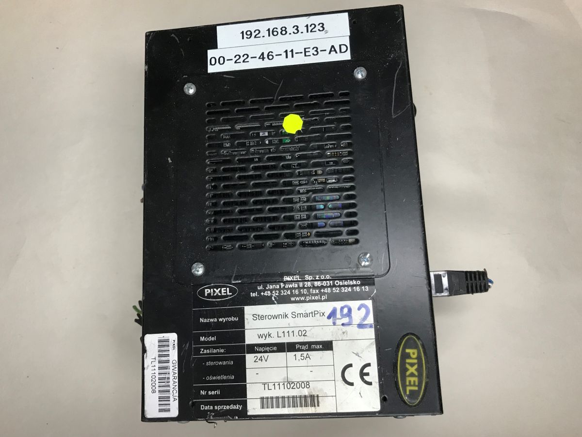

  • Black PIXEL SmartPix controller case with IP and MAC labels, on a light tabletop

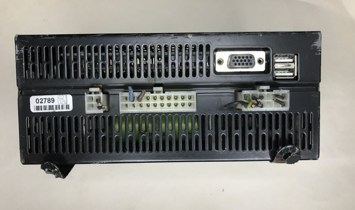

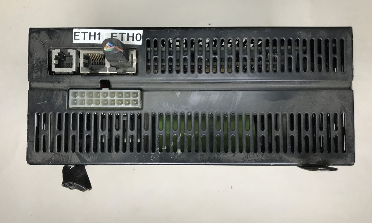

    Today, another curiosity from the electro-junk - a main computer/controller which, according to my information, was used on trains. I'll try to get it up and running here, get into the BIOS, etc. This time the presentation will be even more rich than usual, as I got this equipment in one and a half copies.
    Rear of a black computer module with VGA, two USB ports, and several multi-pin connectors
    The first thing that catches the eye is the VGA monitor output and two USB ports. On the other side we have two Ethernet ports and one telephone port. In addition, we have a connector suggesting a power supply, although the case information rules out that it's ATX - the expected voltage is 24V DC.
    Black electronic module with Ethernet ports (ETH0/ETH1) and a white multi-pin connector

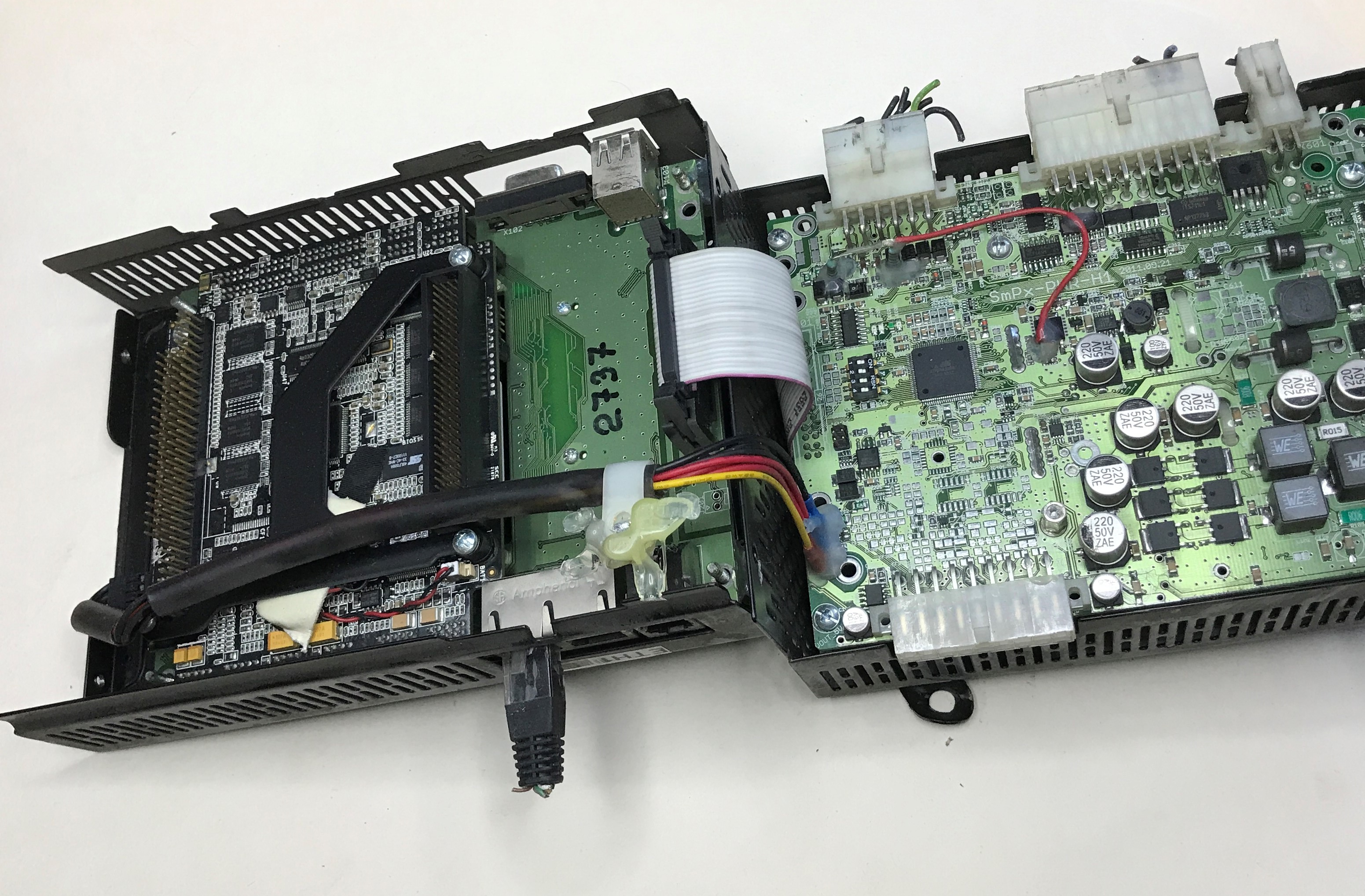

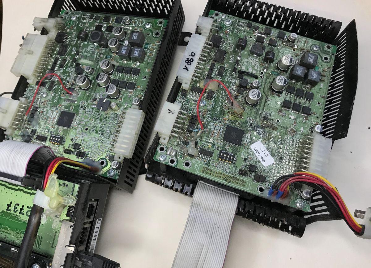

    The chassis turns out to be two-piece and the module opens like a book. There are two boards inside.
    Opened electronics module with two PCBs, ribbon cable, and wires inside a metal enclosure
    Already on opening there is a bit of a crunch, as the surface-mount electrolytic capacitor falls off. Interestingly, it does not appear to be well soldered at all. The photo shows pads where the solder was basically gone.
    Close-up of a PCB with a large white multi-pin connector and several electrolytic capacitors
    I mentioned something about two copies - here they are, this plate I have two pieces:

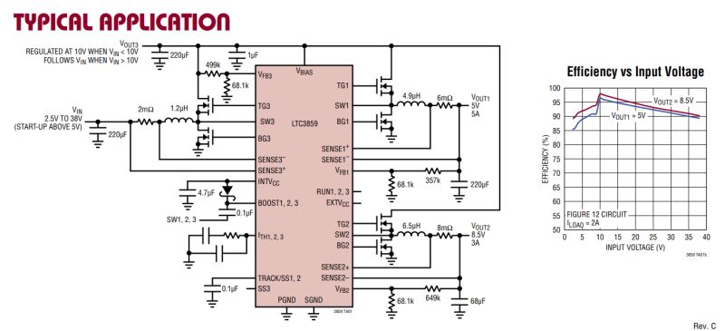

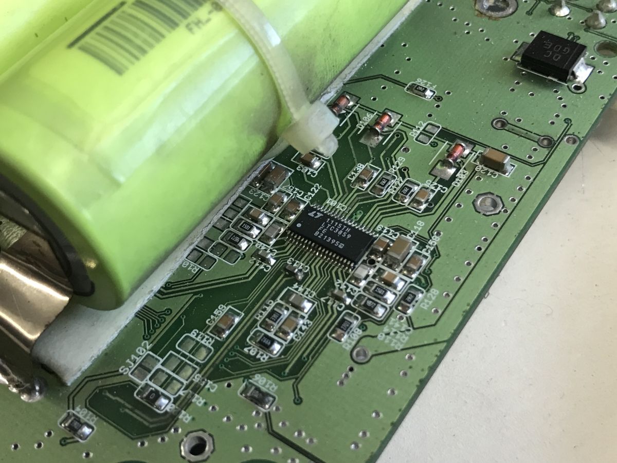

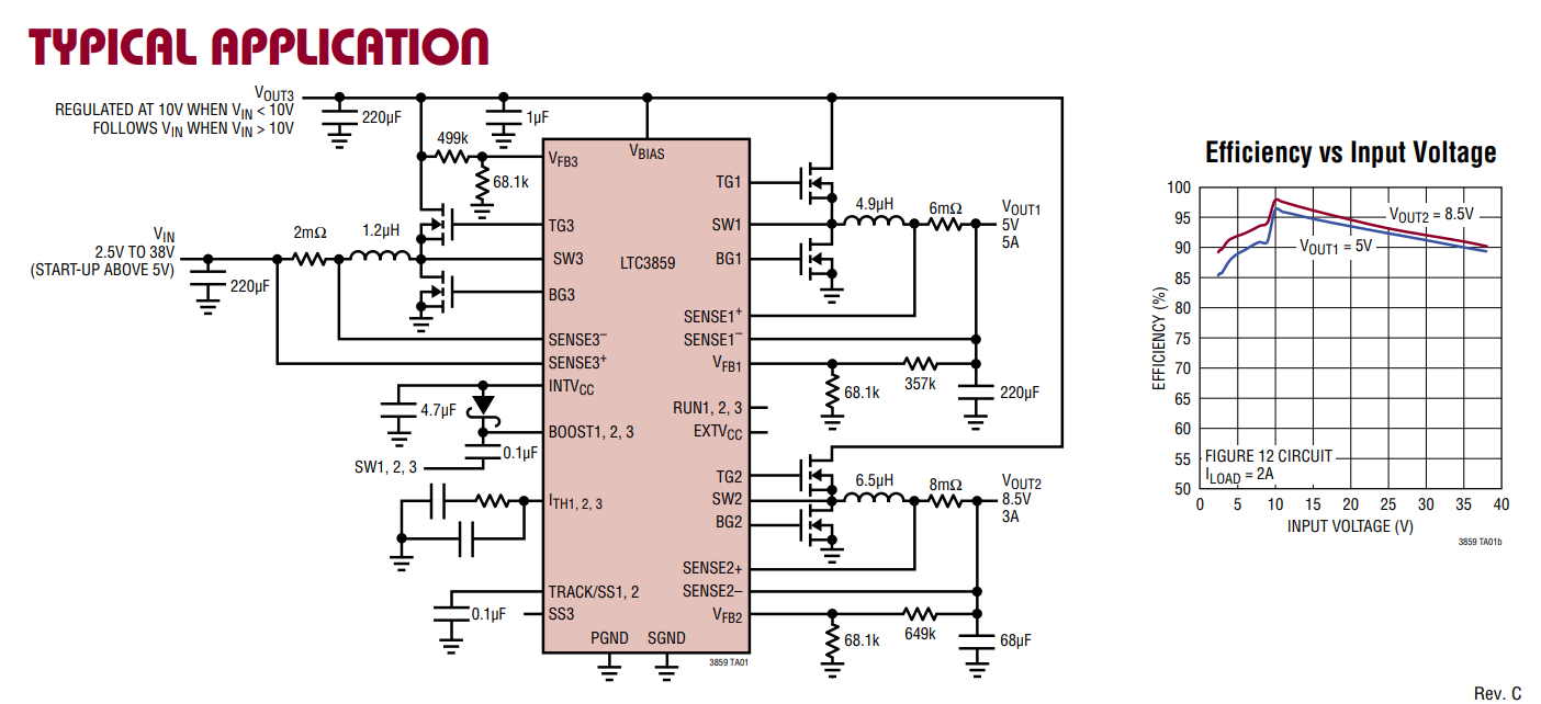

    Nearby you can see the LTC3859, which is a triple controller for the voltage reduction inverter.
    Close-up of a green PCB with an LTC3859 IC next to a pack of cylindrical cells
    Application diagram:
    LTC3859 typical application circuit diagram with efficiency vs input voltage graph

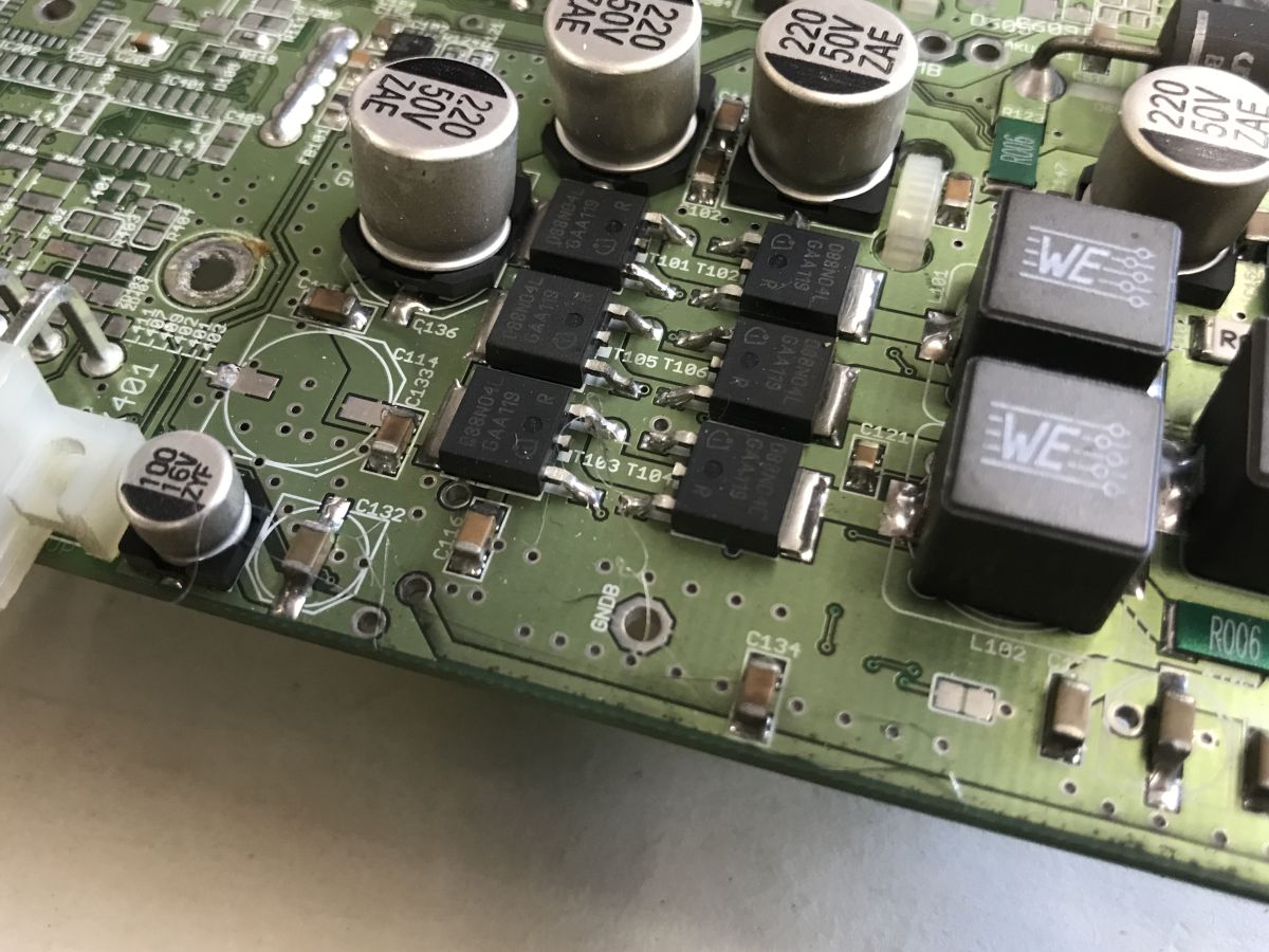

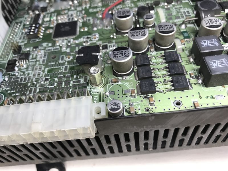

    This would explain the presence of these transistors (088N04L), inductors and capacitors on the other side of the board:
    Close-up of a PCB with electrolytic capacitors, power transistors, and two black blocks marked “WE”

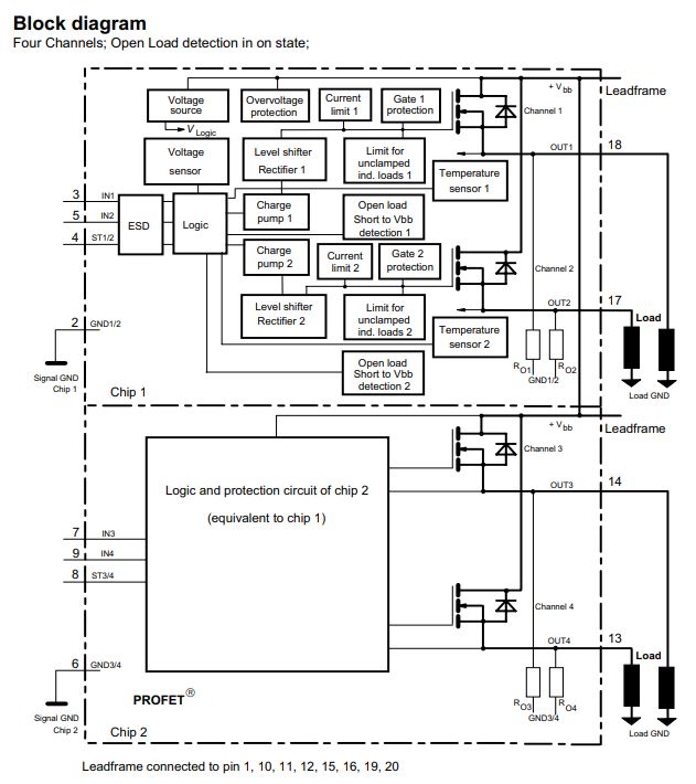

    The whole board is more complex, however, and we have output ports capable of controlling large loads, which appear to be implemented on the ITS711L1 (quadruple key) and BTS409L1. These are controlled by a 74HCT4094D sliding register - presumably the designer was missing pins.
    Close-up of a green PCB with Infineon chips and multi-pin connectors in a white housing
    Block diagram of a four-channel PRO-FET device with protection blocks and outputs OUT1–OUT4

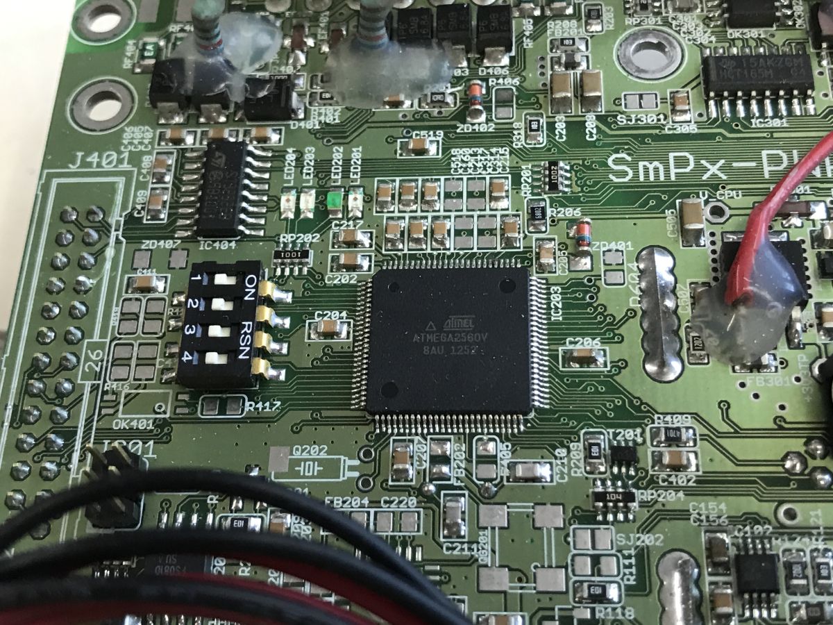

    The heart of the board is the Atmega2560V, I don't know what its specific role is:
    Close-up of a PCB with Atmel ATMEGA2560V microcontroller and a 4-position DIP switch

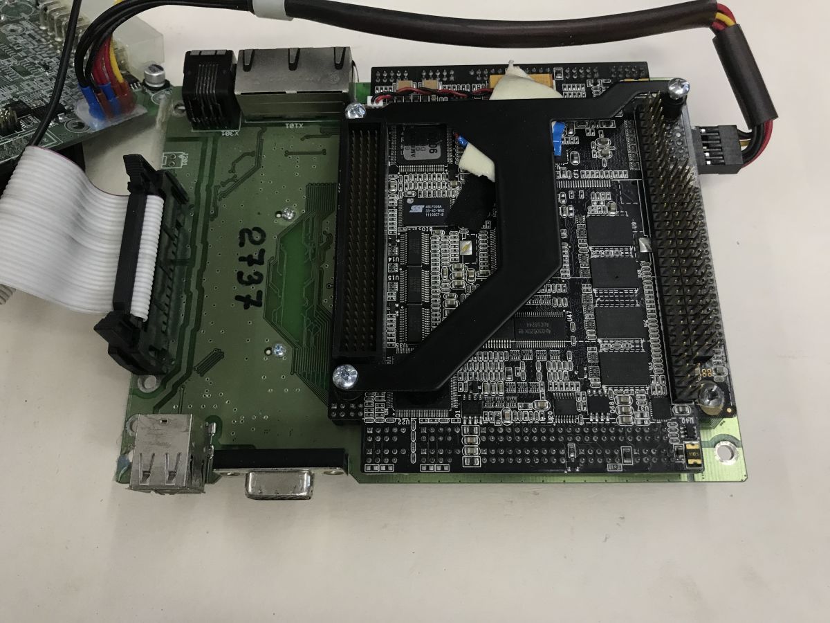

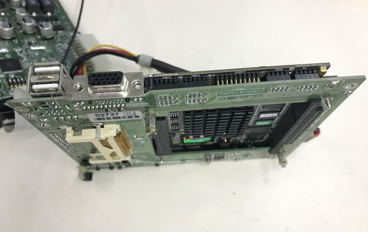

    Now the second PCB - actually two boards, it looks like a microcomputer module superimposed on a proprietary mother board.
    Microcomputer module on a green baseboard with ribbon cable and USB port on a tabletop
    Interesting that even the VGA is derived. I would have more expected this connector to be on the microcomputer module itself, but apparently such a space-saving feature makes sense too.
    Circuit board with VGA socket, two USB ports, and multi-pin connectors on a white surface

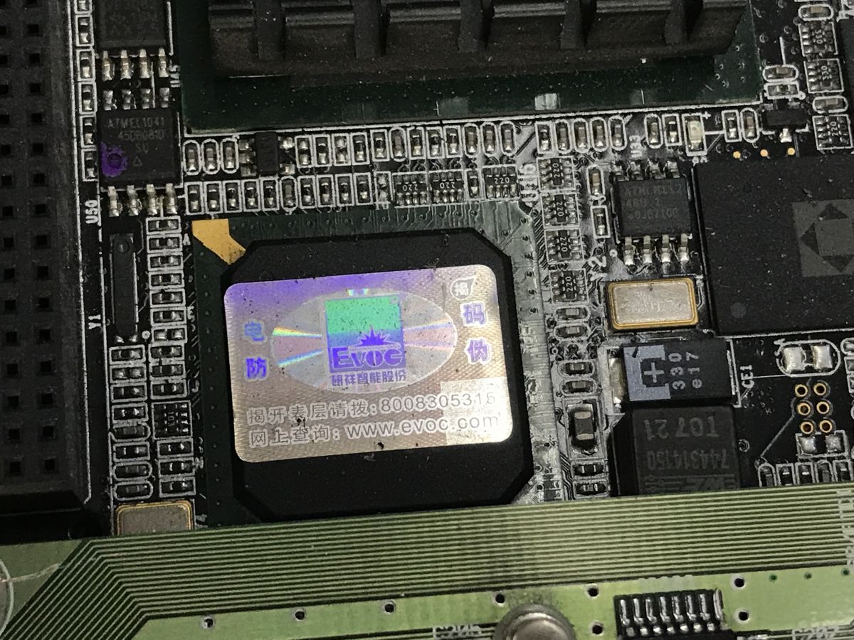

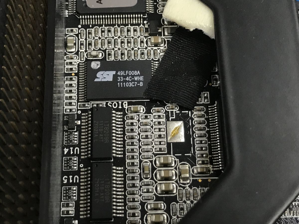

    The sticker on the CPU identifies what the hardware is - an EVOC microcomputer:
    Close-up of a PCB with a chip bearing an EVOC holographic sticker and surrounding SMD components

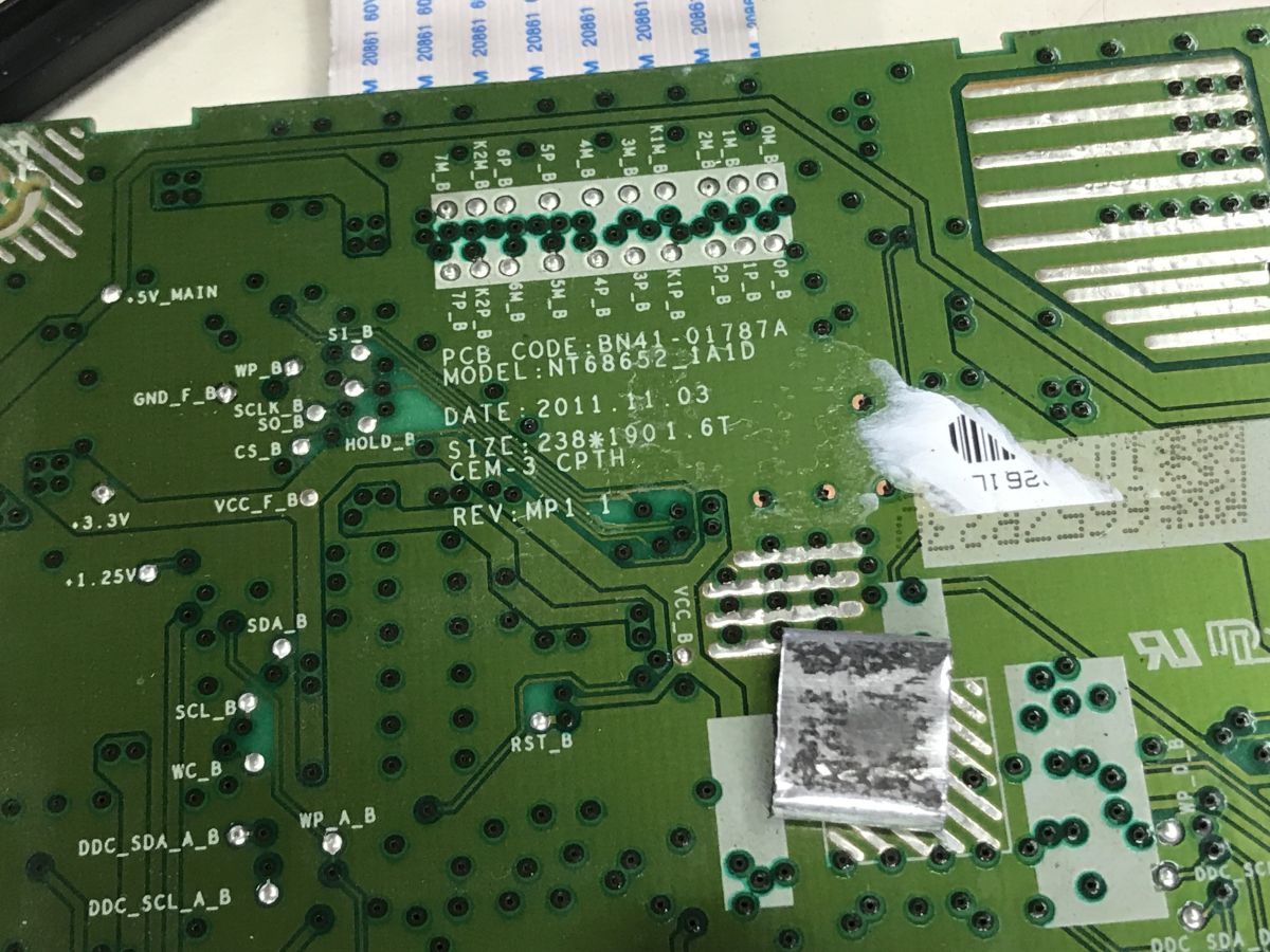

    Additional module
    I still received BN41-01787A in the kit. Even without looking up the name in a search engine, you can see that this is part of the monitor. Here we have a VGA connector, a place for DVI and a connector from the DC power supply, and from the board comes the LVDS ribbon for matrix control. There is a connector from the LED backlight on the side.
    Circuit board in a black frame with a VGA port, connectors, and a ribbon cable

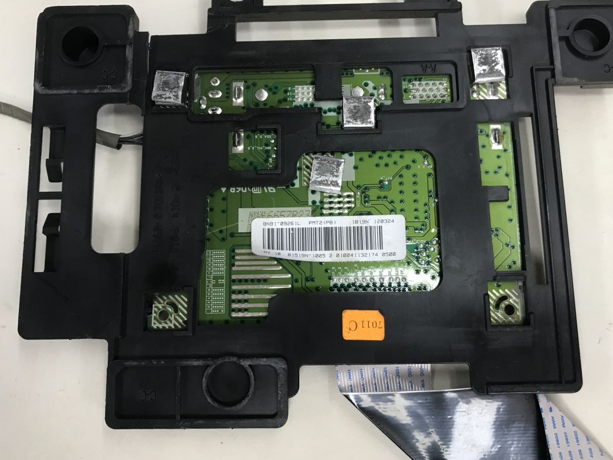

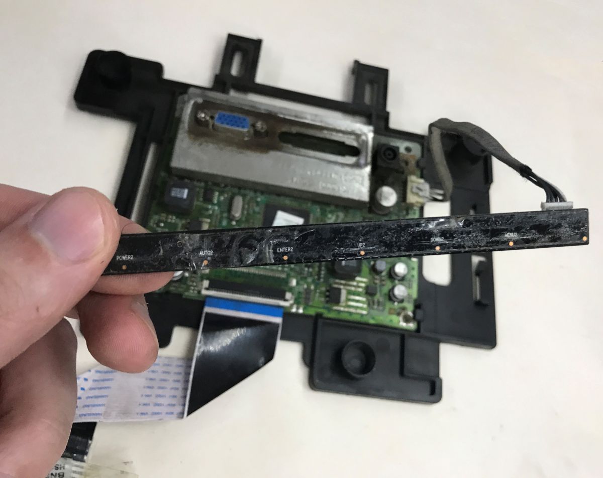

    Characteristic plate with buttons:
    Hand holds a narrow button-and-LED board in front of electronics with a VGA connector

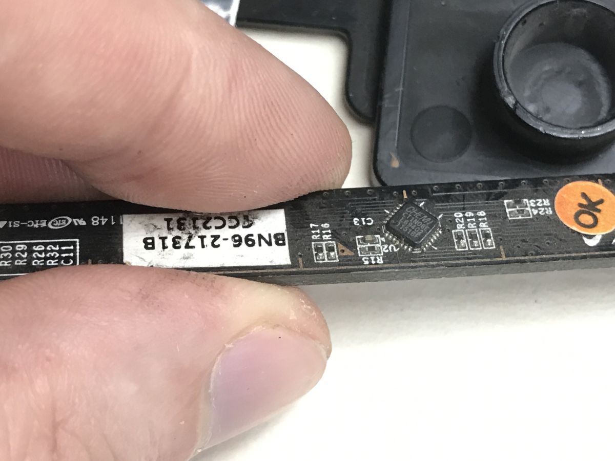

    I was curious about the button controller, could it be something with an interface such as SPI or I2C?
    Close-up of a PCB with “CT1N08E” chip held between fingers, showing label “BN96-21731B”
    CT1N08E Chemi, I couldn't find its data sheet.
    Green PCB in a black frame with a barcode label showing BN91-09261L Close-up of a green PCB with SMD chips, a crystal, capacitors, and a ribbon connector on the right Close-up of a green PCB with BN41-01787A markings and many vias and traces

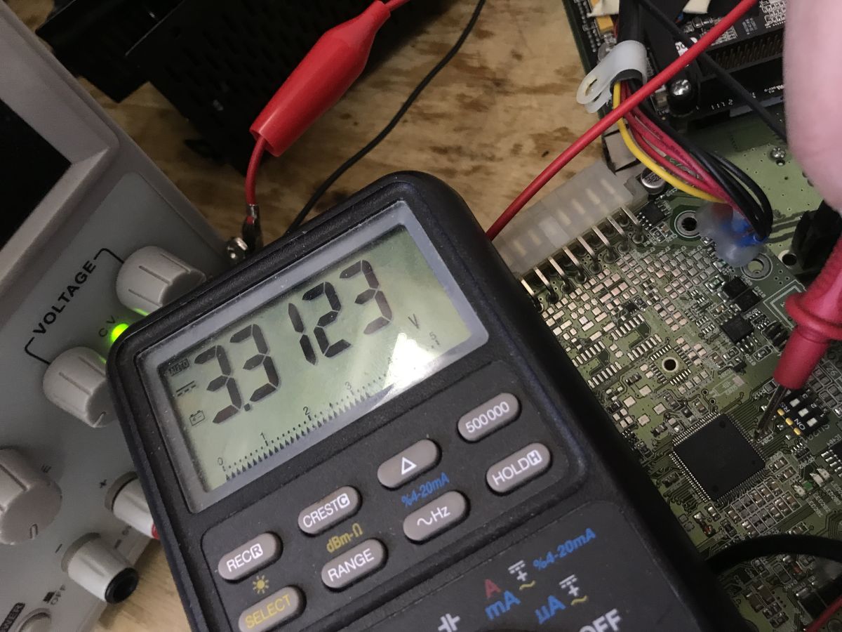

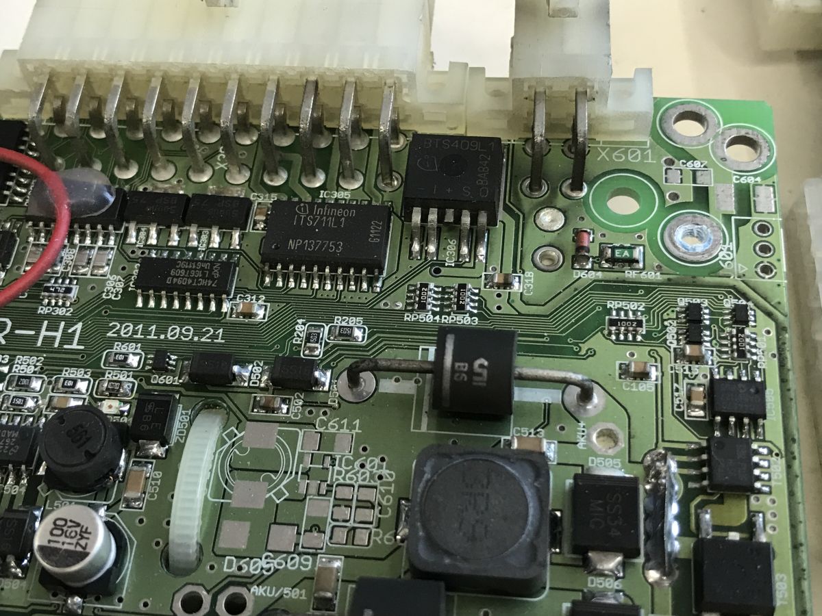

    At first I reckoned that this connector was from ATX - but it doesn't fit and doesn't agree with the voltage from the case. Then I made a bet that the quadruple connector was a 24 V input. I used a lab power supply in current limiting mode for testing.
    Digital multimeter reading 3.3 V while probes touch a PCB with connectors and wires

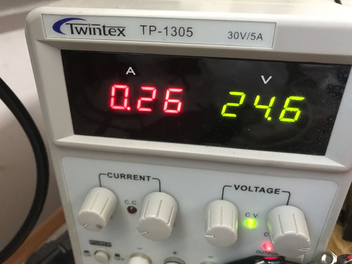

    At first, I only managed to get light from one LED and 3.3 V on the capacitor from the Atmega. This is already something.
    I kept a close eye on the current, it did not want to grow beyond 0.01 A. Only by changing the position of the DIP switches did it succeed:
    Close-up of a Twintex TP-1305 bench power supply showing 0.26 A and 24.6 V

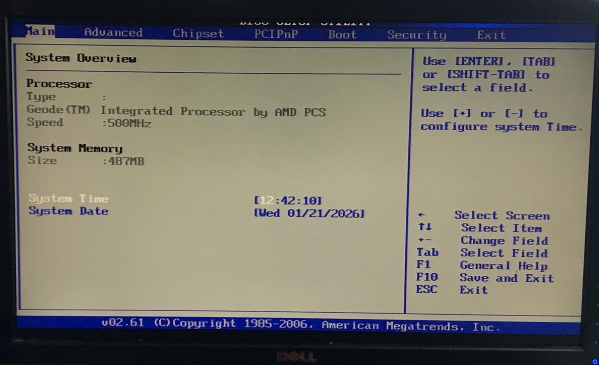

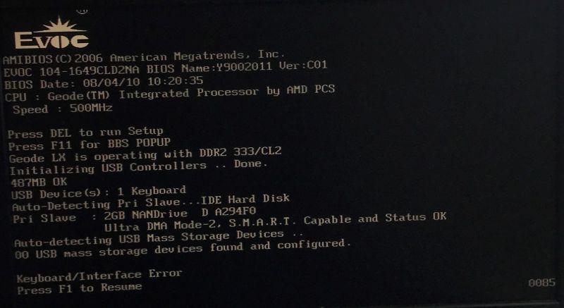

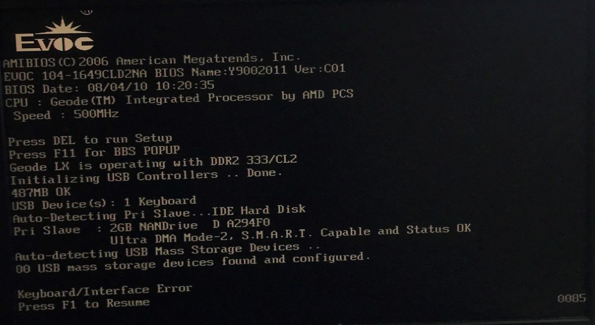

    There is a picture - the device also sees the keyboard on the USB. The CPU is Geode (TM) by AMD PCS 500 MHz, the memory is DDR2 487 MB, the disk is 2 GB NANDrive D A294F0.
    EVOC BIOS screen showing AMD Geode 500 MHz CPU, DDR2 memory, and a 2 GB NANDrive disk
    The computer itself identifies itself as EVOC 104-1649CLD2NA.

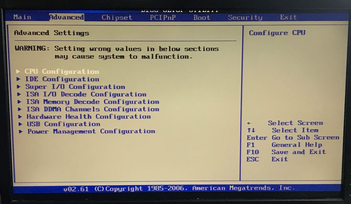

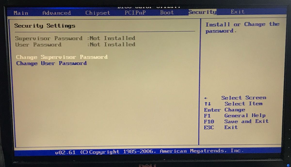

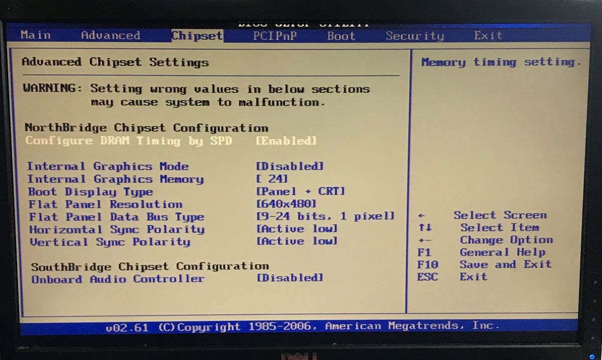

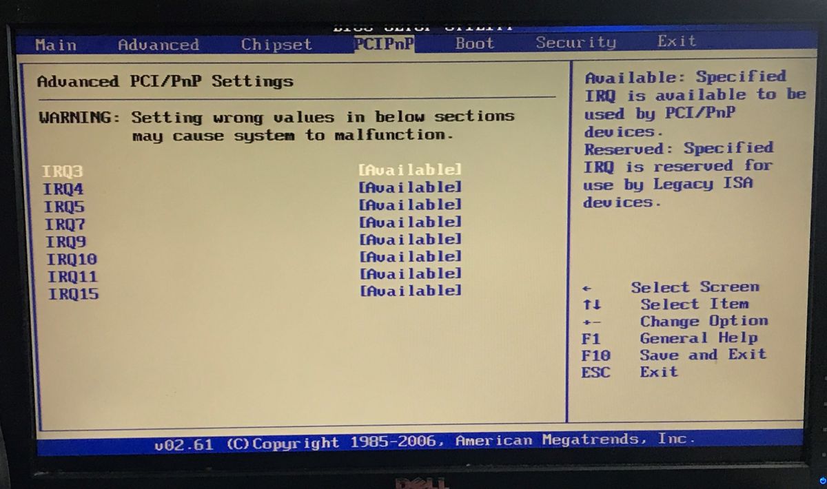

    It is possible to enter the BIOS:
    AMI BIOS System Overview screen showing AMD Geode 500 MHz, 487 MB RAM, and system time/date fields. AMI BIOS screen, Advanced Settings tab with options for CPU, IDE, USB, and power management BIOS “Advanced Chipset Settings” screen showing graphics options and flat panel 640×480
    AMI BIOS screen on the PCI/PnP tab showing IRQ list marked as Available BIOS screen on the Boot tab showing boot settings and device priority for HDD and Realtek network BIOS screen showing “Security Settings” tab with supervisor and user passwords listed as not installed.

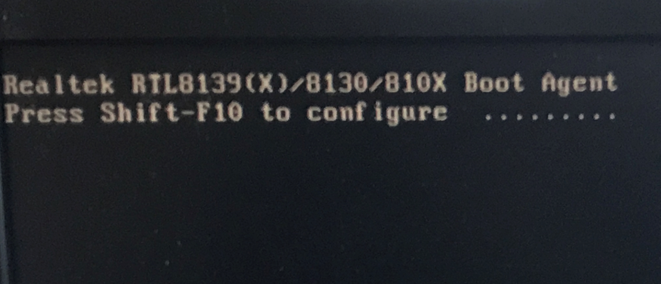

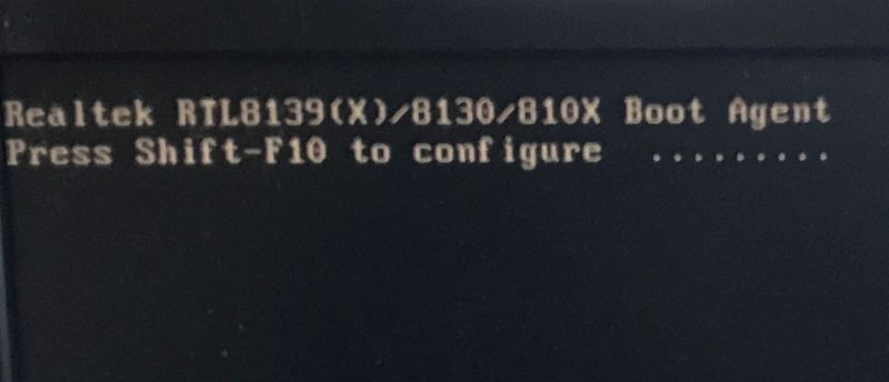

    I still caught this message - Realtek RTL8139, probably the network controller.
    Boot screen showing “Realtek RTL8139(X)/8130/810X Boot Agent” message

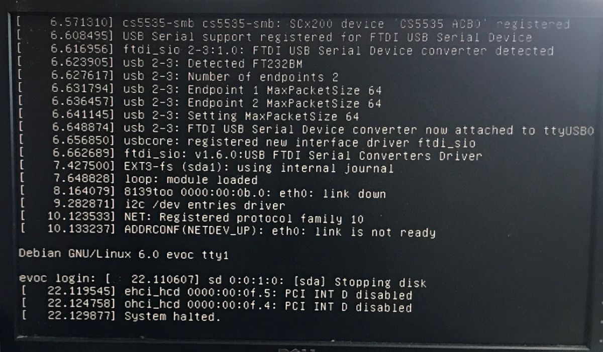

    Then Linux starts up - but you can't even type anything in the login line, because a "System halted" error pops up.
    Screen showing Debian GNU/Linux boot logs ending with “System halted”

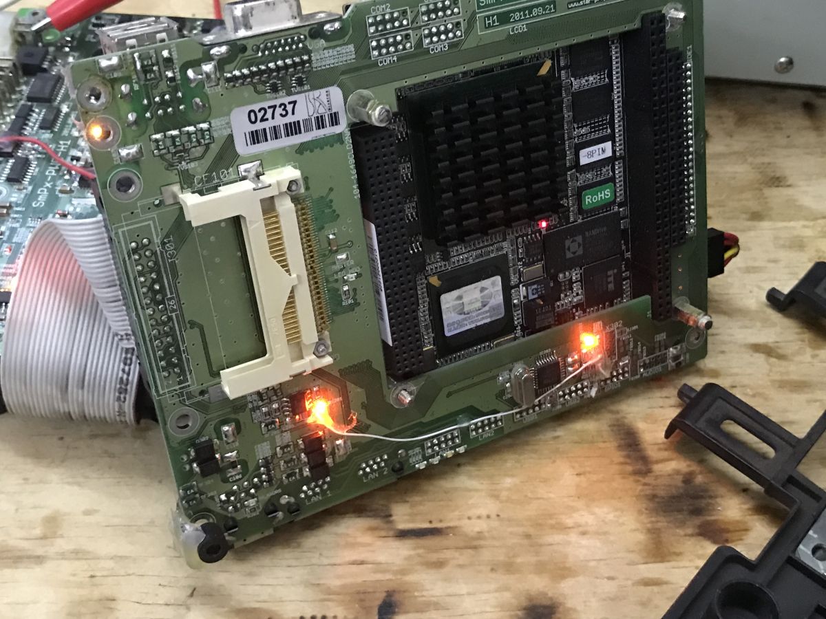

    The LEDs on the computer board are lit:

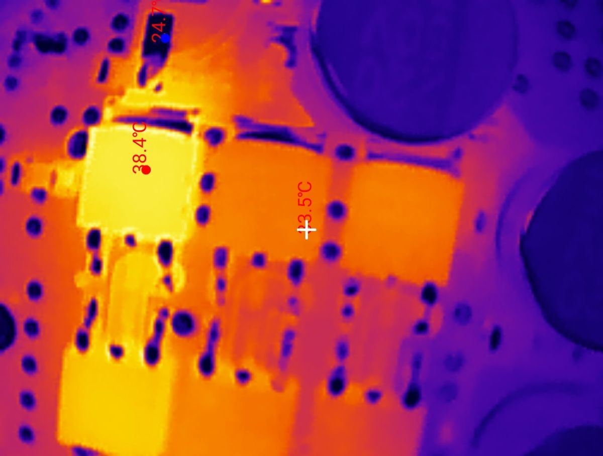

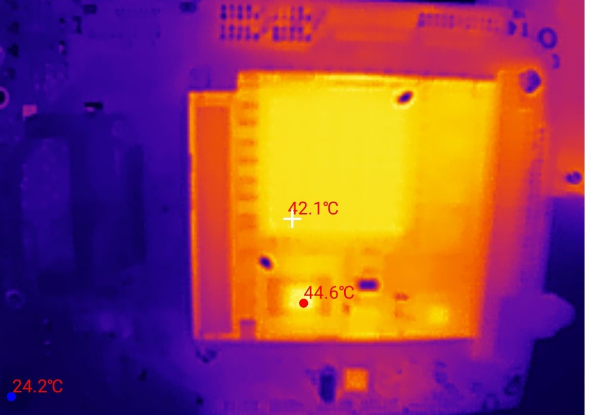

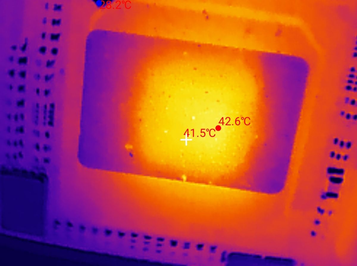

    On the motherboard the key transistors from the inverters are heating up the most. On the computer board, the CPU heats up.
    Thermal image of a PCB with measurement markers showing temperatures up to about 39.1°C Thermal image of a PCB with two hot components and labels 38.4°C, 24.7°C, and +3.5°C
    Thermal image of a PCB with a hot central module; temperature readings 42.1°C and 44.6°C Thermal image of an electronic circuit board with a hottest area around 42.6°C

    The whole thing is password-protected, but maybe it would be possible to upload a new system to it - I have to try, do you have any suggestions as to what could be uploaded there?

    Maybe to start with a BOOT from USB without recording - some Linux and you can try to see what is on the disk unless it is encrypted apart from the password.
    Generally what is there now I think it really wants a LAN connected - Once that Realtek Network Boot is set as the second BOOT and additionally I think it is when there is no LAN access that the reboot happens.
    On disassembly it was easier to cut the wires than remove the plugs and clearly there is a plug in ETH0.
    Maybe this worked on a network with other computers where one was a kind of server and provided system images or other software components without which this Linux recorded now won't castrt.

    And what kind of CPU is sitting there?
    EVOC 104-1649CLD2NA
    Are you sure? After a few specifications found, one can find out that the PC should have at least DDR3L and a CPU from AMD clocked at at least 615MHz.
    The screenshots state AMD Geode 500MHz with DDR2 and such specifications can be found but in older boards.
    Don't get me wrong - this is the first time I've seen this with my eyes, I also want to figure out what can be done with it XD
    What kind of socket is this?

    dLogan wrote:
    What is this nest?
    Close-up of a white connector with a brown FFC/FPC ribbon cable on a green PCB
    This looks like a Compact Flash card slot, often found in industrial computers like this - visible description "CF101" on the PCB, better perspective here:
    Electronics PCB with a microcomputer module, black heatsink, and lit LEDs on a workbench
  • #5 21844137
    IS
    Level 19  
    Posts: 247
    Help: 16
    Rate: 98
    It's the CF connector, presumably the main part of the system is on this card by default, and it was removed when the hardware was disassembled.

    You can see it is booting Debian,
    personally, I would boot it in some kind of "fallback" mode, or boot in any way that supports ext2/3,
    further:
    find out what the /etc/passwd file is, edit it (make the encrypted password place for root blank),
    .... reboot....
    login: root
    password:
    and you are in debian without a password.

  • PC/104-style microcomputer module on proprietary motherboard
    #10 21844343
    zgierzman
    Posts: 1787
    Help: 108
    Rate: 1573

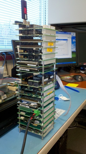

    Now the second PCB - actually it's two boards, it looks like a microcomputer module superimposed on a proprietary mother board.
    This looks like a PC/104 standard board
    I didn't have much to do with it, but usually I think most of the I/O (network cards, video outputs etc) was moved to external cards. You could build quite large towers out of this :-) Here the I/O was done by the manufacturer in his own way to fit the case.
    I found something like this on the internet ;-D
    Tall stack of green PCB boards on a desk, with monitors, cables, and office items in the background

What exactly is this railway on‑board computer?
It’s an EVOC single‑board computer module (identified as 104‑1649CLD2NA) on a custom carrier, previously used on trains and still able to POST and enter BIOS. [Elektroda, p.kaczmarek2, post #21843838]
How do I power it safely for first tests?
Use a lab PSU set to 24 V DC with current limiting. Connect the 4‑pin 24 V input, watch current draw, and set DIP switches as needed to reach BIOS. [Elektroda, p.kaczmarek2, post #21843838]

Why does the installed Linux halt at login?
A forum member notes netboot is second in the boot order and missing LAN can trigger reboot or halt. Connect Ethernet and try again, or boot from USB to inspect the disk. [Elektroda, stachu_l, post #21843894]
How can I access the system if I don’t know the root password?
Boot any environment that supports ext2/3, edit /etc/passwd, and clear the root hash. Reboot; login as root with an empty password. “And you are in Debian without a password.” [Elektroda, TrotyL, post #21844272]

What’s on the power/IO daughterboard with big inductors?
It carries a triple buck controller (LTC3859), MOSFETs, and high‑side switches (ITS711L1, BTS409L1) for driving loads. “The heart of the board is the Atmega2560V.” [Elektroda, p.kaczmarek2, post #21843838]

What is the extra BN41‑01787A board in the bundle?
It’s a Samsung monitor controller board with VGA, footprint for DVI, DC input, and LVDS to the panel, plus LED backlight connector and button PCB. [Elektroda, p.kaczmarek2, post #21843838]

Quick 3‑step: how do I get to BIOS and test video?
  1. Supply 24 V DC with current limit enabled.
  2. Adjust DIP switches until POST appears.
  3. Connect VGA and USB keyboard; enter BIOS and verify devices. [Elektroda, p.kaczmarek2, post #21843838]
