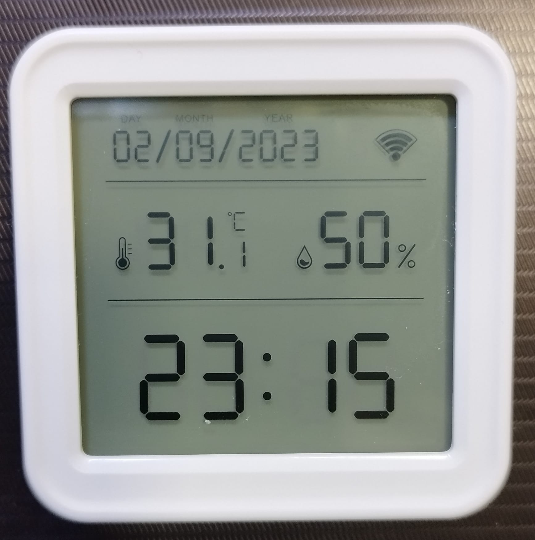

  • TH08-CBU-ATH20-V2 is a LCD calendar/clock/temperature/humidity unit with a BK7231N CBU module, BL55070 LCD driver, and ATH20 sensor.
  • U3 appears to be the Tuya MCU, while U8 with a 32.768 kHz crystal likely handles RTC and LCD/backlight control, and Q1 switches Wi‑Fi power.
  • It runs from 3xAAA cells at 4.5V and was bought for 4.49€ as a Choice offer.
  • The Tuya app shows a 1 hour update interval, and pairing can fail because the device connects only briefly between updates.
Electronic display with date, temperature, humidity, and time

External and teardown photos:
Electronic display with date, temperature, humidity, and time Electronic display showing date, temperature, humidity, and time.
View of the underside of a green printed circuit board with trace markings. Black LCD panel and white component on a dark background.
Close-up of a PCB with markings and electronic components. Interior of an electronic device with a visible CBU module and PCB markings.
Electronic module with a PCB labeled TH08-CBU-AHT20-V2 2023/07/22.
As you can see, the PCB silkscreen states "TH08-CBU-ATH20-V2 2023/07/22"

After drawing this, it seems clear U3 is the main MCU, connected to CBU module via RX1 and TX1, to the key, to the sensor via I2C, to the LED, to a voltage divider from the battery, and to the other U8 with two wires (another I2C or RX-TX?) and another signal to start the backlight. There's also a mysterious pad (PB5) connected to it.
U8, with a 32.768 kHz oscillator, is probably an RTC, controls the LCD via I2C to U1 and also the duration of the backlight, and is programmed/read by U3 via a two-wire interface.
As stated above, Q1 is a mosfet controlling power to the WiFi module, switching on or off the connection to ground.
Finally, U4 is the main voltage regulator (2,8 volts) feeding all components except the backlight, which is fed by U6 (3 volts) that is turned on or off by pin 9 of the RTC.

p.kaczmarek2 06 Sep 2023 17:51
This indeed looks like a new version of TH06, just as you said. Let me know when you've done the packets capture. I wonder how much of the protocol/dpIDs has changed. [Read more]
auntlydia 06 Sep 2023 23:42
Hi, I just happened to unpack, disassemble and flash the same device today! I was about to create a post for it, but then you have been already doing this job, thank you! Maybe we can work together to... [Read more]
p.kaczmarek2 07 Sep 2023 00:05
OpenBeken sends time only when it's requested: https://obrazki.elektroda.pl/9594592300_1694037873_thumb.jpg I can't see : TuyaMCU_ProcessIncoming: received TUYA_CMD_SET_TIME, so sending back... [Read more]
auntlydia 07 Sep 2023 00:14
Yes, indeed, it would be good to find out how time is transferred from firmware to the module... is it requested? Or pushed through without request? How can we find out, is there anything I can contribute... [Read more]
p.kaczmarek2 07 Sep 2023 08:10
It's just accident. Those are not related. It seems that 0x10 (decimal 16) is ObtainDPCache: https://obrazki.elektroda.pl/6885502900_1694066322_thumb.jpg Here are the docs: https://developer.tuya.com/en/docs/iot/tuyacloudlowpoweruniversalserialaccessprotocol?id=K95afs9h4tjjh Interestingly... [Read more]
auntlydia 07 Sep 2023 09:20
Sweet! Thanks for your efforts! I'll test the updated version as soon as its possible and post results, let's see if there is a response. [Read more]
morgan_flint 07 Sep 2023 10:02
Hello again, I've just updated the first post with some corrections and more information (schematic), and I see you've been making making progress!! Time to read them in detail and see if I can add... [Read more]
p.kaczmarek2 07 Sep 2023 10:40
The display is controlled via MCU, that's why it's hard to just remove MCU and do everything in OpenBeken, although IMHO it would be the preferred way. TuyaMCU complicates lots of things. [Read more]
auntlydia 07 Sep 2023 13:03
Good news! It works with the new version! Good job, thank you so much! Look at the beautifully working sensor now: https://obrazki.elektroda.pl/5404196700_1694084370_thumb.jpg And here we... [Read more]
p.kaczmarek2 07 Sep 2023 13:31
Whoa, I didn't expect it to work at the first try! I haven't even compiled that code before pushing it. Well, if everything really works as expected, then there is very little point to doing data capture.... [Read more]
morgan_flint 07 Sep 2023 13:39
Congratulations!! I'll also give it a try. As you haven't changed anything in this sense, I imagine the report time is still one hour, which I find too long. In the Tuya App there's no option to reduce... [Read more]
p.kaczmarek2 07 Sep 2023 13:47
Polling time setting may be done via dpCache (ObtainDPCache), but you need to know the corresponding dpID. See this topic for example usage: https://www.elektroda.com/rtvforum/topic3975583.html If... [Read more]
morgan_flint 07 Sep 2023 13:49
Hello, p.kaczmarek2. I posted it here following the instructions here . Is it correct? Should I also post something (e.g, a link to this thread) also in the general Devices Teardown forum? [Read more]
auntlydia 07 Sep 2023 13:50
I checked Home Assistant history and I get an update of sensor data every ~17 minutes as standard, even without change of temperature or humidty. As soon as there is a change in temperature or humidity,... [Read more]
morgan_flint 07 Sep 2023 13:56
Ok, sorry to hear that. Anyway, I'm not sure if "polling time" was the correct term for my question, what I meant is if there was a command to set the period in which the MCU "wakes up" the CBU WiFi module... [Read more]
p.kaczmarek2 07 Sep 2023 14:00
Generic teardowns section is only for non-iot teardowns, and smart home is for IoT topics and teardowns. As I said, check if there is an option to set that wake up period in Tuya app, and if it's available,... [Read more]
morgan_flint 07 Sep 2023 14:01
Ok, thanks!, I'll try that and report back. I think, apart from the original firmware's low reporting frequency, this version of the device has one of the best designs and, if the battery life is long... [Read more]
auntlydia 07 Sep 2023 14:06
haha, I have played with thought about Lipo-mod as well! And we could squeeze in a USB-charge module, but we would need to cut the battery plastic housing to make some space. Else I totally agree, I think... [Read more]
morgan_flint 07 Sep 2023 14:14
I already checked it, as you can see in the screenshots at the first post, it seems that option is not available, unfortunately. Totally agree... such an effort is not worth it, and probably this... [Read more]
