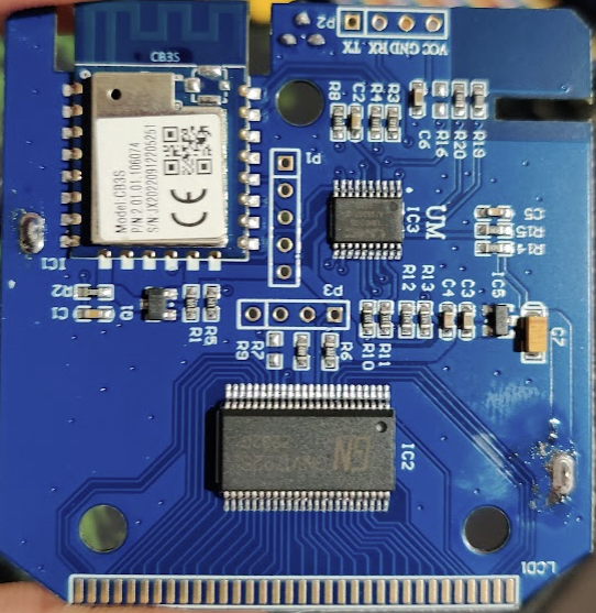

    Teardown of this battery powered temperature & humidity monitor from AliExpress
    [BK7231N] Tuya Temperature & Humidity Monitor: Teardown, Hackability & Features Explained
    It's very hack-able, just 2 screws and it opens right up, nice accessible board, very easy to break-out:
    CB3S chip; assume it's BK7231N like CB2S?
    Also packing TuyaMCU:
    I took capture of communication stream.

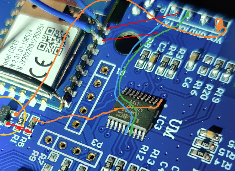

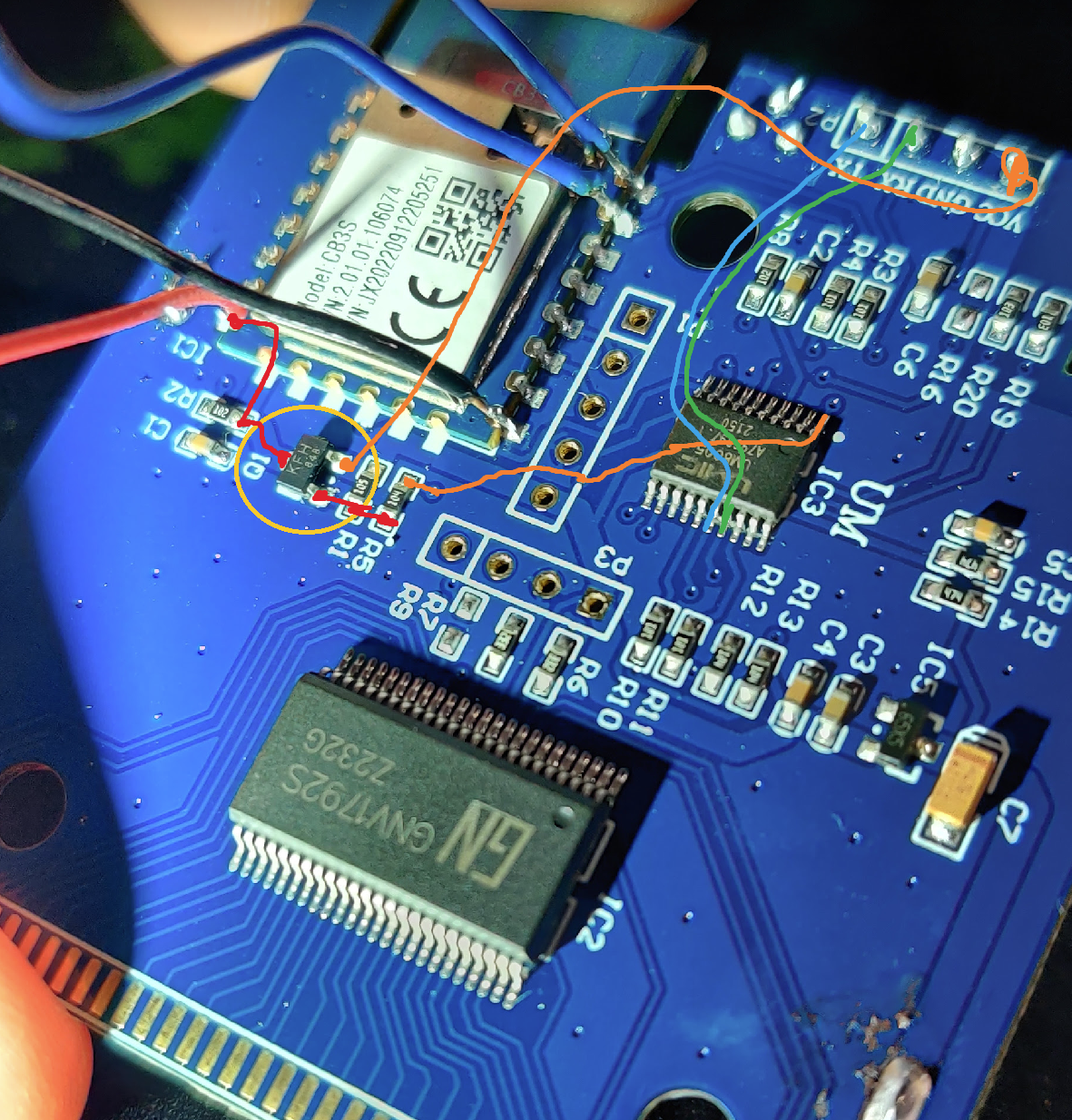

    Can you check, is the CB3S in this device always powered, or does it gets disconnected by TuyaMCU?
    There are some low power devices that have a TuyaMCU which controls power of WiFi module through a N-MOSFET. TuyaMCU can just turn off totally WiFi module and save power. WiFi module is only enabled from time to time when it's needed.
    What is Q1 on the board doing?

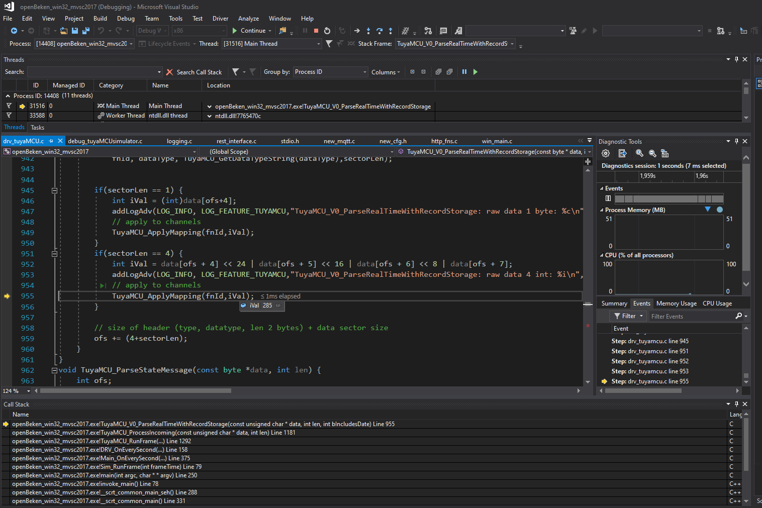

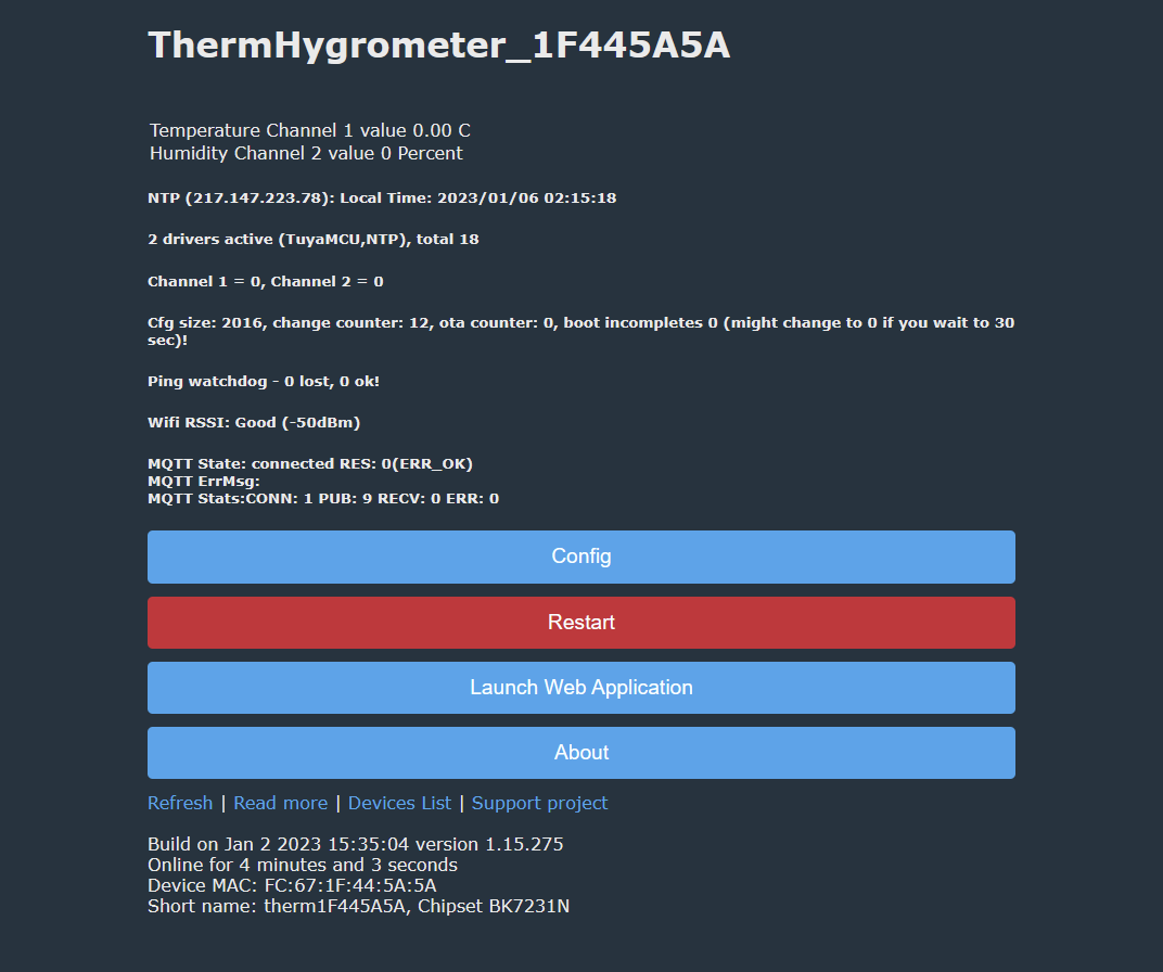

    I have extended my app a little and I can see humidity and temperature data (temperature data is sent as integer and then divided by 10):
    There are much more variables but I don't know the meaning of them. What could be 390 (with fnId 10) and 60 or 20?

    Futhermore, what are the markings of TuyaMCU and of the LCD driver?
    I updated OP with additional photos, including good images of the additional chips.

  • 0x10 packet format may enable OpenBeken configuration
    #12 20293511
    Posts: 14743
    Rate: 12839
    Well, I would also say they shouldn't be there after all, but maybe this packet is a modified version, after all, it has a 0x10 identifier and not the default one.
    Still, now that we know it's format, it should be possible to send such a packet from OpenBeken as well, to configure the device.
    Ok, is there anything else we need to know?

  • Tuya-controlled power gating blocks Wi-Fi flashing
    #22 20326232
    TurkeyMan
    Posts: 59
    Rate: 9
    I'm trying to flash this one today, but it seems I've hit a roadblock... it just always fails with "Cannot get bus".
    I have a theory though; since powering 3.3V also powers the Tuya which starts a very noisy chatter; what stops the comms with the wifi module from being interfered by the Tuya?
    I feel like I need to remove the Tuya somehow in order to isolate the wifi module from the comms circuit... but it's all tiny SMD parts, which I have no skills or tools to interface.
    Added after 58 [minutes]:
    Yeah, I can't work out what to do here... the wifi module's 3.3 is connected to what looks like a transistor, which connects back to a pin of the Tuya; so it seems the Tuya enables an IO pin which powers the wifi module on demand.
    If I power the mainboard's 3.3V rail, the Tuya fires up, and then when that's happening, it fires up the wifi module, but they're chattering so I can't interrupt the wifi module's boot process to do a flash when the Tuya is in communication.
    I thought I could try and power the 3.3V pin of the wifi module on the down-stream side of the transistor and that would isolate the wifi module from the rest of the board, but that doesn't seem to work; there's enough circuitry that the rest of the board gets some power and affects things when I breakout from the wifi module directly...
    If I try and flash the chip using the breakout wires seem here, it still doesn't work.
  • Ways to isolate TuyaMCU for BK7231N flashing
    #23 20326460
    Posts: 14743
    Rate: 12839
    Your assumptions are basically correct.
    There are few things to note:
    - TuyaMCU decides when to power WiFi module, so for flashing you'd have to power it manually
    - there are two flashing headers on the board (for WiFi and for TuyaMCU), as you correctly noted
    - TuyaMCU communication with WiFi will interfere with programming
    There are multiple approaches you can take here:
    a) desolder whole WiFi module and just power from an external 3.3V LDO, just connect RX and TX and repower while "getting bus", it's works, no external resistors needed
    b) cut traces between WIFI module and MCU, power WiFI module from 3.3V LDO external directly, flash (repower while "getting bus")
    c) find datasheet of the MCU, determine whether it has a RESET pin, if it has, put the MCU into RESET state (by shorting it's RESET to ground?), and then power WiFi module from external 3.3V and flash
    d) you can of course also desolder whole MCU....
    e) if those tracks don't go to MCU directly (but through resistors):
    you could just desolder resistors..

    Can you post a screenshot from your main page?
    What do you have in the logs?
    I have checked parsing of your packets on windows and it gets the 285 value correctly - 28.5C:
    I'm trying to make progress on this. It doesn't seem to want to communicate with the Tuya... maybe it's because how I'm powering it?
    I'm powering the device's main VCC, which powers the Tuya, but under normal operation, the Tuya turns the wifi module on for a moment from time-to-time to allow it to report, then off again. I can't work out when the device is powered, and I can't intercept it fast enough to do any config or tests, so I also power the wifi module directly at the same time as the mainboard.
    I'm not sure if applying power to the main board and to the wifi module both directly is going to cause some problem with the Tuya... I'm not sure why it would... but when I power it this way, the wifi module boots up, but it shows no communications.
    Maybe it would be useful to make that UART sniffer you described in another thread?
    I see there is "UART Tool", on the main menu; when I choose that, it looks like I can type some ascii and transmit over the UART(?), but it doesn't seem that it logs any incoming communications.
    Perhaps improve that bit of software so it logs all RX bytes to a panel in the webpage, and maybe also allow to transmit hex rather than ascii? Then I can at least watch the comms, and I could even fabricate unsupported Tuya packets and send them.
    Added after 58 [seconds]:
    Also, we need a way to transmit the time to the Tuya... I can start NTP, but we need some way to know when the NTP init receives a response, and at that time, we need to send the time message to the Tuya...
    Oh, also, i noticed the "Home Assistant Configuration" automatically populates with config for relays and lights, but in this case where I have 2 read-only values, it doesn't attempt to populate the home assistant config with anything at all...
    Do you know what should go in that home assistant config to advertise these 2 values to HA? How is that config structured?
    Added after 9 [minutes]:
    I think I've just exposed another issue...
    I watched the wifi module's VCC on a scope, so I can see when Tuya supplies power to the wifi module. What I notice is, it powers the device for a few seconds, but OBK doesn't have time to boot up before it cuts the power again. This might be a problem!
    Is there any way OBK can be optimised for faster boot time? It does seem to take a weirdly long time to boot.
    I don't see why a tiny linux running almost nothing should take more than 1s to boot up, but it seems to take 15-20 seconds generally in my case here.
