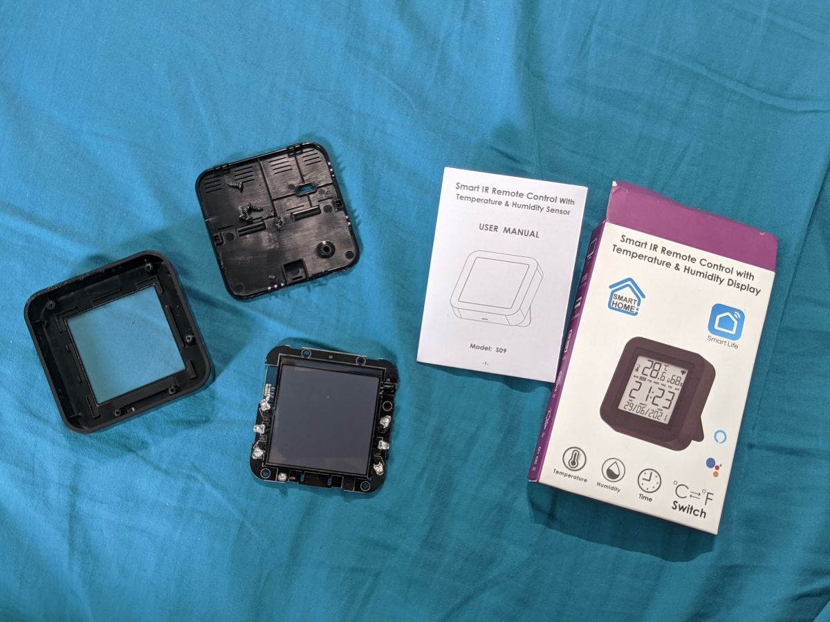

    Kit contents, first impression
    The set came in a flat box:
    Teardown of the TH06 clock/thermometer/hygrometer and UART reverse engineering Teardown of the TH06 clock/thermometer/hygrometer and UART reverse engineering Teardown of the TH06 clock/thermometer/hygrometer and UART reverse engineering
    Product code: SKUH77374
    The product model (TH06) is also printed on the packaging.
    Contents (USB cable is included, but it's a power-only cord, without Data lines):

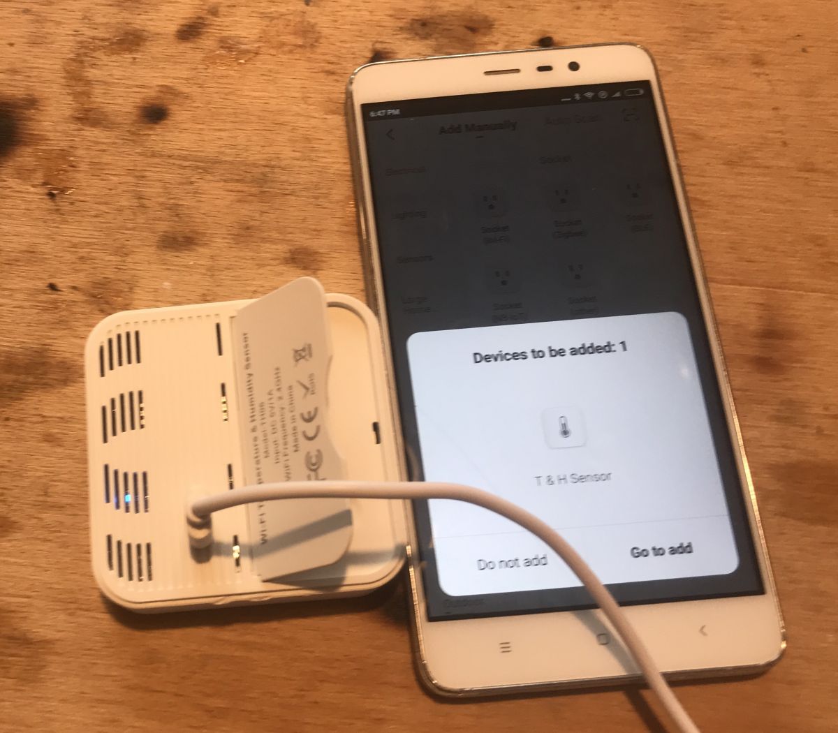

    Pairing is very simple, I have already covered it many times in this series. According to the instructions, we press RESET longer, we provide information about our WiFi in the app ...:
    Added (the temperature shows high, because I heated it with a lamp to check the reaction time - it is quite fast):

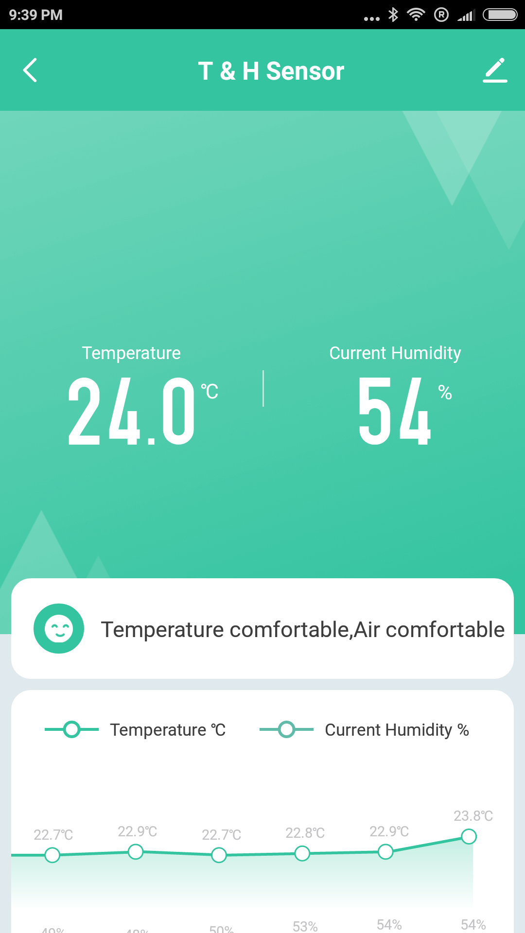

    Android application and its possibilities
    I have already described it several times, so here I just emphasize that the application offers a really wide range of possibilities for creating automation and work scenarios. We can trigger events with temperature, humidity, and even (I don't know why) by changing the format of the displayed temperature (F or C). We can condition events with the current time of the day, with the states of other devices, etc.
    We have AND and OR logical operations available, we have delays.
    Below is a collection of application screenshots:
    Also, of course, there is history and charts:

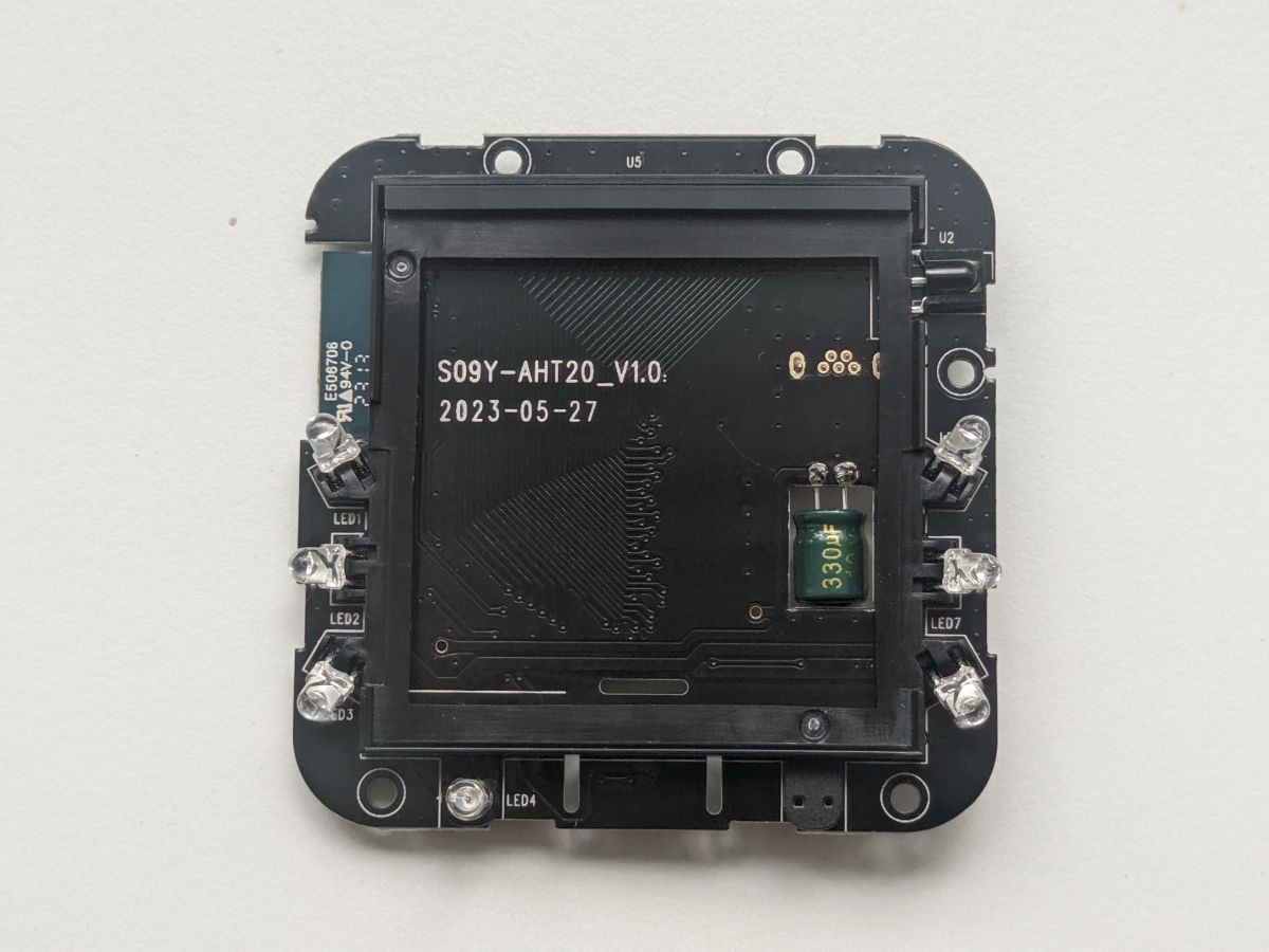

    Interior of the TH06
    The housing is latched. It must be undermined:

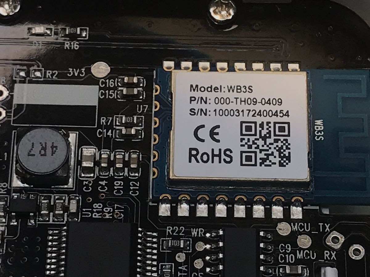

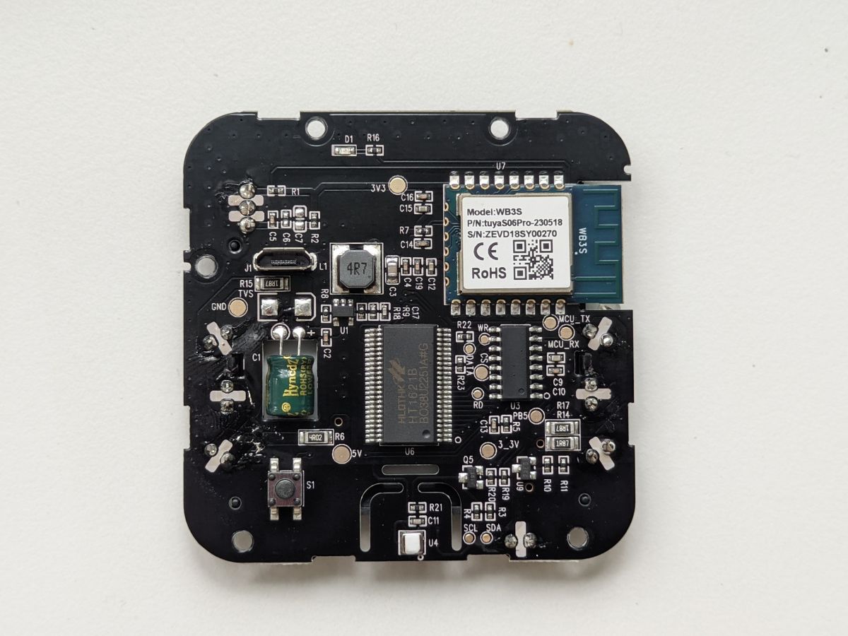

    There is quite a lot of electronics inside:
    Circuit board with mounted electronic components and a module labeled WB3S.
    The heart of the device is the Tuya WB3S WiFi module:
    Unfortunately, it is not based on ESP. We will not be able to upload Tasmota (although you can convert it to ESP12F, desolder and solder ESP ...)
    The WB3S is based on the 32-bit BK7231T. WB3S offers 1T1R WLAN module, 256-KB SRAM, 2MB flash memory and rich peripherals.
    However, the WB3S itself does not support this device. Next to it is a chip in SOIC that looks like a microcontroller, but unfortunately is not signed.
    In addition, we have the LCD driver, TM1621B:

    Of course, there is also a temperature / humidity sensor on the board. This is a very popular AHT10:

    Next to AHT10 you can see a transistor signed A19T.
    Maybe it's AO3401? I can see it is very popular:
    This transistor is probably some part of the AHT10 circuit, I see a similar element on the modules with it.
    There is of course also the power section. The characteristic large element marked 4R7 is a choke (not a resistor), it proves that there is a step down converter that converts 5V to 3.3V for the WB3S. There is also no LDO regulator in the vicinity, which also confirms the presence of a step down converter. The step down converter is more efficient than the regulator.
    The step down controller is signed A121.
    It's probably SY8008A / SY8008B / SY8008C. I can see that someone from the Radiokot forum was already looking for it.

    It is also worth noting that the manufacturer has placed a large low ESR electrolytic capacitor.
    Only the button remains (I do not know what these unpopulated place under Q2, Q3 are for):

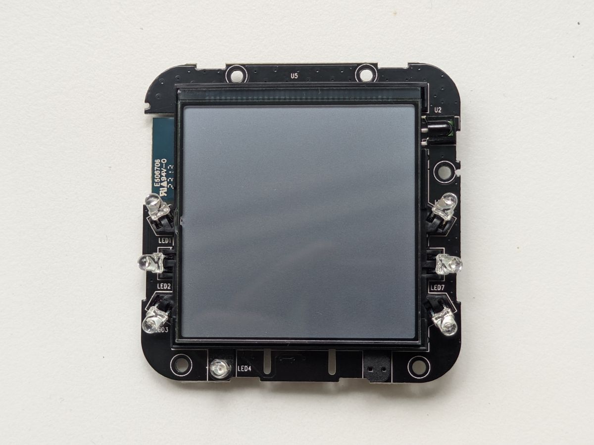

    Now a glance from the front.
    This protruding part of the WB3S module is not a coincidence. This is where the antenna is on the board. It shouldn't be covered:
    Tuya strongly recommends not to cover the antenna with a PCB. This would reduce the range / quality of the WiFi signal:
    There is also a place for a mysterious element with three pin, which in my opinion would undoubtedly be an IR receiver:
    So probably the second version of this product with IR uses the same board, but has an additional receiver soldered here.

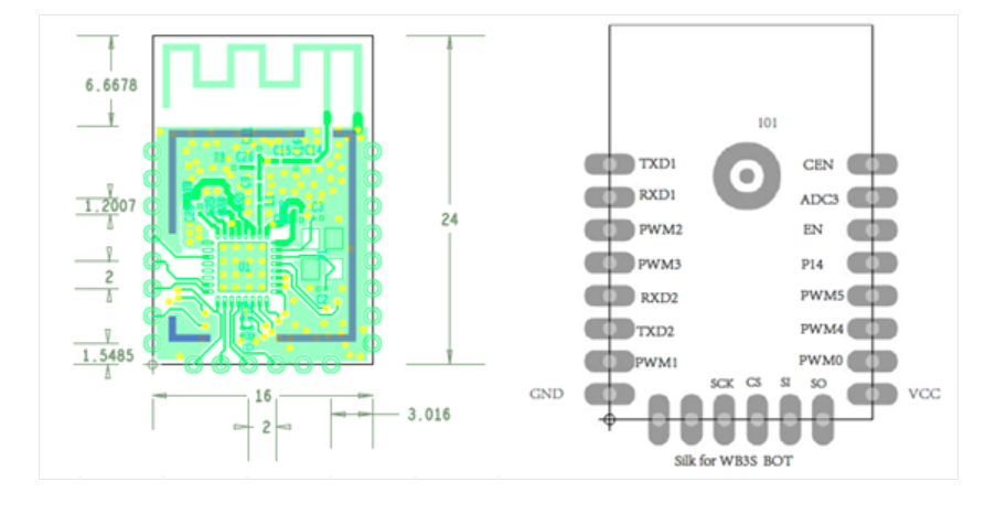

    Reverse engineering of the UART protocol with TH06
    Inside we probably have a microcontroller that communicates with WB3S via UART. This is a fairly common solution in this type of product.
    Let's try to get to know their communication protocol.
    I started by locating the UART pins. That's not a problem, we have the WB3S documentation:

    The picture with the leads is a view from the bottom, so looking from above we have to mirror it in our mind.
    I also tracked the pins on the board:
    Both RX and TX go to unknown microcontroller circuits, which is all as expected.
    I soldered the cable to the TX to see what the WB3S was sending. If we wanted to replace WB3S with another module, e.g. ESP12F, we would also have to send it:
    On the other hand, I led the signal to the RX of the UART adapter.
    Of course, there must also be a common ground, so I also connected GND from the UART adapter.

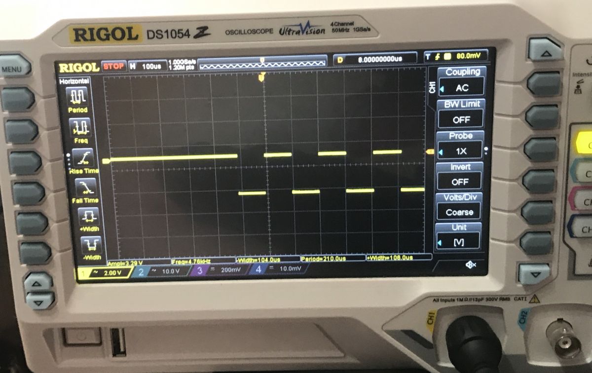

    In order to finally check what the baud is, I used an oscilloscope. All you need is a single trigger and the trigger set appropriately for the oscilloscope to catch the beginning of the signal and we get:
    One bit is 104us ... that's enough information for us. We can calculate baud now.
    (by the way, this Rigol has the possibility to unlock the RS232 debug mode in a certain versions, but I have not tested it yet, but it should be able to automatically read the byte values from UART signal)
    Baud is the number of bits per second.
    1s / 104us = approximately 9600 baud.

    Equipped with the information that the baud is really 9600, I checked the communication again, this time saving the received data to a file:

    I have a new version with the infrared stuff. But I did a big error. I desoldered the WB3S IC before trying to find this info.
    I have flash and solder an ESP12F to the board with tasmote firmware, I am trying to know how protocol works.
    I ahve found several things useful with tasmota firmware:
    I can get (once a minute) this info from the Tuya IC: {"SerialReceived":"55AA0307000865020004000000C54155AA030700086602000400000042BF"}
    These are two strings of information:
    55AA0307000865020004000000C642 and 55AA03070008660200040000003FBC
    55AA0307 - 0008 length - 65 dpId(101) - 02 dataType - 0004 length - 000000C6 value(=198) 42 (checksum) --> 19.8ªC temp
    55AA0307 - 0008 length - 66 dpId(102) - 02 dataType - 0004 length - 0000003F value(=63) BC (checksum) --> 63% humidity
    I dont mind about IR stuff at this moment, but I have a problem.
    I need to know which is the command that the WIFI MODULE sends to the TUYA IC to update DATETIME at boot.
    Probably, after booting up, the wifi module sends "something" to tuya IC (tx pin in wb3s) similar to hour time year, ....
    Could you please sniff it?
    I could give you all information about soldering and configuring tasmota firmware to get all data. It will be perfect to collaborate.
    I have only missing tha datetime stuff so the screen will look pretty!!!!
    Thanks a lot

  • #5 20359471
    juan3211
    Posts: 10
    Thanks a lot, after reading your source code, I have sent with tasmota this command, but.... not luck:
    serialsend5 55 AA 00 1C 00 08 01 16 0C 1E 0C 1A 00 05 8F
    (it is supposed to be 2022/12/30 12:28:00 Firday)
    Or may be I am doing something wrong?
    (see attached images, one of them is old, before desoldering WB3S)

    I am not using TUYA (54) in tasmota as configuration module. It gets into a boot loop and reset the configuration. I am just using serial comms with TuyaMCU.
    I have checked about IR, reciever is connected to PWM2 in wb3s (IO5 in esp12f), and emitters are in P14/IO16.

    These pins are now confirmed that works (I am using tasmota firmware, IRrecv gets data, and with IRsend GPIO14 I have managed to change my TV volume ;) )
    Reciever: GPIO5 IRrecv
    Emiter: GPIO14 IRsend
    (in photos you will see some space between ESP12F and PCB, It is intentionally)
    I hope this info is usefull

    Hoping to buy a few of these S09’s to control the air-conditioners in several rooms and report the environmentals as a climate control setup in Home Assistant.
    https://www.aliexpress.com/item/1005005019677684.html
    Aim would be to keep the Beken chips in with OpenBeken as my soldering skills are not good enough to replace with an ESP without likely doing catastrophic damage.
    A worthwhile project or do you think there are too many hurdles to overcome with my limited abilities and the complexity of LCD, Temp/Humidity & IR all in 1 device?
  • #21 20554655

  • #22 20555058
    spin55
    Posts: 209
    Help: 17
    Rate: 42
    I have flashed two S09. You don't need to cut tracks.
    To Backup original firmware:
    python uartprogram backup_S09.bin -d com4 -r -l 0x200000
    To write firmware OpenBeken:
    python uartprogram OpenBK7231T_UA_1.15.599.bin -d com4 -w
    autoexec.bat:
    Code: Bash
    Configuration pins:
    Flash by putting CEN to GND and quickly removing it. You will fail the first time, keep trying. You'll get it if you insist.
    Regards

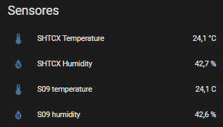

    Nanganator wrote:
    and seems the temp and humidity sensors aren’t terribly accurate
    You can do the temperature and humidity correction in Home Assistant, but you have to wait for the S09 to stabilize. Allow a few hours after you turn it on.
         - unique_id: "obk_S09 _obkFF876F82_temperature"
           name: "S09 temperature"
           state_topic: "obkFF876F82/1/get"
           unit_of_measurement: 'C'
           value_template: "{{ '%0.1f'|format( value | float * 0.1 - 1.3 | round(1) ) }}"
           availability:
            - topic: "obkFF876F82/connected"
           payload_available: "online"
           payload_not_available: "offline"
         - unique_id: "obk_th06_obkFF876F82_humidity"
           name: "S09 humidity"
           state_topic: "obkFF876F82/2/get"
           unit_of_measurement: '%'
           value_template: "{{ value | float + 3.6 | round(1) }}"
           availability:

    I just received my S09 with IR from AliExpress (11.6€) - it looks like an updated version with an AHT20.
    Most notably, the IR transmitter pin has been changed to PWM5/P26.
    Electronic module of a Tuya S09 mainboard with visible integrated circuits, WB3S module, and SMD components. Front view of a PCB with a large LCD display and LEDs arranged around the edges. S09Y-AHT20_V1.0 circuit board showing electronic components and production date. Disassembled S09 IR remote with temperature and humidity sensor, user manual, and original packaging lying on a blue surface.
    It is unfortunate that the unnamed MCU is responsible for much of the functionality - though in some ways this did make getting the device working with custom firmware easier than I expected
    I use ESPHome for my devices, so I used:
    * tuya-cloudcutter with the "Tuya Generic - IR Remote Control with Temperature and Humidity Display" profile to flash the device for the first time
    Here is (the device-specific part of) my ESPHome config:
