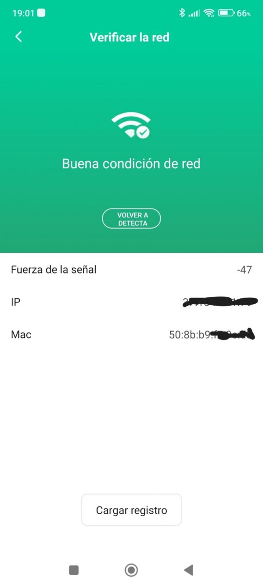

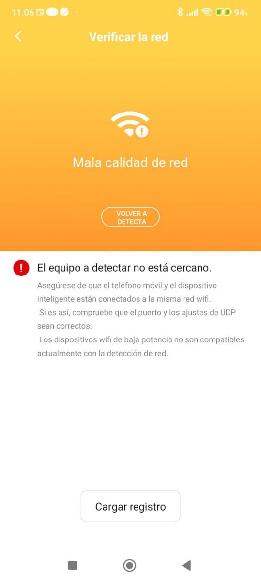

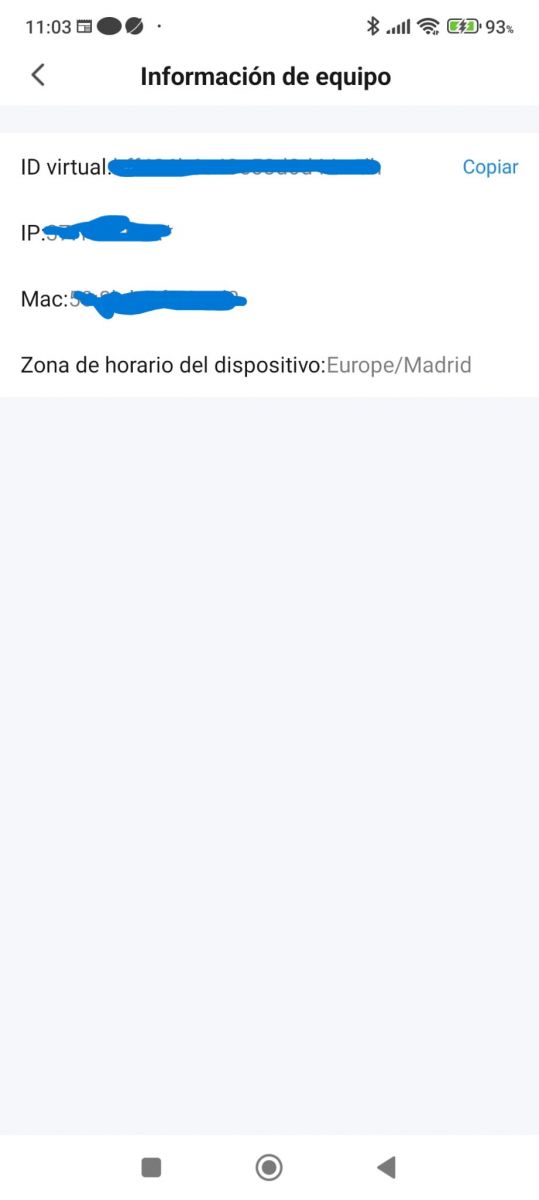

  • The Tuya app shows a 1 hour update interval, and pairing can fail because the device connects only briefly between updates.

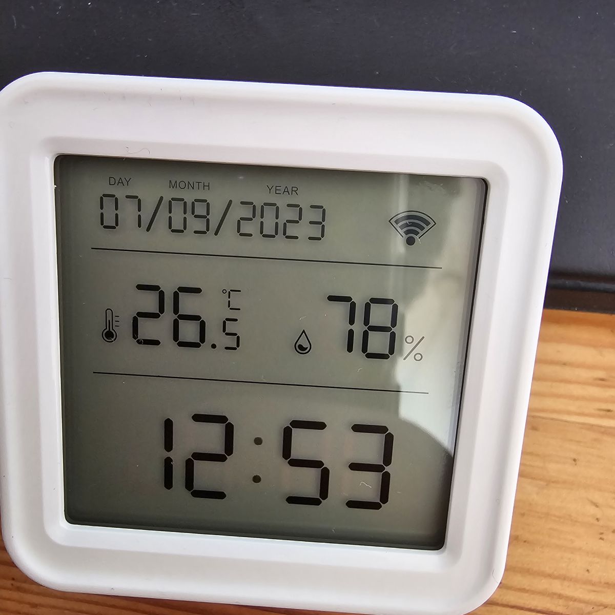

  • Electronic display with date, temperature, humidity, and time

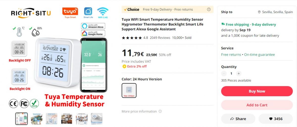

    Aliexpress's link: https://www.aliexpress.com/item/1005005644804864.html
    Aliexpress' ad capture (in case link becomes obsolete):
    Advertisement for Tuya temperature and humidity sensor with display.
    It's advertised for 11,79€ with free shipping, but I managed to get it for 4,49€ as a "Choice" offer:
    Screenshot of an Aliexpress advertisement showing three products at a promotional price.

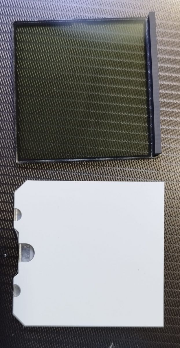

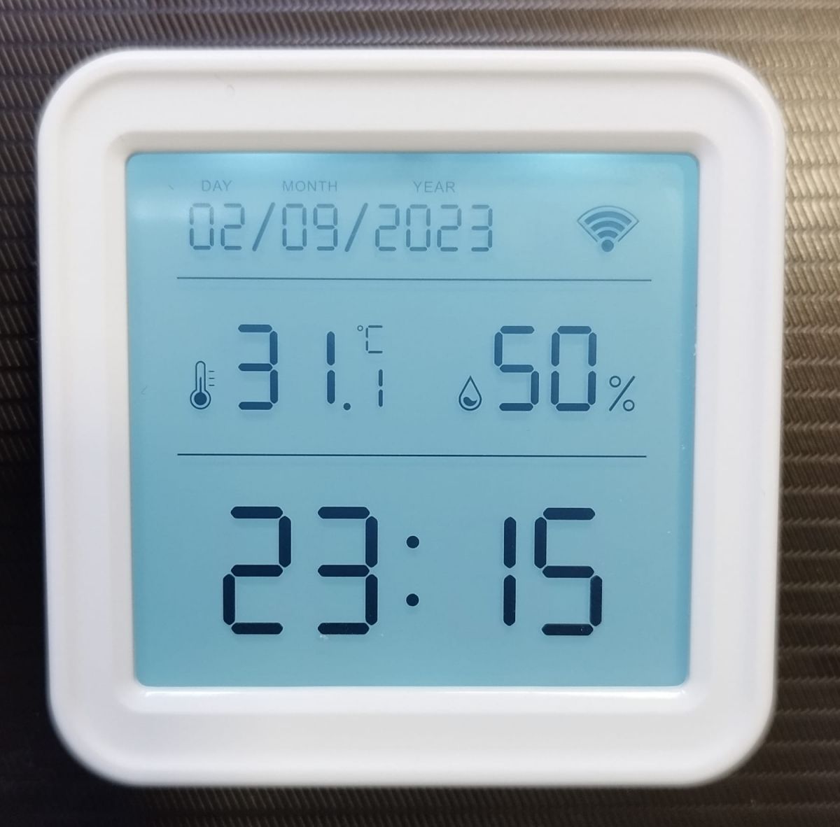

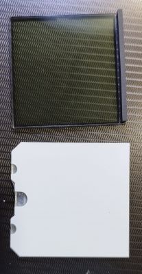

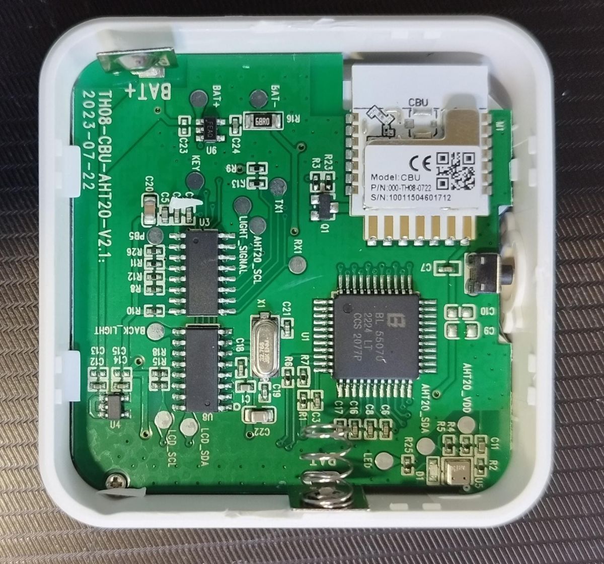

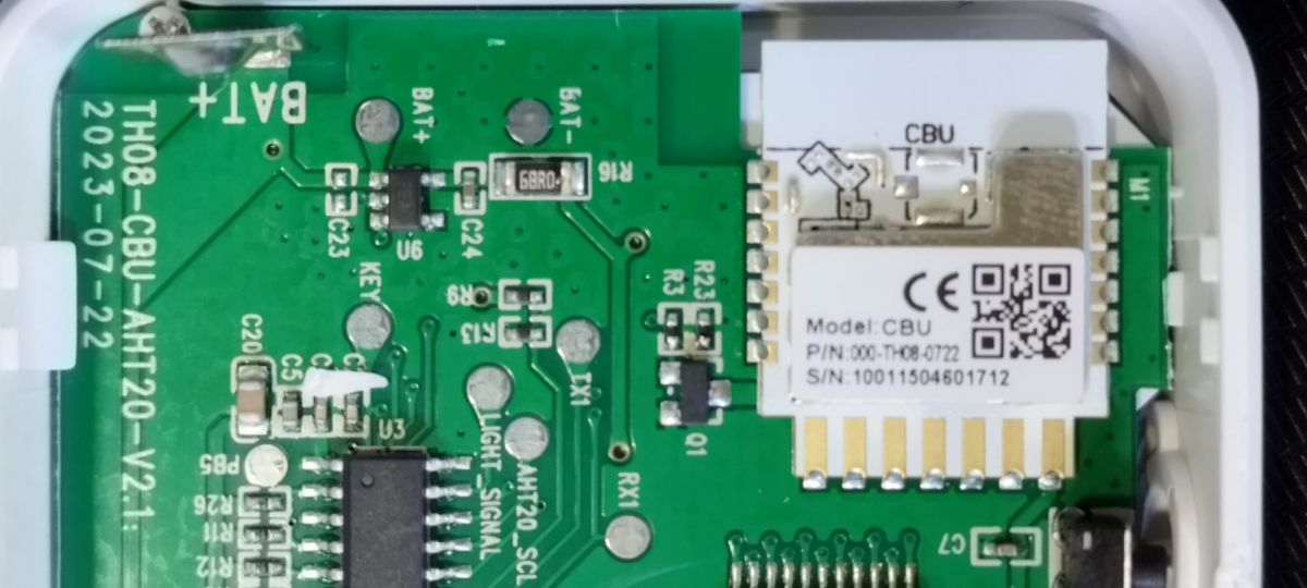

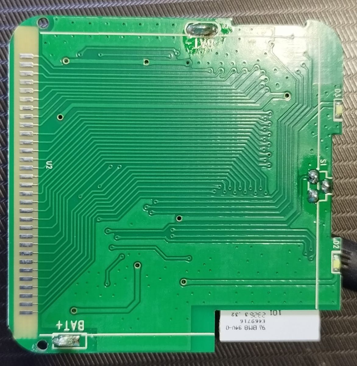

    External and teardown photos:
    Electronic display with date, temperature, humidity, and time Electronic display showing date, temperature, humidity, and time.
    View of the underside of a green printed circuit board with trace markings. Black LCD panel and white component on a dark background.
    Close-up of a PCB with markings and electronic components. Interior of an electronic device with a visible CBU module and PCB markings.
    Electronic module with a PCB labeled TH08-CBU-AHT20-V2 2023/07/22.
    As you can see, the PCB silkscreen states "TH08-CBU-ATH20-V2 2023/07/22"
    I understand:
    - "TH08" is the model so it must be a newer version of TH06, covered here and here. It could be also a close relative of the item described here
    - "CBU" refers to the WiFi module, as it corresponds with the module's silkscreen (datasheet)
    - "ATH20" is the temperature/humidity sensor (product page and datasheet)
    There are also:

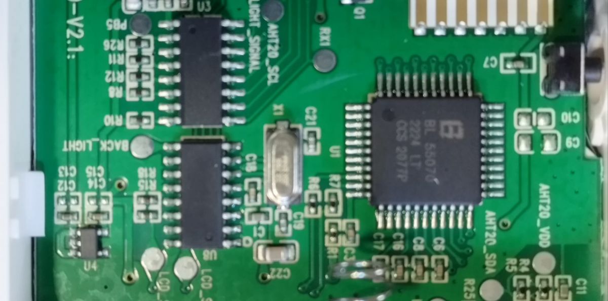

    - A big IC labelled "BL 55070", which is an LCD driver (product page and datasheet)
    - Two 16 pin ICs with the label erased: One of them (U8) has a quartz crystal connected (X1), and three pins are connected to pads labeled "BACK_LIGHT", "LCD_SDA" and "LCD_SCL", so it's clear it controls the display and its backlight, so I think this is a dedicated RTC. Some tracks connect this IC with the previous one (U3), which in turn has pins connected to pads labeled "RX1" and "TX1" (connected to the Wifi Module), "ATH20SDA" (sensor) and "LIGHT_SIGNAL", connected to U8. This one must be the Tuya MCU.
    Among the other components, Q1 controls power to the WiFi module, similar to the other products mentioned above. It's an N-Channel Enhancement Mode MOSFET NP2302FVR-J (datasheet).

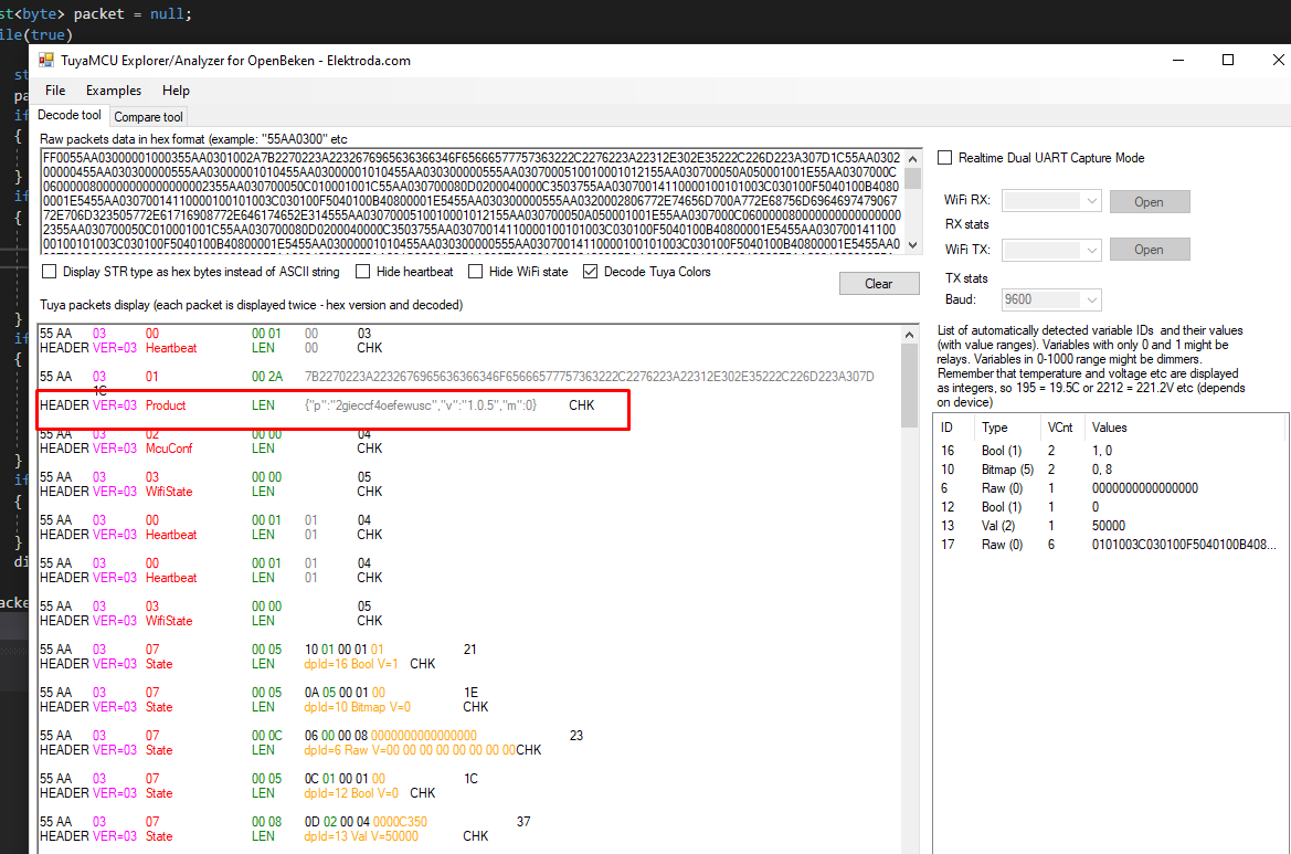

    The full schematic and block diagram are included below and the analysis of traffic in RX1 and TX1 will be posted later (done, see post#33)

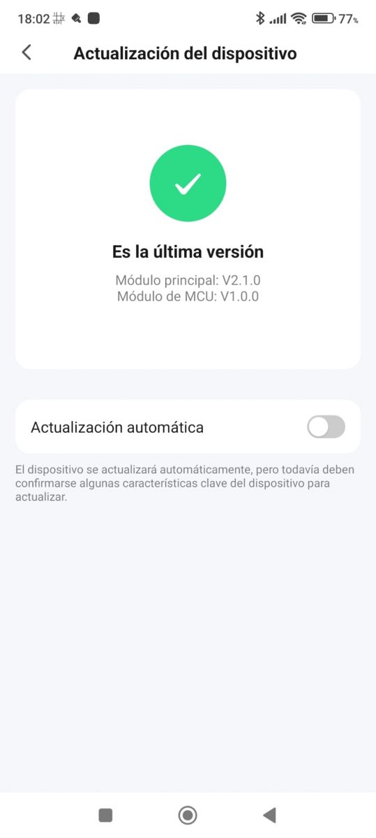

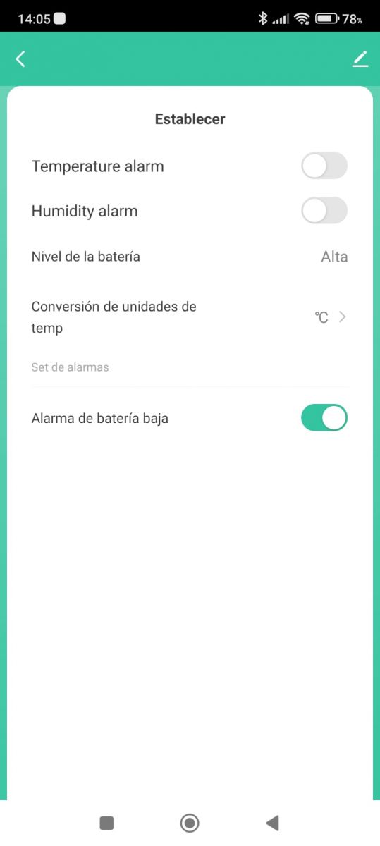

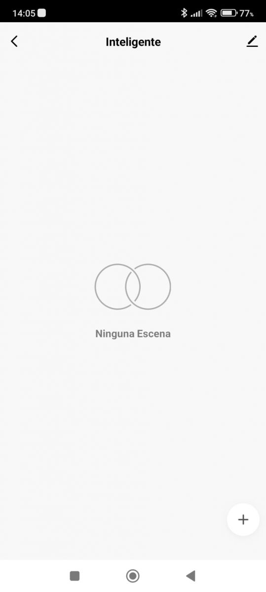

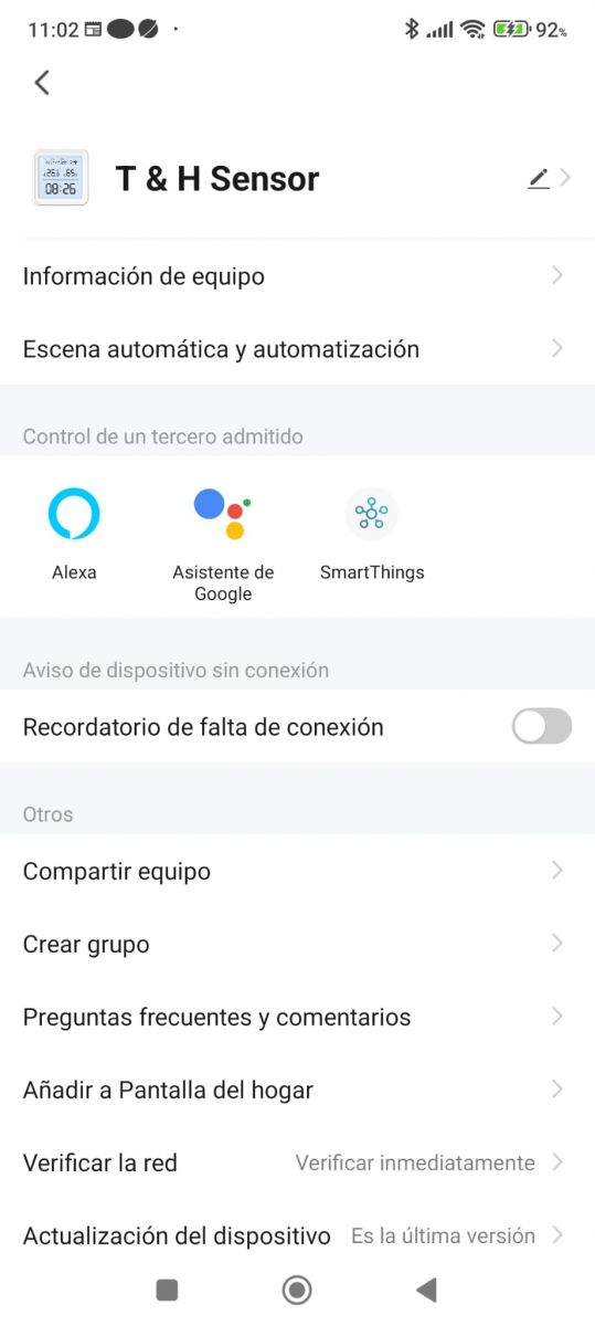

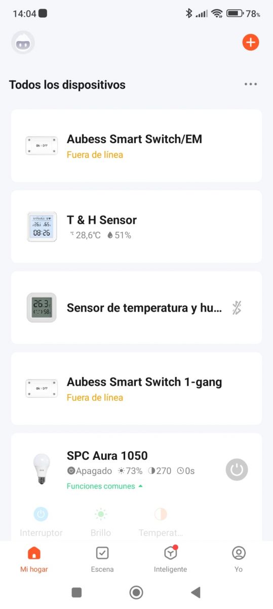

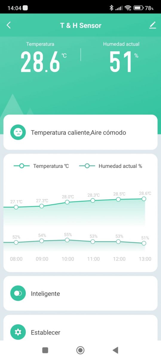

    Tuya App screenshots:
    Screenshot of Tuya app with a list of devices. App interface of a temperature and humidity sensor displaying real-time data. Settings app interface with alarms and battery level A mobile app screenshot with the text Ninguna Escena and an icon of two overlapping circles.Screenshot of a mobile app for the T & H Sensor with various settings options and integration with smart assistants. Screenshot of an app showing device information such as virtual ID, IP, and time zone. Tuya device update screen displaying software versions. Screenshot of an app displaying a message about poor network quality.App screen with Wi-Fi network information, showing a good connection quality.
    The update interval for the graphics is very long (1 hour) and, apparently, can't be changed from the app (its an App related issue; the device updates more frequently, as you can see later in this thread). Related to this, the last screenshot shows an error when trying to connect to the device. I understand it's because the device only connects for a brief time between updates, so you should connect to it in that brief moment to get the info (I've tried just after inserting the batteries without success, so it must be the connection doesn't last enough). After powering the module directly to be able to read it with BK7231flasher, I could complete this screen, so it's attached after the one with the error.

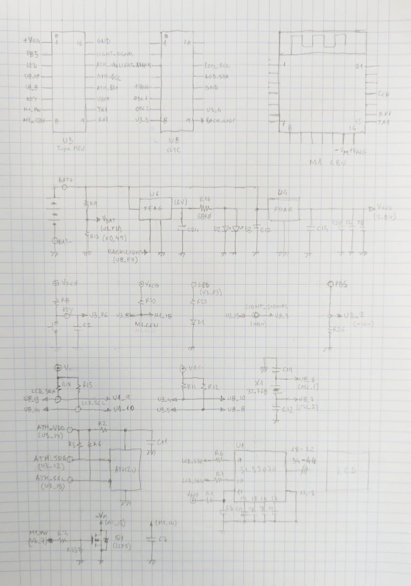

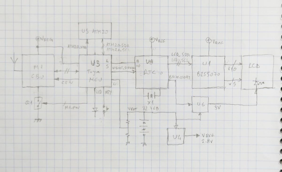

    Schematic:
    Hand-drawn electronic schematic on graph paper with labeled components.
    Block Diagram:
    Sketch of a block diagram of an electronic device with various components.
    After drawing this, it seems clear U3 is the main MCU, connected to CBU module via RX1 and TX1, to the key, to the sensor via I2C, to the LED, to a voltage divider from the battery, and to the other U8 with two wires (another I2C or RX-TX?) and another signal to start the backlight. There's also a mysterious pad (PB5) connected to it.
    U8, with a 32.768 kHz oscillator, is probably an RTC, controls the LCD via I2C to U1 and also the duration of the backlight, and is programmed/read by U3 via a two-wire interface.
    As stated above, Q1 is a mosfet controlling power to the WiFi module, switching on or off the connection to ground.
    Finally, U4 is the main voltage regulator (2,8 volts) feeding all components except the backlight, which is fed by U6 (3 volts) that is turned on or off by pin 9 of the RTC.

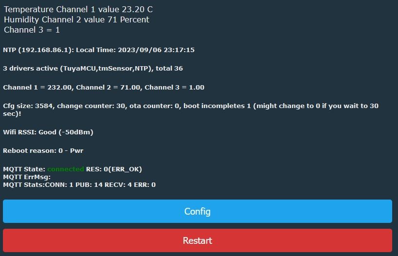

    Hi, I just happened to unpack, disassemble and flash the same device today! I was about to create a post for it, but then you have been already doing this job, thank you! Maybe we can work together to get this sensor working properly!
    What I found so far is:
    - OpenBK can be flashed without desoldering or cutting traces
    - configuration of temperature and humidity can be used as with other known TuyaMCU sensors, the drivers work here for battery, humidity and temperature
    - I used startup commands/autoexec.bat with following input:
    startDriver TuyaMCU
    startDriver tmSensor
    startDriver NTP
    ntp_setServer xxx.xxx.xxx.xxx // put the IP address of your preferred NTP server
    ntp_timeZoneOfs 2
    setChannelType 1 temperature_div10
    setChannelType 2 Humidity
    setChannelType 3 ReadOnly
    linkTuyaMCUOutputToChannel 3 val 3
    I get correct data for T/H values, battery value between 1 and 3, and also OpenBK pulls correct date/time from NTP server.
    Screenshot of a device interface displaying temperature, humidity, and other system data.

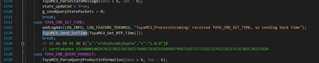

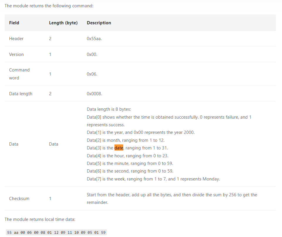

    What doesn't work: get the correct date/time on the device's display

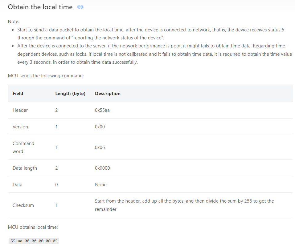

    Info:TuyaMCU:TUYAMCU received: 55 AA 00 02 00 00 01
    Info:TuyaMCU:TuyaMCU_ProcessIncoming[ver=0]: processing command 2 (MCUconf) with 7 bytes
    Info:TuyaMCU:TuyaMCU_ProcessIncoming: TUYA_CMD_MCU_CONF, TODO!

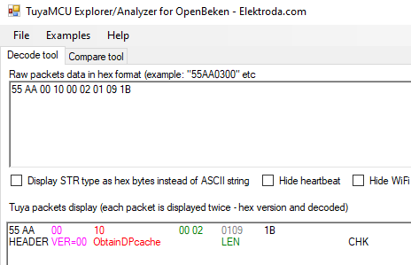

    Info:TuyaMCU:TUYAMCU received: 55 AA 00 10 00 02 01 09 1B
    Info:TuyaMCU:TuyaMCU_ProcessIncoming[ver=0]: processing command 16 (Unknown) with 9 bytes

    OpenBeken sends time only when it's requested:
    Screenshot of a code snippet related to time setting in OpenBeken.
    I can't see :
    TuyaMCU_ProcessIncoming: received TUYA_CMD_SET_TIME, so sending back time
    in your log.
    That brings the question - when should we send the time? When is time sent on original firmware?

    It seems that 0x10 (decimal 16) is ObtainDPCache:
    Screenshot of the TuyaMCU Explorer/Analyzer program showing a raw data packet in hexadecimal format.
    Here are the docs:
    https://developer.tuya.com/en/docs/iot/tuyacl...niversalserialaccessprotocol?id=K95afs9h4tjjh
    Interestingly enough there is a section called Obtain the local time:
    Command table for obtaining local time by MCU
    Table showing the command structure and local time data returned by the module.
    It seems we have MCU sending 55 aa 00 06 00 00 05 here! So it's not SetDP but ObtainLocalTime.
    Added after 8 [minutes]:
    I have tried to add 0x06 packet type handling:
    https://github.com/openshwprojects/OpenBK7231...mmit/7a1e68363548e00ee82ce4f52ec8e3e5c3ab63fe
    but I haven't tested it yet

  • Suspected RTC chip and two-wire display interface
    #8 20724124
    morgan_flint
    Posts: 251
    Rate: 63
    Hello again,
    I've just updated the first post with some corrections and more information (schematic), and I see you've been making making progress!!
    Time to read them in detail and see if I can add something else...
    Thank you!

    auntlydia wrote:
    It would be interesting to find out how the device pulls date/time from firmware and sends it to the display!
    As I said in the comments to the schematic, I suspect U8 is a dedicated RTC that controls the display and the main MCU (U3) program/read it via a two wire interface (probably I2C, as it has pull-ups, but could be also serial).
    From the photos, I'm afraid in TH06 the display was controlled directly from the MCU, but this does not necessarily have to affect the protocol between MCU and module.
  • #9 20724169
    Posts: 14770
    Rate: 12913
    The display is controlled via MCU, that's why it's hard to just remove MCU and do everything in OpenBeken, although IMHO it would be the preferred way. TuyaMCU complicates lots of things.
  • New firmware works and device is fully functional
    #10 20724329
    auntlydia
    Posts: 70
    Rate: 15
    >>20724020
    Good news! It works with the new version! Good job, thank you so much!
    Look at the beautifully working sensor now:
    Digital display of a sensor showing the date, temperature, humidity, and time.
    And here we can see what happens in firmware log:

    As you haven't changed anything in this sense, I imagine the report time is still one hour, which I find too long. In the Tuya App there's no option to reduce it (as, for example, this device has. Apparently, that device also stored intermediate measurements, which were reported to the App once every 120 min (which could be reduced), but this one doesn't seem to have this ability, just reports one value per hour...
    Is there any command in the Tuya protocol to change the polling time? If this is the case, we could try to see if it's implemented in the MCU's firmware

    I checked Home Assistant history and I get an update of sensor data every ~17 minutes as standard, even without change of temperature or humidty. As soon as there is a change in temperature or humidity, device "wakes up" and data is transfered. I think this is quite a good condition already.
    I also enabled flags 10 and 19, but I don't think they affect these intervals.
    Maybe you can try to flash OpenBK and set it up with the suggested commands in autoexec.bat and have a look how often your device updates the data? I assume it would show the same behaviour as mine, as we seem to have the same model.

  • Check Tuya wake interval and capture UART data
    #17 20724405
    Posts: 14770
    Rate: 12913
    Generic teardowns section is only for non-iot teardowns, and smart home is for IoT topics and teardowns.
    As I said, check if there is an option to set that wake up period in Tuya app, and if it's available, then capture the UART data.
    I've also read somewhere that on some devices you can short button so it's always pressed and it will report more often, but I think it was in regard to Aqara Zigbee products.
    Alternative would be to figure out LCD driver protocol, remove the MCU and connect everything to BK7231, but that would be a very hard task.

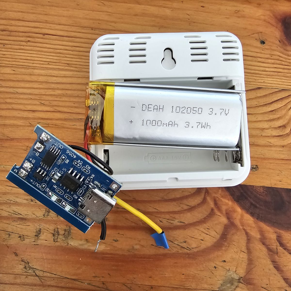

  • Suggesting a LiPo mod with USB charging module
    #19 20724416
    auntlydia
    Posts: 70
    Rate: 15
    haha, I have played with thought about Lipo-mod as well! And we could squeeze in a USB-charge module, but we would need to cut the battery plastic housing to make some space. Else I totally agree, I think compared to many other TH sensors with display it is a very fine one!
    Let us know what update intervals you get, I am curious! It could even be that same models have slightly different internal programming.

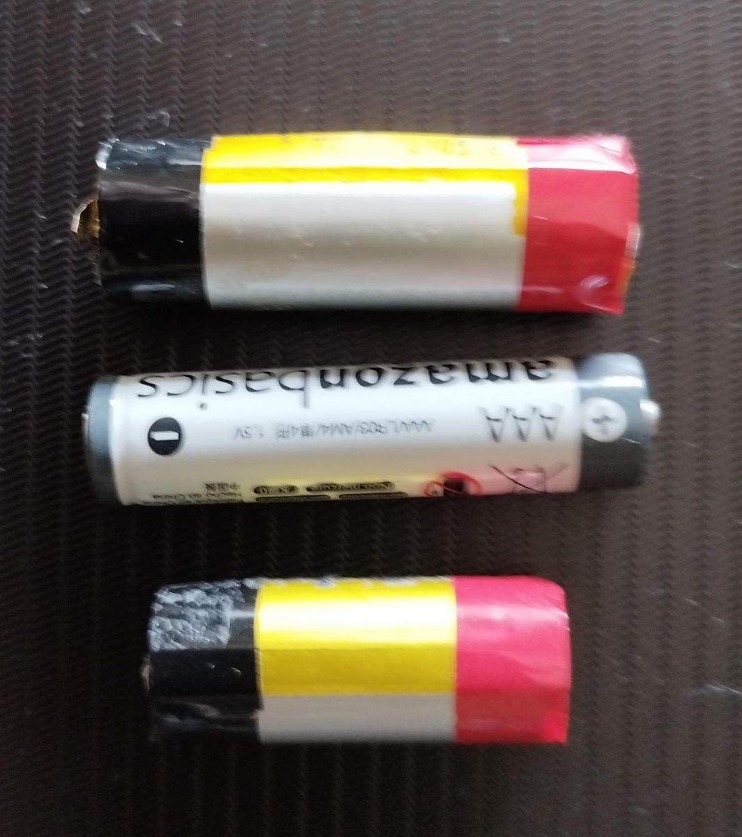

  • LiPo AAA replacements need thicker battery bay
    I already checked it, as you can see in the screenshots at the first post, it seems that option is not available, unfortunately.
    Totally agree... such an effort is not worth it, and probably this design with a dedicated RTC (U8) is better in terms of low power consumption. Another possibility would be to reverse-engineer the communication protocol between MCU (U3) and RTC (U8), but again, complicated and worse in terms of power consumption, I think.
    Added after 7 [minutes]:
    I was considering using LiPo batteries recovered from electronic cigarettes, which are very similar in size to AAAs but, unfortunately, they are a bit thicker:
    Comparison of LiPo and AAA battery sizes.

  • USB-C power mod with 5V to 4.2V stepdown
    #22 20724429
    auntlydia
    Posts: 70
    Rate: 15
    I had flat lipos in mind, such as this one, including China cheap charging module with USB-C port:
    Charging module with USB-C port and flat battery shown side by side.
    anyway, the AAA option works fine too, I use rechargeable 1,2V batteries and will see how long they last...
    Edit: Actually, for this device it would be even worth to do a USB direct power mod, which could be done by simple USB-C female connector board and a 5V-->4.2V stepdown converter.. for long-term usage it might be annoying to swap batteries or charge.
    I've been doing some tests without flashing OBK yet, and mine doesn't seem to behave like this, as even if I heat the sensor on purpose, the display doesn't change unless I power cycle the device (!).
    Can you still check your MCU's FW version? Mine is 1.0 and, as this product is so young (PCB silkscreen states 22/07/2023) it may well have had some teething problems, corrected with a new MCU FW version. If that is the case, I think I should update MCU's FW before flashing OBK, as I don't now if OBK allows updating MCU's FW.
    Here's the Tuya Screen with FW versions:
  • 2-minute update cycle after temperature or humidity change

  • #25 20724827
    Posts: 14770
    Rate: 12913
    I may be wrong, but isn't the MCU version reported via UART at the beginning of TuyaMCU communication?
    See example capture:
    Screenshot of TuyaMCU Explorer showing packet communication analysis.

    #28 20725414
    morgan_flint
    Posts: 251
    Rate: 63
    auntlydia wrote:
    In openbk, I found that button press results in connecting to WiFi and updating current value, regardless of changes or not. so it kinda does everything we need.
    That would be perfect but, as this behavior corresponds to MCU and not OBK, I've tried it again; it seemed to work just once but the following tries (heating and cooling the sensor in between) didn't seem to work, probably transmits data, but the same as in the display, that doesn't change... now I'm completely clueless.
    I'll continue testing and I'll try to sniff data. In the worst case, we can always use a power cycle to force it to send current values. It would be still better if we could identify the reset pin of the MCU.
    I've checked now that it has pin 8 pulled up by R10 and connected to the WiFi module's pin 18 (CEN or reset, I hadn't identified this before). So, thinking it could be a reset pin, I've tried pulling it down with a relatively low value resistor to see if it causes a reset, but pin voltage stays high, so it's clear it's not the reset pin, but an output pin meant to reset the module from the MCU.
    I have also taken the opportunity to look again at PB5 and LIGHT_SIGNAL; I still can't find anything connected to the first one but found now that the second one is connected to U8/P3. Probably, it's an active low output signal from the MCU to the RTC to trigger the backlight (I think the RTC controls by itself the time the backlight is on).
    I'll update the schematic in the first post with all this changes
  • No seconds timer limits minute-only updates

  • Measured 2.8 V supply on MCU and U8
    #30 20725533
    morgan_flint
    Posts: 251
    Rate: 63
    I'm not sure about button forcing update, as @auntlydia and I are getting different results (and even myself, from time to time...)
    No, no seconds timer in the display. I really don't think it's worth adding support for BL55070 just for this case. It's a pity U8 has its markings erased (BTW, @auntlydia, Are they also erased in your units?) because it must be an RTC controllable via I2C that would take a lot of hard work from the module, in case we wanted to leave out the Tuya MCU.
    I wanted to connect the serial to USB converters to sniff the communication, but I have another question regarding this: Surprisingly to me, the voltage that feeds the MCU, the CBU, and U8 is not 3.3V as I expected (and even wrote it in the first version of the schematic). I thought it should be 3.3V as is the usual voltage in these devices and is what is specified in the CBU module datasheet.
    But, when I measured it (two different multimeters), I saw it's only 2.8V. I have serial to USB converters both for 5V and 3.3V, but not for 2.8V.
    Do you think it's going to be a problem to use 3.3V while sniffing and/or programming? Also, @auntlydia: Which voltage did you use when you flashed OBK?
