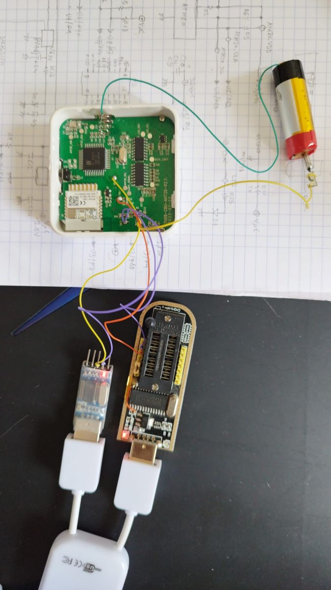

    Also, @auntlydia: Which voltage did you use when you flashed OBK?
    I used standard 3.3V from my UART USB module. From my experience, the modules with BK7231 chips function also with 3.0V or less, but I wouldn't go higher than 3.3V...
    I just connected wires and flashed as usual, very easy, takes only few minutes
    PCB with CBU module and colored wires.

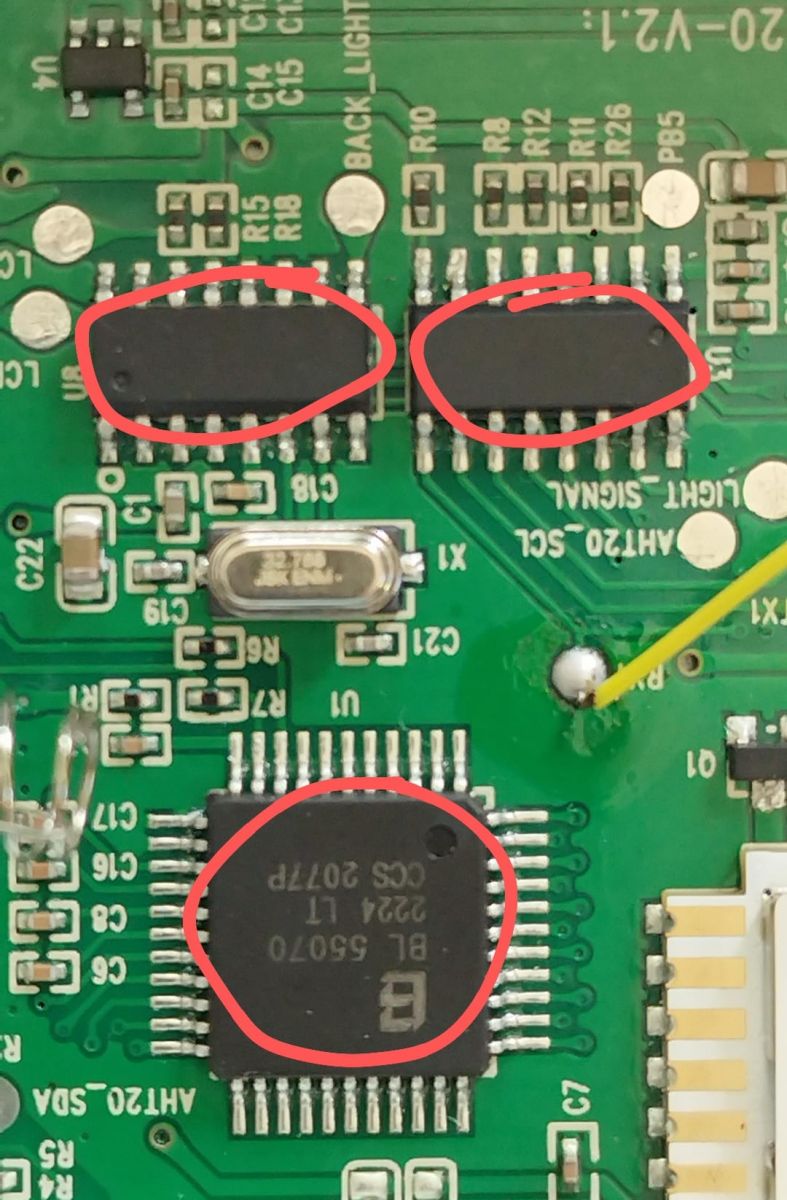

    It's a pity U8 has its markings erased (BTW, @auntlydia, Are they also erased in your units?)
    Do you mean that all the values are reset when the device uses power?
    No, what I was asking is if you can read the physical markings on the ICs; as you can see in the following photo, I can't read anything on U3 and U8 while the marks on U1 are perfectly readable:
    Close-up of a PCB with three integrated circuits, two with unreadable markings and one marked BL 55070.

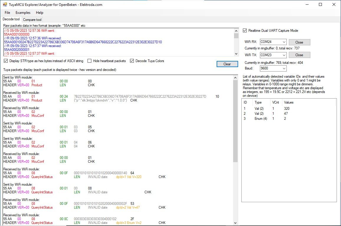

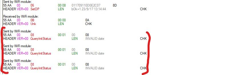

    This is what I got:
    TH08_RX1_S...iffing.txt (7.07 kB)You must be logged in to download this attachment. TH08_TX1_S...iffing.txt (4.32 kB)You must be logged in to download this attachment.

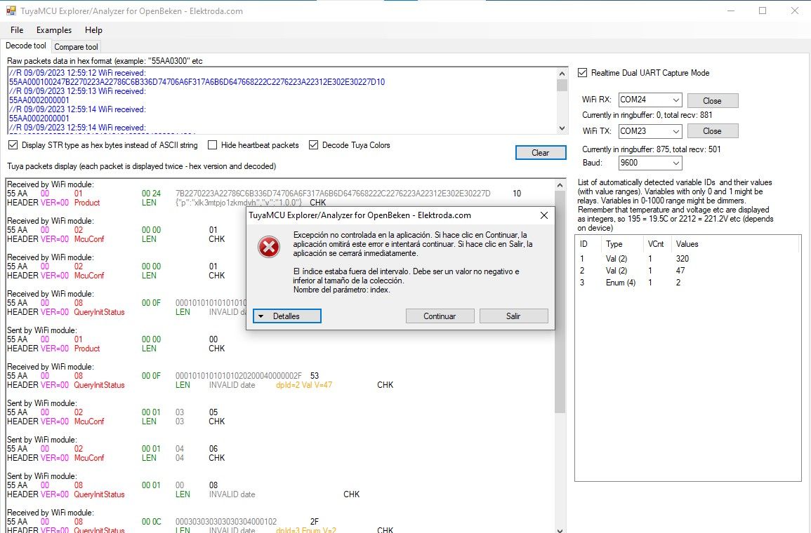

    I've tried to add all the relevant information shown in the display while reading the serial port although, in some of them, I couldn't take notes fast enough, hence the "?" in some information.

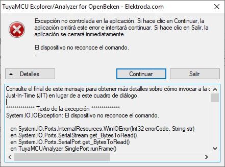

    I also tried TuyaMCU Analyzer, but got some errors:
    Screenshot of TuyaMCU Explorer/Analyzer with an application error.
    Anyway, in this screenshot you can see we have the same FW version:
    Screenshot of the TuyaMCU Explorer/Analyzer software displaying data in hex and text format.
    Let's see if @p.kaczmarek2 can analyze the sniffings and obtain some helpful information... thanks in advance!
    If you need some specific captures, please let me know.

    Can you click "details" on that error and show the stack trace where index is out of array bounds?

    The details of the error are as follows (unfortunately, in Spanish, hope they're still meaningful):

    If I copy-paste the hex codes from the first block of the TXT's of my previous post to TuyaMCU Analycer, the error appears sometimes
  • #36 20728274
    Posts: 14622
    Help: 655
    Rate: 12639
    Thank you, this is helpful.
    Are you the same person who reported it here?
    https://github.com/openshwprojects/TuyaMCUAnalyzer/issues/2
    Fix will be submitted this evening.

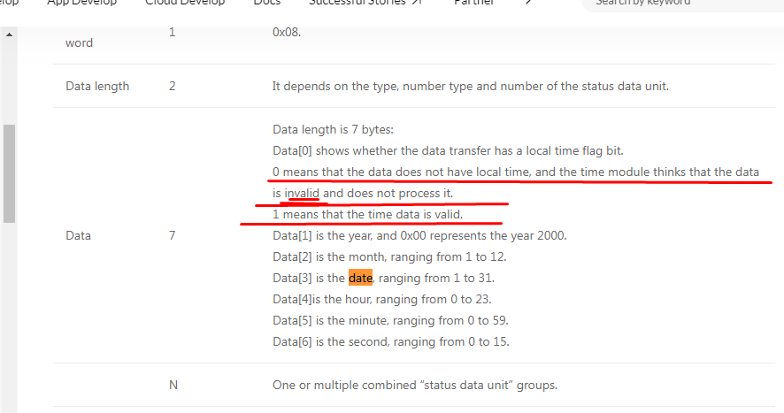

  • #37 20728429
    morgan_flint
    Posts: 251
    Rate: 60
    No, it's not me. Happy to be helpful in any case.
    Did you have time to look at the RX1 and TX1 captures? Any new conclusions from them?
    In the screenshot of TuyaMCU Analyzer, there are several "INVALID date" messages...
  • #38 20728447
    Posts: 14622
    Help: 655
    Rate: 12639
    The messages on your screenshots seems to be normal.
    On your capture, I can see:
    - dpID 1 value 320, which is 32.0 temperature
    - dpID 2 value 47, which is 47% humidity
    - dpID 3 value 2, which is a battery state enumeration
    The "invalid date" is normal, it's just that this protocol has few bytes reserved for date and first byte tells us whether date is included or not:
    Screenshot showing data protocol documentation with information on data length and its significance.
    I see you have also attached files as well. I will check them out later today or tomorrow, as I am not on my main machine right now and the fixed TuyaMCU analyzer is on my main machine.

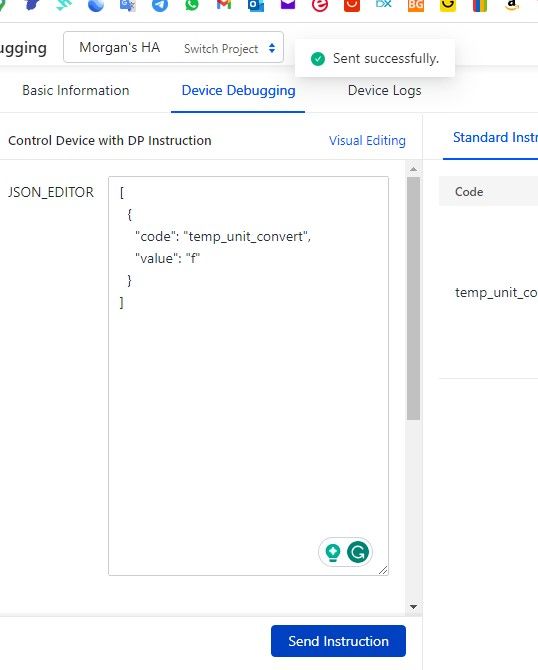

  • #39 20728894
    Posts: 14622
    Help: 655
    Rate: 12639

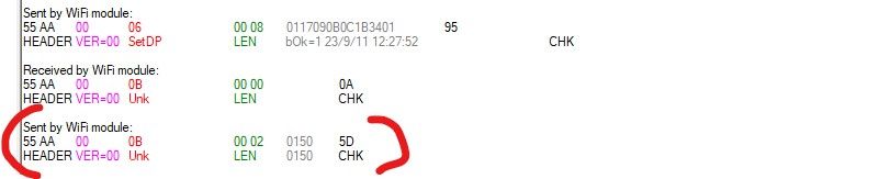

    There is something more in those files:

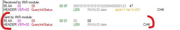

    55 AA	00	08		00 0C	000303030303030904000100	33
    HEADER	VER=00	QueryInitStatus		LEN	INVALID date	dpId=9 Enum V=0		CHK
    dpID 9, type enum, value 0. I don't know what it may be.
    Or... maybe C vs F setting? We could try changing that in the app.
  • #40 20729109

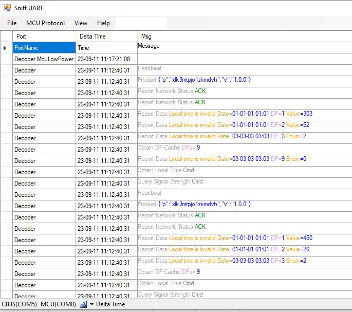

    Hi, did you try https://github.com/MkMunich/SniffUART/tree/V1.0 ?
    This smart tool allows you to sniff both USB serial ports in parallel, if you have 2 USB serial adapters.
    I decoded the first txt file using this tool. Please find it attached.
    You could do me a favour and use TuyaMCU Analyzer to record. Please let me know, if this works.
    BR MK_Munich Screenshot of Sniff UART tool displaying a list of events and messages from serial ports.
    • 230911 1113 Sniff.txt (21.22 KB) You must be logged in to download this attachment.
  • #41 20729291
    morgan_flint
    Posts: 251
    Rate: 60
    I'm attaching the captures with your app. First two blocks are after power on and waiting 2 min. for the first update. Then, change ºC to F in the app and wait for the next update. Finally, changing again to ºC and wait for update.
    BTW, using today's version (V0.5) and the error no longer appears!
    • C_F_RAW.txt (4.56 KB) You must be logged in to download this attachment.
    • C_F_DECODED.txt (7.85 KB) You must be logged in to download this attachment.

    Posts: 14622
    Help: 655
    Rate: 12639
    @morgan_flint this proves that dpID 9 is a C vs F setting. There doesn't seem to be anything more than that. No measurement interval setting.

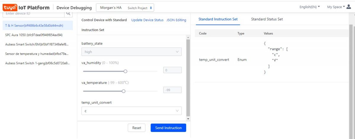

    Ok, it's a pity... Once I flash OBK we could probe the commands for that in similar models; maybe it's programmed in Tuya MCU but the app doesn't use it. Is this possible?

    I also disconnected the USB port with TuyaMCU Explorer opened and it forced the attached error. I understand it's not relevant, as you're not supposed to do that, but just in case it's interesting for @p.kaczmarek2
    Error message in TuyaMCU Explorer/Analyzer for OpenBeken.
    • TuyaMCU Explorer Error.txt (3.28 KB) You must be logged in to download this attachment.
  • #46 20730912
    Posts: 14622
    Help: 655
    Rate: 12639
    Maybe, just maybe, executing a tuyaMcu_sendQueryState command may cause more dpIDs to be sent, but as far as I know, it would only work on non-battery powered models. So I wouldn't bet on that.

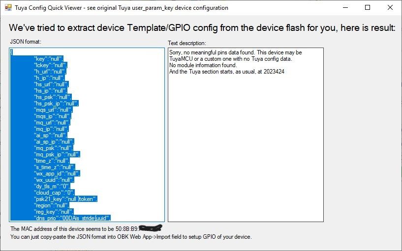

    Ok, finally today I soldered the additional wires and changed the connections to be able to use BK7231flasher and make a backup of the original FW.
    In the beginning, I only used TX1, RX1 (both from the islands at the PCB) and GND (directly from the module, as module's GND is connected to the main GND via Mosfet Q1), and it seemed to work, even without connecting 3.3V or the battery, presumably taking power from the RX and TX lines (I've read this can happen in other threads here; seems like te developer didn't read this), but the reading halted before completing. So I also soldered a cable to the module's 3.3V pad and fed it from the USB to serial converter. This way, after rebooting the module with the CEN signal, I got a full backup. Curiously, and despite the Q1 thing, the full module got power, the display showed the correct time, etc, just the low battery icon was flashing and sending low battery alarms to Tuya App.
    Considering this, I think it's, I think it's important to read/flash the module about 15-20 seconds after powering it, but not much later than that, to allow the TuyaMCU to start and end initial communication with the module, but not give enough time for the next cycle to happen (about 2 minutes after that). This way, the reading/flashing happens while the MCU thinks the module is sleeping.
    At the end of the FW backup, BK7231flasher came up with the following screen:
    Screenshot of Tuya Config Quick Viewer showing device configuration in JSON format.
    The full content of the message in the left window is in the attached TH08_BackupMessage.txt and the full dialog in BK7231flasher main screen is at TH08_BackupDialog.txt, also attached. Finally, I'm also attaching lastRawDecryptedStrings.bin, generated at the end of the backup. I'm not very sure about how to interpret them, but maybe @p.kaczmarek2 can get some new information from them.
    I'm not attaching the full FW as @auntlydia already did it at post #3, but if it's of any help I can also attach it. I masked some info as keys and MAC address for privacy, but if it's relevant I can send it privatelly
    • lastRawDecryptedStrings_.bin (71.86 KB) You must be logged in to download this attachment.
    • TH08_BackupDialog_.txt (14.03 KB) You must be logged in to download this attachment.
    • TH08_BackupMessage_.txt (1.58 KB) You must be logged in to download this attachment.

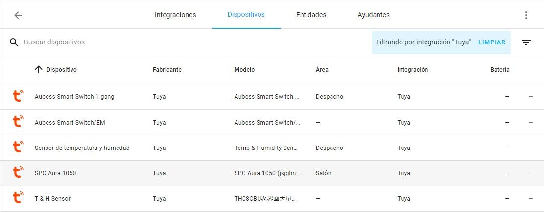

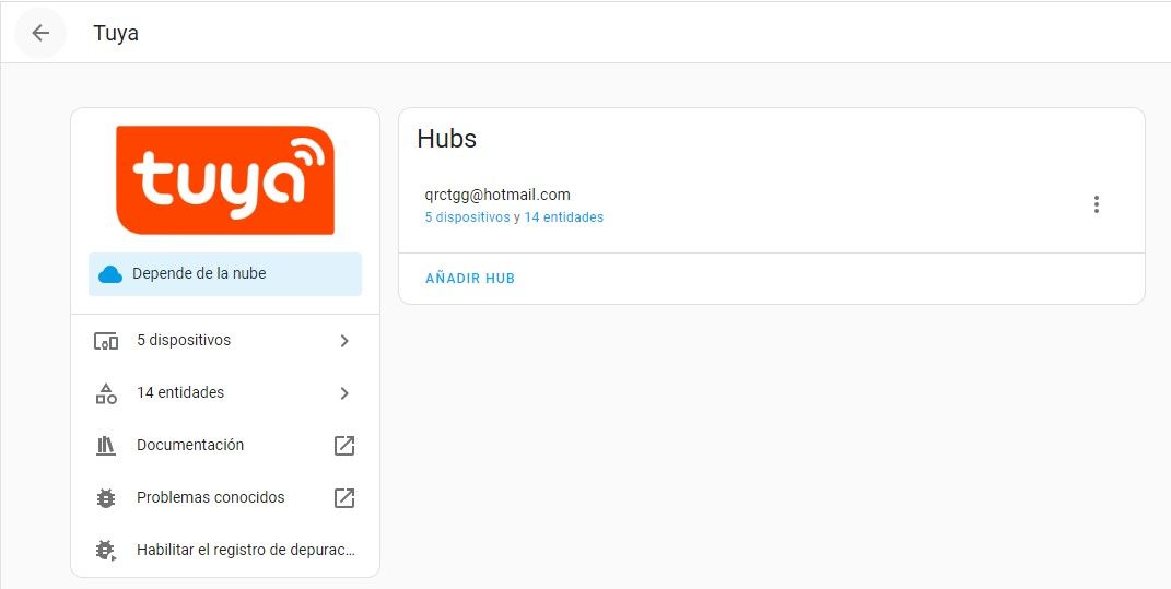

    Hello, MnM1,
    I had already followed those steps (I think all of them) and I can see the device in HA. But still can't find there anything related to changing the update period.
    This is the screenshot of Integrations:
    Screenshot of the Tuya integration interface showing available devices and options.
    This is the screenshot of "Devices" under the previous one:
    Device list in the Tuya integration interface

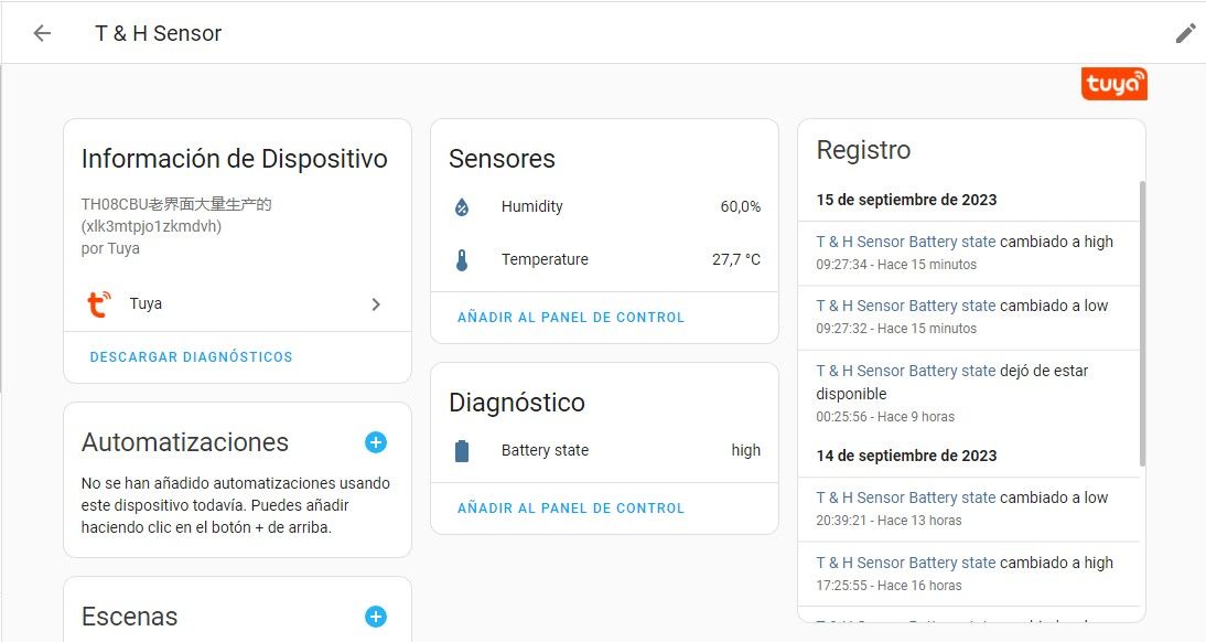

    The device of interest is the last one, and this is the screenshot of its page:
    Screenshot of the T & H sensor integration panel in the Tuya interface.
    Curiously, the Google translation of the Chinese part of the name is "Old interface mass-produced".
    If I hit "descargar diagnósticos" there (download diagnostics), I get the attached txt (sorry for the strange name, but I conserved the original in case it's meaningful). I can't find anything new for me there...
    Does it reveal something to any of you? Is there anywhere else where I can look? (I tried on Tuya Developer's project page, but got lost very soon).
    Thank you!
    EDIT: I navigated a little more in the Tuya's website and found this:
    Tuya IoT platform interface showing settings and sliders for a sensor.
    Apparently, the only instruction that can be sent is related to the ºC - F conversion. Am I right?

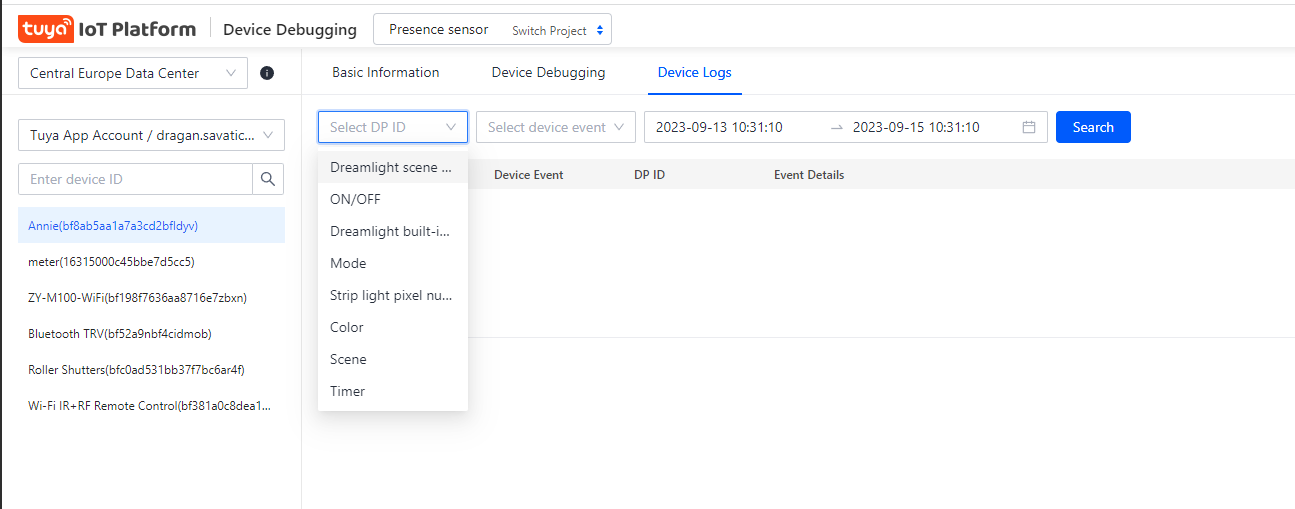

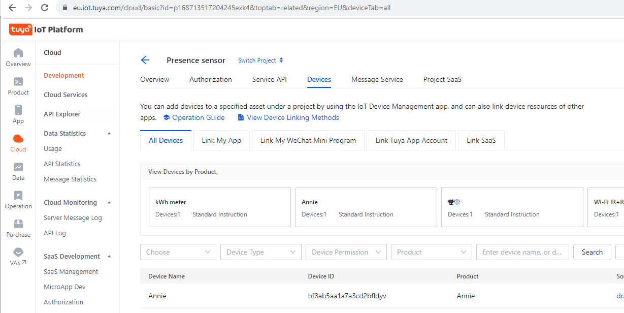

    @morgan_flint
    Once in the iot.tuya.com you can see available dpID's by navigating to Cloud/Development/Devices
    Screenshot of the Tuya IoT platform page with the Devices tab for the Presence sensor.
    Once in there you can select you device and click on Device Logs
    Screenshot of the Tuya IoT Platform with the DP ID selection menu open in the Device Logs tab.
    But if that setting is not available in the phone app it is unlikely that it is avaliable/active on that device.

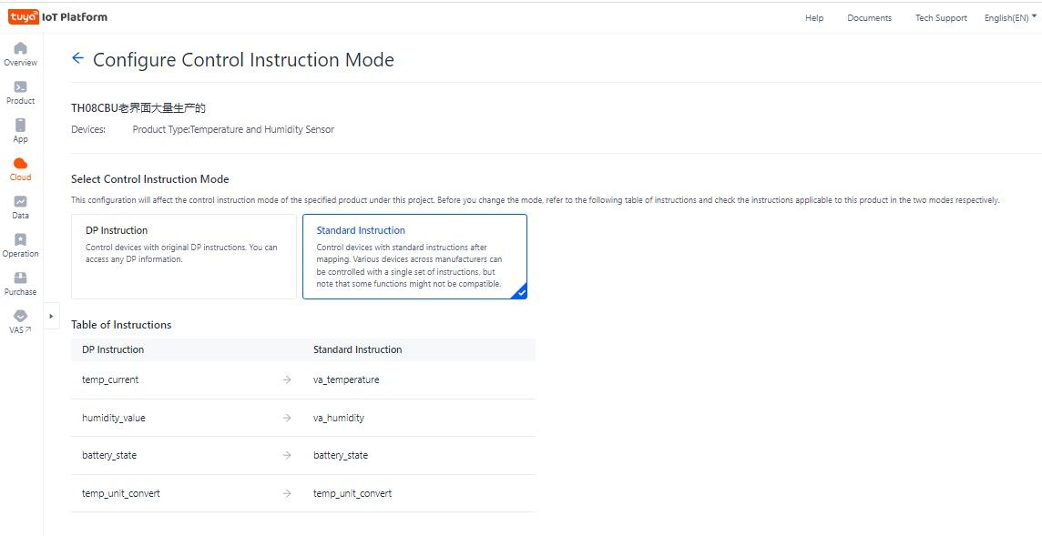

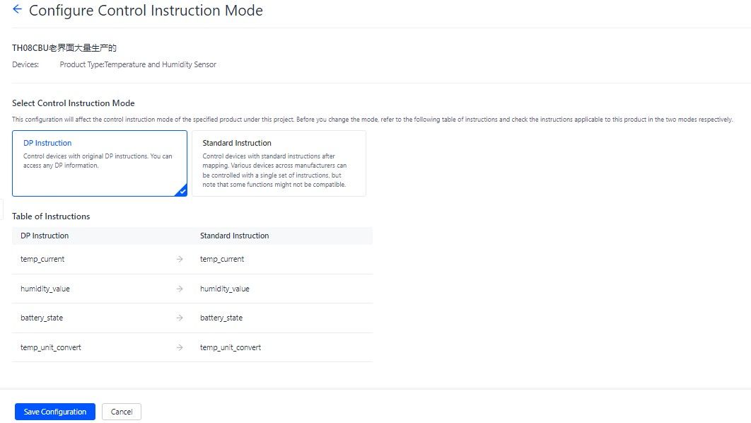

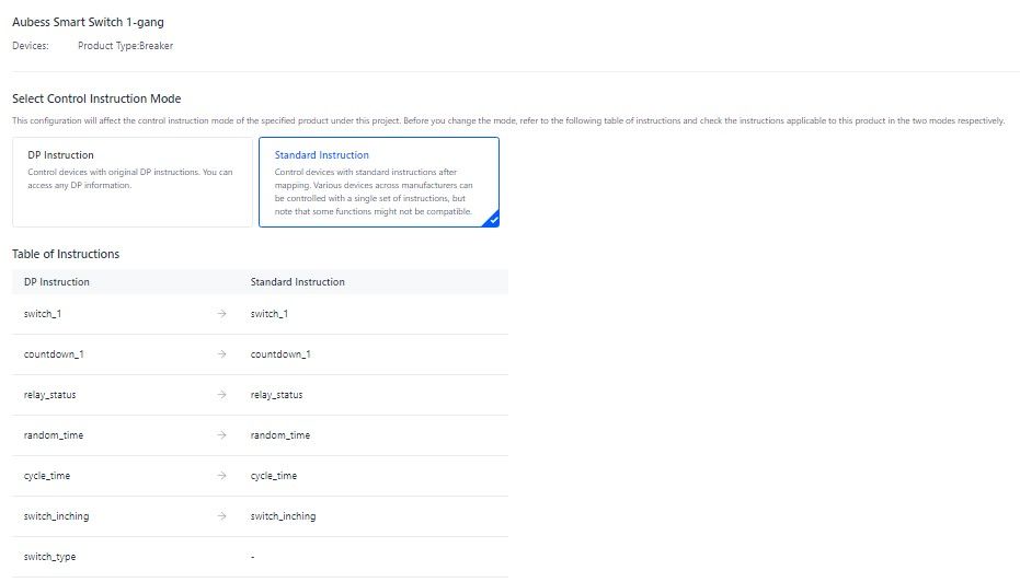

    I've continued looking there and came to this point:
    Screenshot of Tuya IoT Platform showing control instruction mode configuration for a temperature and humidity sensor.
    If I try to change to "DP Instruction" it gives a warning:
    Warning message about changing the control instruction mode to raw DP mode.
    I changed it anyway, but couldn't see anything else:
    Screenshot of control instruction mode configuration for a temperature and humidity sensor, showing DP and Standard instruction options.
    And then I went to another device:
    Configuration of instruction mode for Aubess Smart Switch.
    And could see that, in this one, there's effectively one more entry in the DP side, something that didn't happen with the sensor... So I'm afraid the sensor doesn't have any hidden feature, unless undocumented features don't appear here... What about sending something not listed from here to see what happens?
    Screenshot of a device debugging interface with a JSON editor.

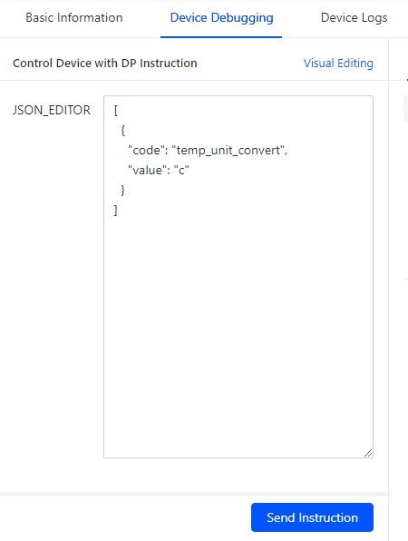

    Ok, most probably, that's the case, but I thought, maybe, as the developers of these products frequently copy each other, some features could exist in the MCU FW, although not used officially, if this FW was an evolution of a previous one...

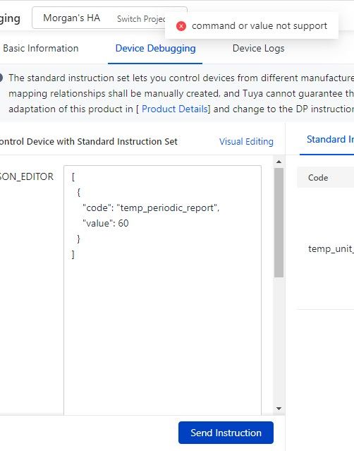

    Do you have the code of the instruction to change the update time in a similar product to give it a try?

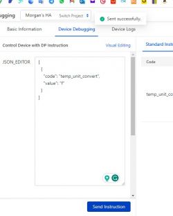

    EDIT: Tried instructions from here and here, but no luck:
    Screenshot of device debugging interface showing the error command or value not support.
    With the standard one, no problem:
    Device debugging interface with JSON instruction for changing temperature unit.

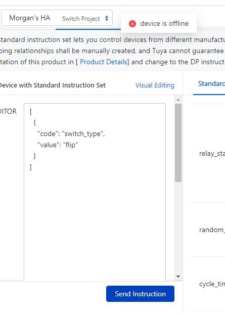

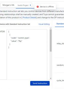

    Just to check, also tried the non-standard function in the switch Values taken from here:
    Screenshot of a user interface for managing an IoT project, showing an device is offline error.
    But gives "offline" and I can't bring it online as it's flashed with OBK now... So no conclusions from this

    If you have flashed the device to OBK the Tuya IoT wont be able to send anything to the device.
    You have to flash Tuya firmware back on it (from your backup if you have one) and then try. But even then I am not sure what these options will do as I have never tried them.

    Changing the subject, I made several more measurements with the original FW: sniffing I2C to ATH20 and LCD, and trying to find out the traffic between U3 and U8.
    From the I2C sniffing, I found that the sensor is polled quite often, every few seconds. This explains why it reacts to (significative?) changes in temperature, powering the module and sending the information even if the two-minute "standard" period hasn't passed. Also, the traffic in LCD_SDA and LCD_SCL has more or less the same frequency. I used rather crude tools for this (Arduino Nano and ESP32), so I don't know if the logs I obtained are useful, but if someone wants to analyze them, I'll post them here.
    I've not been able to obtain any conclusions about the traffic between U3 and U8 (pins 4 and 5 to pins 8 and 10). I've tried supposing it was I2C or RX-TX, both with no results.
    Then, after these experiments, I finally flashed OBK in the TH08. In the beginning, like @auntlydia , I tried to do it without interrupting TX1 and RX1 (I had been able to read a backup like this), and, apparently, the flashing went OK, but for some reason, the device didn't work. The next flash attempts failed so I ended up having to interrupt the connections between U3 and M1 (RX1, TX2, and CEN) to be able to flash it again. I think the first time it worked without interrupting as I managed to do it in the 2 min "refractory period" during which the Tuya MCU thinks the module is powered off (by disconnecting its GND from the main GND with Q1). But, once the original FW was lost, I found that the Tuya MCU insisted on talking with the module for a longer period, so it interfered with the flashing, not only at the RX and TX, but also resetting it (CEN is connected to pin 8 of U3). More on this later.
    Finally, I managed to get it flashed well, connect it to the AP, and set SSID and password. Then, browsed to its IP, launched the web application, used the same autoexec.bat as @auntlydia at post #3, and got confirmation of connection to the NTP server and correct values for temperature and humidity at the initial screen. (IP/index). In the beginning, the device's display didn't show the date/time, but later it did; I'm not sure if this was after configuring MQTT or if this was just a coincidence.
    Channels 1 and 2 are temperature (x10) and humidity, as stated in the autoexec, and Channel 3 (ReadOnly there) seems to be the battery status (1=ok 2=low).
    So everything seems to go well, except for one detail: As I said before, once removed the original FW, the "on" cycle of M1 (the time Q1 is switched on) goes from about 10 seconds to more than one minute. I think this must be because the Tuya MCU is waiting for some kind of confirmation from M1 (something like "successfully connected to WiFi or to the cloud") that the original FW gave bot OBK doesn't, so it keeps activating the module for a longer time and/or resets it via CEN to try to get a connection. Then, after about 1 min, it gives up until the next reconnection time (after 2 min, a change on temp or when pressing the button).
    Could it be like this? In this case, Is it possible to include that confirmation in OBK (Tuya MCU driver)? It would be good, as the longer the module is on, the higher the battery consumption.
    EDIT: I've captured the traffic between the module and the MCU with TuyaMCUAnalyzer, with OBK flashed, and compared it with previous captures with the original FW. I'm attaching two files with the comparisons in RAW and decoded formats. You can see the original FW sent the following message after receiving each of the three messages with the measurements (temperature, humidity, and battery status) from the MCU
    Screenshot of communication between Wi-Fi module and MCU Tuya showing discrepancies in transmitted messages.
    That OBK doesn't send. Also, the end of the traffic is different; the original FW sent to the MCU just one packet:
    Captured communication data between modules.
    While OBK sends 3 packets instead:
    Screenshot showing communication between a Wi-Fi module and MCU with packet analysis and error messages.
    Could this be the cause for the higher WiFi on time with OBK?
    There are also two other differences (in orange in the attached documents), but as they are sent from the MCU, I don't think they are relevant. In case they are necessary, I have the captures in .txt and the comparisons in .xlsx formats.
    • TH08_OBKvsOrigRAW.pdf (398.75 KB) You must be logged in to download this attachment.
    • TH08_OBKvsOrig.pdf (420.72 KB) You must be logged in to download this attachment.
