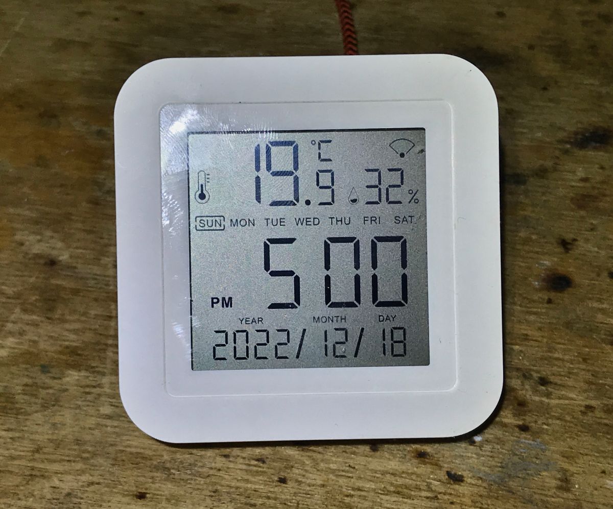

    I will show you how to connect a calendar/thermometer/hygrometer model TH06 with the Home Assistant LCD. This calendar is based on the WB3S/BK7231T WiFi module connected to an additional microcontroller that communicates with the WiFi module via the TuyaMCU protocol. The WiFi module is responsible for providing the microcontroller with the current time from the Internet (obtained via NTP) and for receiving temperature and humidity measurements from it.
    In order to connect to Home Assistant, we will change the BK7231T firmware - we will upload it OpenBeken . At OpenBeken, we will properly configure the TuyaMCU and NTP driver so that it works with the calendar.

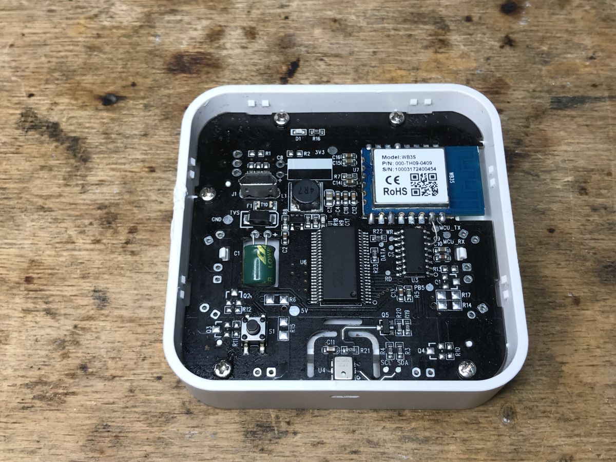

    This calendar, like other devices using TuyaMCU, connects to the microcontroller through the same UART port (TXD1, RXD1) that is used for programming. In order to change the firmware, you need to cut off the paths going to the MCU, then you can normally change the batch through bkWriter 1.60, as in similar topics from the series.
    [BK7231T] LCD calendar/thermometer/hygrometer TH06 WiFi for TuyaMCU - Home Assis
    Photos before the operation and a description of the plate are in the previous topic, previously linked.
    This is what mine looks like after surgery:

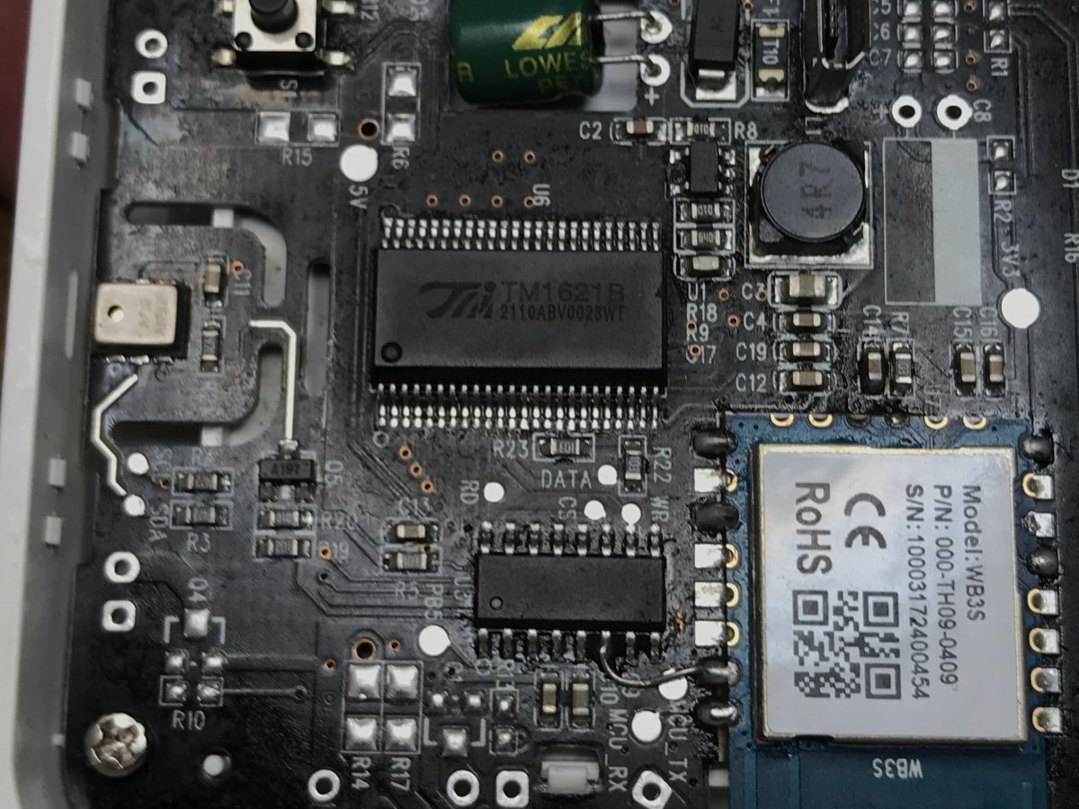

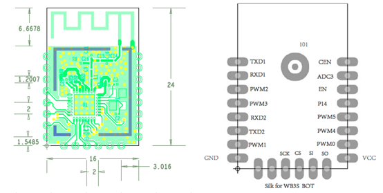

    I did the programming as follows:
    - cut off RX/TX from MCU
    - I connected my USB to UART converter to TXD1 and RXD1, additionally I connected its mass
    - in bkWriter 1.60 I started writing the batch
    - when bkWriter 1.60 was waiting for the module to reboot, I cut off and connected it to the power supply through its USB connector
    - the batch has been uploaded correctly

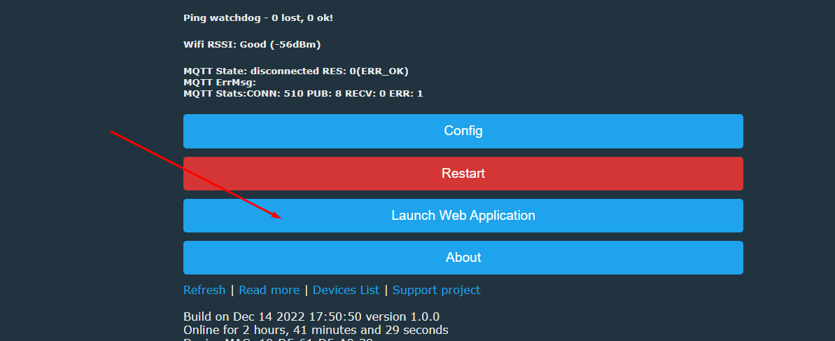

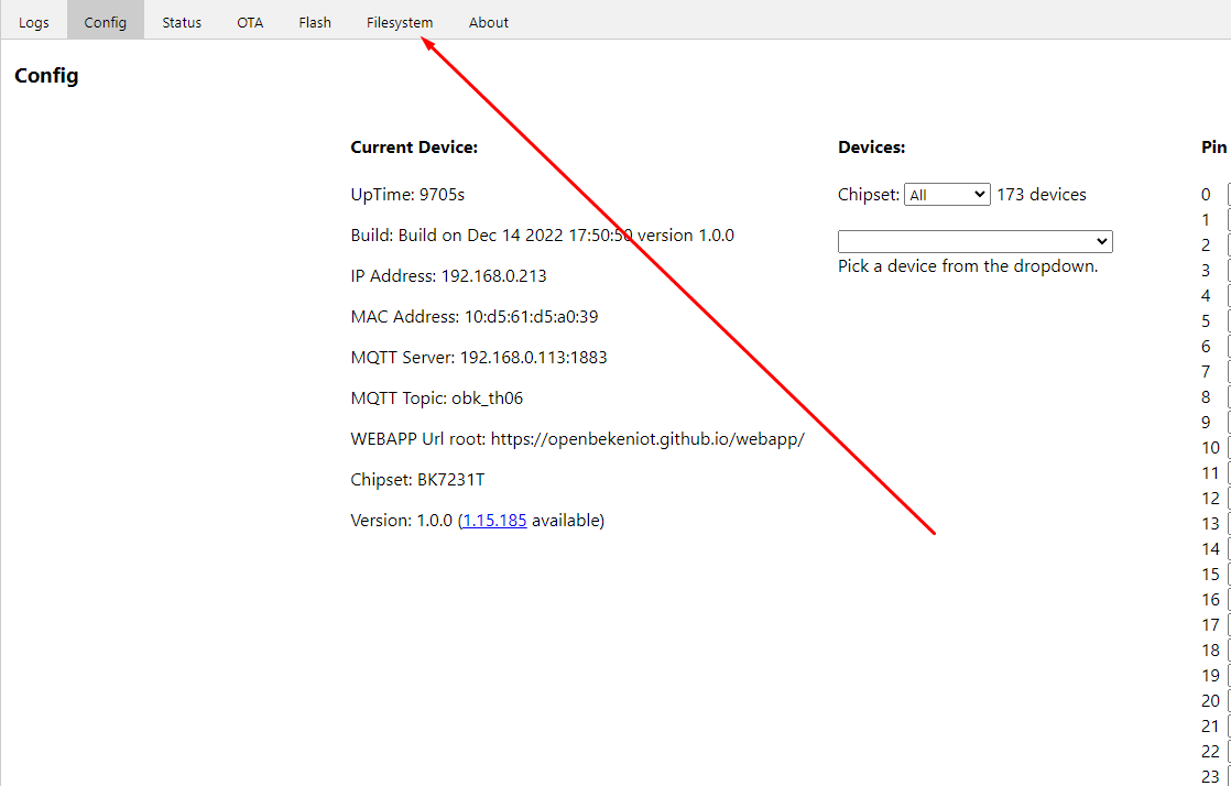

    In OpenBeken, we open the Web Application (the second WWW panel):

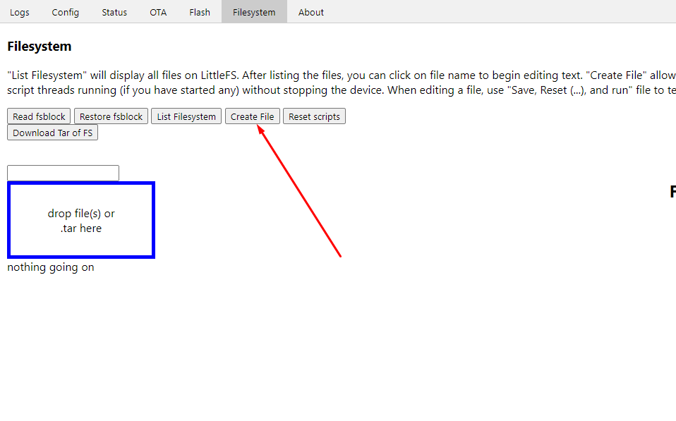

    In it, the FileSystem tab:
    There CreateFile to create autoexec.bat:
    Paste the contents of the script, save:

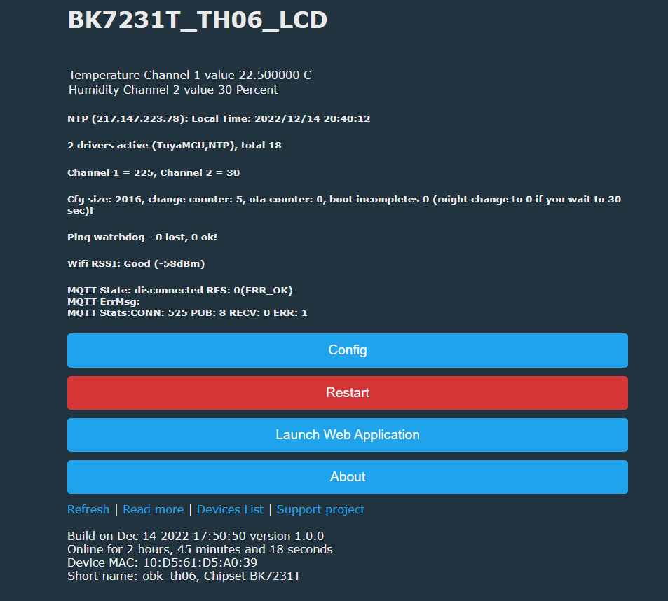

    startDriver TuyaMCU
    startDriver NTP
    // dpID 1 is tempererature div 10
    setChannelType 1 temperature_div10
    // dpID 2 is % humidity
    setChannelType 2 Humidity
    We are rebooting.
    But we will explain the script step by step.
    - startDriver TuyaMCU - starts the TuyaMCU driver
    - startDriver NTP - starts the NTP driver (network time)
    - setChannelType 1 temperature_div10 - sets the type of channel 1 (selected freely) to temperature times 10 (i.e. 23.5C written as 235 integer, as this notation is used by Tuya), thanks to which OpenBeken knows how to display its value on the panel
    - linkTuyaMCUOutputToChannel 1 val 1 - maps dpID from TuyaMCU (variable identifier) 1 to channel 1, value type. In this particular device, dpID 1 is temperature. dpID roles vary by device
    - setChannelType 2 Humidity - sets channel 2 type to humidity
    - linkTuyaMCUOutputToChannel 2 val 2 - as before, here dpID 2 is humidity
    Additionally, you can add - ntp_timeZoneOfs [Number of Hours] - time zone offset.
    After reboot we get:

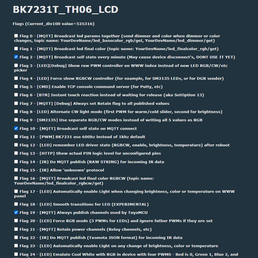

    Before writing Yaml, it is worth enabling additional publishing of MQTT variables, which is disabled by default - that is, periodically publishing full status and publishing full status on connection. In addition, we will enable full publishing of TuyaMCU variables - just as a rule. It's possible that some of these flags will turn on automatically in future versions, but for now it's worth checking to make sure they're checked. In Options->General/Flags:

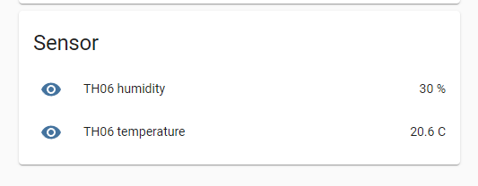

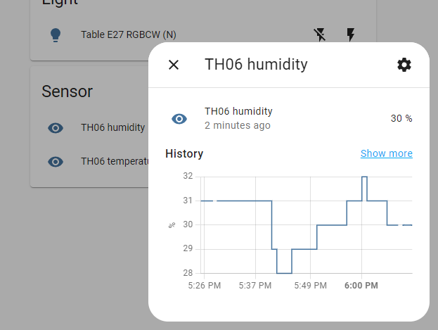

    Then, in Home Assistant, we write the YAML code:
    Code: YAML
    Indexes 1 and 2 here are the indexes of the channels to which we have mapped the TuyaMCU variables. Nothing is "rigid" here - the same procedure allows you to get to other values from TuyaMCU, dimmer, battery value and so on.
    In addition, there is also a correction of the value - replacing the internal representation of the TuyaMCU temperature (an integer, temperature multiplied by 10) to the normal temperature - hence the multiplication by 0.1. Round rounds to one decimal place.
    In this way, we get a full history of measurements in HA:
    Summary
    I like this calendar very much - one of its advantages is that it is powered via USB. No problem with changing the battery.
    The disadvantages of this product include the inability to change the time display to 24-hour mode - that is, we will always have AM/PM.
    In addition, the display is not very clear from certain angles, especially when it is not well lit.

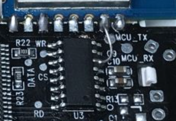

    - you still didn't mention reconnection, you naturally merged them right?
    Jumper from the resistor leg, the picture shows at least one connection:
    And if you don't want to cut it, maybe desolder the entire MCU like here:
    Close-up of a circuit board with a component being desoldered using a soldering tool.
    https://www.youtube.com/watch?v=Yb3zXtBdSnE&ab_channel=Elektrodacom

How do I flash OpenBeken onto the TH06?
  1. Cut RX and TX traces between WB3S and the co-MCU.
  2. Connect a 3.3 V USB-UART to TXD1, RXD1 and GND.
  3. Use bkWriter 1.60 to write OpenBeken, then power-cycle the board [Elektroda, p.kaczmarek2, post #20342890]

How do I publish readings to Home Assistant?
Enable full-status and TuyaMCU MQTT flags in Options→General, then add two MQTT sensors: state_topic: obk_th06/1/get (temperature) with value_template {{ value|float*0.1 }} state_topic: obk_th06/2/get (humidity) [Elektroda, p.kaczmarek2, post #20342890]
Why did my clock reconnect to MQTT every 4 minutes and how do I fix it?
Early OpenBeken builds missed a keep-alive. Upgrade to v1.15.592 or later; one user reported the loop disappeared immediately [Elektroda, spin55, #20504170; #20504226].
Can the LCD show 24-hour time after flashing?
Firmware cannot change the LCD’s hard-wired 12 h/24 h layout. Buy the 24 h hardware version if you need it [Elektroda, Karol966, post #20344782]
