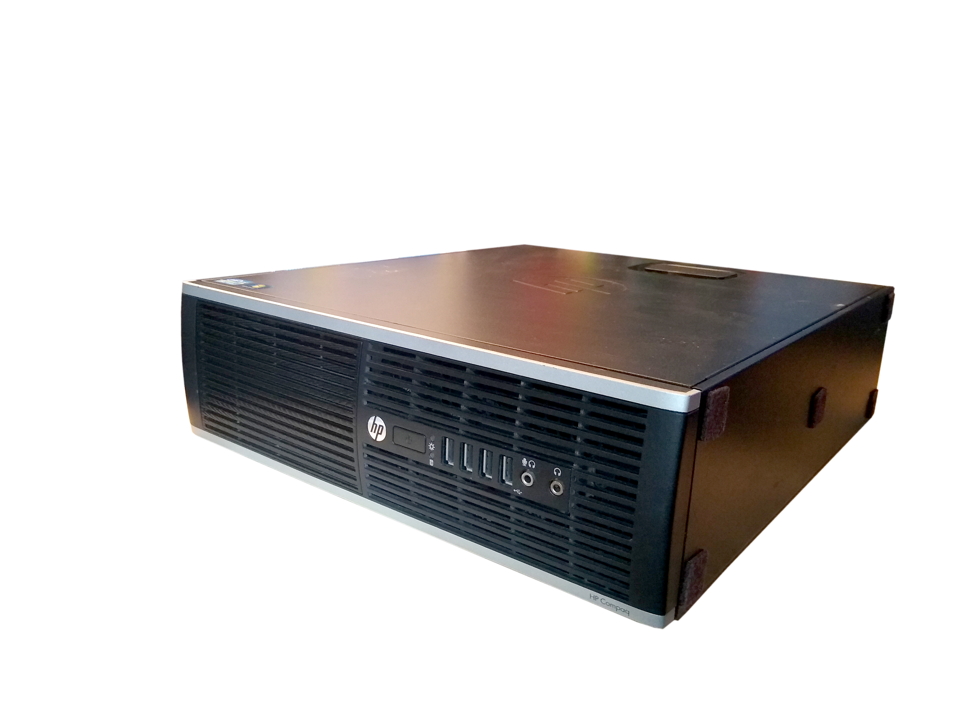

Front view of an HP Elite 8300 SFF office computer.
As we know, people are divided into two types. Those who will do backups and those who already do. I belong to the latter group.
For this purpose, I found a use for an HP Elite 8300 SFF office computer.
The whole thing works with urBackup as software. In order to fit up to three 3.5 inch drives and one 2.5 inch Sata SSD, I had to get rid of the drive rack in the 5.25 and 3.5 bays.
For the platter drives I made a cage out of a plastic ventilation duct, routed power from the motherboard for a small 70mm fan and modified the power cable for the drives.
On the visual side, the change was simple. I got rid of the 5.25 and 3.5 caps.
The hardware side is boring. Possibly a quick photo from the top:

I didn't bother with the lack of dentition as long as the server was behind the couch. Recently, the server took up space under the desk and that meant it was visible (no plugs and just a rectangular indentation in the front of the case). To make matters worse, it was within easy reach of the hands of two future electrode regulars :D .
I had originally planned to design and print the whole front of the case, but laziness got the better of me and it fell to the grille.
HP Elite 8300 SFF office computer with visible front panel.
(Above is a picture of a typical HP Elite 8300)
However, there was a problem - the front is rounded.
Usually, all we had to do was gather the dimensions with a caliper and the subject was settled. In the end, I used calipers (overall dimensions of the indentation in the front of the case, width of the ventilation slots) and ordinary pieces of paper to design the fitted bezel, of course.
I'm already explaining. I saw that the height of the opening was 82.5mm, so I cut a piece of card to this length, applied it to the opening and drew the shape on one side and the other with a pen. The cards were then scanned, straightened and colour processed in Photoshop and then thrown into Blender to model the grille.
