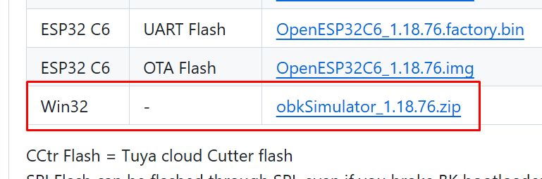

Now let's focus on running Berry in OBK. Currently, there are two options:

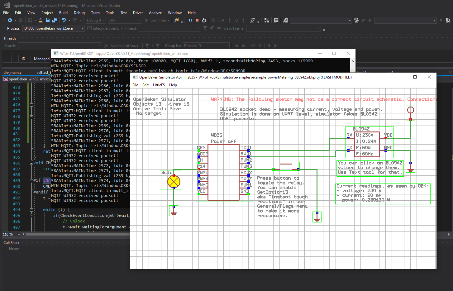

Option 1: you can just use OpenBeken Simulator to try Berry on Windows, just get binaries here: https://github.com/openshwprojects/OpenBK7231T_App/releases
Screenshot with a download link for OBK Simulator for Windows
Option 2: You can use only builds (no toolchain required) to enable Berry for the platform of your choice, follow this tutorial. Keep in mind that on some platforms you might need to disable some other features in order to keep binary size small enough to run. This is because OBK comes by default with most of the features enabled, so each binary has TuyaMCU driver, LED driver, WS2812 driver with animations, and even Tasmota JSON support, and you most likely will not this kind of thing. So, edit obk_config.h to suit your needs. Just remember - for Berry, you need to enable ENABLE_OBK_BERRY define.
Futhermore, the stack sizes may not be adjusted for Berry currently, so you might need to increase them on your own. There is also still room for optimization in Berry code, for example, some event handlers could be more or less delayed to avoid large stack requirement. This is still subject to change in future.
This tutorial will be based on OBK Windows Simulator, so anyone can run it, even with no IoT devices.

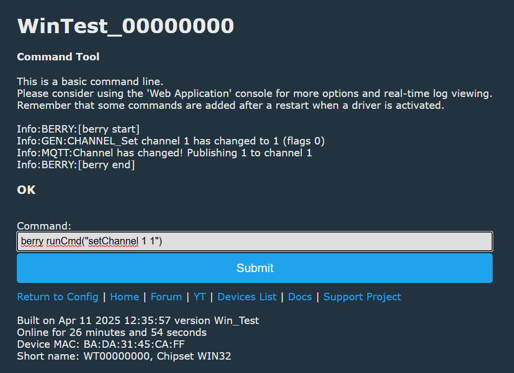

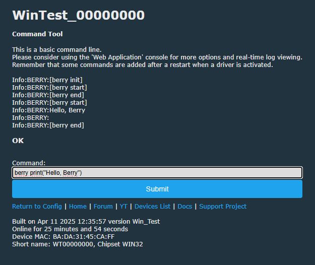

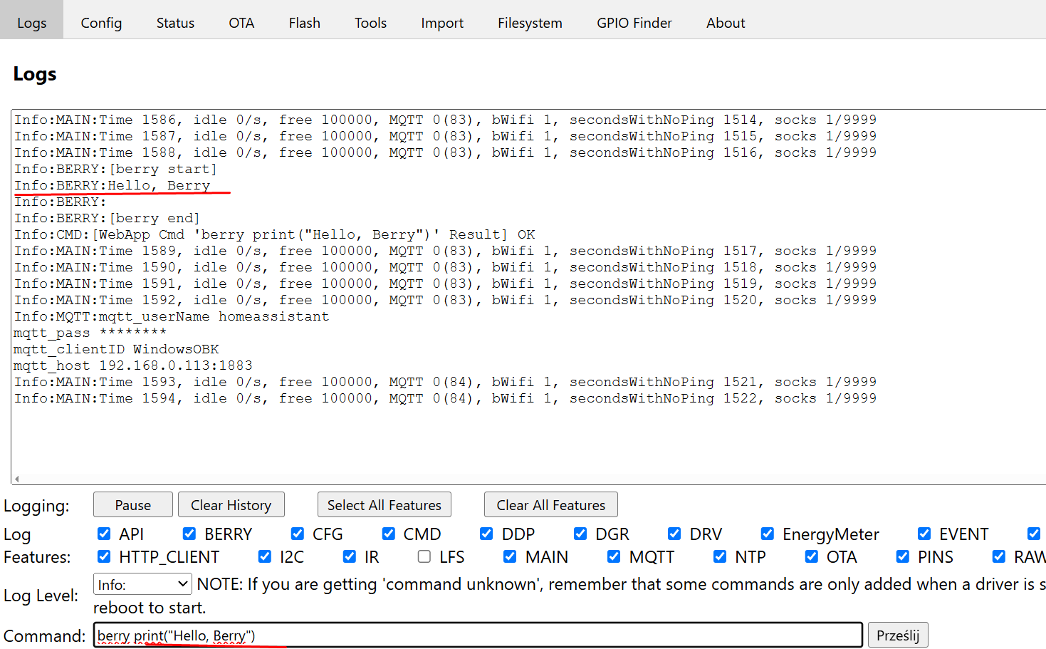

Let's start by executing some simple Berry commands in OBK command line:
berry print("Hello, Berry")
Berry command tool interface displaying the result of the command berry print(Hello, Berry).

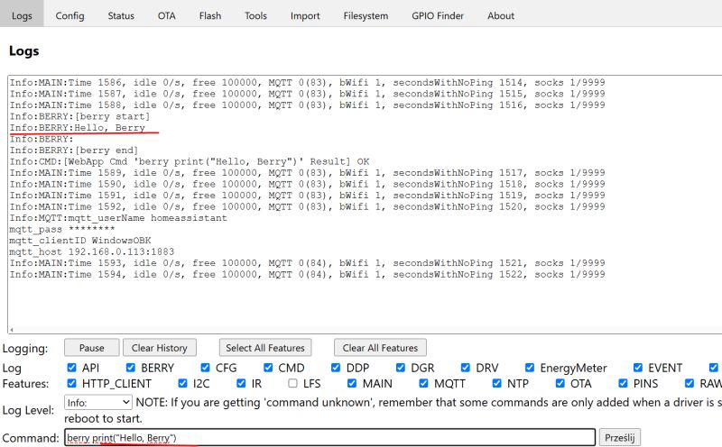

The same could be done in the Web App console:
Screenshot of logs showing execution of the command berry print('Hello, Berry') in the OpenBeken environment.

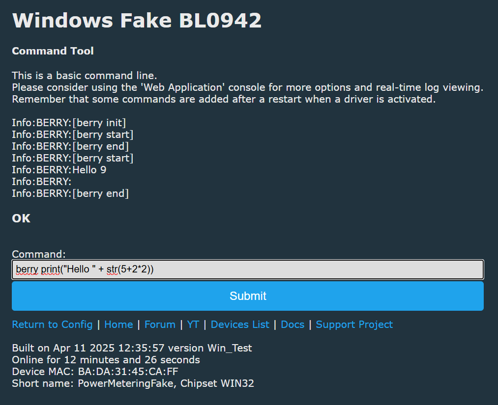

This way you can test various berry commands, for example, expressions:
berry print("Hello " + str(5+2*2))
Screenshot of the Windows Fake BL0942 interface with Berry commands.

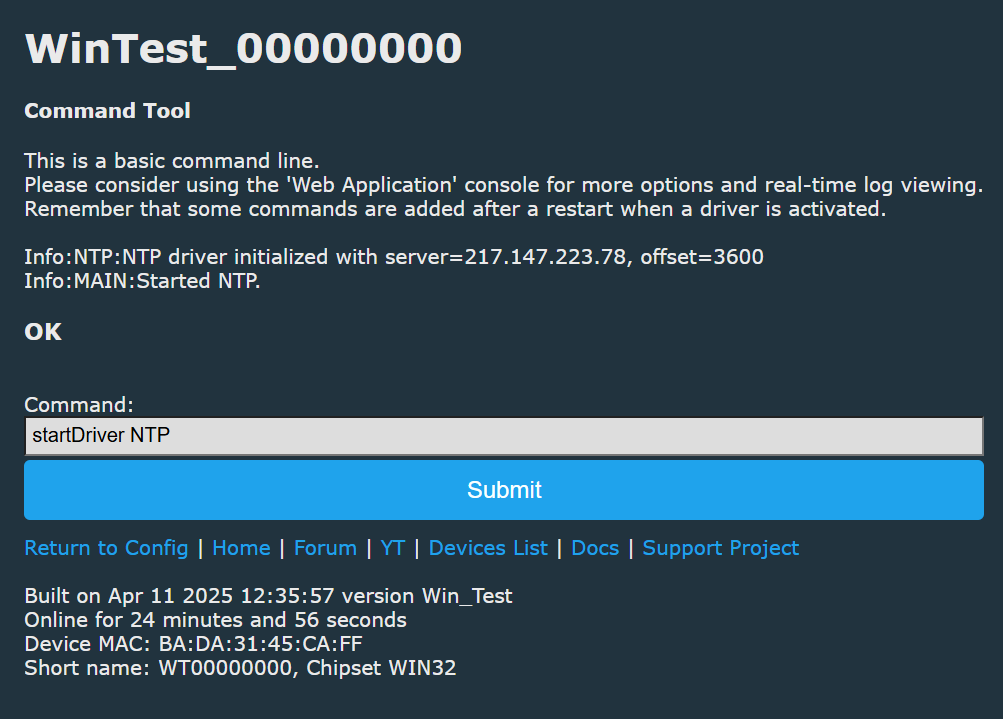

The most simple way to call OBK commands from Berry is "runCmd" command.
Commands should be taken from here:
For example, you call setChannel from Berry to set new channel value. In OBK, this can for example set relay state, along with whole MQTT publish and state update:
berry runCmd("setChannel 1 1")
Screenshot of the Berry command line tool interface with a command entered.
You can use the same approach to run text commands as well:
berry runCmd("MQTTHost 192.168.0.213")

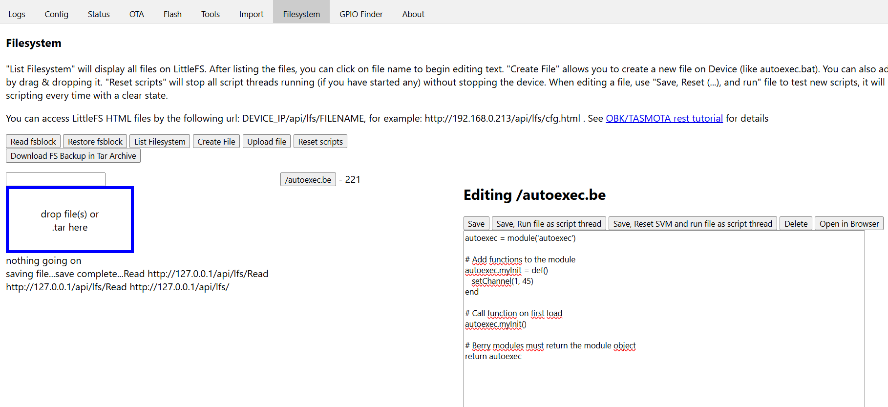

Berry script files
Main Berry scripts should reside within Berry modules. Berry modules can be created in LittleFS file system:
Let's start by making simplest module. Call it autoexec.be. It will run on each device startup.
autoexec = module('autoexec')
# Add functions to the module
autoexec.myInit = def()
   setChannel(1, 42)
end
# Call function on first load
autoexec.myInit()
# Berry modules must return the module object
return autoexec
File management interface with open script editor in OBK
For faster prototyping, you can use "Save, Reset SVM and run file" button. This will also attempt to clear device state to simulate a reboot, but may not be always reliable.

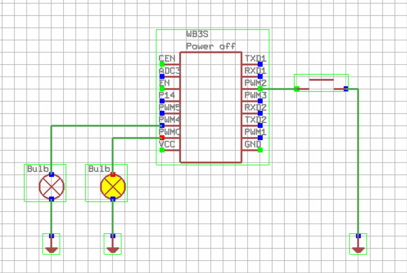

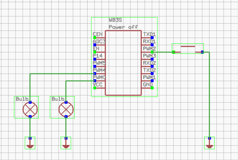

With setInterval, you can make a simple "blink LED" (or a relay, or anything) demo:
autoexec.myToggle= def()
   runCmd("toggleChannel 1")
end
setInterval(autoexec.myToggle, 500)
return autoexec
Circuit diagram using a WB3S module connected to two bulbs.
The same could be done with setTimeout, if needed:
   setTimeout(autoexec.myToggle, 500)
end
autoexec.myToggle()
return autoexec

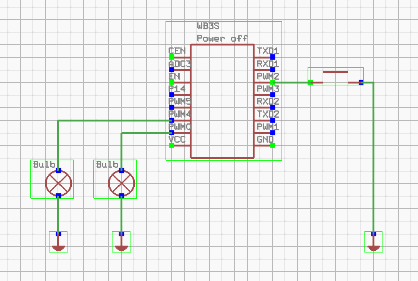

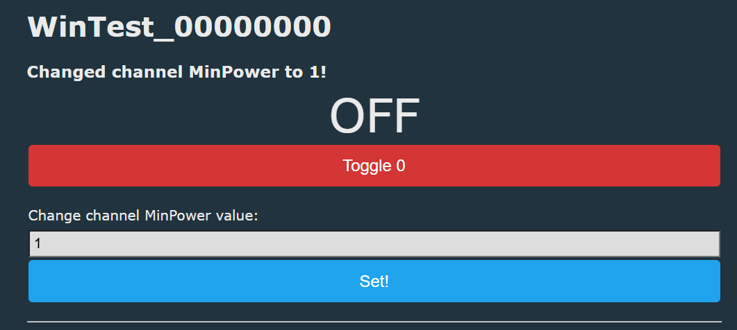

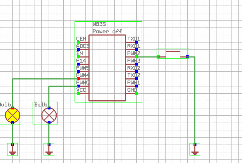

Reacting to events - buttons
Berry can react to OpenBeken events. For example, you can use it with Btn_ScriptOnly button. Set a Btn_ScriptOnly role for given pin, let's say, 14, and try following code:
   runCmd("toggleChannel 2")
end
addEventHandler("OnClick", 8, autoexec.myToggle);
return autoexec
For the demonstration purposes, I've put two relays ("bulbs") on channel 1 and channel 2:

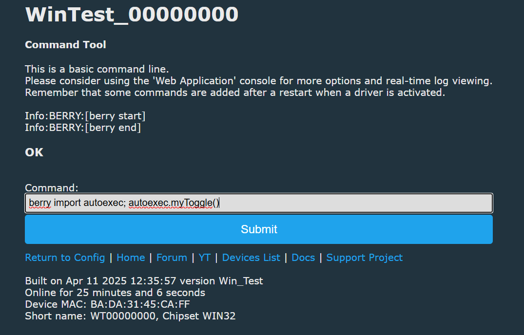

Calling module functions from outside
Keep in mind that you can simply use Berry modules anywhere inside OBK. Let's consider simplified version of mentioned module:
g_handle = 0;
   if g_handle == 0
        g_handle = setInterval(def()
        end, 200 )
     else
           cancel(g_handle)
           g_handle = 0
      end
end
return autoexec
Once you have it in LFS, you can just run OBK command:
berry import autoexec; autoexec.myToggle()
and it will correctly toggle the blink interval.
Command Tool console interface with Berry command.

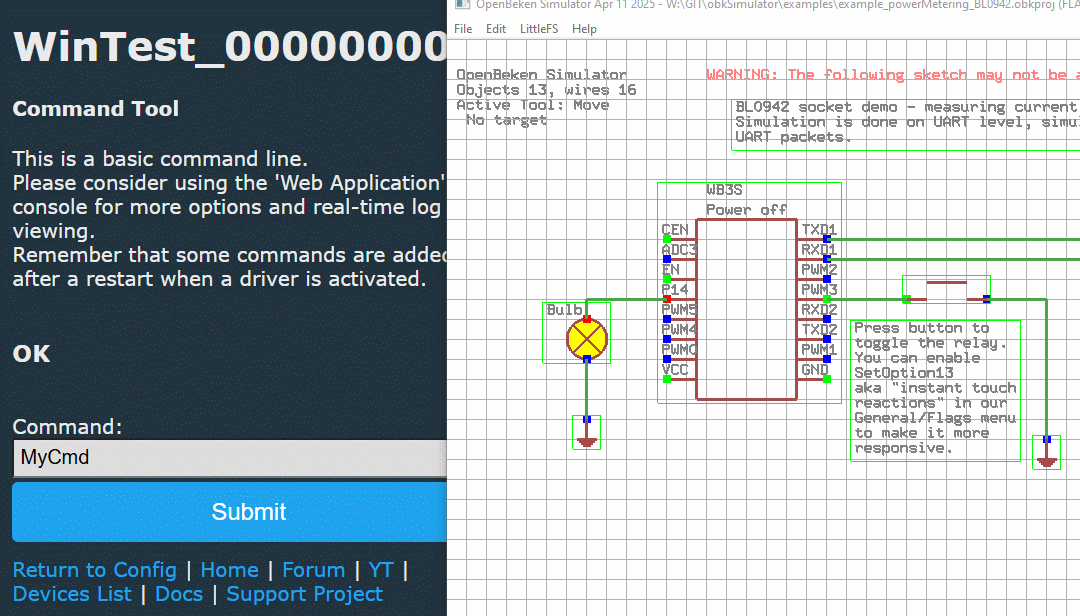

Direct command handlers
There are more ways to call Berry functions from outside. For example, you can just create your own command handler in Berry:
g_handle = 0;
   if g_handle == 0
             runCmd("toggleChannel 0")
        end, 200 )
     else
           cancel(g_handle)
           g_handle = 0
      end
end
addEventHandler("OnCmd", "MyCmd", autoexec.myToggle)
return autoexec
Keep in mind that now you can run this command from anywhere - even from MQTT!
OpenBeken simulator interface with a command input field and wiring diagram.

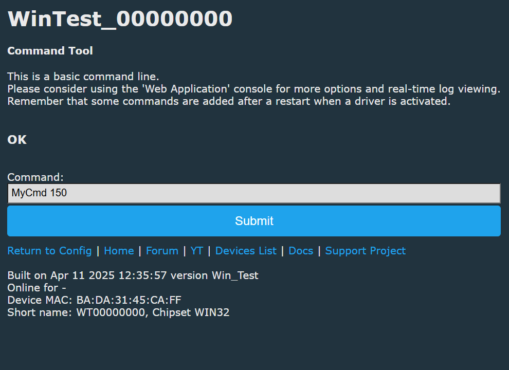

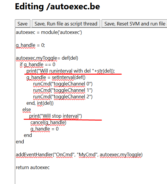

Direct command arguments
Commands can have arguments that are also passed to Berry. Arguments are strings by default, so you need to cast them to int to use them as a number. In this example, we'll modify the blinking command to include single argument, which is a blink interval. In order to convert it to string, I've used int(del) function.
g_handle = 0;
autoexec.myToggle= def(del)
   if g_handle == 0
        end, int(del))
     else
           cancel(g_handle)
           g_handle = 0
      end
end
return autoexec

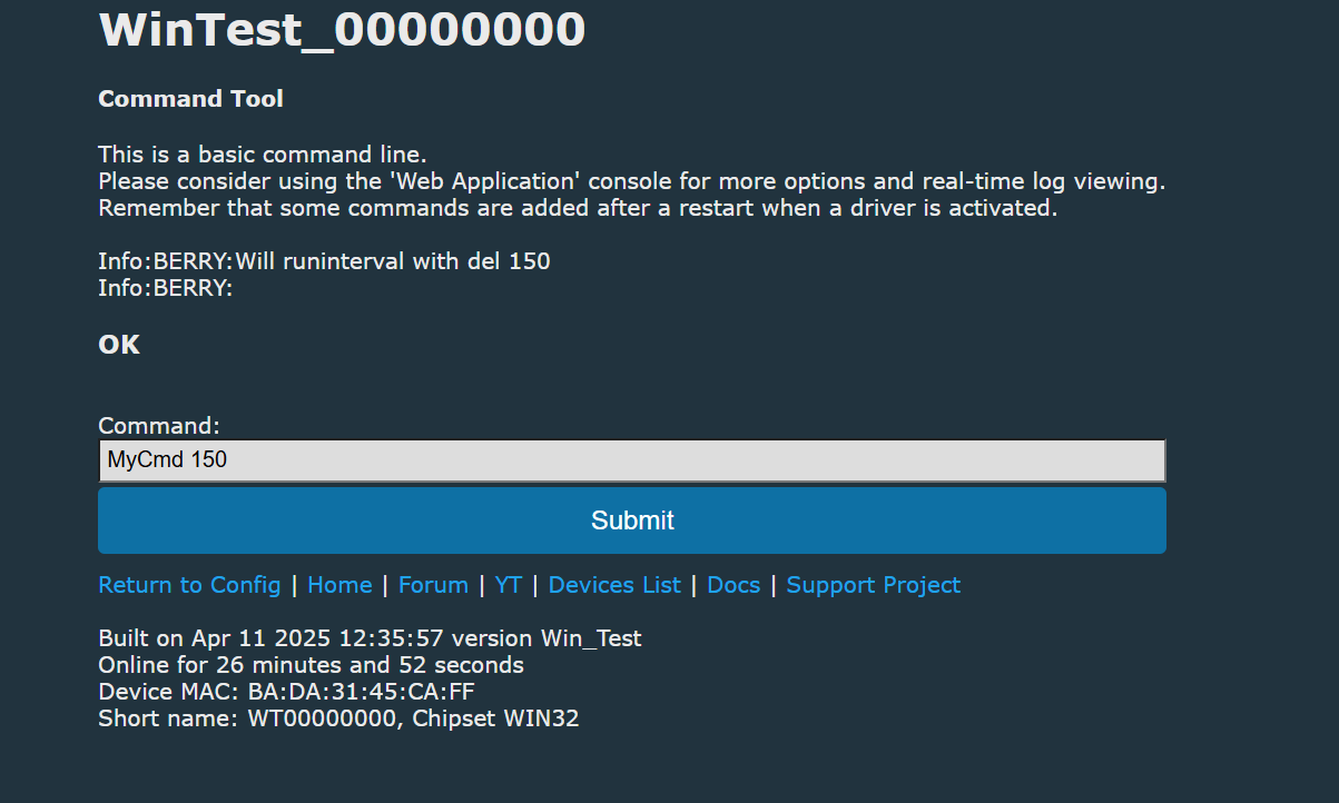

The usage is very simple:
Screenshot of the OBK Simulator command tool interface showing a text box with the command MyCmd 150 and a Submit button.

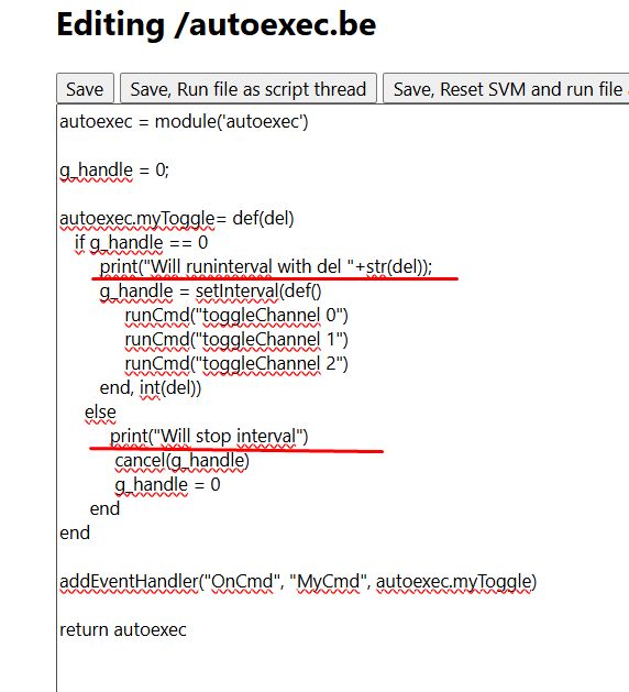

Of course, when in doubt, you can just print out some debug information:
Screenshot of editing an autoexec.be script with code in the user interface.
Screenshot of command line tool console for Berry in OBK simulator.

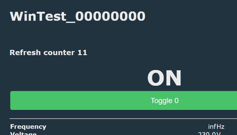

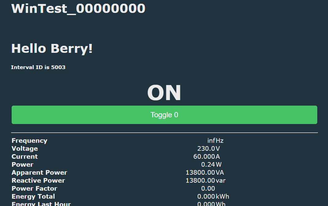

Showing information on state section
OpenBeken features a main page with a state section that is automatically refreshed in background.
g_handle = 0;
   if g_handle == 0
        print("Will runinterval with del "+str(del));
        end, int(del))
     else
          print("Will stop interval")
           cancel(g_handle)
           g_handle = 0
      end
end

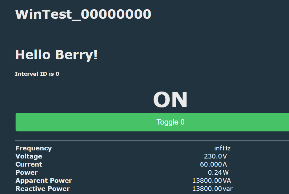

autoexec.myShow= def(request)
     poststr(request, "<h1>Hello Berry!</h1>")
     poststr(request, "<h5>Interval ID is " + str(g_handle)+"</h1>")
end
addEventHandler("OnHTTP", "state", autoexec.myShow)
return autoexec
Screenshot of a simulation application displaying power data and relay status.
Interval ID will be 0 when it's inactive.
Screenshot of a simulation application interface for the Berry scripting language.

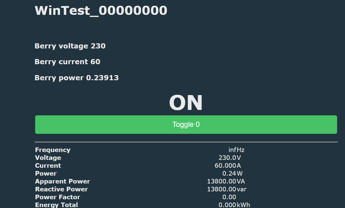

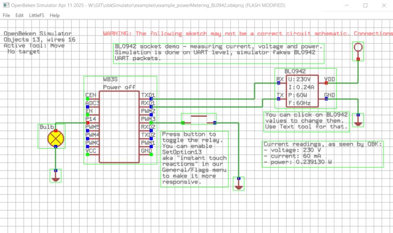

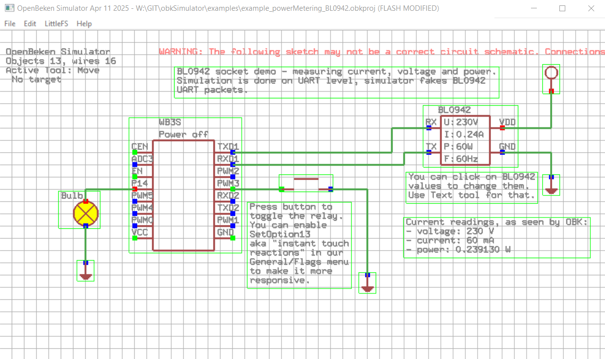

Access to OBK variables - power metering
OpenBeken has some legacy variables that were used before Berry introduction. They can be seen here:
https://github.com/openshwprojects/OpenBK7231T_App/blob/main/docs/constants.md
In Berry, you can access them with getVar function.

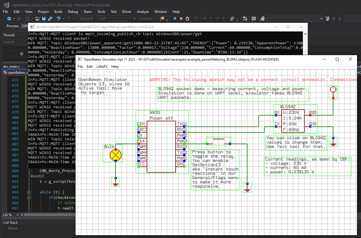

Here's a simple BL0942/BL0937 readout demo:
     v = getVar("$voltage");
     poststr(request, "<h3>Berry voltage " + str(v)+"</h3>")
     c = getVar("$current");
     poststr(request, "<h3>Berry current " + str(c)+"</h3>")
     p = getVar("$power");
     poststr(request, "<h3>Berry power " + str(p)+"</h3>")
end
return autoexec
Screenshot of OpenBeken Simulator showing a circuit schematic with voltage, current, and power measurements.
Values are correctly displayed on the main page:
User interface of a simulator with voltage, current, and power data.

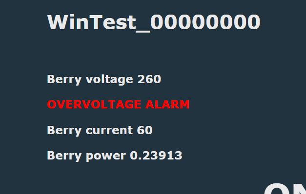

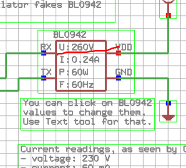

Following example can be expanded with conditionals. You can use if block to check voltage value.
     if v > 245
          poststr(request, "<h3 style='color:red'>OVERVOLTAGE ALARM</h3>")
    elif v < 210
          poststr(request, "<h3 style='color:red'>UNDERVOLTAGE ALARM</h3>");
     end
end
return autoexec
Now, let's set voltage to 260 and see what happens:
Diagram of BL0942 simulator circuit showing voltage, current, power, and frequency values.
The error message is displayed correctly:
Screenshot showing electrical parameters with an overvoltage alarm.
Extra sample - refresh counter
Following script will counter the number of automatic refreshes done by OBK state page segment:
autoexec = module("autoexec")
cnt = 0;
addEventHandler("OnHTTP", "state", def(request)
     poststr(request, "<h3>Refresh counter " + str(cnt) + "</h3>")
     cnt = cnt + 1
end)
return autoexec
Screenshot of an interface showing a refresh counter and a toggle switch.

The following sample can be extended by, for example, moving constants to text fields:
loopsLowPower = 0;
def myLogic()
      print("power is " +str(p));
      minPower = getChannel(5);
      if p < 1
         loopsLowPower  += 1
         if loopsLowPower  > 5
           runCmd("POWER OFF");
         end
      else
          loopsLowPower  = 0;
      end
end
runCmd("setChannelType 5 TextField")
runCmd("setChannelLabel 5 MinPower");
setInterval(myLogic, 1000);
return autoexec
Result:
Screenshot of an interface simulating a channel test with an option to change MinPower value.

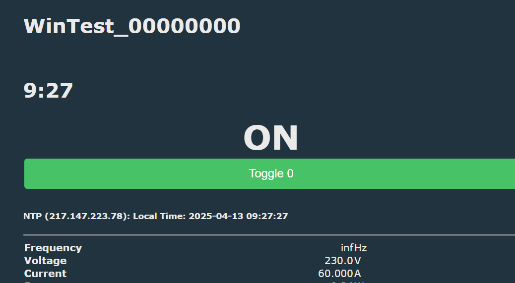

Access to OBK variables - time variables
First start NTP driver. Once it's running, you will be able to access current time data:
Screenshot showing the command input tool in the WinTest application.
Try following script:
     h = getVar("$hour");
     m = getVar("$minute");
     poststr(request, "<h1>" + str(h)+":" + str(m)+"</h1>")
end
return autoexec
It will print NTP hour/minute on the main panel:
OBK simulator interface showing device status and electrical parameters.

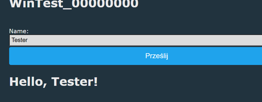

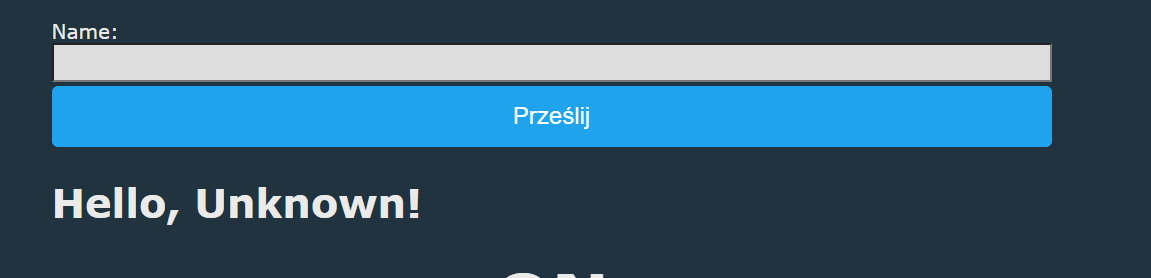

Custom HTML fields
HTTP callback also allows you to create custom HTML fields. They can store any kind of data that is later processed by Berry. You can use getVar to access GET variables as well. The input field, however, can be tricky. This is becaue state section is refreshed automatically, so you'd lose the data you type. That's why there is another callback - called "prestate" that runs before state div. So field is created in prestate, and display in the state.
name = "Unknown";
autoexec.myPre= def(request)
     other = getVar("name");
      if other != nil
        name = other;
     end
      poststr(request, "<form method='GET'>Name: <input name='name'><input type='submit'></form>")
end
autoexec.myState= def(request)
     poststr(request, "<h1> Hello, " + name+"!</h1>")
end
addEventHandler("OnHTTP", "prestate", autoexec.myPre)
addEventHandler("OnHTTP", "state", autoexec.myState)
return autoexec
Screenshot of a form with a field to enter a name and a Submit button, below is the text Hello, Unknown!
OBK Simulator user interface with a text field and Submit button
