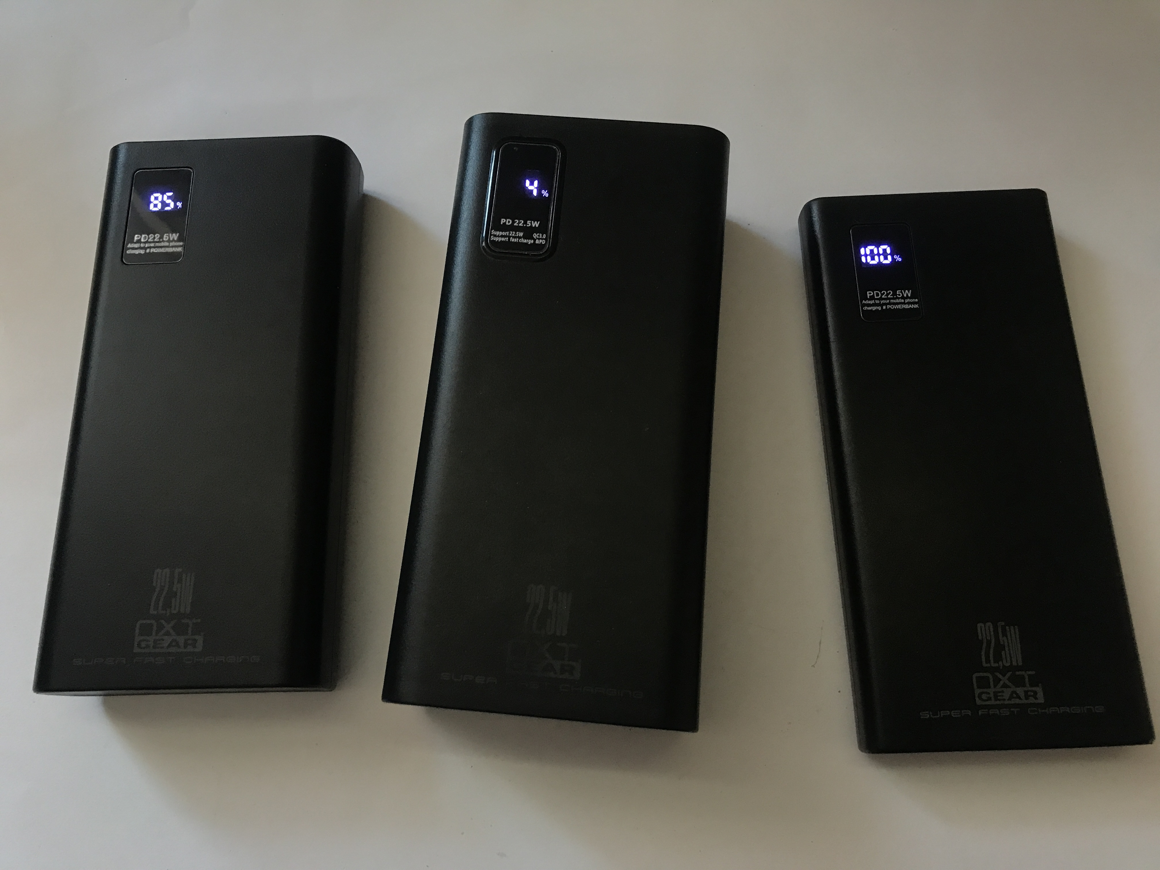

Three black QXT Gear power banks with LED screens showing charge percentage
Today's test will focus entirely on powerbanks supporting the Quick Charge standard, i.e. capable of powering our mobile devices with a voltage higher than the standard 5 volts. This speeds up their charging significantly. The declared power of each unit is 22.5 watts and the capacities are 10 Ah, 20 Ah and 30 Ah, respectively. They can be purchased for, respectively, PLN60, PLN115 and PLN160. Does it make sense to pay this much? Let's find out!

From my estimates, these powerbanks have 8.46 Ah, 19.4 Ah and 29.15 Ah respectively. The first result is possibly acceptable, the others are good. With other powerbanks, for example Baseus ( link to test ), it was better, but there were also much worse copies.
I also checked the current capacity and QC. I think it is very good - we get what the seller promised. It even managed to get 12 volts, although my phone didn't switch on as much as that voltage, it only stopped at 7.5 volts. The powerbank itself is also able to take the increased voltage, as we connect it to a suitable power supply. On a side note, I've observed that the QC shuts down when you plug in a second USB cable - no matter whether to charge the device itself or something external. This means that by connecting the phone for charging "via powerbank" we lose the QC option altogether and this should be kept in mind, but I don't suppose anyone does this?
