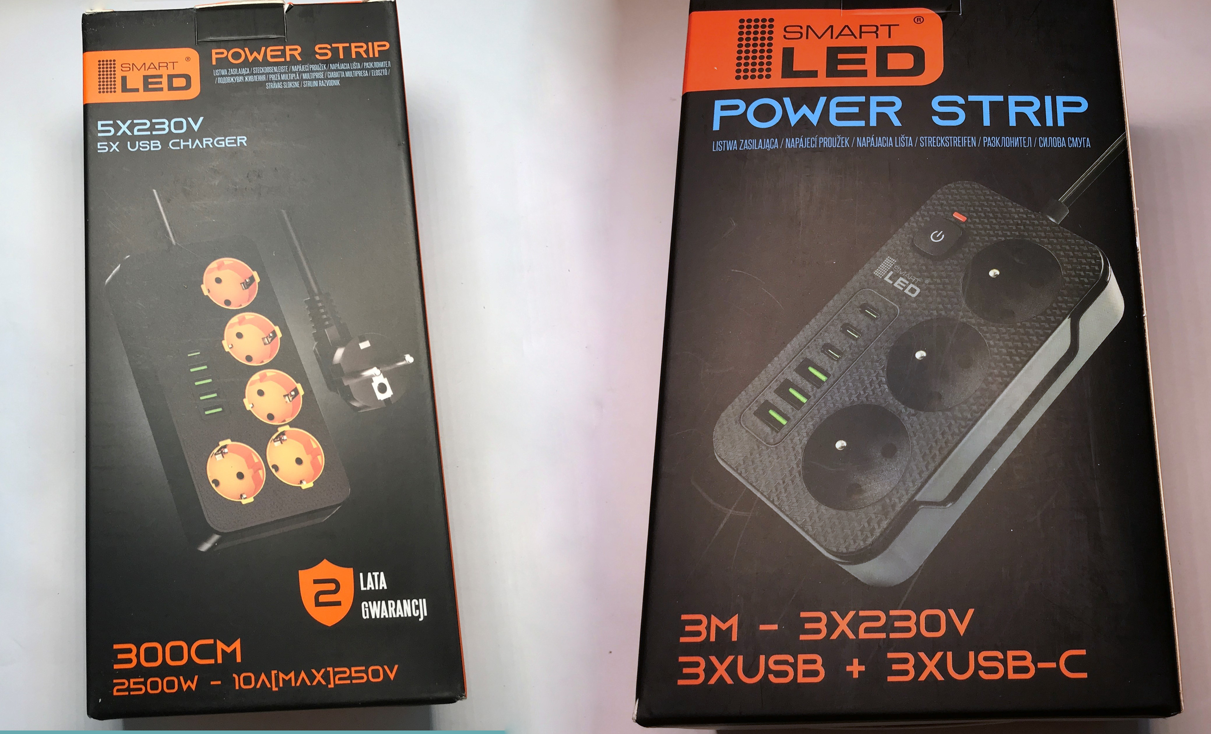

Extender with six USB sockets, that means charging phones for the whole family - isn't that convenient? Plus, the whole thing for just PLN35! Is there a catch here? Let's find out.
In this topic, I will present two products from the same series - SmartLED 8152 (5 x USB, 5 x 230V) and SmartLED 8110 (6 x USB, 3 x 230V). Both cost around PLN35 each, which is suspiciously cheap, but they do have USB C, which might seem like a good bargain. Just does the presence of a USB C socket equate to support for fast charging standards such as QC and PD? We shall see.
SmartLED 8110 (PLN32)
Let's start with the description. The text does not mention USB parameters, so supported voltages and current capacity are a mystery.
There is a bit more information on the packaging - 5 V/2.1 A, not to be confused with 21 A. The question now becomes, is this the current capacity of one socket or all six together?
The product itself looks good and is signed with the importer's logo.

SmartLED 8152 (PLN37)
Again, we start with the description. Here it is slightly better. There is a tentative mention of 5 V and 2.1 A in the description:
Power strip with three sockets and five USB ports placed on a patterned carpet floor.
The author of the description, however, does not seem to see the problem. The information then appears once again and is presented as an asset:
Power strip with 5 USB ports and 5 Schuko-type 230V sockets
Confusing voltage with current does not add any credibility to the description.
Smart LED power strip box with 5x230V outlets and 5 USB charging ports Side of SmartLED 8152 power strip box with icons and technical info SmartLED 8152 power strip packaging with technical specifications in Polish
The packaging again states 5 volts and 2.1 amps. The product itself looks good, although here there are already Schuko sockets, not French. There is also no overcurrent circuit breaker.
