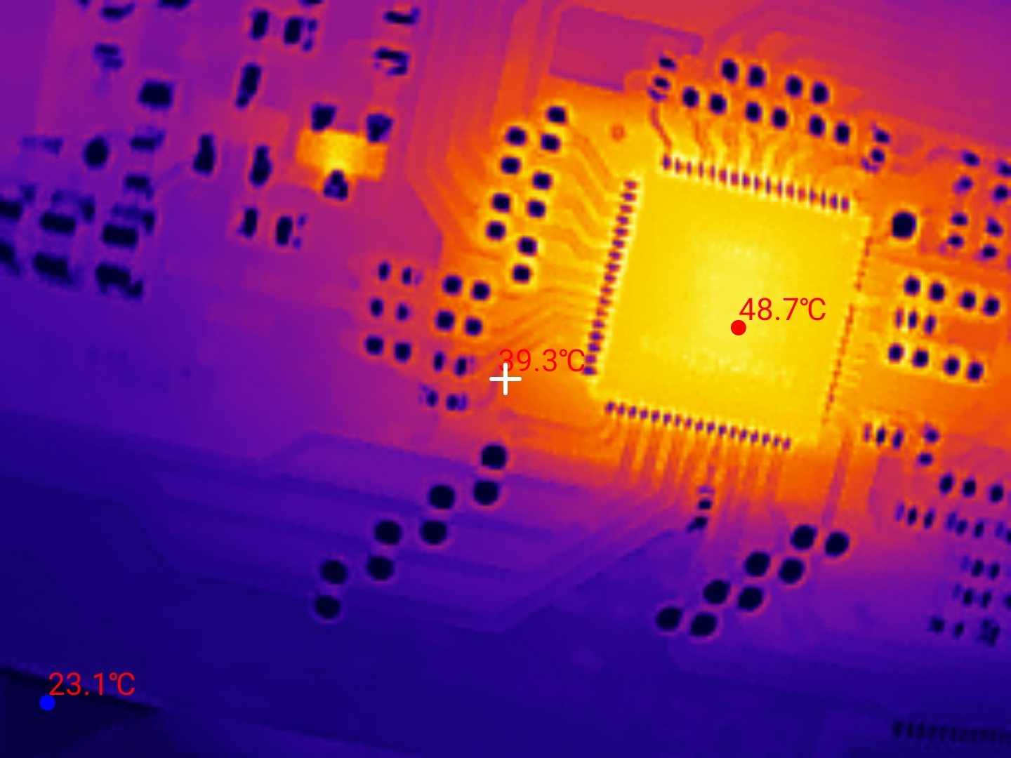

With a macro lens - what heats up on the T-Con:
Thermal image of PCB with hot integrated circuit at 48.7°C
Thermal view of a PCB showing hot spots near integrated circuits
Thermal image of a PCB with hot spots marked at 57.3°C and 35.9°C
You can even see the transistor heating up in the SOT-23 housing.
