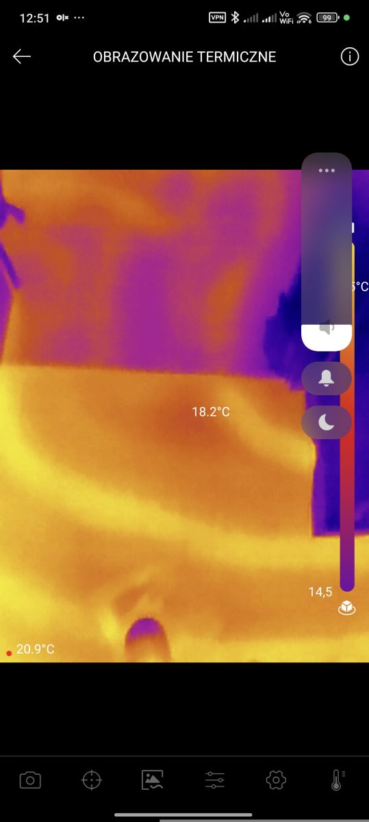

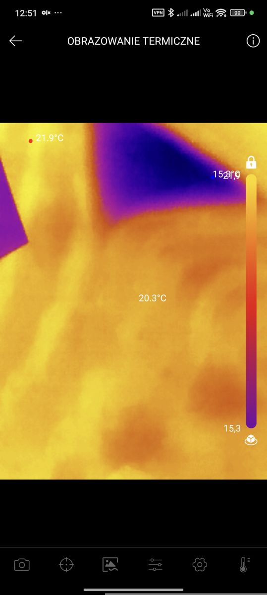

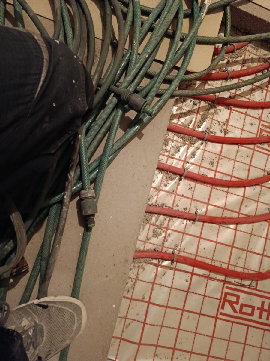

    Thermal image of a floor with visible underfloor heating pipes Red underfloor heating pipes attached to mesh-patterned foil Thermal image showing underfloor heating pipes embedded in concrete floor
    Here, for example, photos from a building where the water temperature on the boiler is about 20 degrees. The air temperature in the building about 16.
    You can see that the pipes are lost in the floor.
    I thought maybe it was the fault that the temperature was too low.

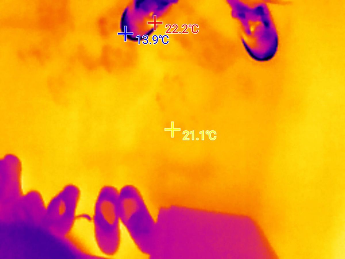

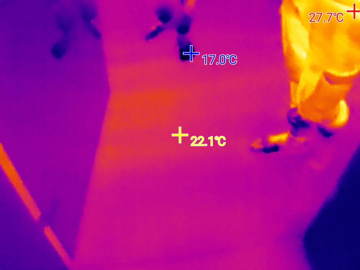

    I checked this in another new building where someone already lives and we have a normally heated building here.
    Thermal image of floor with temperature labels and outline of footwear Thermal image of a floor with no clear underfloor heating pipe patterns
    You can't see it either.

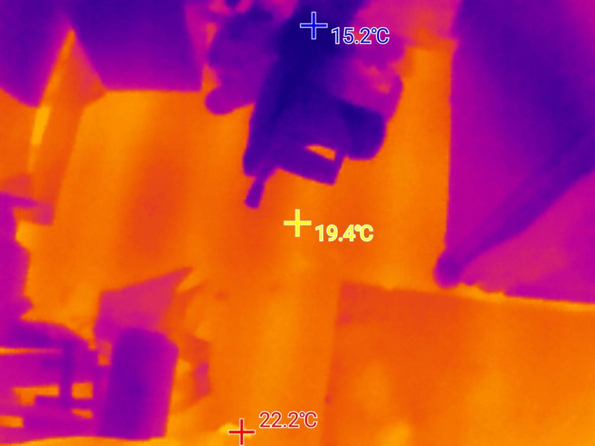

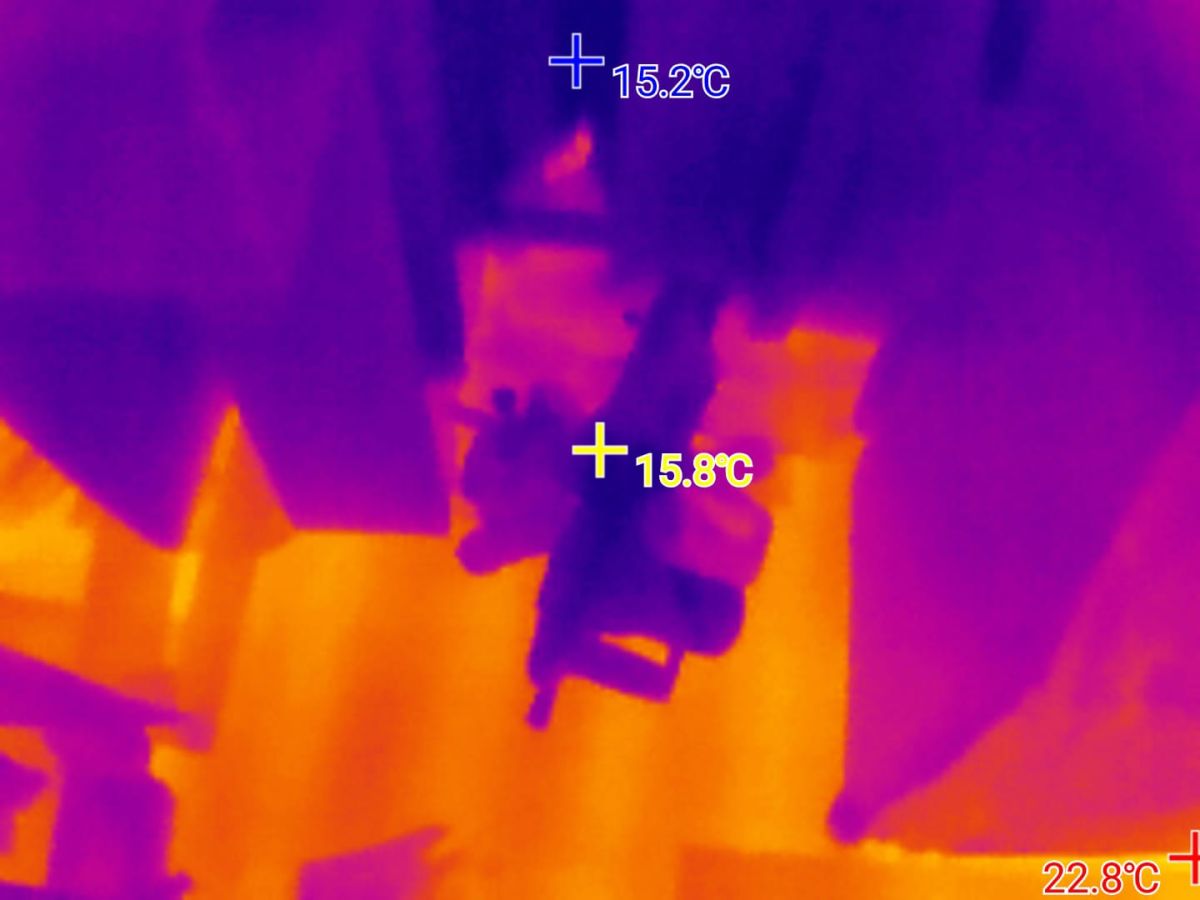

    Here a picture from the garage. The water temperature in the system is the same as in the living area but the air temperature in the room is lower.
    Thermal image of a floor showing temperatures from 15.2°C to 22.2°C Thermal image of an indoor space showing temperatures from 15.2°C to 22.8°C
    Here the tubes are already at a greater distance from each other - 20cm. As if there was something already visible here.
    Maybe due to the fact that there is a greater temperature difference between the floor and the air.
    Do any of you have the possibility to check if you can see the pipes in the underfloor heating on his camera?
    I don't know if this can only be seen when someone raises the temperature or maybe when they have just switched the heating on.
    Maybe you can't see it normally though.
    I have not changed any settings in the app.

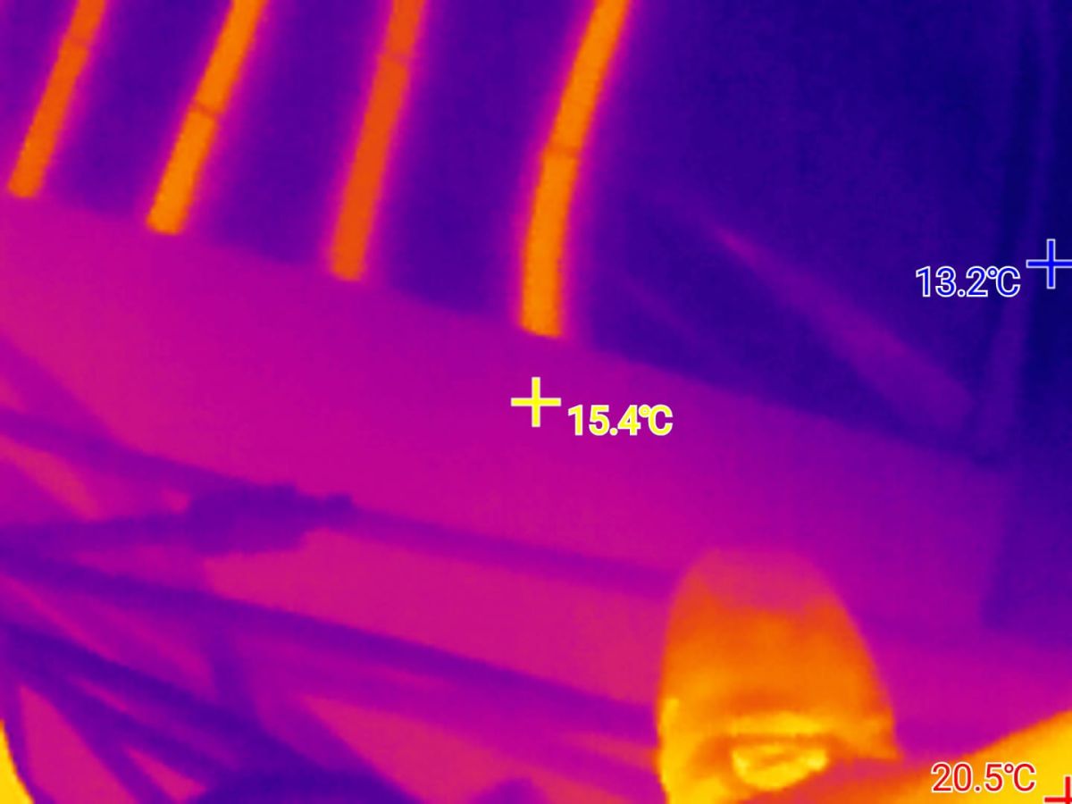

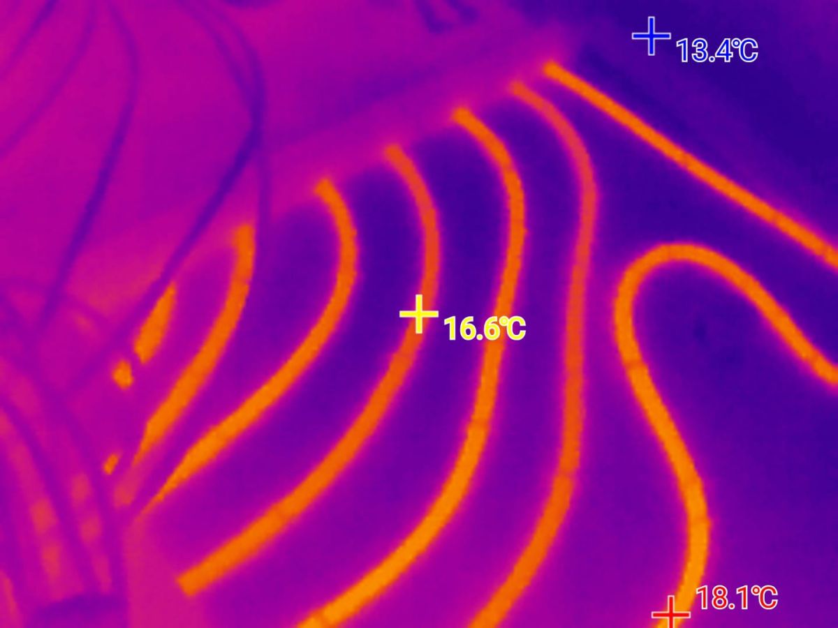

    You can see, you just have tiles like that. It's not an x-ray ;)
    If you spread the heat evenly it won't show.
    Thermal image of a floor showing uneven heat distribution Thermal image showing temperatures from 15.3°C to 21.9°C

    You can manually limit the temperature dynamic range, then you will see them better. You will see them best when you have a cooled floor and let the heating go to the maximum. There is also one condition - the floor must be dry (in volume, not just on the surface). You can definitely see the electric heating better.

    You can't see it in mine.
    The pictures are from two buildings.
    In the one with the lower temperature you can't see anything.
    In the other building where there is normal heating, where you can see the outline, it is actually in the garage where there are no tiles on the floor. In the house there are panels or tiles and there are no outlines visible anymore.
    Maybe this camera of mine is weaker.
    Which one are you using?
    You can see from the software that it's more like InfiRay but apparently ToolTop works on this software too.
    Is this a photo of the floor in normal use of the house, or is it a specially turned up temperature or some other washes?
    What is your water temperature there?
    From what they show on the internets that's where you can see it more clearly.

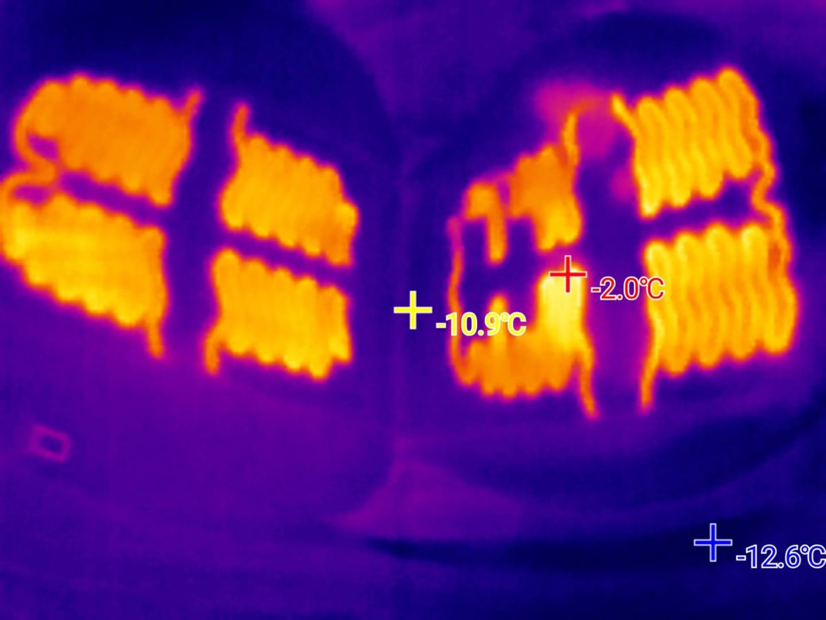

    As for the electric heating it is closer to the tiles or panels, there is not so much concrete there to play it supposedly be visible.
    In the car the mats in the seats or steering wheel can be seen.
    Thermal image of a steering wheel showing temperature range from -12.8°C to 19.9°C Thermal image of two car seats with visible heating pad patterns.
