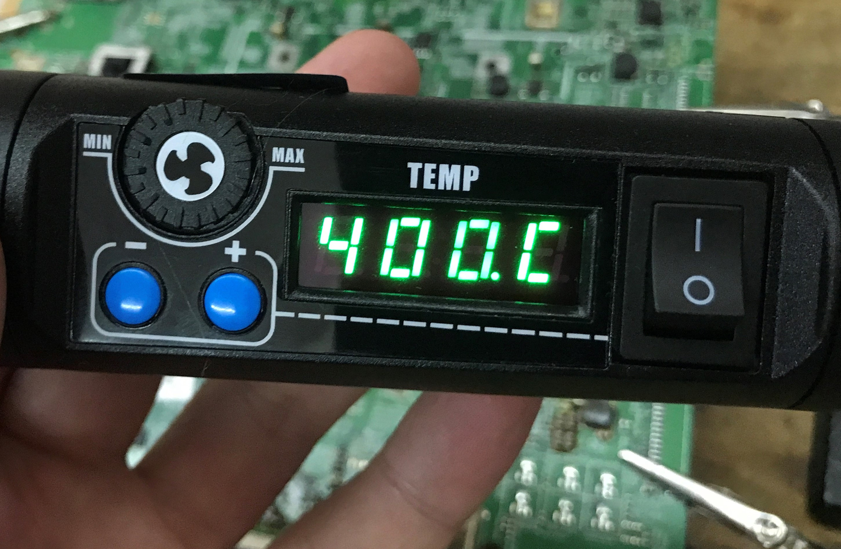

Tests with motherboard
The whole thing is simple and convenient to use. The blower is adjusted with a potentiometer, the temperature with buttons. When you have finished working, you do not disconnect the whole thing from the mains, because the station first still cools itself by blowing air without heating, as per the instructions.
Close-up of hot air WEP 8858 handle with vented end and power cable WEP 8858 device display showing 400 °C temperature

First test - 300 °C, full blast.
I gave up after 5 minutes. It was not possible to solder the component.
I increased the temperature to 450 °C:
The component came off after 2 and a half minutes. No revelation.
Second test - 400 °C:
Here I helped myself with flux, an element in an enclosure such as a flash memory chip came off in two minutes. This means that, if anything, it would be possible to upload firmware in case the clip from the CH341 fails. The minimum functionality is.
Third test - 400 °C:
Next something more difficult, a coil from one of the inverters. Such a component is quite large and sits on a larger copper spout, which acts as a heat sink and absorbs heat.
I heated for three and a half minutes, but the element was able to be removed.
Fourth test - 450 °C:
This time the coil came off in one and a half minutes.
Fifth test - 450 °C:
A tiny component in a QFN housing.
The situation is difficult because the component is also soldered underneath. It was successful in one and a half minutes.
Sixth test - 450 °C:
A slightly larger component. Also with a mass underneath. This can be seen when it is pulled off.
Just under two minutes.
Seventh test - 450 °C - no nozzle, larger QFN component.
Two minutes.
Conclusions a little further on.
