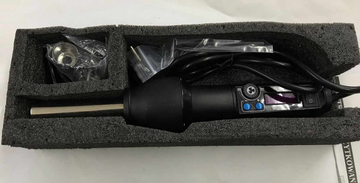

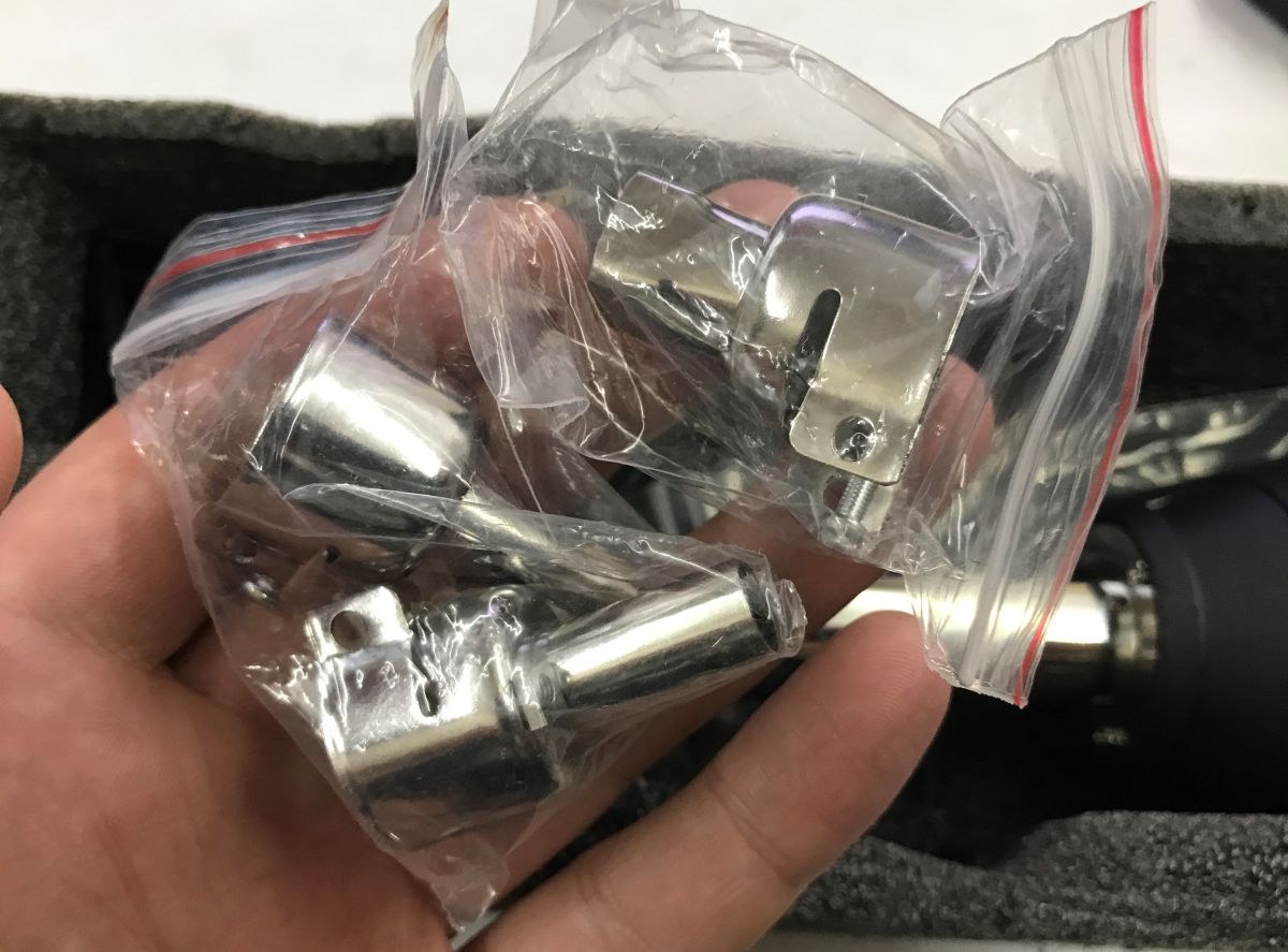

    The unit is quite well protected for transport. In addition to the hot air itself, we get three nozzles - a 12mm x 12mm square one and 9mm and 7mm round ones. A stand is also included.
    WEP 8858-I hot air station packed in foam casing with accessories Hot air nozzles for WEP 8858 in a plastic bag held in a hand Plastic bracket for hot air station held in hand above packed device with nozzle

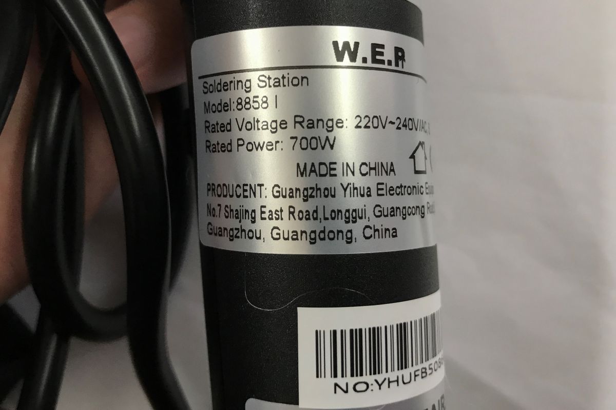

    Nameplate:
    Nameplate on WEP 8858 I soldering station showing specifications and manufacturer details

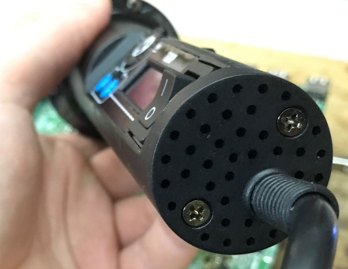

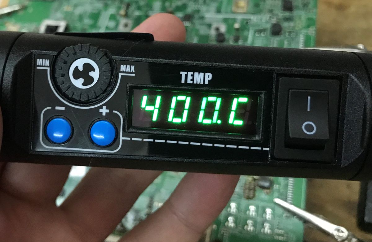

    The whole thing is simple and convenient to use. The blower is adjusted with a potentiometer, the temperature with buttons. When you have finished working, you do not disconnect the whole thing from the mains, because the station first still cools itself by blowing air without heating, as per the instructions.
    Close-up of hot air WEP 8858 handle with vented end and power cable WEP 8858 device display showing 400 °C temperature

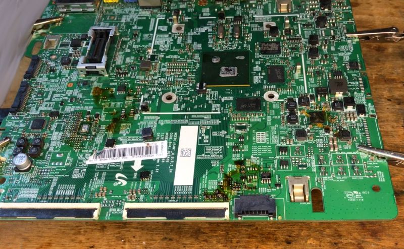

    You can confidently test. Just on what? I have chosen a large PCB:
    Large green motherboard with many ICs and SMD components on a wooden table
    The more copper, the more massive the board, and the more layers, the harder it is to solder the component.
    A motherboard from a computer would probably be even better, but I didn't have any on hand.
    First test - 300 °C, full blast.
    I gave up after 5 minutes. It was not possible to solder the component.
    I increased the temperature to 450 °C:
    The component came off after 2 and a half minutes. No revelation.
    Second test - 400 °C:
    Here I helped myself with flux, an element in an enclosure such as a flash memory chip came off in two minutes. This means that, if anything, it would be possible to upload firmware in case the clip from the CH341 fails. The minimum functionality is.
    Third test - 400 °C:
    Next something more difficult, a coil from one of the inverters. Such a component is quite large and sits on a larger copper spout, which acts as a heat sink and absorbs heat.
    I heated for three and a half minutes, but the element was able to be removed.
    Fourth test - 450 °C:
    This time the coil came off in one and a half minutes.
    Fifth test - 450 °C:
    A tiny component in a QFN housing.
    The situation is difficult because the component is also soldered underneath. It was successful in one and a half minutes.
    Sixth test - 450 °C:
    A slightly larger component. Also with a mass underneath. This can be seen when it is pulled off.
    Just under two minutes.
    Seventh test - 450 °C - no nozzle, larger QFN component.
    Two minutes.
    Conclusions a little further on.

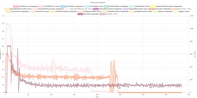

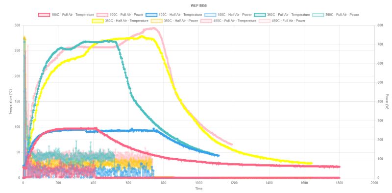

    Temperature measurements
    I made the measurements based on the configuration from this topic:
    OpenBeken configuration for hot air testing - MAX6675, temperature and power logging
    Measurements were taken at full blow and at 50% blow.
    Here I have prepared two sets of measurements:
    - measurements only for WEP 8858, at three temperatures, I also checked the different levels of blowing
    - a summary comparison of all the stations I have had so far
    Let's start with the measurements of the 8858 only.
    Temperature and power graph for WEP 8858 station under various settings
    Interactive version: https://openshwprojects.github.io/hotairwep8858.html
    The first thing that strikes me is the small difference between heating at 350 °C and 450 °C. The curves intersect there, but it's all within error. It seems that the 450 °C setting only approached 300 °C by a 'throw on the belt'. A lower setting, 350 °C, on the probe gave a temperature only about 25 °C lower.
    Someone might think that the temperature setting doesn't work at all - but no, you can see from the results with the 100 °C setting that it has some effect after all. At 100 °C, the results are actually very accurate. The full-blow setting achieved some 98 °C, the half-blow setting 90-95 °C, also within the margin of error.
    The differences between full blow and half blow are negligible in my sensor tests.
    It can be equally interesting to analyse the power consumed. Those promised 700 W are only there at the beginning. Even when heating to 450 °C (which, by the way, is remarkably similar to the 350 °C setting), the power drawn most of the time is around 120 W.

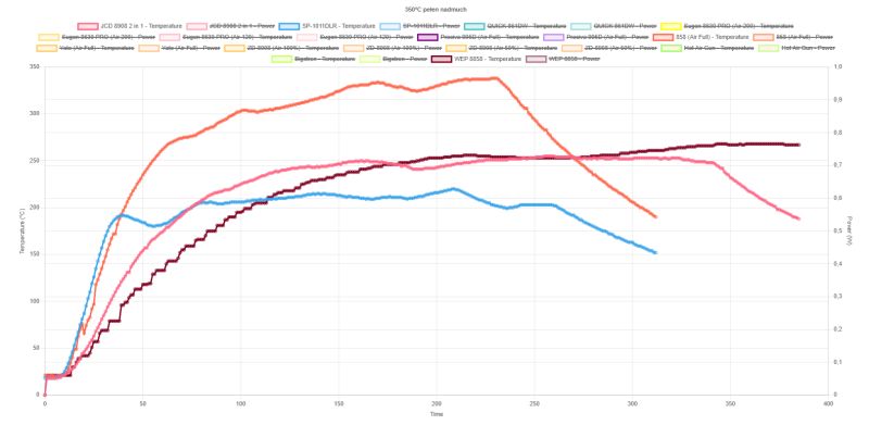

    You can now also take a look at the summary graph. It is separately for the two temperatures:
    https://openshwprojects.github.io/hotair/version9/450c.html
    https://openshwprojects.github.io/hotair/version9/350c.html
    Comparison graph of temperature and power for hot air stations at 350°C, full airflow
    Not a revelation, the performance of this station is similar to the weaker ones I tested, the JCD 8908, SP-1011DLR, etc. Even the budget and classic 858 trumps it.
    Out of curiosity I included three interesting stations on it - the Sugon 8630 PRO (high end, very expensive), the 858 (cheap but good hot air) and the eponymous WEP 8858. You can see by the power alone that there is definitely a heating difference, as it is the power here that translates into heat:
    Comparison chart of temperature and power of hot air stations at 450 °C
    Everyone can also draw their own conclusions from the graphs, so I provide interactive versions for reference:
