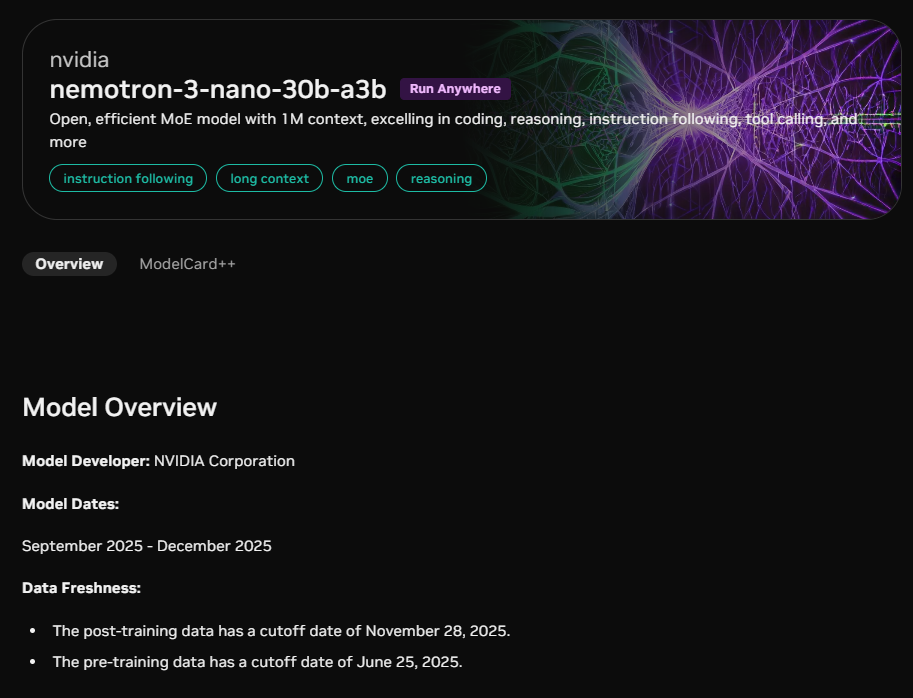

In this topic I will show how anyone can run the Nemotron 3 Nano on their own computer and then test it with all sorts of electronics and programming tasks. The Nemotron 3 Nano is a new thinking LLM model based on a Mixture-of-Experts architecture with a Mamba-2 + Transformer hybrid. The model has 30 billion parameters, but only about 3-4 billion are active during inference, significantly reducing the computational requirements.
Nemotron-3-nano-30b-a3b supports very long context (up to 1M tokens), several languages (German, French, Italian, etc.; no Polish) and released under the NVIDIA Open Model License. The model allows commercial use.
Information about the model used:
https://build.nvidia.com/nvidia/nemotron-3-nano-30b-a3b/modelcard
