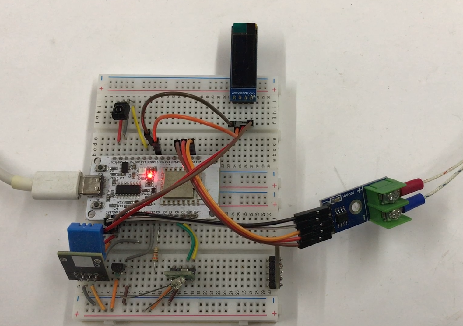

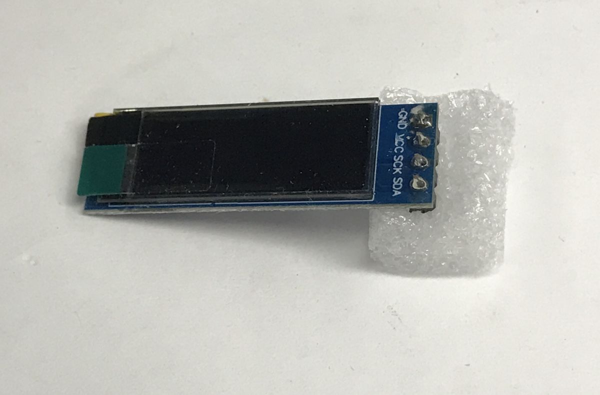

    In this topic I will show how to step-by-step run a simple driver for a 128x32 OLED without using off-the-shelf libraries, relying solely on software-based I2C. I will test how difficult it is to display text on such a display and how many bytes of RAM and Flash it requires. Will it be possible to run the text drawing without holding the image buffer in memory? Let's find out!
    Small OLED display module on a board with pin labels GND, VCC, SCK, SDA, on a white background
    I've shown the SSD1306 before, but I was running it with an Arduino . I described its connection and capabilities there. I was quite happy with the results, for this reason I also decided to add support for this display to my IoT firmware supporting up to 32 platforms .

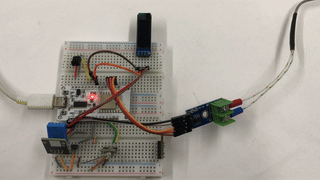

    I prototyped the driver on a BK7238, but due to the use of software I2C it should work on any supported platform.
    Development board on a breadboard with a small OLED display and a measurement module on the right

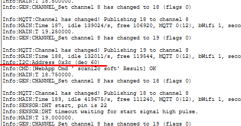

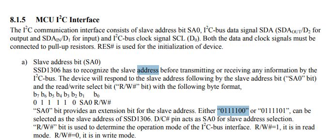

    I2C scan
    The first thing I run in such cases is an I2C address scan. It allows me to check that everything is well connected and that I have the address of the target device well defined. In my firmware there is a ready command for this - scanI2C . It displays the addresses of the devices found:
    Console log screenshot showing MQTT and DHT sensor messages and a “Result: OK” line for soft I2C.
    The address 0x3C is consistent with the catalogue note, you can proceed to the next step.

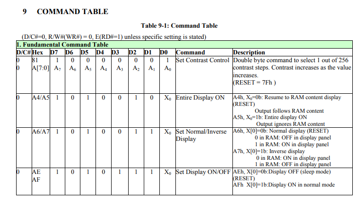

    First flashing
    The second step is always to run the simplest set of operations, the result of which is visible and verifiable. Here I wanted to try blinking the display.
    In this case, however, this requires a full configuration of the display and an understanding of its protocol.
    Here we have:
    - commands for the display - code 0x00
    - access to the pixel memory - code 0x40
    A bit of stuff needs to be set up at the beginning, fortunately my 128x32 module is popular enough that I could just follow the ready-made libraries. According to the catalogue note - contrast, remapping, scan direction, inversion, offset, frequency, RAM. As far as I can see, most drivers also have this implemented as static commands executed once at module start.
    Screenshot of a datasheet command table, with a green-highlighted section header
    In addition to this, I added a pixel send (WriteData), lit all of them for a test (0xFF - all bits lit) and alternated on/off commands, i.e. 0xAE and 0xAF, in a loop.

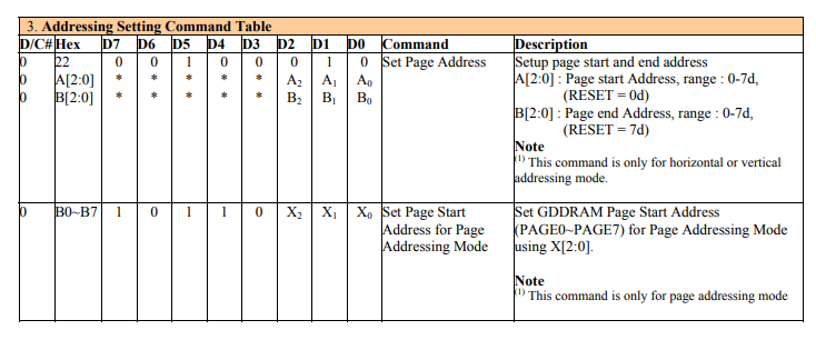

    Here, fortunately, there is a cleverer method - we can draw on an area of pages of our choice, and the display remembers this itself.
    We have 8 pages - from Page0 to Page7. In the version with a display height of 32, 4 pages are used. Each page is 128 bytes. Pages are groups of pixels, where successively we have vertical lines of 8 pixels. So by setting the first, for example, 16 bits, we create a 2x8 rectangle. If we skip every eighth bit, we create a 2x7 rectangle, and so on. The display also has the ability to change the segment mapping.
    SSD1306 addressing command table showing D7–D0 bit fields and descriptions
    SSD1306 command table excerpt for page addressing and setting page start/page address

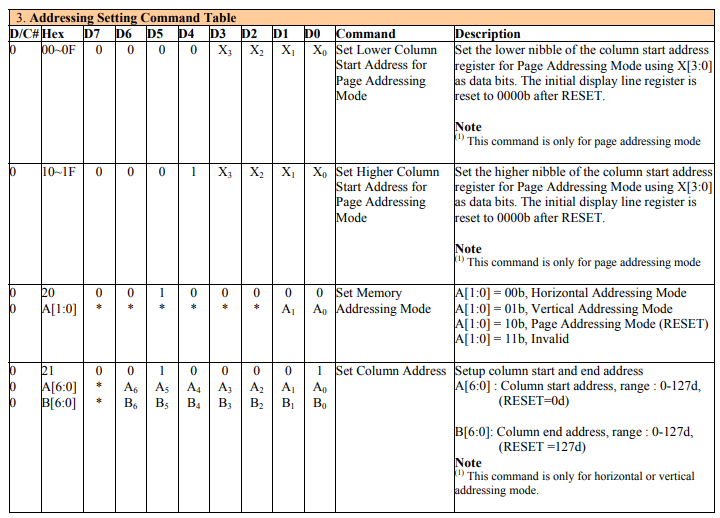

    A function was created to set the position of the cursor on a given byte on one of the eight sides:
    Code: C / C++
    Auto-incrementing the target address, however, does not allow us to jump freely between rows and columns, so when drawing a rectangle we set the cursor separately N times. Basically, we draw it from separate lines, here aligned to memory pages (for simplicity - operation >> 3, bit-shifting 3 bits to the right, i.e. dividing by 8 to get the page index).
    Code: C / C++
    In addition, I take into account two filling modes - full and border, in border mode I simply test if we are at the 'edge' pixels.

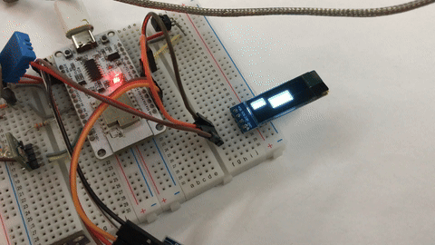

    Full demo:
    Code: C / C++
    Result:
    Breadboard with a microcontroller module and a small OLED display showing bright rectangles

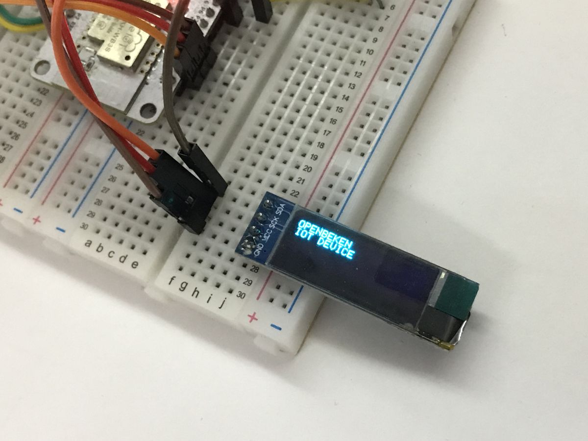

    First characters
    The next step is to display the text. Here again, you can take advantage of this division of memory into 8 pages and assume that you only ever draw characters on one of them. This in turn allows us to encode the characters as strings of bytes, which we send linearly to the controller, only setting the position on the selected one of the pages beforehand (SSD1306_SetPos).
    For the demonstration, I used a standard 5x7 ASCII font, with no lowercase letters. The whole thing is encoded in an array:
    Code: C / C++
    The SSD1306_WriteChar function sends one character to the controller, this character consists of five bytes of data. Nothing more needs to be done, as we have auto-incremented the address within the selected page.
    Code: C / C++
    Then you can add an auxiliary function SSD1306_String, which sends consecutive characters separately.
    Code: C / C++
    The function for presentation remains:
    Code: C / C++
    Result:
    OLED display on a breadboard with wires attached, showing the text “OPENBEKEN IOT DEVICE”.
