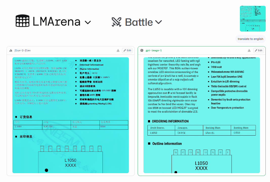

Comparison of two screenshots translating L1050 datasheet using different AI models
Is a catalogue note in a foreign language a problem in 2026? Today I will test whether artificial intelligence can replace a translator and translate subtitles from electronic parts specifications into English. Importantly, the whole experiment will be based on screenshots (bitmaps) rather than PDF files, so AI will have no way to make its job easier. Will this form of specification translation be of any use? Let's find out!
The testing methodology will be very simple - I take a screenshot of the catalogue note and try to translate it into English by sending it as an attachment with a prompt to the AI. I will use the free LMArena website to run the AI models:
https://lmarena.ai/
After testing, I will try to subjectively evaluate and group the models according to their results.
Note - I have placed the images as generated by the AI. If something is cropped, it means that such a bitmap was created by the model.

If the attached images are exactly what AI got, then I'm not surprised. Shit in => Shit out. [Read more]

Several models, especially Flux variants, produced meaningless letter strings. Others hallucinated new backgrounds, overlaid prompts, or cropped images. These are typical vision‑OCR failure modes when text is dense or stylized. [Elektroda, p.kaczmarek2, post #21795582]

Avoid Flux‑2‑Max/Pro variants for this task; results were meaningless letters. Also avoid qwen‑image‑edit and seedream‑4‑high‑res‑fal due to image damage. [Elektroda, p.kaczmarek2, post #21795582]
