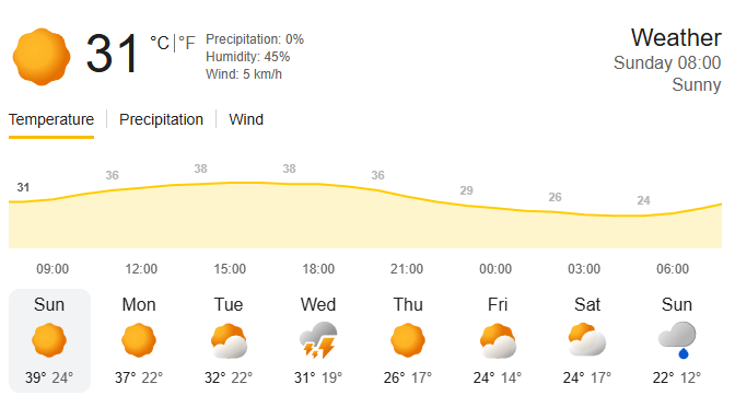

    Reason for purchase
    Portable air conditioners are, by their very nature, not particularly efficient, and the noise significantly reduces user comfort. Unfortunately, however, living conditions sometimes force one to make such a decision. When there is no option for a fixed installation, one has to make do with simpler and cheaper solutions. I paid just under 1,000 zł for the unit shown here.

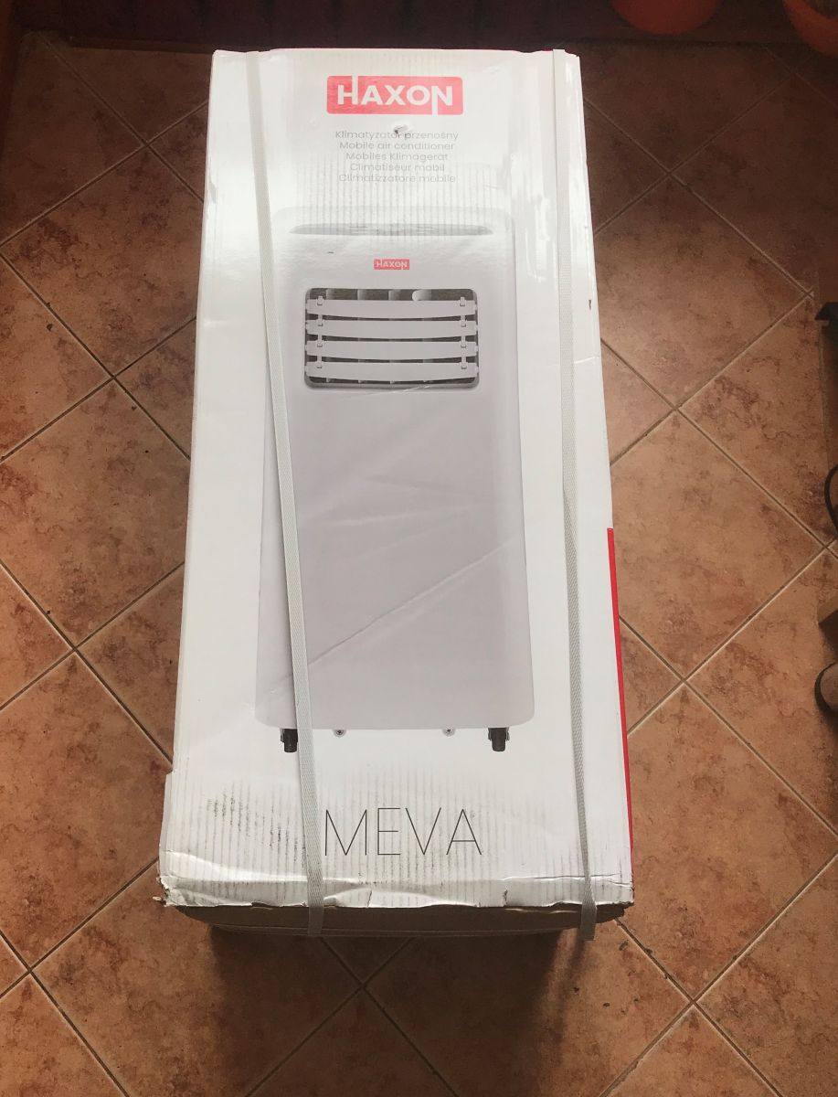

    First impressions
    The unit itself is large and heavy. The set includes a remote control, and the control panel features a simple display and several options, including two operating levels, an additional ‘silent’ mode, and cooling, dehumidifying and fan modes. However, after cycling through the available modes, you quickly realise that the noise level is similar across all settings, and the ‘Night’ button is really just for show.

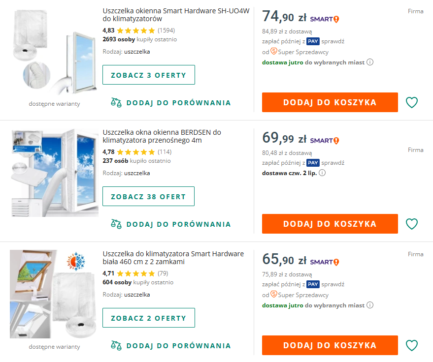

    Installation
    This device can be installed completely non-invasively. All you need is a sleeve that fits over the window. You can buy it for less than 100 zł. The catch, however, is that the poorer the insulation, the poorer the cooling performance. This brings us back to the same point I mentioned at the start – we pay for mobility with a loss of efficiency.

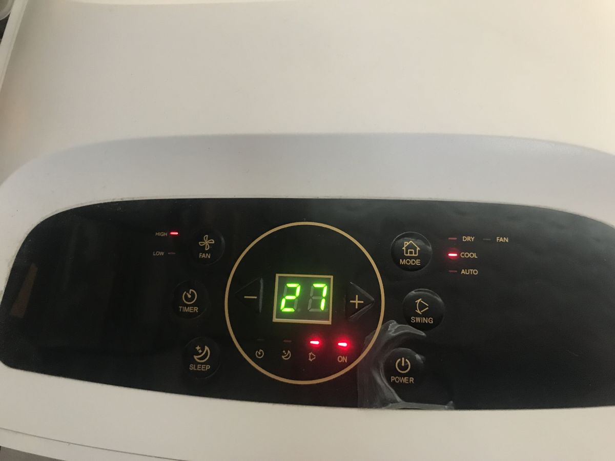

    Performance and operation
    The device displays the current temperature on the top front panel, and you can also set the target temperature there. However, I find this a pointless gimmick. I’ve never been in a situation where using this made sense during a heatwave, and I always cool the room down to an unattainable 15°C. What’s more, I don’t even see the temperature on the display dropping significantly after cooling.

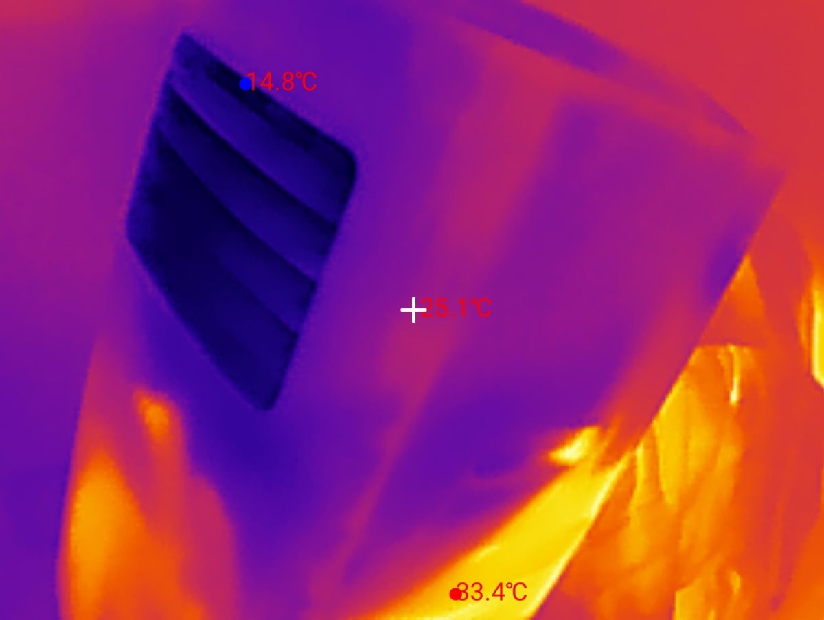

    Brief measurements

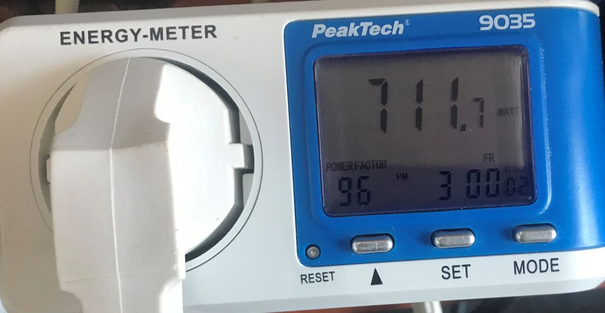

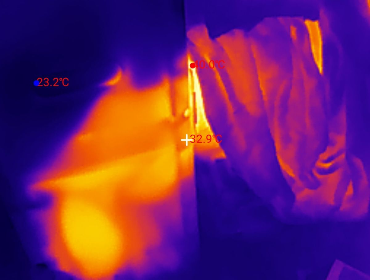

    For the tests, I used a standard plug-in energy meter and an InfiRay P2 PRO thermal imaging camera with a resolution of 256×192. The first thing I checked was how much power was drawn from the mains in different operating modes. Fan mode draws around 100 W, whilst Cooling costs us around 700–750 W, regardless of the selected setting or night mode – the differences are in the region of 20–30 W; on ‘Low’, the noise is indeed slightly lower.
    PeakTech 9035 energy meter display showing 711.7 W power draw
    A quick look at the thermal imaging, however, reveals that the unit is indeed working; the outlet temperature reaches up to 15 °C, and the exhaust pipe heats up to 40 °C or more.
    Thermal image of a portable air conditioner with readings 14.8°C, 25.1°C and 33.4°C Thermal image of a portable air conditioner and exhaust hose with temperature readings.

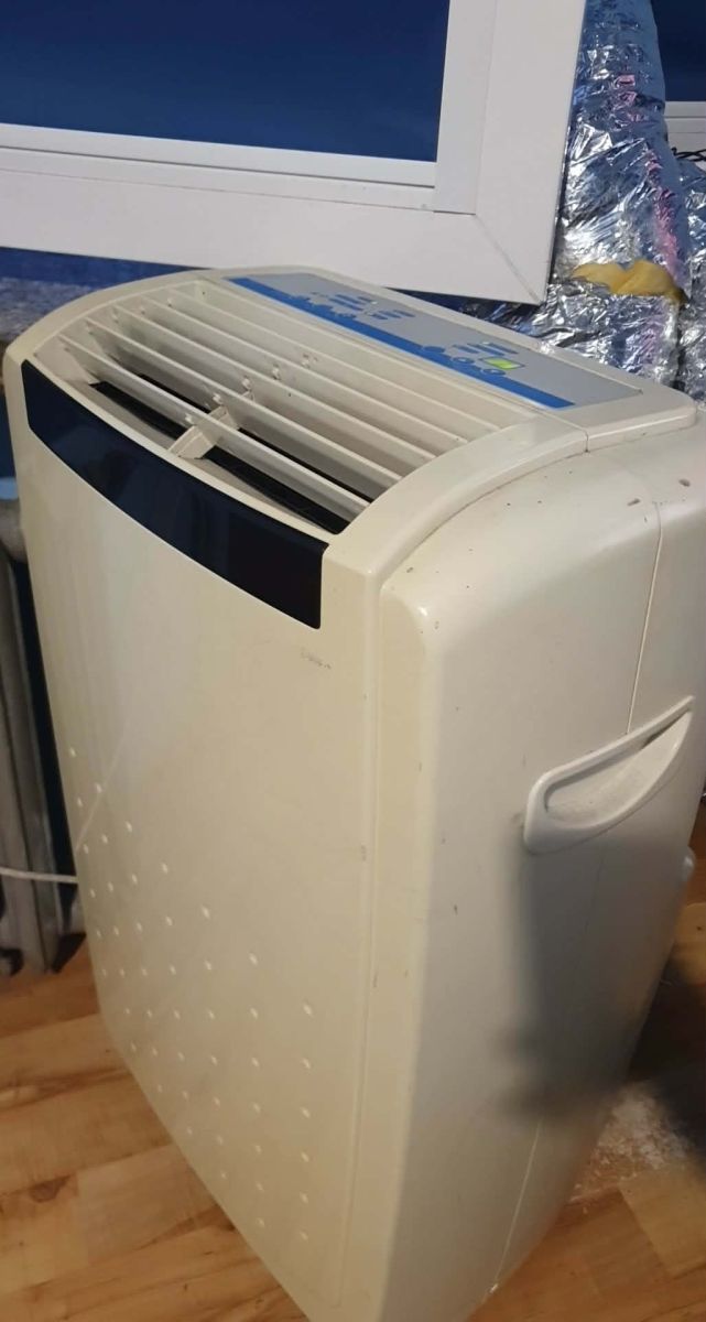

  • Portable AC works, but is noisy and compromises on cost
    #13 21929350
    kotbury
    Gantry automation specialist
    Posts: 9609
    Help: 2104
    Rate: 3642
    It’s a bit of a mixed bag. I’ve had one of these (Yoer PAC 02) for a few years now, with a heating capacity of 3.3 kW and a cooling capacity of 4.7 kW. Once you’ve put up with a few inconveniences, it’s not too bad. Admittedly, it was bought primarily for heating (my house has three levels, with the two lower ones served by split-system units and the top floor by this Yoer), so the cooling is a bonus for me.
    It’s incredibly noisy, unless you switch it to ECO mode. Oh well. It’s a single-pipe unit, but the exhaust duct is extremely short and the pipe is fitted directly into the lower insert of the balcony door via flanges. I don’t have a problem with negative pressure because on the north side (cold, with thuja and lime trees, etc.) I leave the tilt-and-turn windows slightly ajar.
    It’s a compromise – I couldn’t fit a split-system air conditioner due to lack of space, and it’s dirt cheap (about 1,100 zł). It cools sufficiently (it’s running right now).
    As for those combined units, I’d been thinking for a while about one where the back is outside and the front sticks into the flat. Like in American films. There’s no problem with negative pressure because the rear ventilation circuit is entirely outside, whilst the front one is entirely inside the flat. The only thing is that even a tiny one (e.g. 1.5 kW) costs as much as an average split system, even from a Chinese supplier, and you have to modify the window.

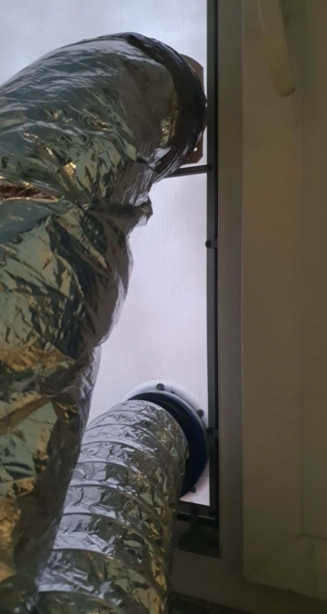

  • 3 mm polycarbonate window frame for portable AC
    #21 21929762
    zenon003
    Posts: 494
    Rate: 82
    For my air conditioning, I made a frame out of 3mm-thick polycarbonate and fitted it with suitable pipe fittings. I also painted the polycarbonate white. Against the white façade, it isn’t particularly conspicuous and looks quite neat. It doesn’t interfere at all with closing the window. I unclip the pipes in a few seconds and close the window. I can remove the frame itself just like a normal fly screen. It’s been in use for three seasons now and works really well. The negative pressure itself also has a second advantage. I only have one window, so it’s difficult to ventilate the room. There have been times when I’ve switched on the air conditioning for a few minutes, even when it wasn’t particularly hot, and removed the cool-air tube. A fairly strong stream of air then flows into the room.
    Two flexible silver AC hoses connected to a window insert with round duct fittings.
    Portable air conditioner by an open window with a white frame and a connected silver exhaust hose
