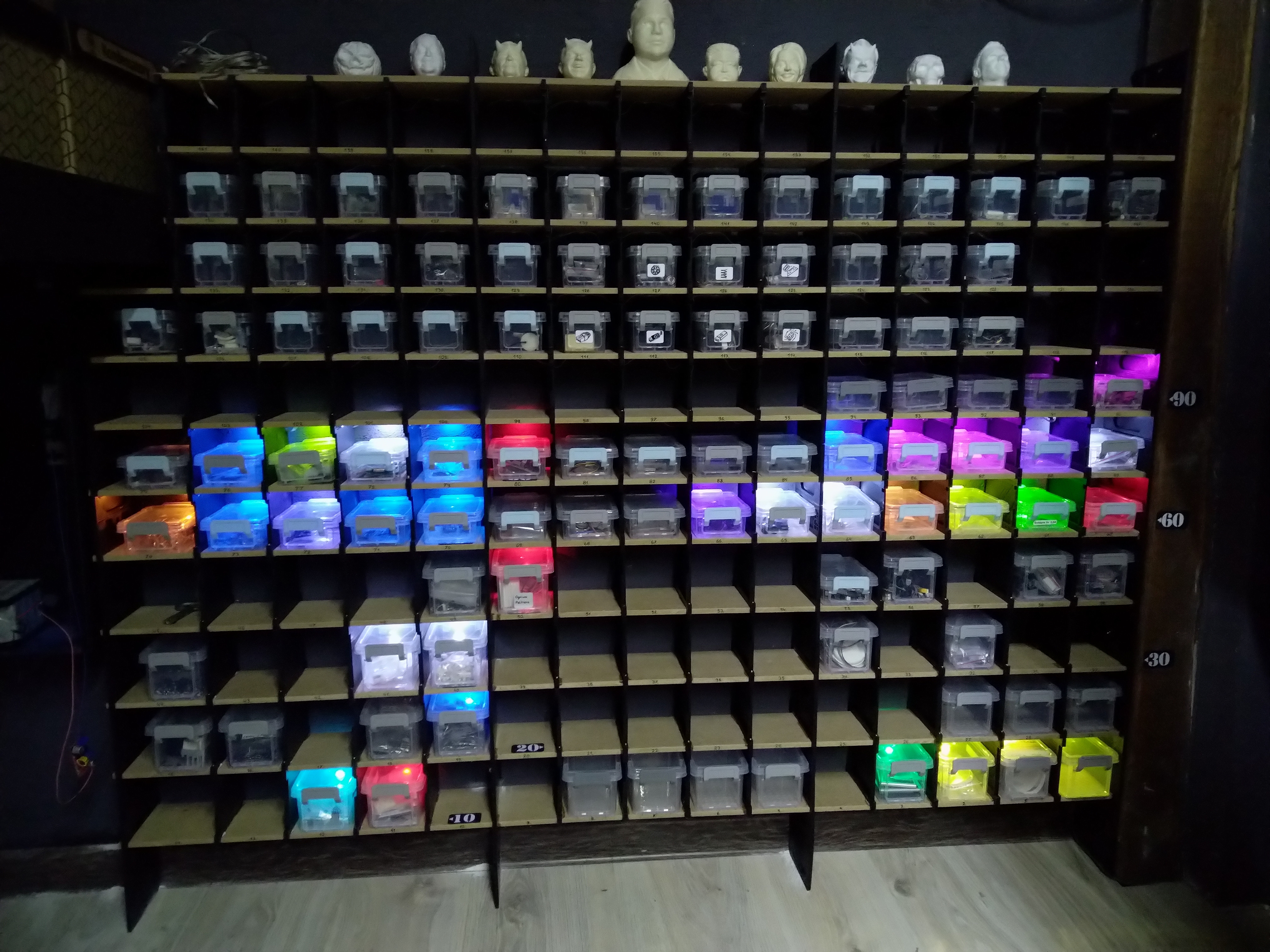

Hello esteemed forumers.
The year 2025 is upon us and, as is customary, it is good to have some New Year's resolutions.
I decided that I would start the new year by putting my studio, and workshop, in order.
What was my surprise when I opened the book calendar for 2025, where the first entry was the New Year's resolution: "Clean up the studio".
So I opened the 2024 calendar and to my eyes appeared a similar entry.
Paper calendar page with handwritten New Year resolutions
I decided to act and cleaned up the workshop first.
However, on reaching the workshop, I realised that the main cause of the mess was the lack of organisation in the small electronics.
Over the last few years I have been buying bins and organisers, stuffing what I need in there and trying to find a place for it all.
There have been many ideas, but so far I haven't fully implemented any of them because there has always been an "BUT".

Project assumptions:
-Cheap to build
-Simple to use
Over the last few years I have weaned myself on microchip programming and 3D printing with React,which has proved to be a saviour.
So I decided to combine a PC-based catalogue database with lights on the shelf.

In the meantime, I have made a few dozen compilations for the ESP8266 with better or worse results.
I was keen that, since the string of 200 WS2812B LEDs that served me last year as Christmas tree lights in the backyard under ESP8266 control and WLED batch on a 1 Ampere power supply, they should work on the computer's USB port alone, without external power.
This in turn means that we do not have to contend with operation over wifi, but operate the ESP via the serial port.
ESP configuration will be done via the WEB side of the device.
So I added Little FS, set the required memory parameters and....
Well it works, but during testing I found that when forcing the device from the WEB page, the device can crash (on the browser side - the rest was OK). I was a bit nostalgic for the ESP32, where I would simply separate the LED display animation and WEB and Serial page handling into two processes.
So I changed the OLED and WS2812B refresh to 30x per second and some other blocking options.
I removed the blocking Serial.readStringUntil() function and replaced it with a SerialBuffer, which collects characters in the background without stopping the CPU. Smart rendering and a few other small modifications were applied and so here we are on 4 January 2026 and the final version.
What remains are the shelves and assigning the appropriate colours, and animations.

The shelf lighting controller itself is nothing more than a WEMOS D1 MINI + OLED + (WS2812B LED string 10cm raster - 200pix)
// Of course with a resistor depending on the length of the wire to the LED and a 1000uF capacitor.
I hope that the project will arouse interest.
