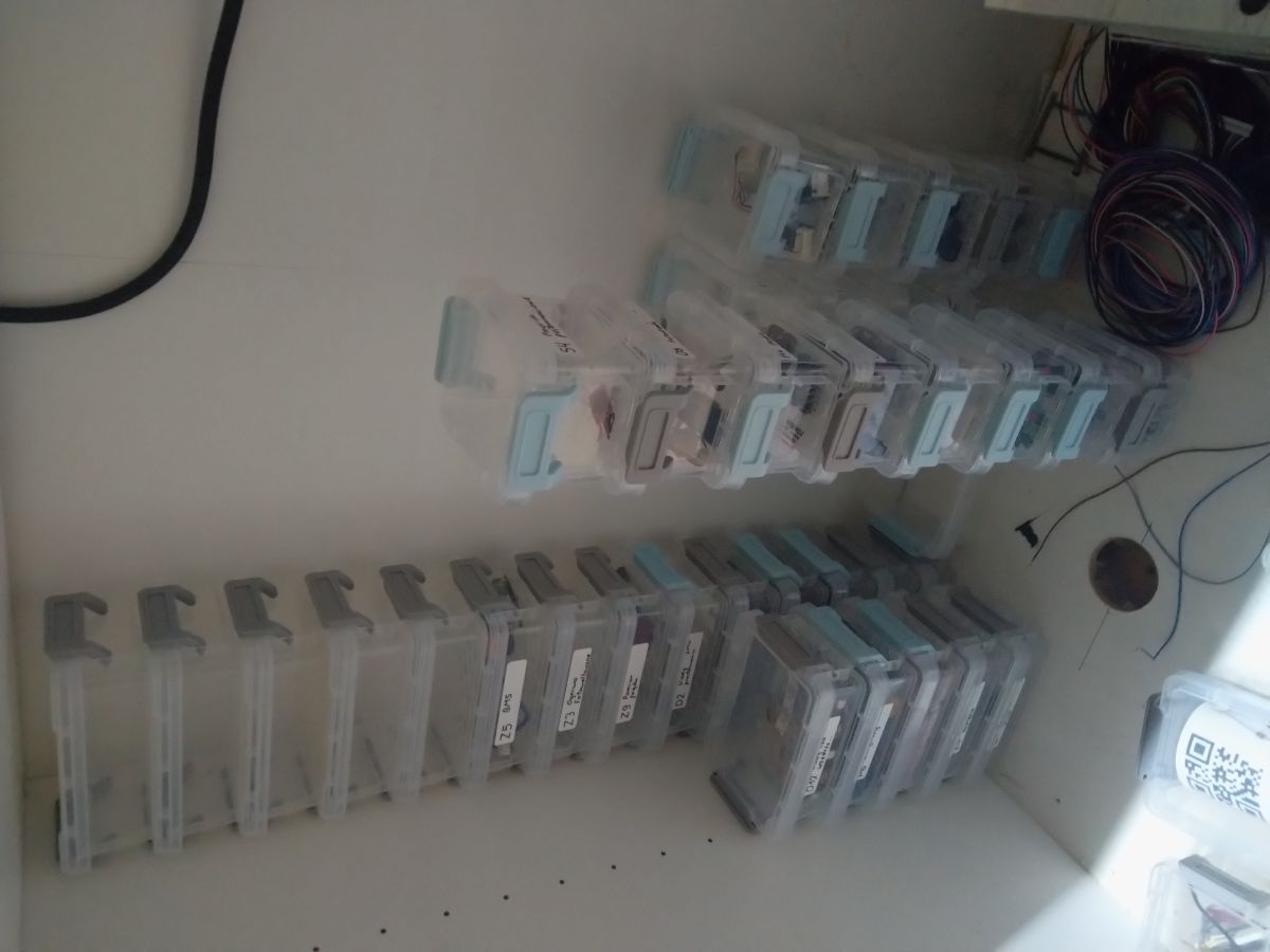

    However, on reaching the workshop, I realised that the main cause of the mess was the lack of organisation in the small electronics.
    Over the last few years I have been buying bins and organisers, stuffing what I need in there and trying to find a place for it all.
    There have been many ideas, but so far I haven't fully implemented any of them because there has always been an "BUT".

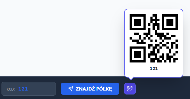

    So I decided to combine a PC-based catalogue database with lights on the shelf.
    As a first step, I needed to catch up on my PC program development.
    So I proceeded to create a program in the React Vite environment in combination with Electron for Windows directory support, and for a breath of fresh air use Tailwind.
    Much of the syntax has unfortunately changed a lot, but with the help of AI I thought I'd get some training.
    With two weeks of time over the Christmas period, I decided to split the project into three factions:
    1. PC database (Executable .EXE file)
    2. Program on ESP (I settled on ESP8266 version of Wemos D1 mini + OLED SSD1306 128x32 - I have some on hand)
    3. Bookcase (Using 3D printing)
    I started the design...

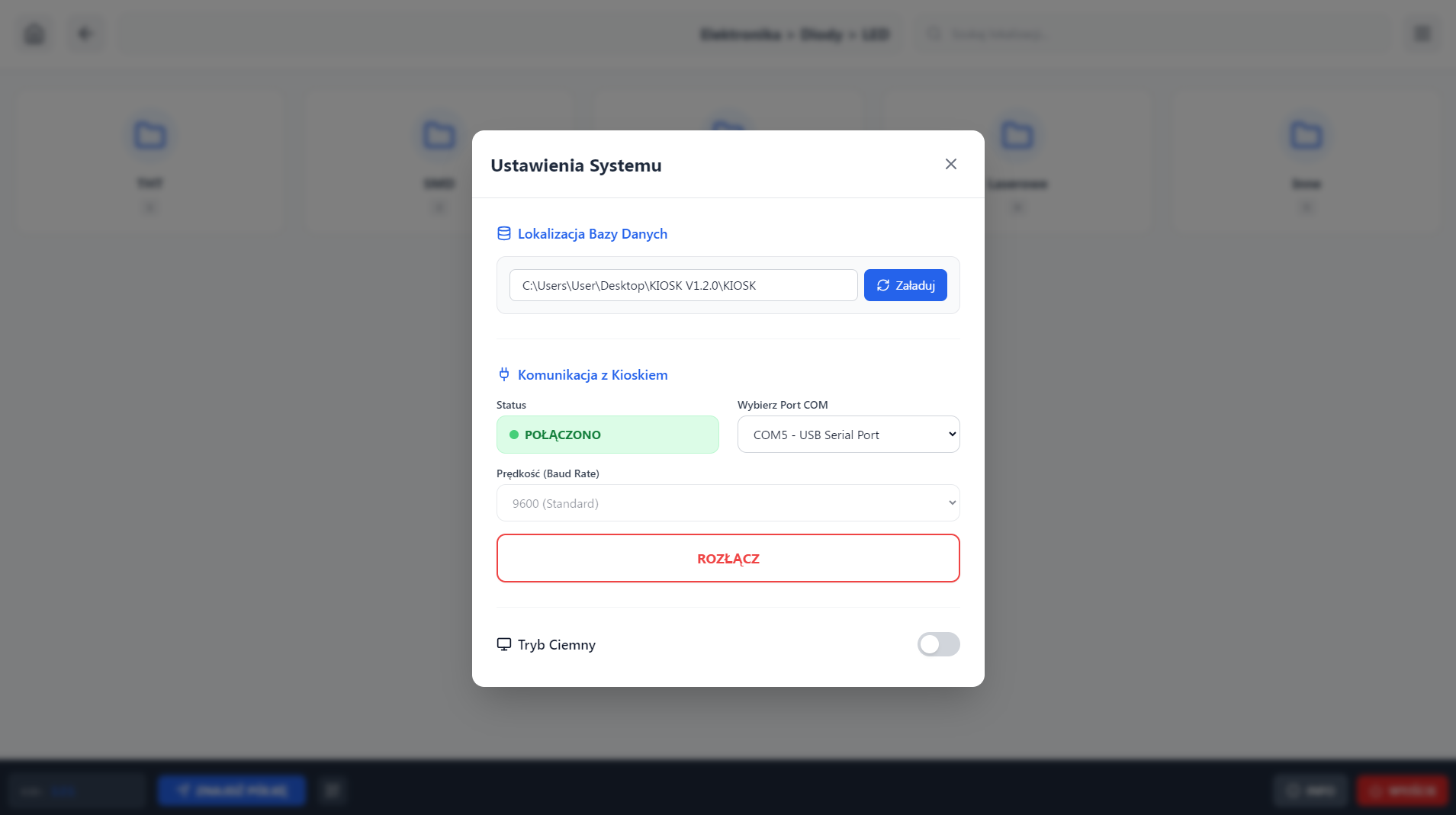

    Both the studio (computer with 2 screens) and the workshop (computer with 2 touchscreens) had to get their storage environments. The difference being that in one system the electronics and in the other more mechanics and spare parts.
    One PC runs on a 64 bit system, the other on an x86 system - it has to work on both.

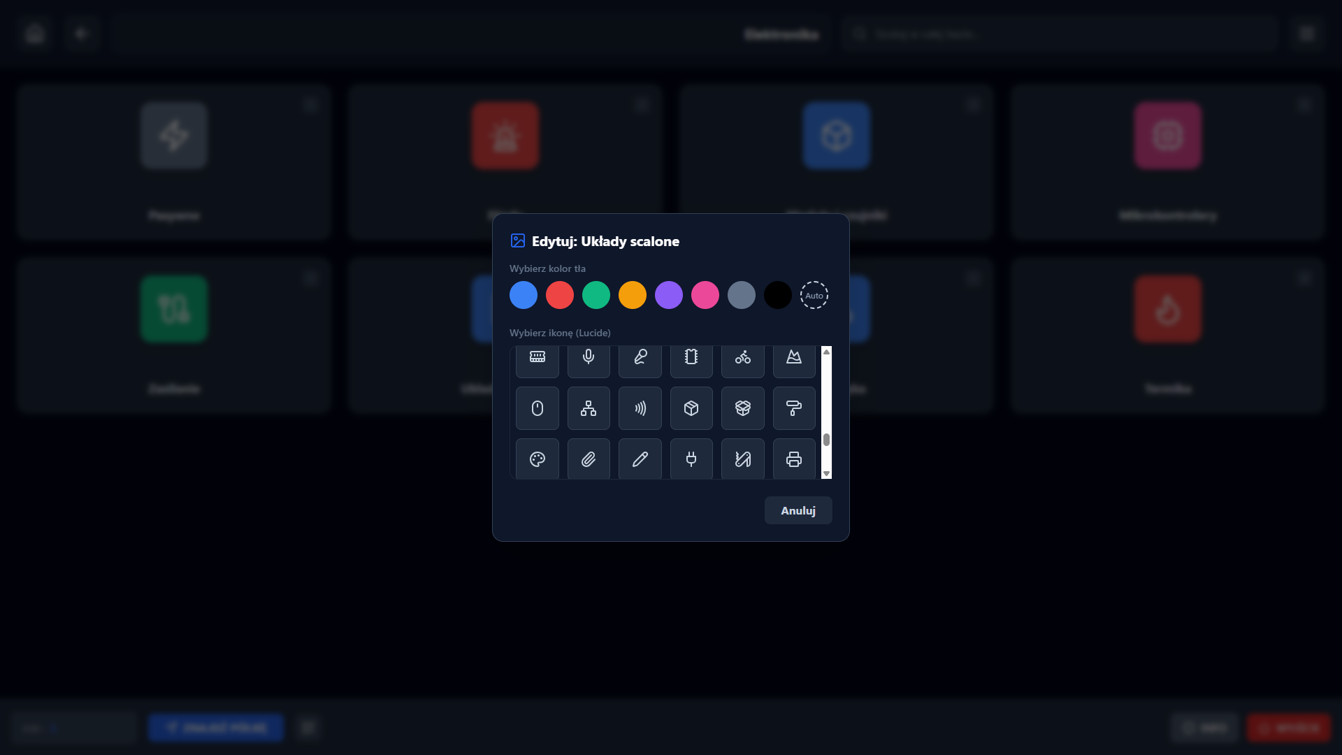

    At the outset, I set out to make the interface clear and fun to use, whether from a mouse, keyboard, touchscreen or code scanner (parsing required).

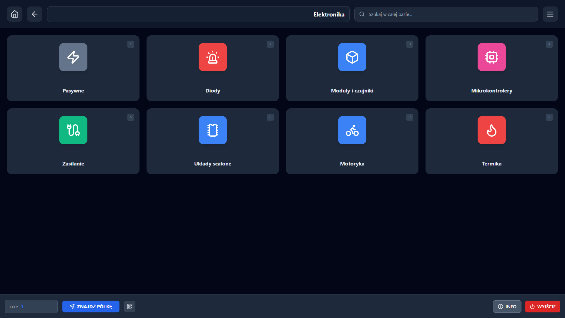

    The layout had to be simple:
    -Top bar (home location, back, path field access, search field, application MENU)
    -Bottom bar (Location code display field, button to send code to ESP8266, QR code frame, "info" field, and exit)
    -MENU (Database path indication field, port selection field for communication with ESP, option to change theme to dark)
    -MAIN SCREEN (folders with prefix as tile, and files opened with default Windows applications {.pdf, .png...}

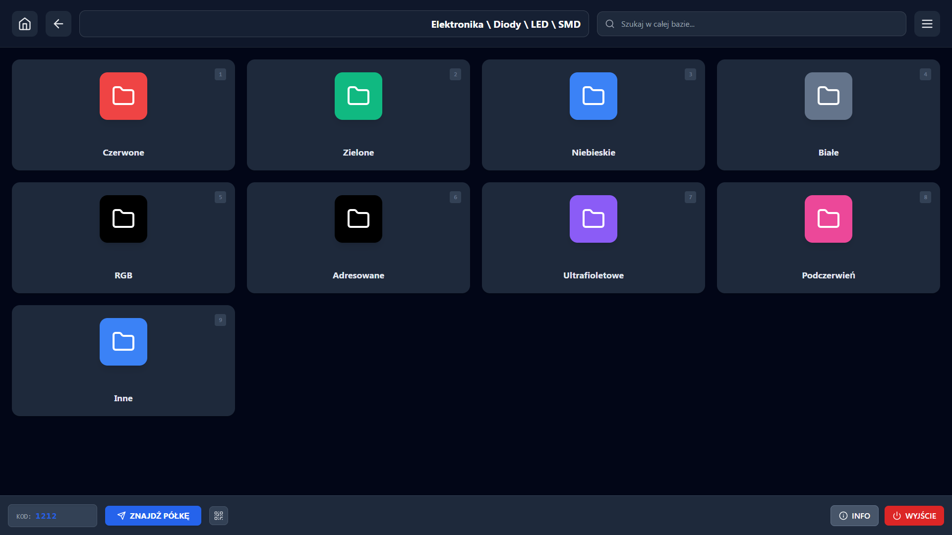

    Inventory app interface showing the LED directory in dark mode
    Settings window showing COM port connection and database path
    System Settings window showing connection via COM5 port
    Interface with “Find Shelf” button, QR code, and displayed number 121

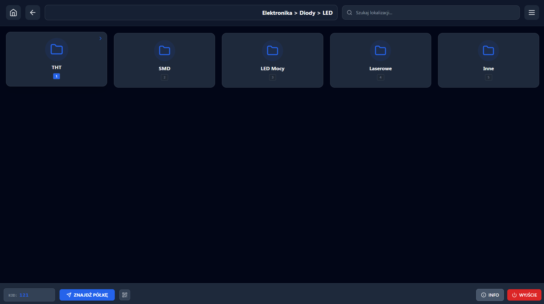

    Screenshot of LED category search in electronics inventory application
    In order to keep everything consistent and not drifting apart, I have decided that the directories will be numbered with a prefix (1_Electronics, 2_Chemistry...).
    In the program, however, we will show the name of the catalogue without the prefix, with the difference that the prefix will be used to navigate using the keyboard, or the attached code scanner on the boxes (in case you don't know where to put the code box)
    Each directory with a prefix can contain other directories inside with a prefix as well (the so-called children of the parent directory)
    An example of part of my directory structure:

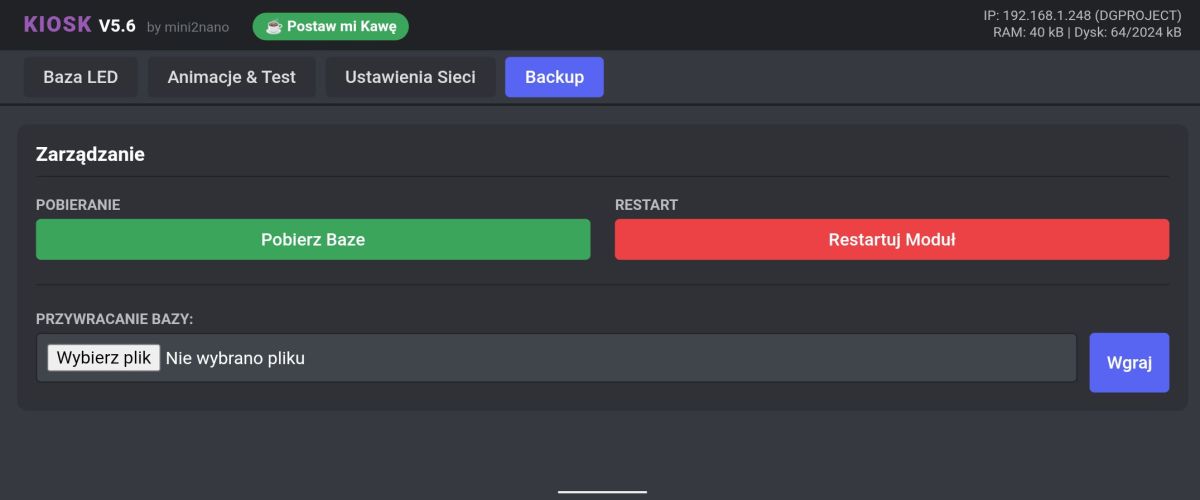

    In the meantime, I have made a few dozen compilations for the ESP8266 with better or worse results.

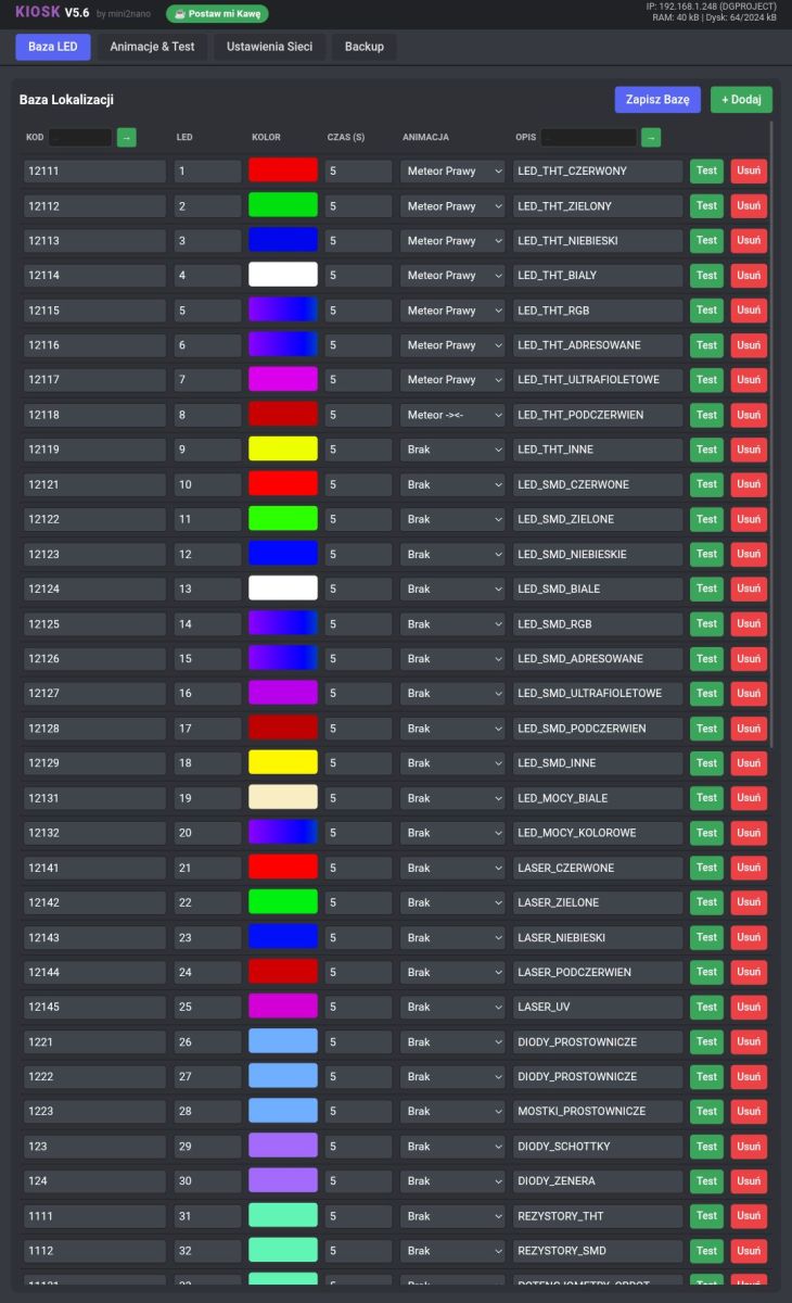

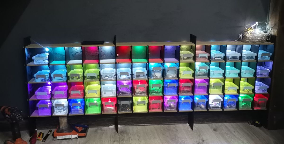

    I was keen that, since the string of 200 WS2812B LEDs that served me last year as Christmas tree lights in the backyard under ESP8266 control and WLED batch on a 1 Ampere power supply, they should work on the computer's USB port alone, without external power.
    This in turn means that we do not have to contend with operation over wifi, but operate the ESP via the serial port.

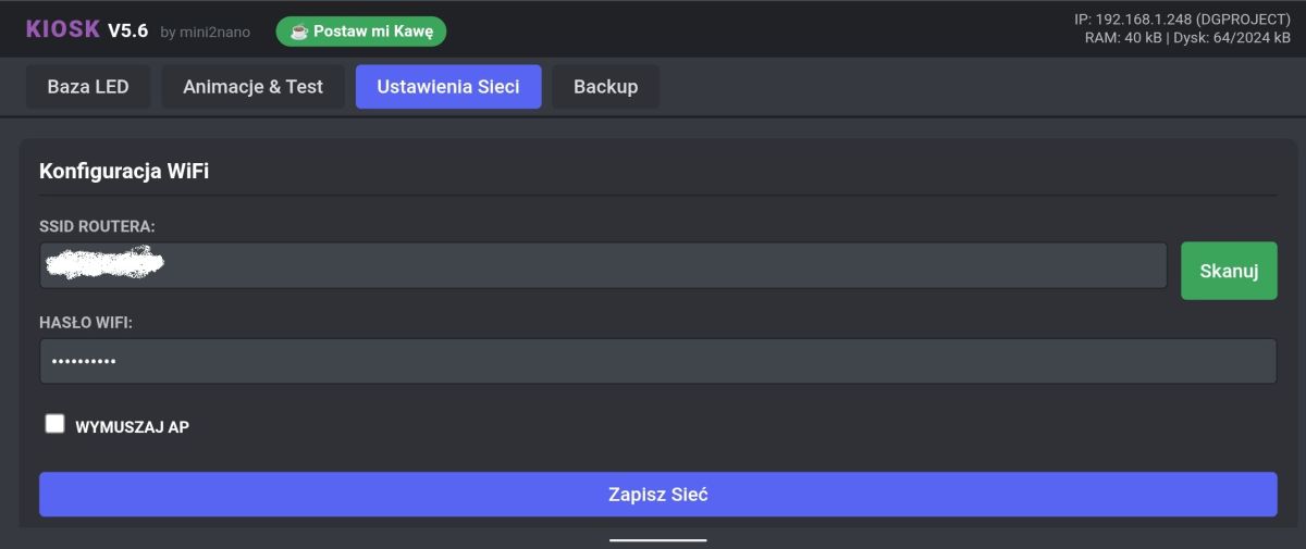

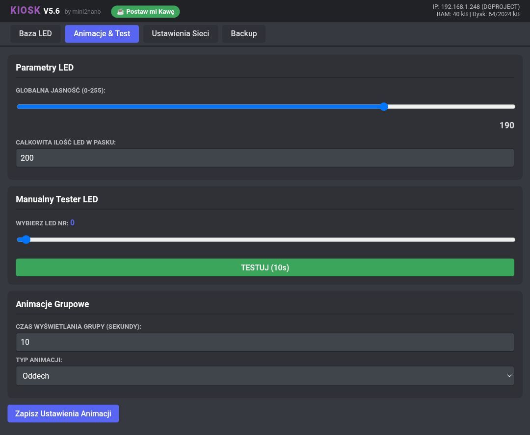

    ESP configuration will be done via the WEB side of the device.
    So I added Little FS, set the required memory parameters and....
    Well it works, but during testing I found that when forcing the device from the WEB page, the device can crash (on the browser side - the rest was OK). I was a bit nostalgic for the ESP32, where I would simply separate the LED display animation and WEB and Serial page handling into two processes.
    So I changed the OLED and WS2812B refresh to 30x per second and some other blocking options.
    I removed the blocking Serial.readStringUntil() function and replaced it with a SerialBuffer, which collects characters in the background without stopping the CPU. Smart rendering and a few other small modifications were applied and so here we are on 4 January 2026 and the final version.

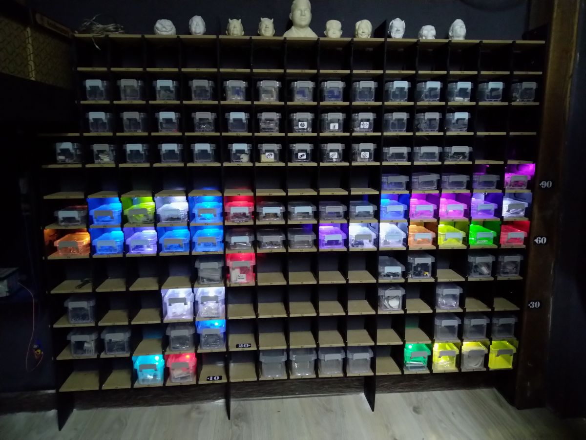

    What remains are the shelves and assigning the appropriate colours, and animations.

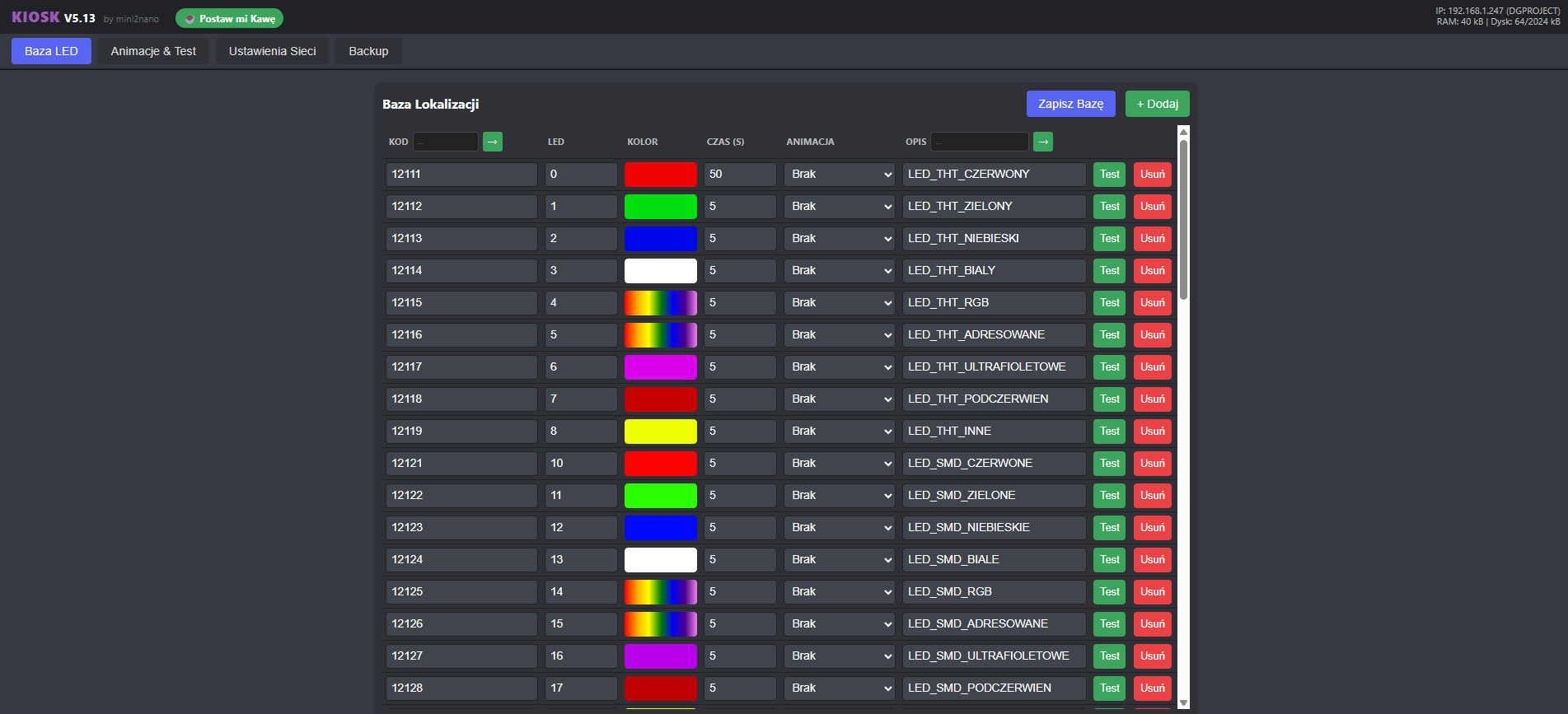

    LED control panel with location and animation database on web interface

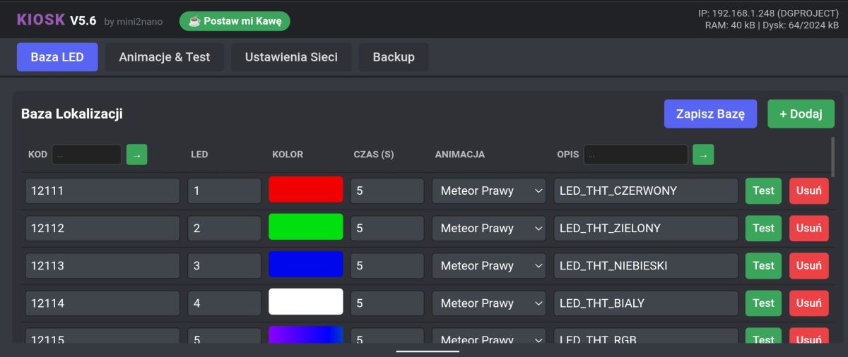

    In ESP, I used the option to display a location defined by a colour with the possibility to select one of the three available animations in the form of a following light to the target (from one end, the other, or both at the same time) - the METEOR Effect.
    When we return in the application to the catalogue parent) illuminates all the items inside the catalogue in the defined colours, with the difference that we can define in the menu the effect of illuminating multiple fields simultaneously and specify the lighting time and power.
    To make it easier to save the database, and to show e.g. LED RGB, I have also added a shimmering rainbow colour pixel assigned to absolute black in the colour palette (colour:000000)
    The database is saved in a readable way, giving the possibility to be more ambitious, edit even from an EXCEL data sheet.

    There is no great philosophy here, and after a few days of playing around and bug-fixing, the program was run in a version that finally satisfied me.
    In the meantime, I made a few dozen compilations for the ESP8266 with better or worse results.
    I was keen that, since the string of 200 WS2812B LEDs that served me last year as Christmas tree lights in the backyard under ESP8266 control and a WLED batch on a 1 Ampere power supply, they should work on the computer's USB port alone, without external power.
    In ESP, I used the option of displaying a location defined by a colour with a choice of one of three available animations in the form of a following light to the target (from one end, the other, or both at the same time) - the METEOR Effect.
    When we return in the application to the parent catalogue, all the items inside the catalogue light up in the defined colours, with the difference that we can define in the menu the effect of lighting up many fields simultaneously and specify the lighting time and power.

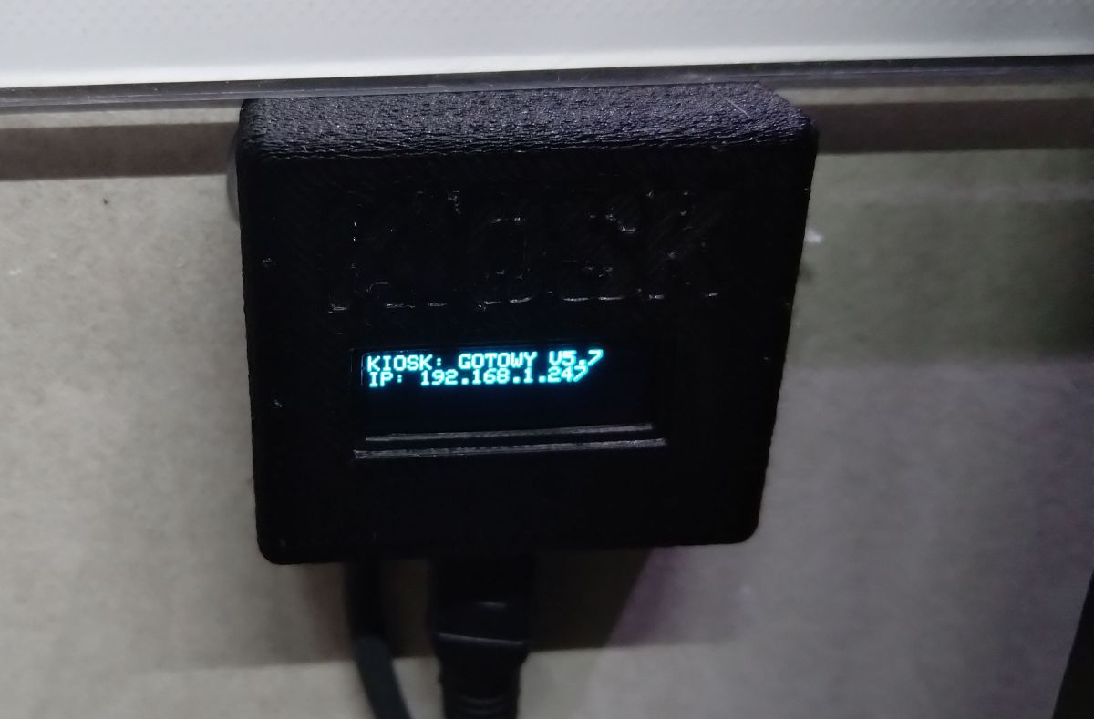

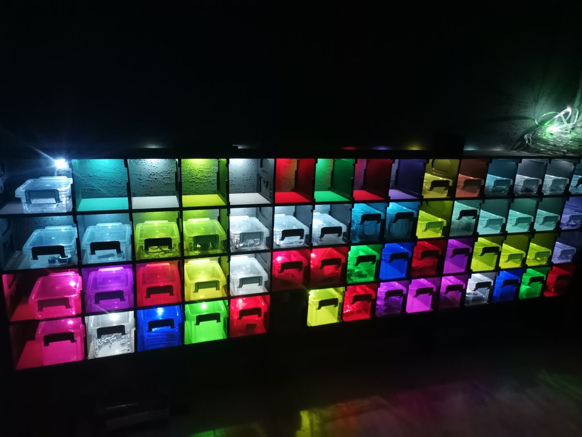

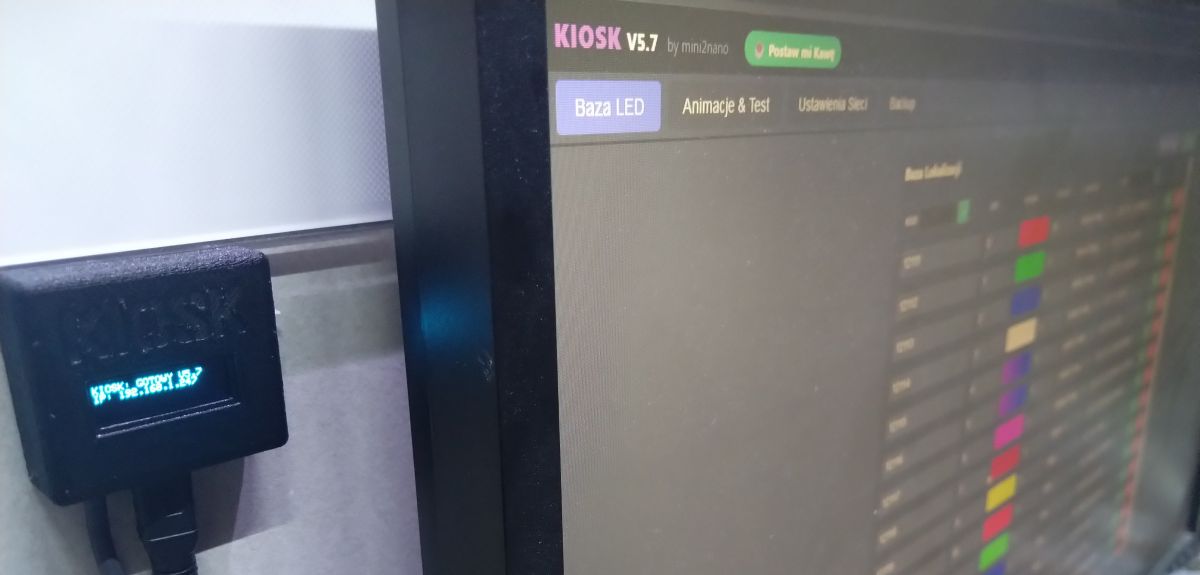

    The shelf lighting controller itself is nothing more than a WEMOS D1 MINI + OLED + (WS2812B LED string 10cm raster - 200pix)
    // Of course with a resistor depending on the length of the wire to the LED and a 1000uF capacitor.
    I hope that the project will arouse interest.

    KIOSK V5.6 app interface with an LED table, color indicators, animations, and controls
    LED control panel with brightness settings, test function, and animation options

    WiFi configuration panel in KIOSK V5.6 app on ESP8266
    OLED display with ESP8266 next to monitor showing KIOSK V5.7 application interface
    ESP8266 module with OLED screen showing KIOSK status and IP address
    Programme operation on PC
    WEB page operation on ESP8266

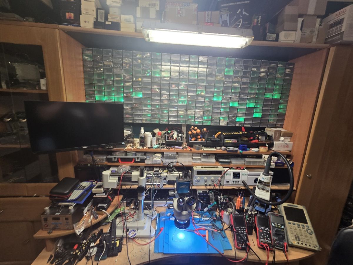

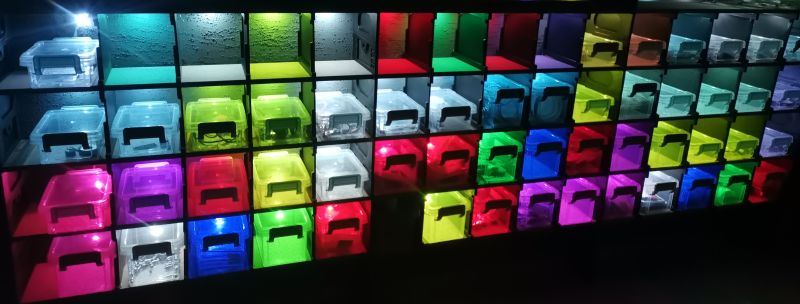

    I made myself such an organiser based on some existing design some time ago and I highly praise it.
    In idle mode the Matrix effect.
    Electronics workstation with LED-lit organizer and stereo microscope
    The item drawer indication looks like this because on a fully loaded drawer the led was not quite visible:
    And this is what the interface looks like that I converted for my needs:

    yanek231 wrote:
    Indicating the drawer with the item looks like this because on a fully loaded drawer the led was not quite visible
    I also wondered about the placement of the LEDs in the shelves and they eventually mount above the bins. I'll admit I've looked at your videos a few times and with this I've added another important feature, which is pointing to empty locations. Thanks, it works divinely....
    More shelves trimmed and I'm waiting for the delivery of Filament to pile further up.
    As soon as I complete the shelves I'll upload a video.

    KIOSK app interface with LED category folders on a dark background
    Screenshot of the LED control panel in KIOSK V5.13 software

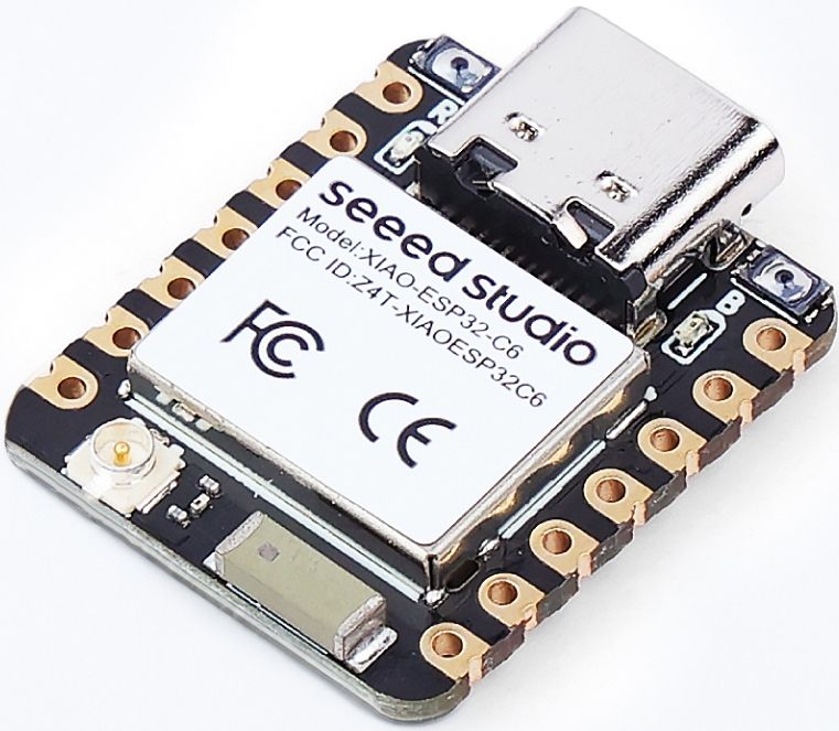

    While I am still struggling with the PC kiosk and another version has been created with some new features, I have reached a fence with the ESP8266.
    It is known that every fence can be jumped, but the further I delve, the more problems I encounter with the WIFI - WS2812B stability connection.
    I've come to the conclusion that the V5.13 version to be supported will be the last stable version on ESP8266 and it's time to switch to ESP32.
    Initially, I will base the project on a chip that I already use in several of my DIY projects and which performs quite well.
    That is: Seeed Xiao ESP32-C6
    Seeed Studio XIAO-ESP32-C6 microcontroller with USB-C port and side pins visible
    The shelves are slowly creeping upwards, and even at 40% power output (which seems sufficient in my studio) the shelves are animating quite substantially.
    Color-lit plastic storage bins arranged in a workshop shelving unit
    The ESP32 will be given more ambitious tasks.
    In addition to the WS2812B LED support, it will be given the task of controlling several drives, Bluetooth BLE cooperation with active WIFI for kiosk cooperation.
    In short, it will have the ability to be a pointing device as before, and to work as an independent storage robot with its own power supply.
    In the meantime, I am focusing on the KIOSK base programme and its functions.

  • Anti-static bag storage with grouped plastic containers
    #17 21806065
    Ondo
    Posts: 104
    Rate: 17
    I don't understand the idea of this project at all, apart from the wow effect and the educational effect for the creator, of course. If an electronics engineer came to my recruitment and said he had done it himself, I would probably hire him on the spot.
    But on a day-to-day basis I don't see the use, of course such a thing helps to organise a workshop where many people work, or some hackerspace, but for one person the management overhead is too great.
    I'm a clutterer myself, but I like to have order. At my place, I keep items in anti-static bags, and I group these together. I have about 10 5-litre plastic containers with lids, grouped resistor, processor, connector, chemistry, mechanical. plus two 1-litre hand-held containers for THD and SMD "hand-held" components. The large containers stand two, max. three on top of each other.
    The bigger storage problem is hardware and tools.
  • #18 21806128

    A couple of conclusions during the development of the new version.
    I am a bit puzzled about the code parsing from a code reader connected to USB as a keyboard.
    In program version V1.2.0, the option should work by default , unfortunately there is a small BUT.
    Well, either the keyboard or the scanner - in the case of keyboard-based scanning, we must always be in the ROOT location of the project.
    I've done some thinking and there are a lot of options (after all, we can switch the scanner to work like a standard from the previous era on RS232 etc.)
    I have currently made some small visual and functional modifications:
    1. I added the possibility to select a directory icon and change its colour from the right-click of the mouse (Lucide-React).
    2. I added the possibility to open both files inside the directories (manuals, drawings...), and to open the directory locations in a separate Explorer window.
    3. A configuration file "Kiosk_config.json" will be created in the ROOT location with the moment of design changes, which can be edited, for example, in VS Code.
    4. Some minor visual and functional improvements have been made.
    5. The scanner support has been dropped (temporarily) - Solution to be considered - I am considering handing over this function to ESP32 (after all, it does the executive)
    In the next version I will implement bidirectional communication with ESP.
    New version available below...
    https://drive.google.com/drive/folders/1hnoxh2GpS30uNQiNsFQavRU_DW0FagfV?usp=sharing
    Application interface screen with electronic component category tiles.
    Edit folder window with background color and icon selection in dark theme app
    Thank you all for your good advice, support and of course Kawka :)

    #25 21809966
    dgproject
    Posts: 183
    Rate: 272
    I followed your advice and initially in the new version 1.3.0 I added support for storage database .
    I'm at the stage of making minor tweaks for now, so I'm not making the finished product available yet.
    At first I was sceptical about this due to the fact that the programme was only meant to call out shelves.
    But after I slept on the subject for a few nights, I came to the conclusion that since an automatically generated "kiosk_config.json" file was already used to handle the Lucide icons and the colour scheme on the tiles, what stands in the way of doing the same in other locations using the right-click in the background of the application.
    After clicking on the free space, you will now see the option to add in the location of the component base and enter the data.
    In a nutshell, we add an array of objects (1/3 of the available space) at the bottom.
    I thought long and hard about what the individual columns should be and tentatively fell into:
    LP / SYMBOL / TYPE / CABINET / DESCRIPTION / QUANTITY / MINIMUM / DOCUMENTATION
    However, I think I still need to work on this a bit more, as not everyone will want to use the app just for electronics.
    I myself, by the way, am trying on the workshop to stuff tools, screws etc.
    I'll probably replace the field "SYMBOL" with "NAME" and expand a bit at the expense of the description.
    I definitely still need to add an option to search through all the .json database files so that the item can be found from the search field.
    I have additionally added a function in the menu that recursively goes through all folders, reads the "inventory.json" files and glues them into one large CSV file.
    Maybe some suggestions?

    I have it implemented like this:
    I must admit that it looks quite interesting 🤔
    However, I personally put a lot of emphasis on security, simple solutions and at the same time lightweight for older machines.
    Nevertheless, the app for both systems already has a weight of almost 200MB on its own.
    Today I squatted on the option to work with AI to import icons from the React Icon repository for the magazine, and I have to admit that it went quickly, but it's been a long time since I've seen so much havoc in the code despite clear and specific guidelines.
    In short, I'm left with CTRL+C / CTRL+V 😅
    And looking at the multitude of icons, I'll probably spend all of Saturday choosing the right icons.
    I think I'll manage to finish the new version of the Kiosk this weekend.
