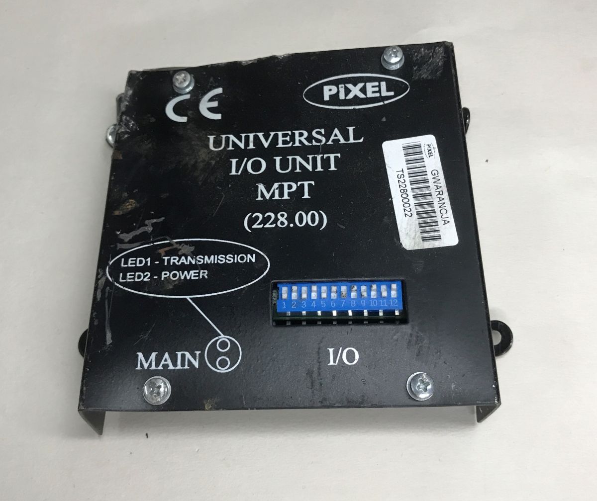

  • Black “PIXEL Universal I/O Unit MPT” module housing with a 12-position DIP switch and LED labels

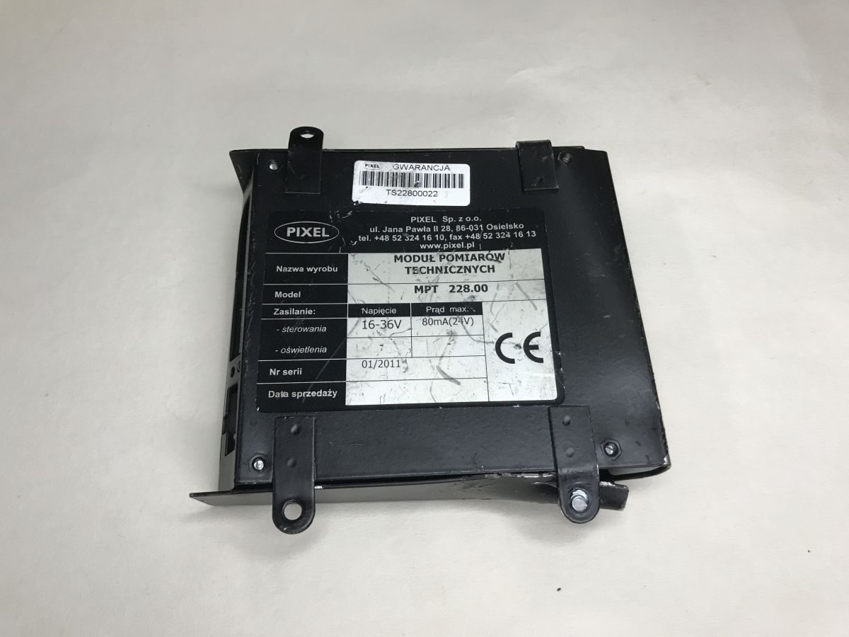

    Here's the inside of another 'railway' equipment after decommissioning. This time the casing is pretty much squashed, but it's still worth a look inside - what is the so-called 'technical measurement module'? The English name is Universal I/O Unit MPT, which suggests it's an expansion card of some sort.
    Black metal PIXEL housing labeled “Technical measurements module” MPT 228.00, 16–36 V
    Operating voltage is 16-36 V, current up to 80 mA (at 24 V). It looks, to me, like a Polish design.
    We remove the cover:

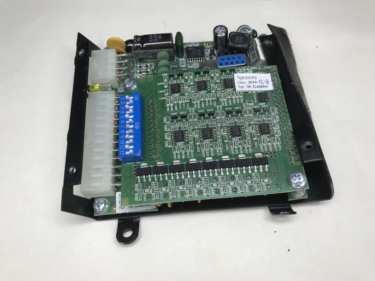

    PCB I/O module in a metal frame with connectors, a blue DIP switch, and a “Sprawny” label.
    The centre resembles that of the GPS module shown earlier - we also have the programming connector and the LED display here, which has been hit quite hard. The boards here, however, are two.

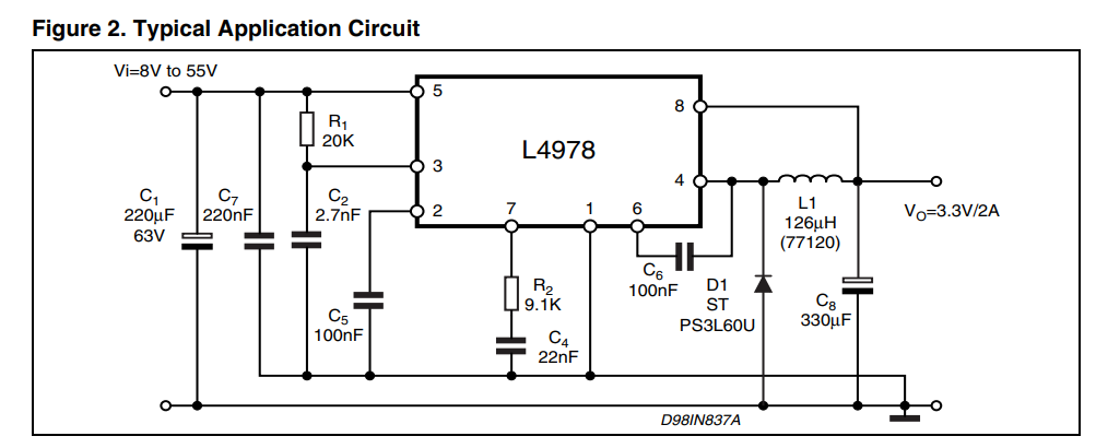

    The power section is based on the L4978D, which is a DC-DC converter that reduces the voltage.
    “Typical Application Circuit” schematic for L4978 with inductor, diode, and capacitors
    The coil has unfortunately also flopped.

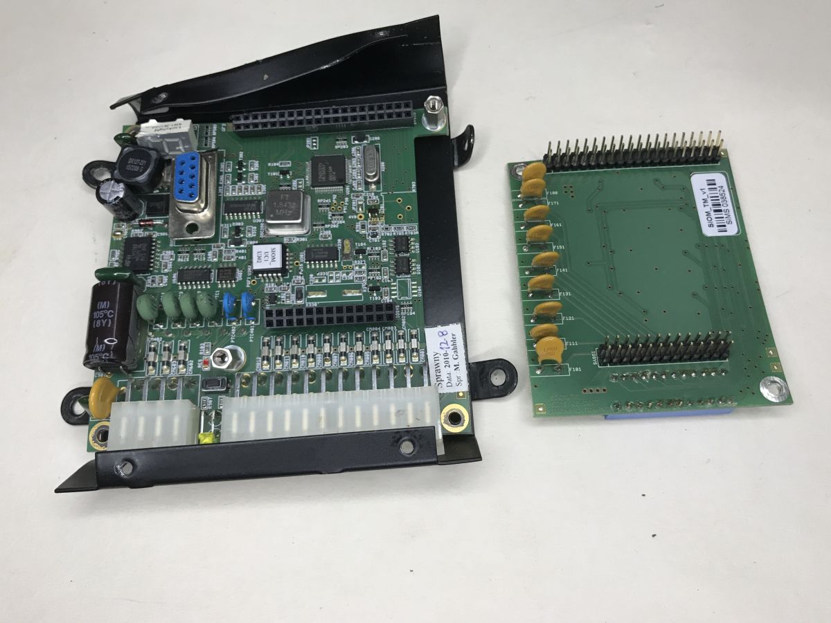

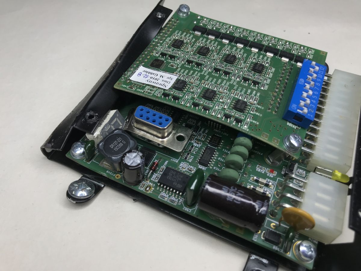

    Let's remove the top PCB:
    Two PCBs from industrial electronics: main board with DB9 port and connectors, plus a smaller daughterboard
    The coil, however, has also flopped:

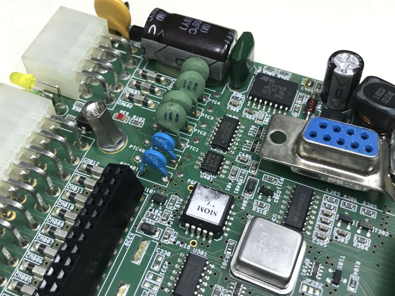

    Close-up of a PCB with ICs and a blue DB9 (RS‑232) connector
    Here we see the main 16-bit MCU (H8/36057), the TTL-RS232 ST232C converter (from programming? This RS232 connector is not visible on the case), and the circuits from level conversion to the main communication bus (TJA1040 and SP491EEN), successively CAN and RS422. These lines are protected by PTC thermistors:

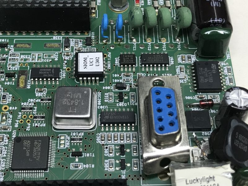

    Close-up of a PCB with H8/36057 IC, crystal oscillators, and pin headers
    And then there's the 74HC14D - inverter, Schmitt flip-flop, probably in the buffer role?

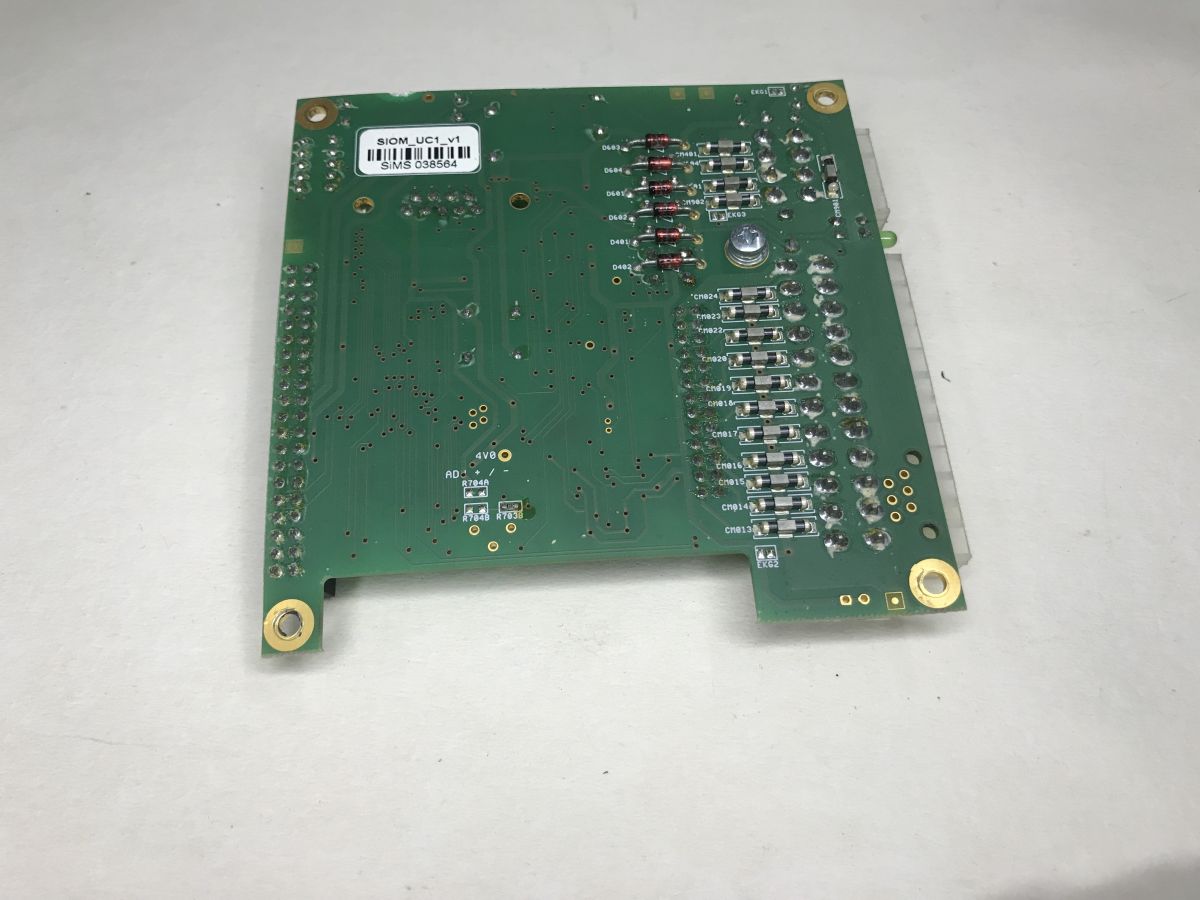

    Bottom of PCB:
    Bottom view of PCB labeled SIOM_UC1_v1 with SMD components and barcode sticker.

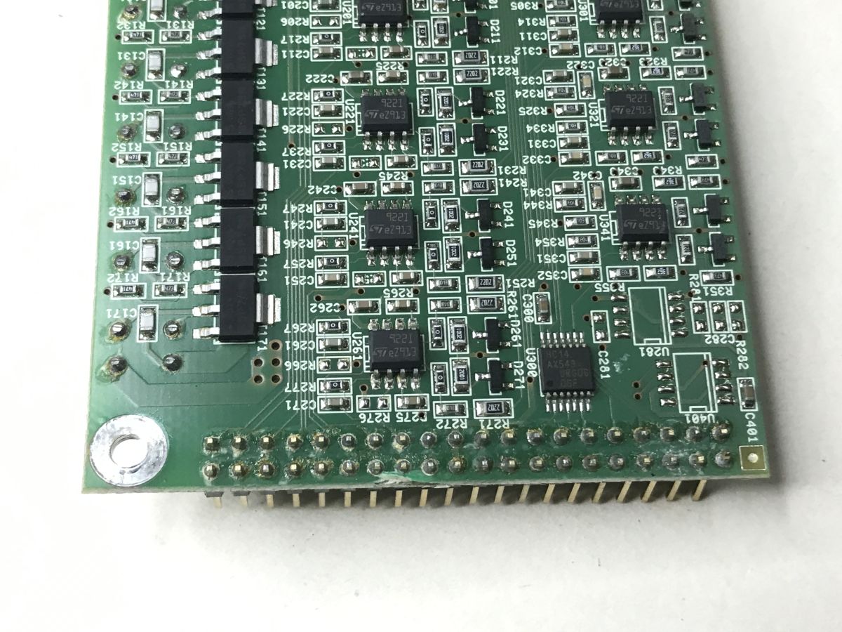

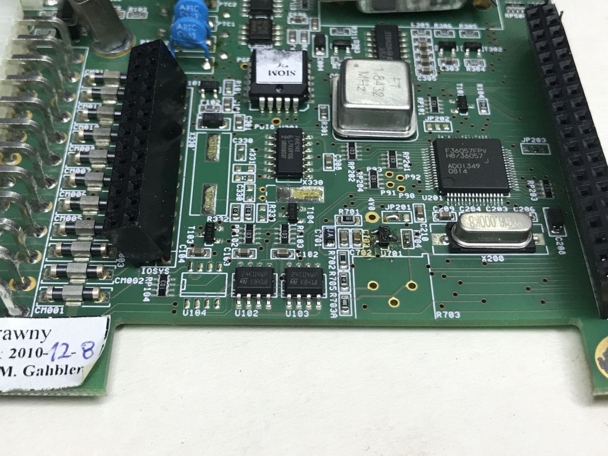

    What remains is the IO overlay. From what I count, the connector on the outside is 2x12 and from the IO board is 2x13.
    Close-up of the lower part of a green PCB with multiple ICs and a pin header

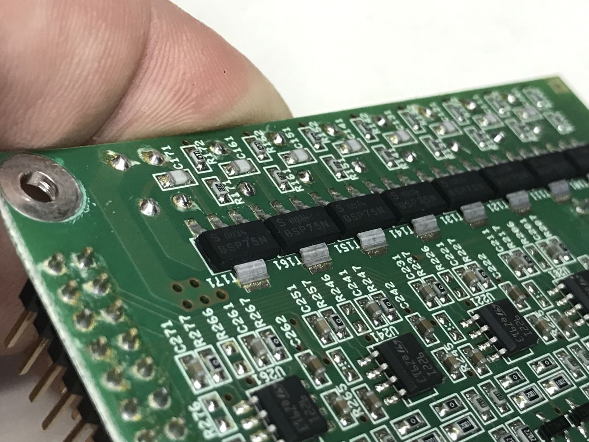

    There is a single HC14 on the board, presumably in a buffer role. In addition to this we have 7 operational amplifiers 9221 (TS922IDT). There are 8 BSP75N transistors at the output:
    Close-up of PCB with BSP75N transistors and SMD components

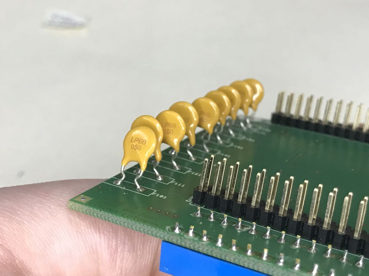

    At the bottom we still have 0.50 A 60V LP60-050 polymer fuses:
    Close-up of LP60-050 yellow polymer fuses on a green PCB with gold pin headers
    It's difficult for me at the moment to make a fully reliable assessment of what the role of the TS922IDT is in this circuit. My guess is that it is the inputs. Is anyone reading able to supplement?

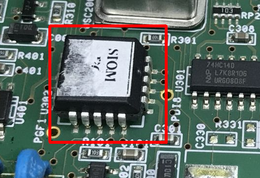

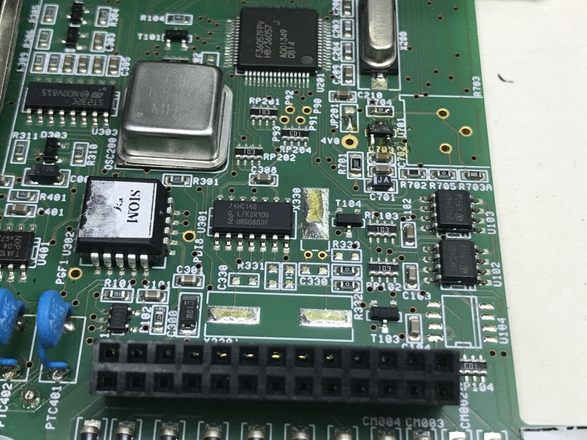

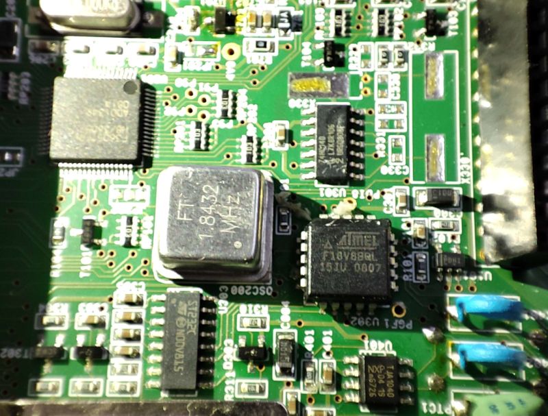

    >>21818045
    IC labeled 10K in DIP package on a green PCB with visible solder traces
    And what designation does this circuit have? Just asking out of curiosity. There is a similar one in the post about GPS
    Could there be a GAL?
  • #4 21818756
    Posts: 14791
    Rate: 12937
    And fact, I was also supposed to give a photo after peeling off.
    Close-up of a PCB with Atmel ATF16V8BQL PLD and electronic components
    F16V8BQL - PLD, Programmable Logic Device.

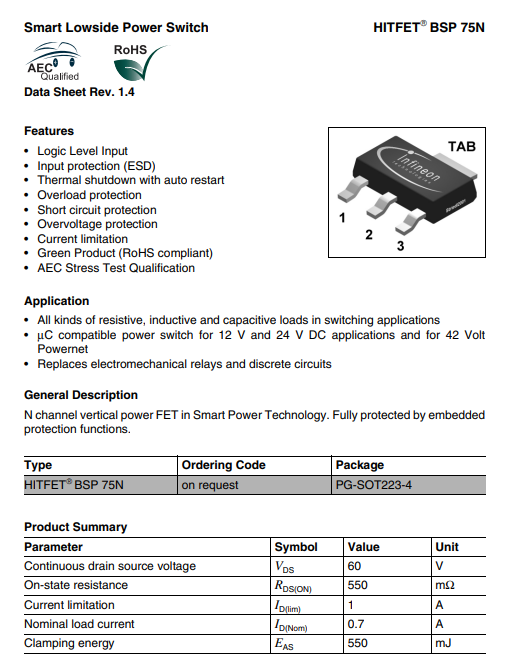

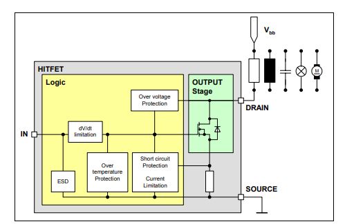

  • BSP75N identified as smart low-side switches
    #5 21819771
    Neorecormon
    Posts: 26
    as to the presented device :
    "There is a single HC14 on the board, probably in the role of buffer. In addition, we have 7 operational amplifiers 9221 (TS922IDT). There are 8 BSP75N transistors at the output :"
    These are not transistors but Smart Low Side Power Switch. Mosfets with integrated switching circuitry replacing relays. the operational amplifiers are rail to rail are part of the level converter from 0-60V to the prock logic :)
    J_Bravo is correct in those years Pixel sold and serviced and Sims manufactured the devices. Both Pixel and Sims are in the passenger information systems business for railways and buses and design electronics and enclosures. Both companies have their origins in KZŁ in Bydgoszcz.
  • #6 21819779
    Posts: 14791
    Rate: 12937
    Thanks for the clarification. There is indeed more hidden in their catalogue note than I thought:
    Block diagram of HITFET circuit with input, output, and protection features
    Infineon HITFET BSP 75N datasheet with features and parameter table
    And for that Logic Level Input... will probably come in handy for other projects.
