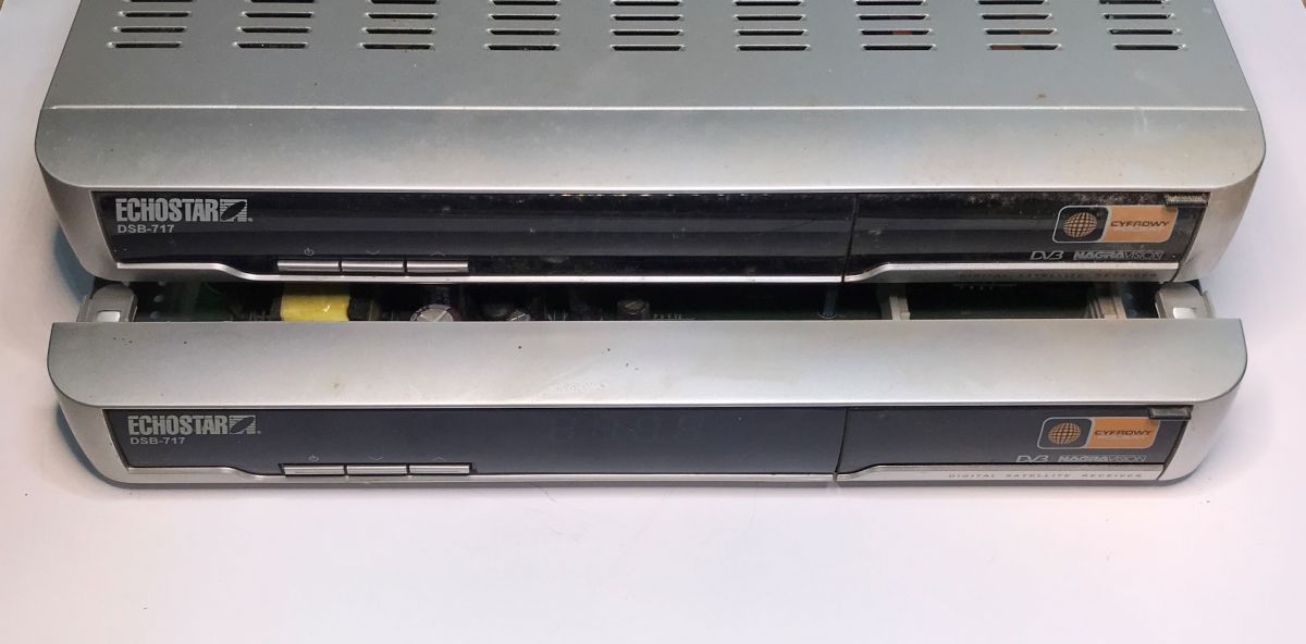

  • Two silver-and-black EchoStar DSB-717 satellite set-top boxes stacked on a table
    Time to present the interior of another slightly older piece of equipment. This time it will be even more interesting, because I received two copies. I will see if anything from the inside can be useful to a hobbyist electronics technician, I will focus mainly on programmable circuits. Electronics is not at all an expensive occupation when recovering parts from electro-waste. Will we find out again this time? Let's find out!

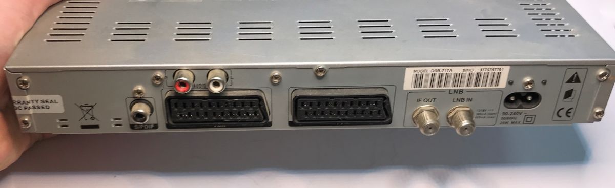

    Rear of a gray set-top box: RCA, S/PDIF, two SCART ports, IF OUT/LNB IN connectors, and power inlet.
    We look at the back of the equipment and all doubts about its age are dispelled. This decoder doesn't even have an HDMI output. I don't know if it would still be able to receive anything, but looking at the prices it's possible to buy one for a dozen zlotys, and I don't even have a remote control....

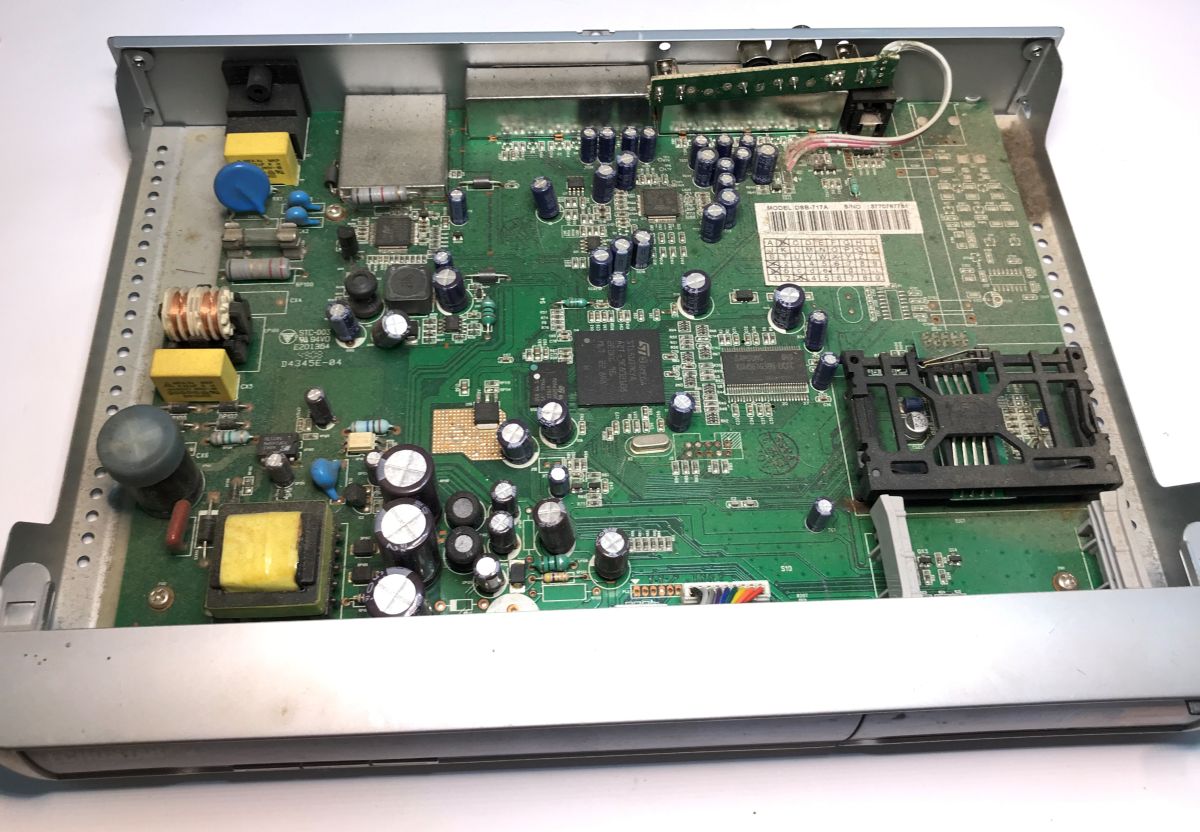

    Inside a set-top box: large green main PCB with capacitors, shield cans, and a card reader module

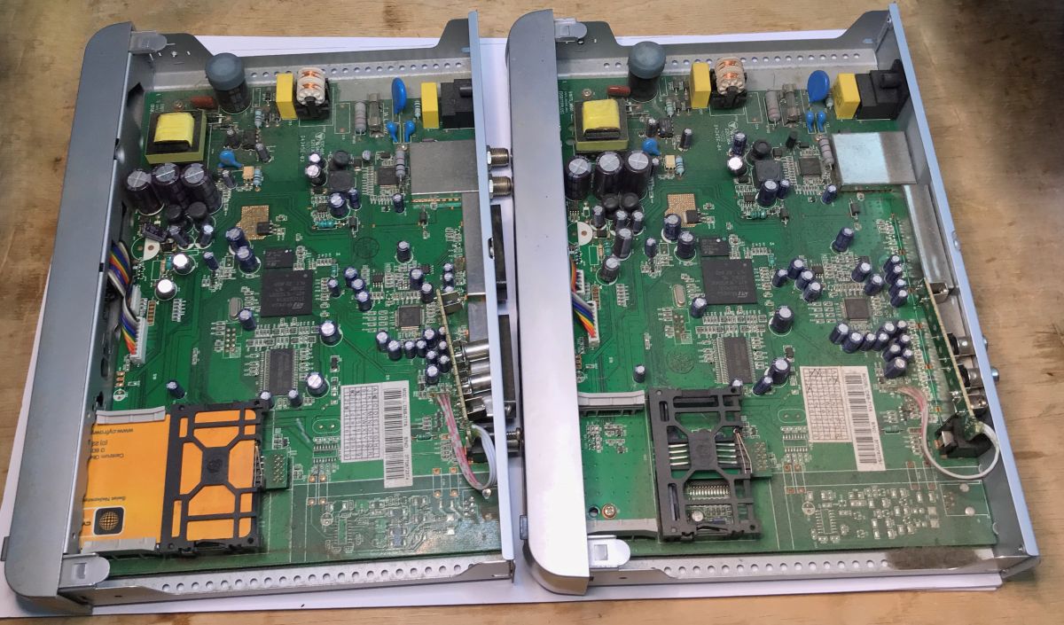

    The whole thing is built around one main PCB, with the switching power supply and the rest of the unit separately. The audio outputs (for the right and left channels) still have a tiny PCB, and there is also a separate display.
    Two open set-top boxes side by side, showing green main PCBs and rear connectors.

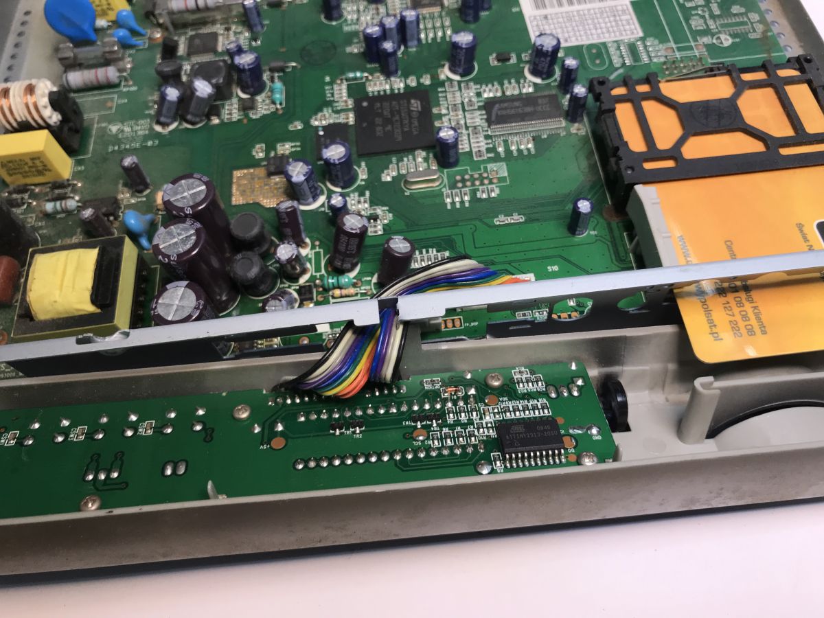

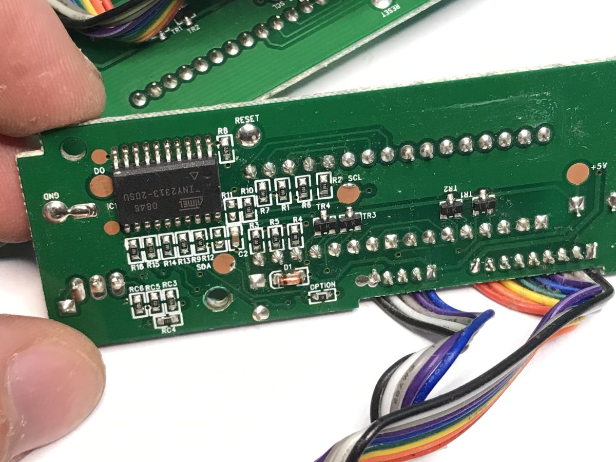

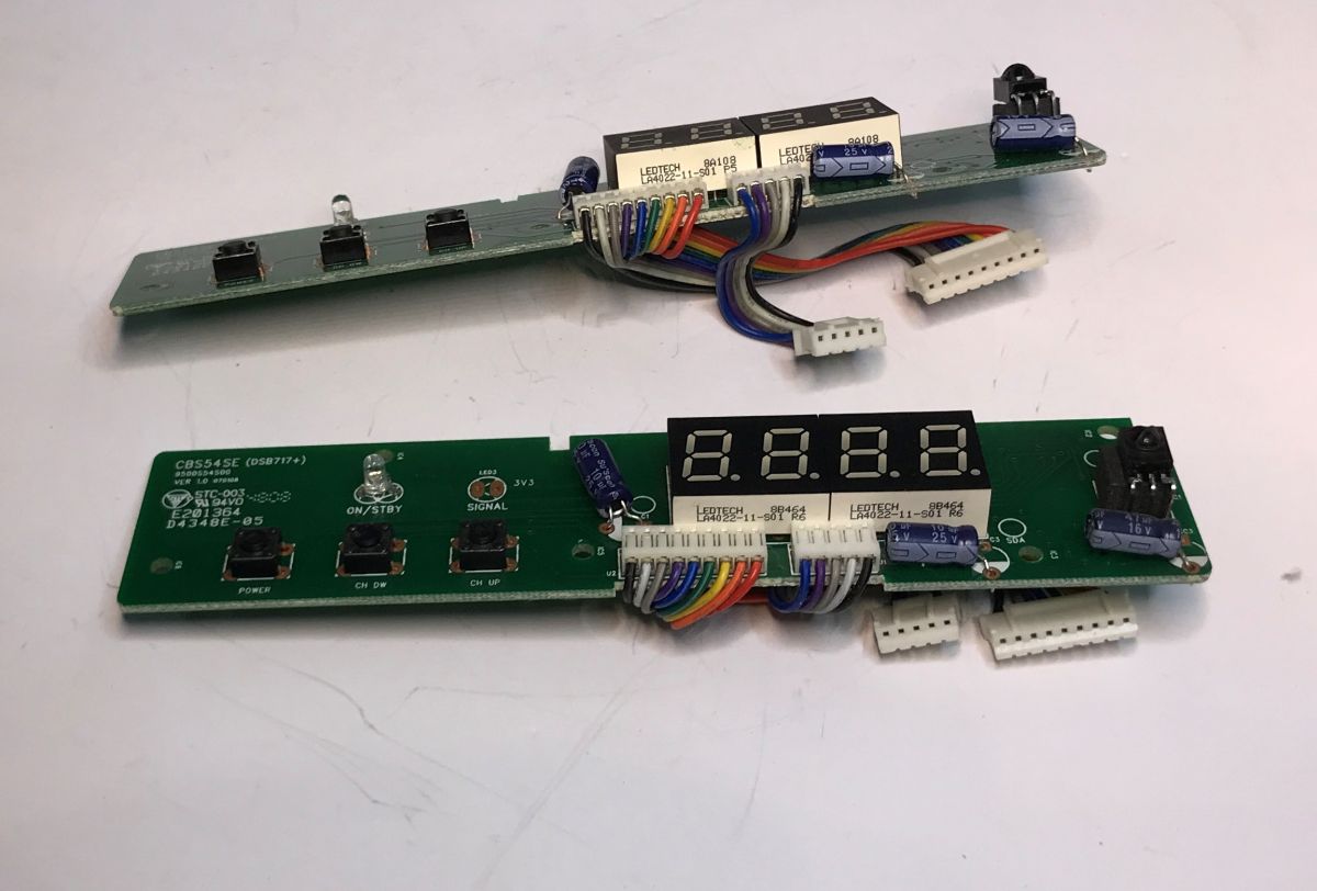

    In the case of the display, we have a surprise, as there is neither a sliding register nor a dedicated controller such as the TM1650 or TM1637, but there is the well-known and well-loved ATTiny2313 microcontroller from Atmel at the time (now, after the acquisition, from Microchip). It appears that it is this MCU that does the multiplexing of the 7-segment display showing the channel codes.
    Inside a set-top box: main PCB with capacitors and a ribbon cable to a small display board

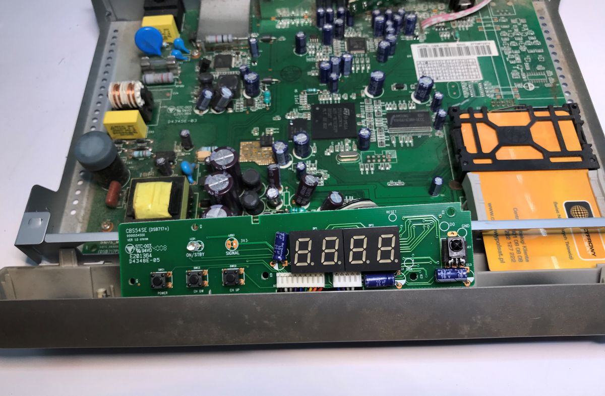

    The display has dots, but no colon - we won't make a clock easily. We also have an IR receiver, after all the remote has to work somehow. You could make it work at least with IRRemote from an Arduino or ESP.
    Inside an electronic device with a green PCB and a front 7‑segment display module

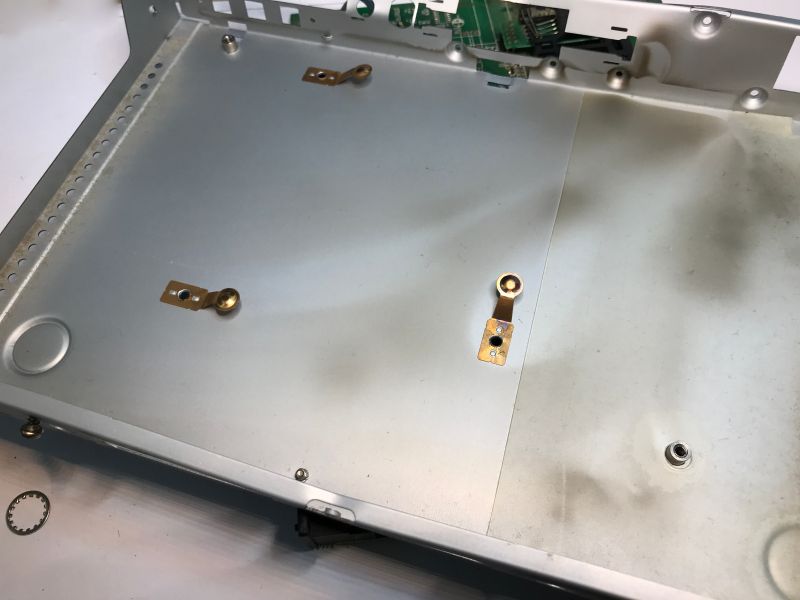

    As a curiosity, we have extra insulation on the bottom of the PCB on the high voltage side and the inverter in general, and on the low voltage side we have contacts from ground/casing
    Inside a metal device casing with mounting tabs and screws; small section of PCB visible at the top

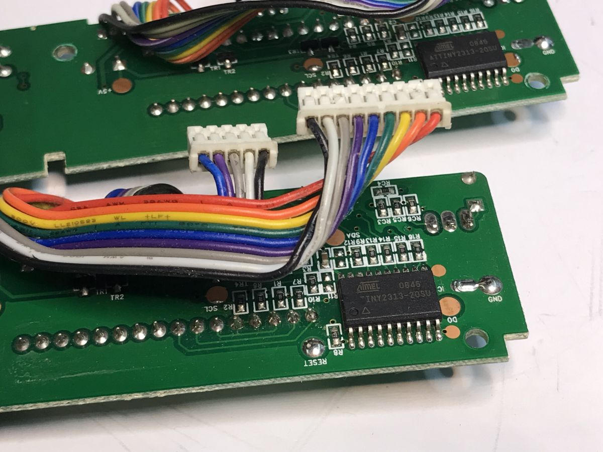

    I had a look at the display. Strange, why so many wires when Attiny does multiplexing?
    Two PCBs with LED displays, buttons, and connectors removed from a device [img-1]
    Close-up of PCBs with ATtiny2313 microcontrollers and multicolor ribbon cables Close-up of PCB with ATTiny2313 microcontroller and ribbon cables

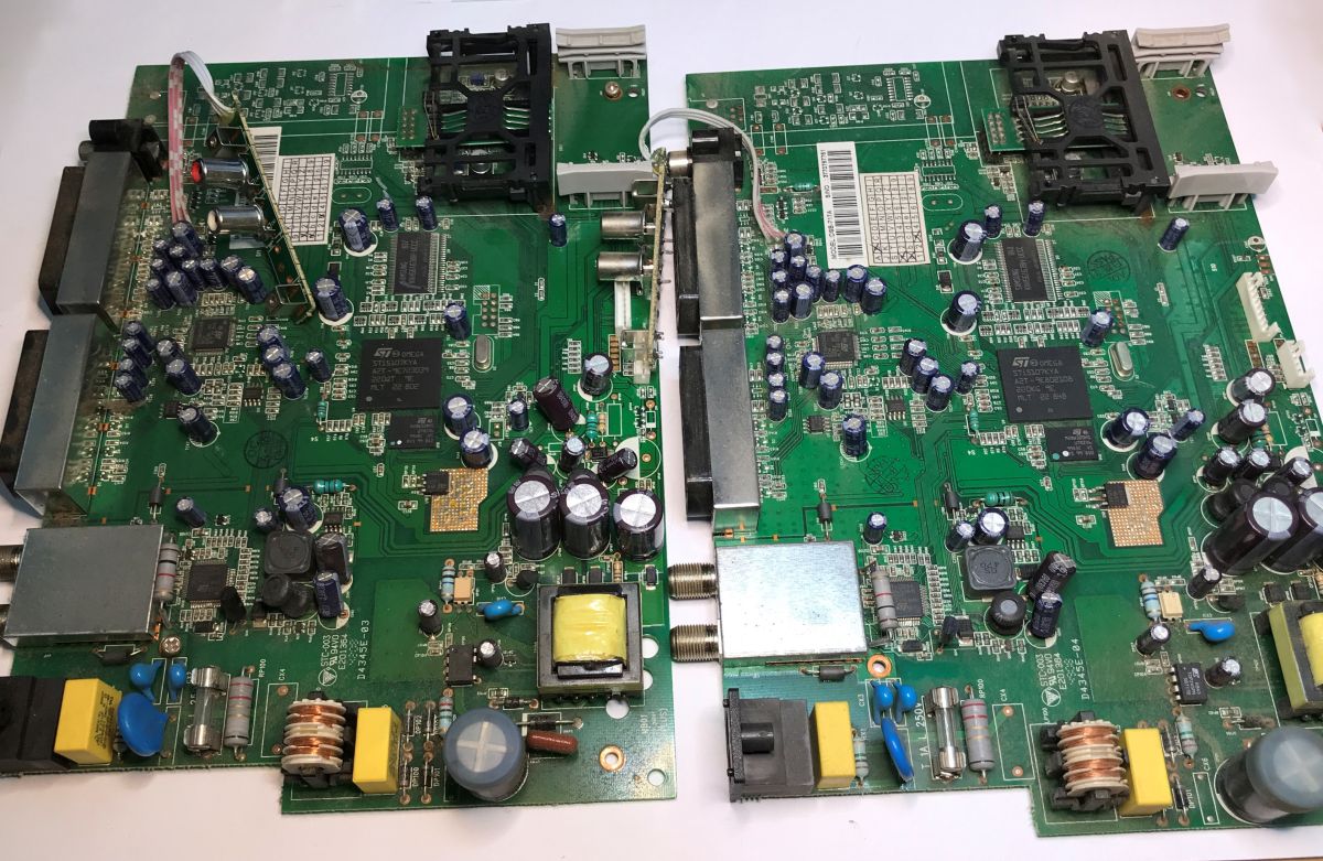

    Both motherboards are quite similar:
    Two green decoder PCBs side by side with capacitors, connectors, and power-supply components visible

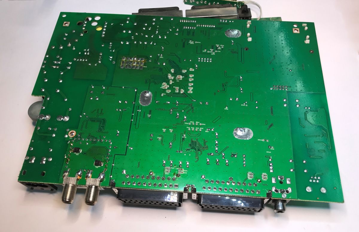

    On the underside we have only a few components, among others the decoupling capacitors from the main CPU:
    Bottom side of a green PCB with many solder points and connectors, including SCART and RF coax sockets

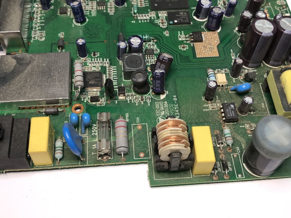

    Now let's further examine the rest of the PCB, starting with the power supply .
    On the input we have rich filters to reduce EMI interference. Of course there is a fuse too. Then a bridge rectifier and a boost converter.
    Close-up of a green PCB with capacitors, coils, resistors, and power-supply components

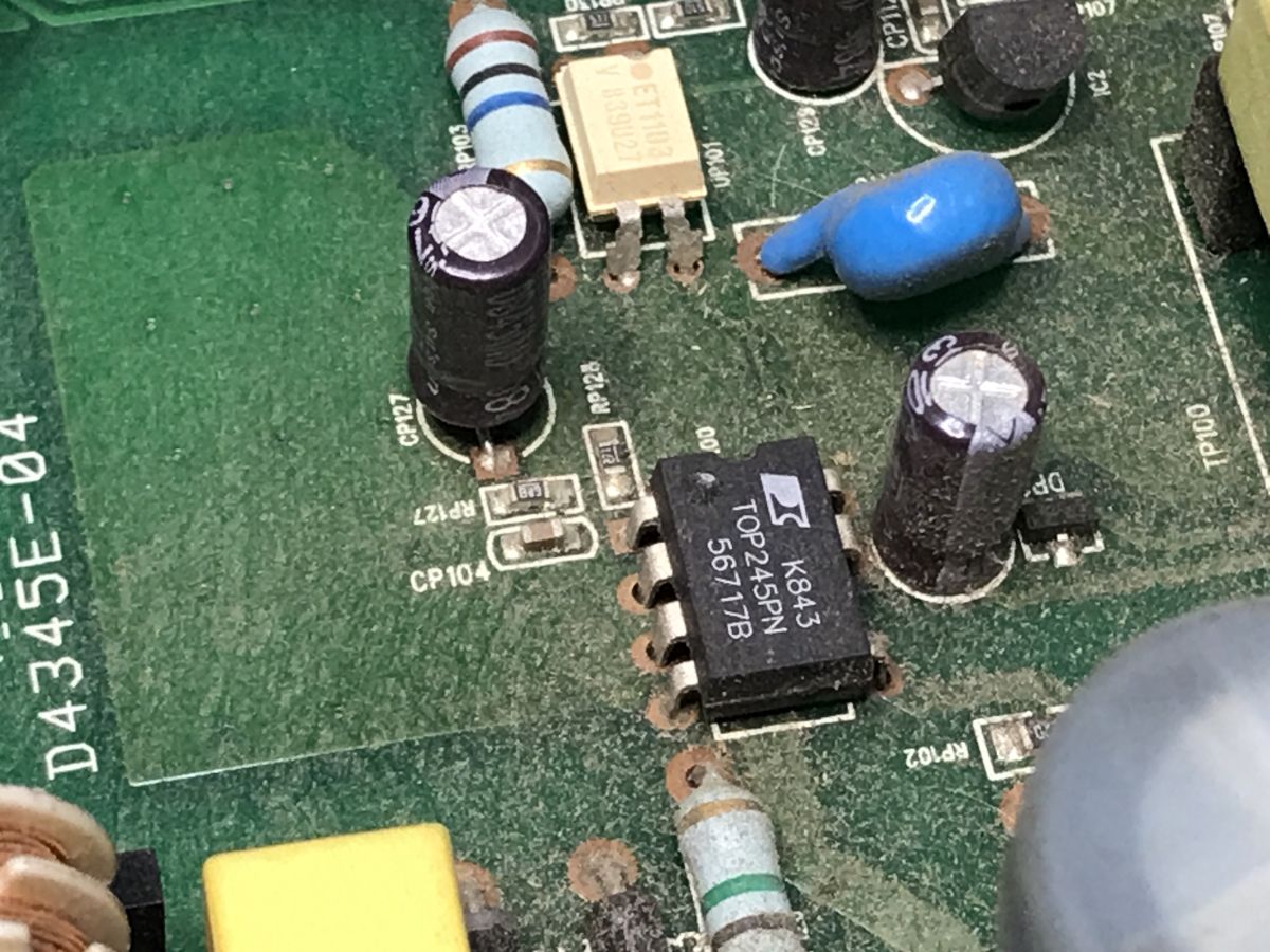

    The inverter is based on the TOP245PN:
    Close-up of a PCB showing a TOP245PN IC and several electrolytic capacitors

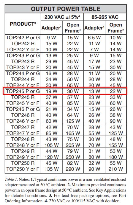

    It can provide up to 30 W, depending on configuration and cooling capabilities.
    Output power table with the row “TOP245 P or G” highlighted in red.

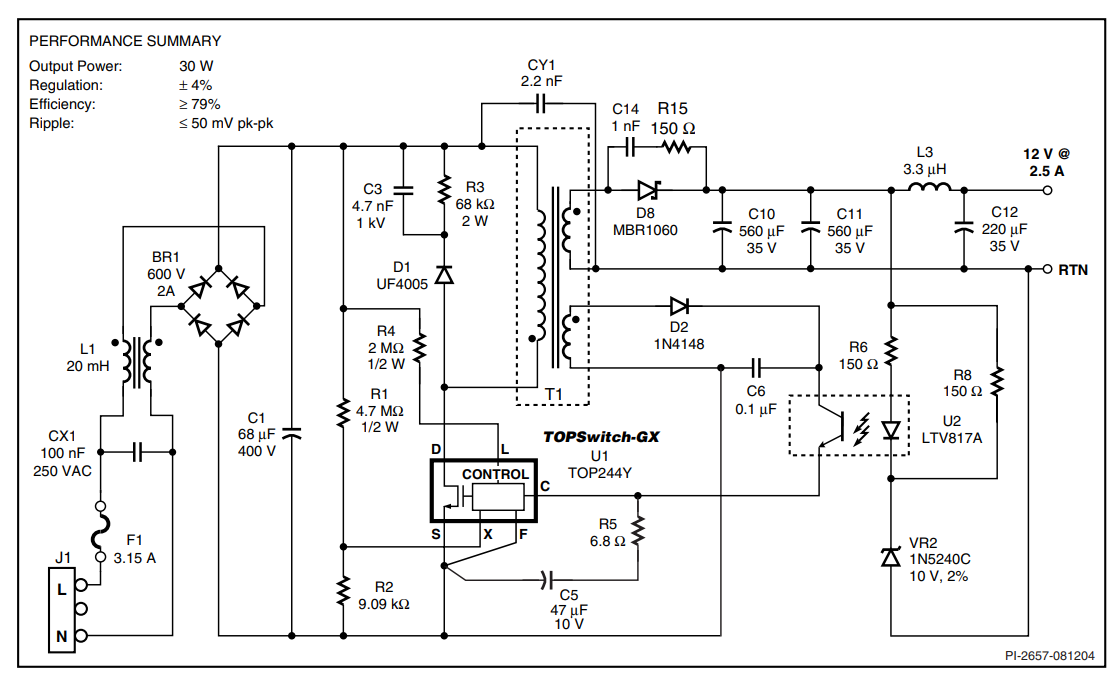

    This circuit already has a keying transistor integrated into it - below is a schematic of an example inverter:
    Switch-mode power supply schematic with TOPSwitch-GX TOP244Y, transformer, bridge rectifier, and 12 V output

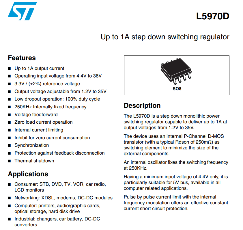

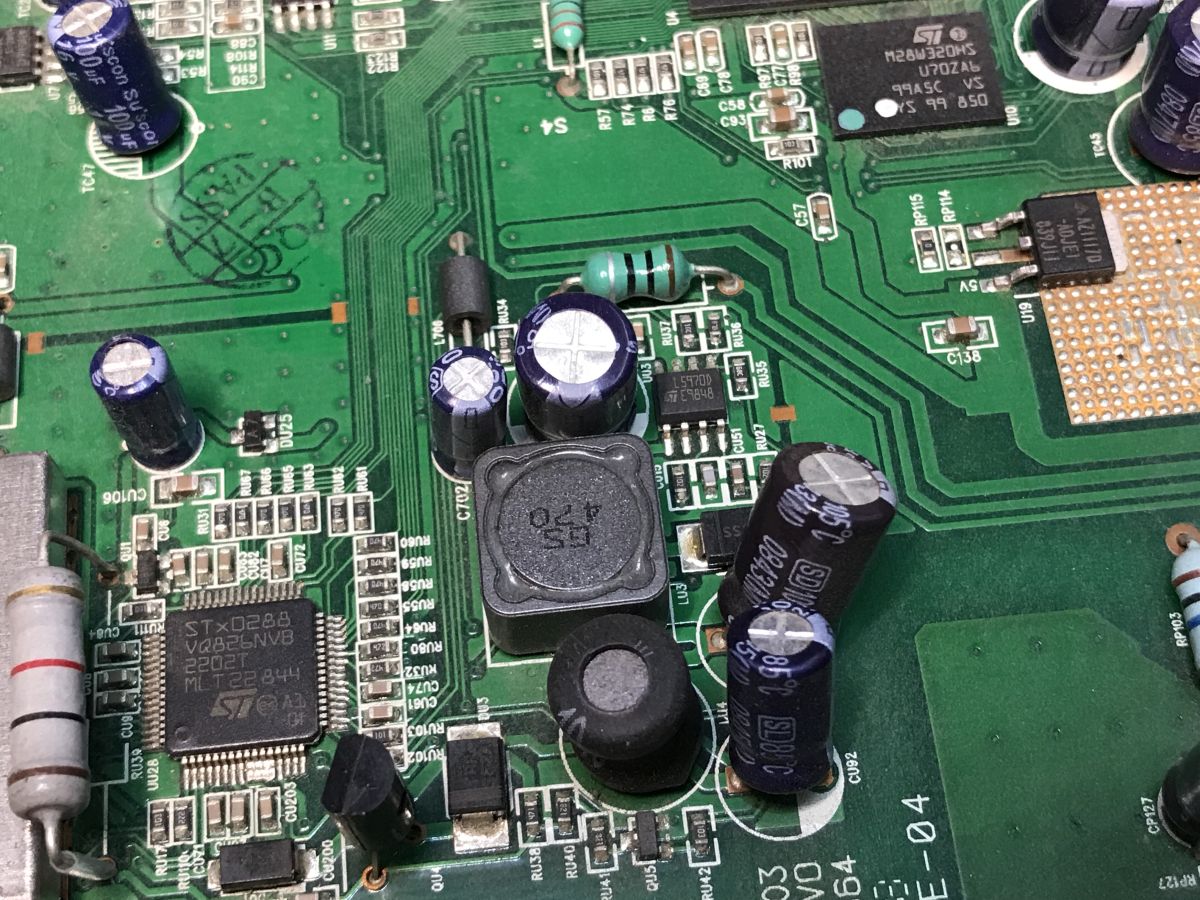

    Next we have more inverters - lower voltages are needed for the processor. In the background you can also see the AZ1117-ADJ, which is a linear voltage stabiliser with adjustable output.
    Close-up of a green PCB with capacitors, inductors, and ST-branded ICs

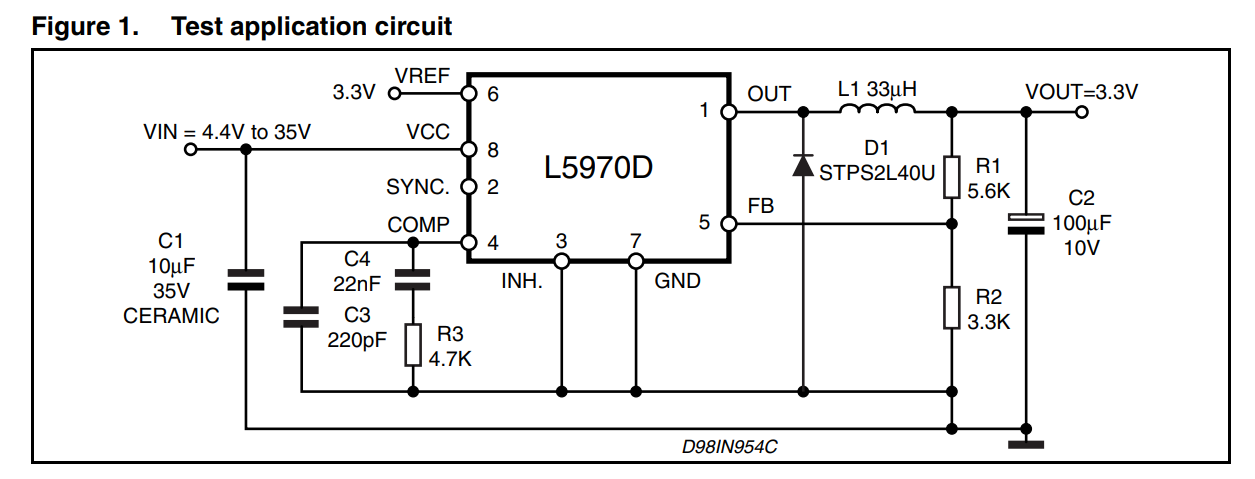

    L5970D - up to 1 A.
    ST L5970D datasheet excerpt: up to 1 A step-down switching regulator with SO8 package drawing
    Example diagram:
    L5970D test circuit: 3.3 V buck converter with 33 µH inductor, Schottky diode, and FB resistor divider

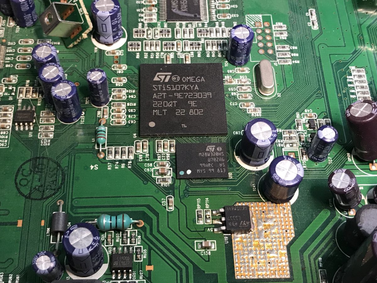

    The main processor is the STi5107KYA Omega from ST. On the PCB it appears with M28W320HS (32 Mb Flash) and K4H561638H (256 Mb SDRAM).
    Close-up of a PCB with ST OMEGA STi5107KYA chip, electrolytic capacitors, and SMD components
    It's a shame that the Flash is in such an inaccessible DIY enclosure, otherwise something could be tampered with. I would have ripped the contents and analysed in Ghidra, and maybe I would have tried to upload something new.

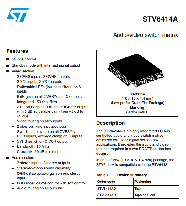

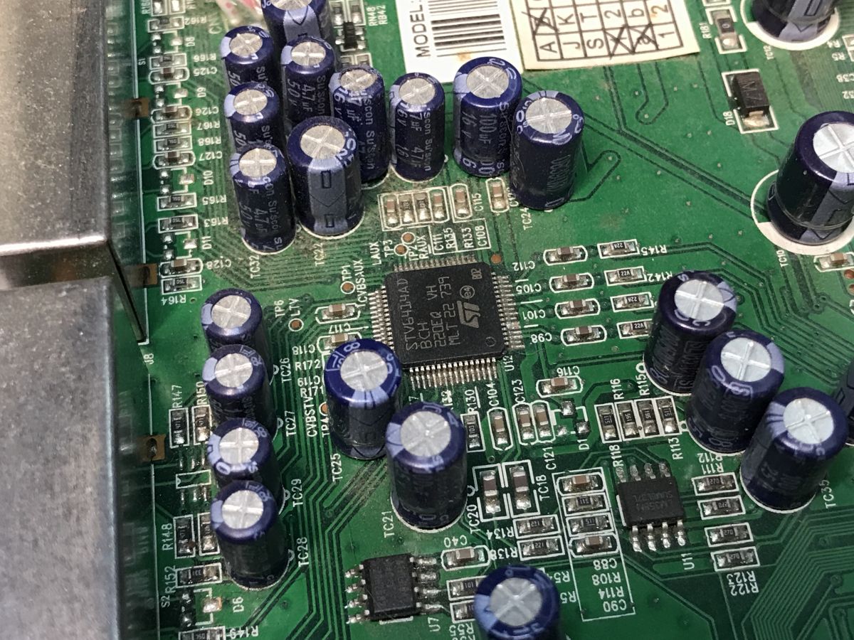

    Further separately we have the STV6414AD:
    Close-up of capacitors and ST microchip on decoder PCB
    As far as I can see, this is simply an audio/video line switch, it is controlled via the I2C protocol.
    STV6414A datasheet fragment showing features of the audio/video switch matrix

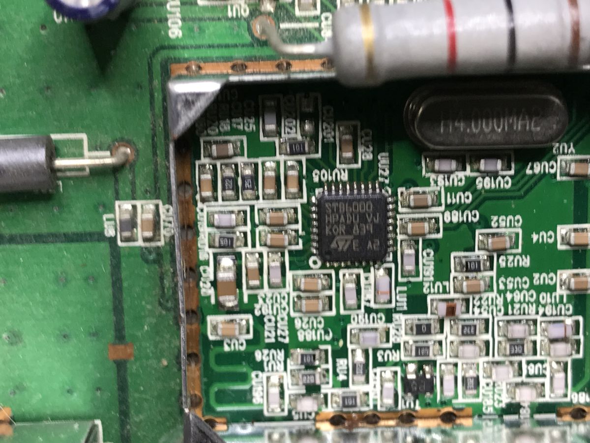

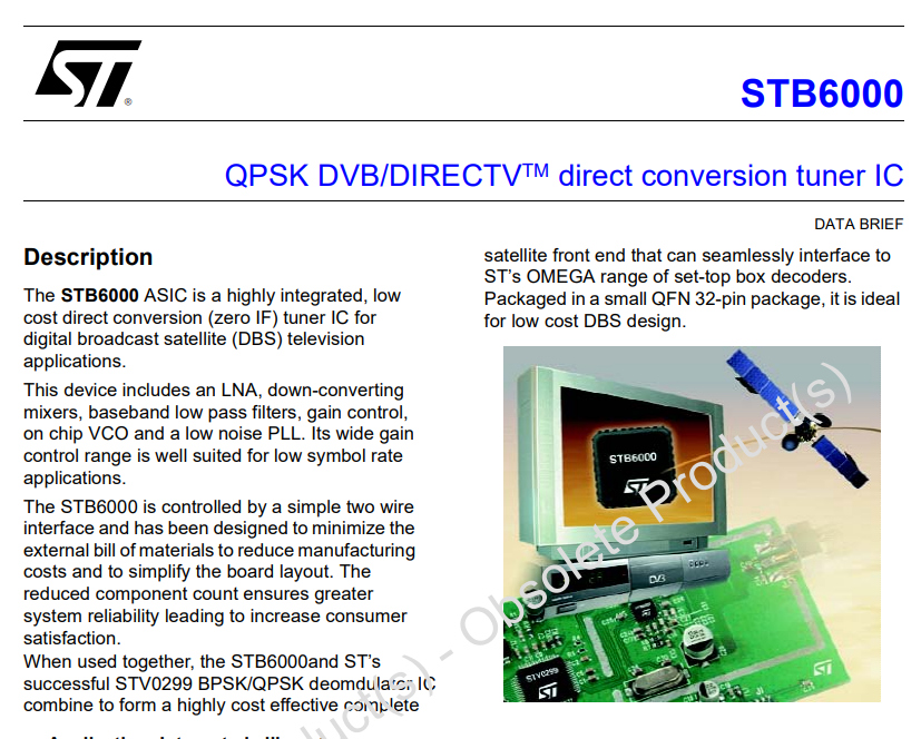

    Still here we have the RF tuner:
    Close-up of STB6000 IC on green PCB with SMD components and 14 MHz quartz crystal
    It is based on the STB6000, interestingly this chip operates in direct frequency conversion mode (without intermediate frequency - IF). It is controlled as usual via I2C:
    Screenshot of the STB6000 datasheet for a DVB QPSK direct conversion tuner IC

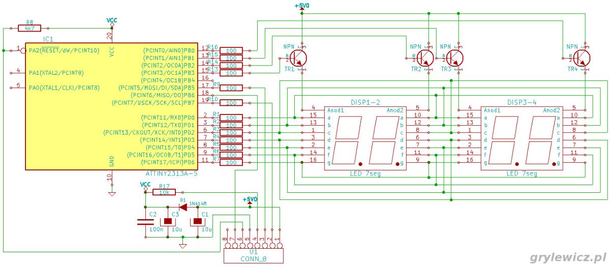

    There are already some applications of the Attiny front panel with displays on the web, I recently acquired a scrap panel myself and also kept some components from it as well as the front panel :)
    https://kaktusa.pl/panel-frontowy-dekodera-cyfrowego-polsatu-dsb-717/
    https://www.elektroda.pl/rtvforum/topic3855371.html
    https://www.elektroda.pl/rtvforum/topic3676125.html
    https://grylewicz.pl/mini-plytka-testowa-avr-z-odzysku/

    I was most acutely interested here in the head unit on the STB6000. The datasheet for this is a mere two pages, so there are no specifics. However, after searching for a while I found some code: stb6000.h and stb6000.c . You could try to do some SDR on this. From this code it looks like with it (stb6000_set_params function) and a logic state analyser it would probably be possible to run it on an STM32.
    Would you be willing to perhaps send me one of these tuners at shipping cost?

    As for the LED display module with ATtiny2313 microcontroller: Link .
    The I2C address of the LED display module is 0x38 (7-bit), baud rate 100 kHz. The I2C frame sent contains 7 bytes - the first three are 0x38, 0x00, 0x07. The next four bytes are the digits displayed on the LED, starting from the left (byte #7 controls the far right digit).
    The bytes and corresponding digits sent are:
    0 - 0x3F, 1 - 0x09, 2 - 0x6E, 3 - 0x6D, 4 - 0x59, 5 - 0x75, 6 - 0x77, 7 - 0x29, 8 - 0x7F, 9 - 0x7D, digit blanked out - 0x00
    Bits and corresponding segments of the display:
    %00000001 $01 - segment "c", %00000010 $02 - segment "e", %00000100 $04 - segment "d", %00001000 $08 - segment "b", %00010000 $10 - segment "f", %00100000 $20 - segment "a", %01000000 $40 - segment "g", %10000000 $80 - none, %00000000 $00 - none

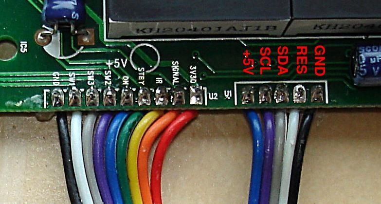

    The only thing that puzzles me is, if there's I2C in there, why so many wires to that PCB? Power, GND, SCL, SDA, and then there's IR, after all, that's a lot less than I see there....

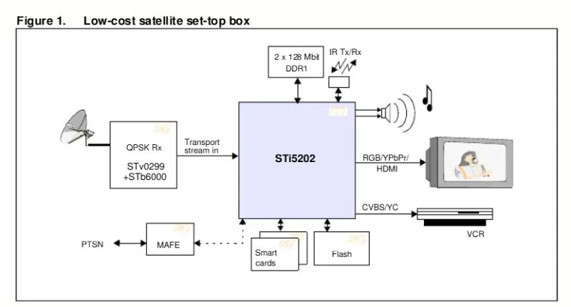

    PS: This is the diagram I found for the STB6000:
    Block diagram of a low-cost satellite set-top box using STi5202 and STV0299+STB6000

    This is the diagram I found as to the STB6000
    I have also seen this. The STB6000 is with a "zero IF" output. As if the signals from it were fed to low-pass (analogue) filters it would be possible to sample it with the STM32. I already have an AV2012 chip running like this (also from a DVB-S tuner), although everything is designed for it.
    While I'll already have this in mind, if I come across any more tuners, I'll check what's sitting there and if anything I'll intercept the communication and put it back - I'll ask you on PW.
    Right. It's the heads that would interest me - especially how they are removable modules. It's just that when there's no datasheet you mostly need the whole tuner to run.

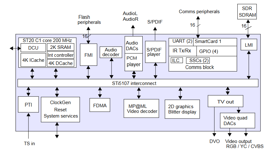

    Some residual information is given about the STi5107KYA (main CPU):
    Block diagram of STi5107 showing audio, video, memory, and interface components.
    Link
    They state that there is an "ST20 32-bit VL-RISC CPU" core. You can see a connector on the board, which is probably a JTAG, but I don't particularly see any chance of working it out. The UART is nowhere to be seen either. Something about the STi5107KYA is on a reliable Chinese site: Link . Too bad I ran out of points there.
    The only thing that puzzles me is if there is I2C there, why so many wires to that PCB?
    It is not by chance that the keys are not supported by the Attiny?
  • Keys, IR receiver and LED are wired to motherboard
    #11 21819344
    MAT_ ZAJ
    Posts: 137
    Help: 12
    Rate: 47
    maciej_333 wrote:
    The only thing that puzzles me is if there is I2C, why so many wires to this PCB?
    It is not by chance that the keys are not supported by Attiny?
    That's right, the keys are routed out to just this ribbon of wires, as are the IR receiver and the two-colour LED. These signals go back to the tuner motherboard.
    I am attaching a description from one of the earlier links.
    Close-up of ribbon cable connected to PCB with labeled signal and power pins

        rjmp   USI_START                         ; 0x40   1e: c010
        reti                                     ;        20: 9518
        reti                                     ;        22: 9518
        reti                                     ;        24: 9518
    Data_Data:
    .db 0x08, 0x65                               ;        26: 6508
    .db 0x00, 0x00                               ;        28: 0000
    .db 0x05, 0x60                               ;        2a: 6005
    .db 0x54, 0x02                               ;        2c: 0254
    Init_I2C:
        cbi    PORTB, scl                        ; 24     2e: 98c7
        cbi    PORTB, sda                        ; 24     30: 98c5
        cbi    DDRB, scl                         ; 23     32: 98bf
        cbi    DDRB, sda                         ; 23     34: 98bd
        ldi    acc, 0b1010_1000                  ; 168    36: ea08
        out    USICR, acc                        ; 13     38: b90d
        ldi    acc, 0b1111_0000                  ; 240    3a: ef00
        out    USISR, acc                        ; 14     3c: b90e
        ret                                      ;        3e: 9508
    ;*   Read I2c                                                *
    USI_START:
        st     -Y, XL                            ;        40: 93aa
        st     -Y, r25                           ;        42: 939a
        st     -Y, r24                           ;        44: 938a
        st     -Y, ZL                            ;        46: 93ea
        st     -Y, r18                           ;        48: 932a
        st     -Y, r17                           ;        4a: 931a
        st     -Y, acc                           ;        4c: 930a
        in     r18, SREG                         ; 63     4e: b72f
        ldi    acc, 0b1110_0000                  ; 224    50: ee00
        out    USISR, acc                        ; 14     52: b90e
        sei                                      ;        54: 9478
    Wait_00:
        in     acc, USISR                        ; 14     56: b10e
        andi   acc, 0b0000_1111                  ; 15     58: 700f
        cpi    acc, 0b0000_1101                  ; 13     5a: 300d
        brcs   Wait_00                           ; 0x56   5c: f3e0
        cli                                      ;        5e: 94f8
    Wait_01:
        sbis   USISR, USIOIF                     ; 14     60: 9b76
        rjmp   Wait_01                           ; 0x60   62: cffe
        in     acc, USIDR                        ; 15     64: b10f
        cpi    acc, 0b0111_0000                  ; 112    66: 3700
        brne   Set_USISR                         ; 0xc6   68: f571
        ldi    acc, 0x00                         ; 0      6a: e000
        out    USIDR, acc                        ; 15     6c: b90f
        sbi    DDRB, sda                         ; 23     6e: 9abd
        ldi    acc, 0b0100_1101                  ; 77     70: e40d
        out    USISR, acc                        ; 14     72: b90e
    Wait_02:
        sbis   USISR, USIOIF                     ; 14     74: 9b76
        rjmp   Wait_02                           ; 0x74   76: cffe
        cbi    DDRB, sda                         ; 23     78: 98bd
        ldi    acc, 0b1110_0000                  ; 224    7a: ee00
        out    USISR, acc                        ; 14     7c: b90e
        ldi    r24, 0x00                         ; 0      7e: e080
        ldi    r25, 0x00                         ; 0      80: e090
    Read_Loop:
        sei                                      ;        82: 9478
    Wait_03:
        in     acc, USISR                        ; 14     84: b10e
        andi   acc, 0x0F                         ; 15     86: 700f
        cpi    acc, 0x0D                         ; 13     88: 300d
        brcs   Wait_03                           ; 0x84   8a: f3e0
        cli                                      ;        8c: 94f8
    Wait_04:
        sbis   USISR, USIOIF                     ; 14     8e: 9b76
        rjmp   Wait_04                           ; 0x8e   90: cffe
        ldi    ZL, 0x65                          ; 101    92: e6e5
        in     acc, USIDR                        ; 15     94: b10f
        std    Z+7, acc                          ; 0x07   96: 8307
        ldi    acc, 0x00                         ; 0      98: e000
        out    USIDR, acc                        ; 15     9a: b90f
        sbi    DDRB, sda                         ; 23     9c: 9abd
        ldi    acc, 0x4E                         ; 78     9e: e40e
        out    USISR, acc                        ; 14     a0: b90e
    Wait_05:
        sbis   USISR, USIOIF                     ; 14     a2: 9b76
        rjmp   Wait_05                           ; 0xa2   a4: cffe
        cbi    DDRB, sda                         ; 23     a6: 98bd
        ldd    r17, Z+7                          ; 0x07   a8: 8117
        ldi    r26, 0x65                         ; 101    aa: e6a5
        inc    r26                               ;        ac: 95a3
        add    XL, r24                           ;        ae: 0fa8
        st     X, r17                            ;        b0: 931c
        ldi    acc, 0b1110_0000                  ; 224    b2: ee00
        out    USISR, acc                        ; 14     b4: b90e
        ldi    acc, 0x01                         ; 1      b6: e001
        st     Z, acc                            ;        b8: 8300
        adiw   r24, 0x01                         ; 1      ba: 9601
        cpi    r24, 0x06                         ; 6      bc: 3086
        ldi    acc, 0x00                         ; 0      be: e000
        cpc    r25, acc                          ;        c0: 0790
        brge   Skip_Set_USISR                    ; 0xca   c2: f41c
        rjmp   Read_Loop                         ; 0x82   c4: cfde
    Set_USISR:
        ldi    acc, 0b1111_0000                  ; 240    c6: ef00
        out    USISR, acc                        ; 14     c8: b90e
    Skip_Set_USISR:
        out    SREG, r18                         ; 63     ca: bf2f
        ld     acc, Y+                           ;        cc: 9109
        ld     r17, Y+                           ;        ce: 9119
        ld     r18, Y+                           ;        d0: 9129
        ld     ZL, Y+                            ;        d2: 91e9
        ld     r24, Y+                           ;        d4: 9189
        ld     r25, Y+                           ;        d6: 9199
        ld     XL, Y+                            ;        d8: 91a9
        reti                                     ;        da: 9518
    WATCHDOG:
        cli                                      ;        dc: 94f8
        wdr                                      ;        de: 95a8
        in     acc, WDTCR                        ; 33     e0: b501
        ori    acc, 0b0001_1000                  ; 24     e2: 6108
        out    WDTCR, acc                        ; 33     e4: bd01
        ldi    acc, 0b0010_1001                  ; 41     e6: e209
        out    WDTCR, acc                        ; 33     e8: bd01
        sei                                      ;        ea: 9478
    Return_from_Convertor:
        ret                                      ;        ec: 9508
    Convertor:
        mov    r17, acc                          ;        ee: 2f10
        bst    r17, 0                            ;        f0: fb10
        ldi    r17, 0x00                         ; 0      f2: e010
        bld    r17, 2                            ;        f4: f912
        mov    r18, acc                          ;        f6: 2f20
        add    r18, r18                          ;        f8: 0f22
        add    r18, r18                          ;        fa: 0f22
        add    r18, r18                          ;        fc: 0f22
        or     r18, r17                          ;        fe: 2b21
        andi   r18, 0b0001_0111                  ; 23    100: 7127
        mov    r17, acc                          ;       102: 2f10
        add    r17, r17                          ;       104: 0f11
        andi   r17, 0b0000_1000                  ; 8     106: 7018
        or     r17, r18                          ;       108: 2b12
        mov    r18, acc                          ;       10a: 2f20
        lsr    r18                               ;       10c: 9526
        lsr    r18                               ;       10e: 9526
        andi   r18, 0b0000_0010                  ; 2     110: 7022
        or     r18, r17                          ;       112: 2b21
        mov    r17, acc                          ;       114: 2f10
        add    r17, r17                          ;       116: 0f11
        andi   r17, 0b0010_0000                  ; 32    118: 7210
        or     r17, r18                          ;       11a: 2b12
        mov    r18, acc                          ;       11c: 2f20
        bst    r18, 5                            ;       11e: fb25
        ldi    r18, 0x00                         ; 0     120: e020
        bld    r18, 0                            ;       122: f920
        or     r18, r17                          ;       124: 2b21
        andi   acc, 0b0100_0000                  ; 64    126: 7400
        or     acc, r18                          ;       128: 2b02
        com    acc                               ;       12a: 9500
        rjmp   Return_from_Convertor             ; 0xec  12c: cfdf
    Set_Hardware:
        in     acc, DDRB                         ; 23    12e: b307
        ori    acc, 0b0000_1111                  ; 15    130: 600f
        out    DDRB, acc                         ; 23    132: bb07
        in     acc, PORTB                        ; 24    134: b308
        andi   acc, 0b1111_0000                  ; 240   136: 7f00
        out    PORTB, acc                        ; 24    138: bb08
        in     acc, DDRD                         ; 17    13a: b301
        ori    acc, 0b0111_1111                  ; 127   13c: 670f
        out    DDRD, acc                         ; 17    13e: bb01
        in     acc, PORTD                        ; 18    140: b302
        andi   acc, 0b1000_0000                  ; 128   142: 7800
        out    PORTD, acc                        ; 18    144: bb02
        ldi    acc, 0x03                         ; 3     146: e003
        ldi    ZL, 0x60                          ; 96    148: e6e0
        st     Z, acc                            ;       14a: 8300
        in     acc, TIMSK                        ; 57    14c: b709
        andi   acc, 0b1111_1100                  ; 252   14e: 7f0c
        out    TIMSK, acc                        ; 57    150: bf09
        ldi    acc, 0x00                         ; 0     152: e000
        out    TCNT0, acc                        ; 50    154: bf02
        ldi    acc, 0x20                         ; 32    156: e200
        out    OCR0A, acc                        ; 54    158: bf06
        in     acc, TCCR0B                       ; 51    15a: b703
        ori    acc, 0b0000_0100                  ; 4     15c: 6004
        out    TCCR0B, acc                       ; 51    15e: bf03
        in     acc, TIMSK                        ; 57    160: b709
        ori    acc, 0b0000_0001                  ; 1     162: 6001
        out    TIMSK, acc                        ; 57    164: bf09
        ldi    acc, 0x38                         ; 56    166: e308
        rcall  Init_I2C                          ; 0x2e  168: df62
        ldi    acc, 0xF0                         ; 240   16a: ef00
        rcall  Convertor                         ; 0xee  16c: dfc0
        ldi    acc, 0x00                         ; 0     16e: e000
        ldi    ZL, 0x65                          ; 101   170: e6e5
        st     Z, acc                            ;       172: 8300
        in     r17, MCUSR                        ; 52    174: b714
        sbrc   r17, 3                            ;       176: fd13
        rjmp   Skip_Set                          ; 0x186 178: c006
        ldi    acc, 0xFF                         ; 255   17a: ef0f
        ldi    ZL, 0x6D                          ; 109   17c: e6ed
        std    Z+3, acc                          ; 0x03  17e: 8303
        std    Z+2, acc                          ; 0x02  180: 8302
        std    Z+1, acc                          ; 0x01  182: 8301
        st     Z, acc                            ;       184: 8300
    Skip_Set:
        ldi    acc, 0x00                         ; 0     186: e000
        out    MCUSR, acc                        ; 52    188: bf04
        rcall  WATCHDOG                          ; 0xdc  18a: dfa8
    Main:
    Wait_Hear:
        wdr                                      ;       18c: 95a8
        ldi    ZL, 0x65                          ; 101   18e: e6e5
        ld     acc, Z                            ;       190: 8100
        and    acc, acc                          ;       192: 2300
        breq   Wait_Hear                         ; 0x18c 194: f3d9
        ldi    acc, 0x00                         ; 0     196: e000
        st     Z, acc                            ;       198: 8300
        cli                                      ;       19a: 94f8
        ldi    r24, 0x00                         ; 0     19c: e080
        ldi    r25, 0x00                         ; 0     19e: e090
    Loop:
        mov    acc, r24                          ;       1a0: 2f08
        subi   acc, 0xFE                         ; 254   1a2: 5f0e
        mov    ZL, acc                           ;       1a4: 2fe0
        subi   ZL, 0x9A                          ; 154   1a6: 59ea
        ld     acc, Z                            ;       1a8: 8100
        rcall  Convertor                         ; 0xee  1aa: dfa1
        ldi    ZL, 0x6D                          ; 109   1ac: e6ed
        add    ZL, r24                           ;       1ae: 0fe8
        st     Z, acc                            ;       1b0: 8300
        adiw   r24, 0x01                         ; 1     1b2: 9601
        cpi    r24, 0x04                         ; 4     1b4: 3084
        ldi    acc, 0x00                         ; 0     1b6: e000
        cpc    r25, acc                          ;       1b8: 0790
        brlt   Loop                              ; 0x1a0 1ba: f394
        sei                                      ;       1bc: 9478
        rjmp   Main                              ; 0x18c 1be: cfe6
    ;*                7 Seg Led Diplay Interrupt                 *
    OC0A:
        st     -Y, ZL                            ;       1c0: 93ea
        st     -Y, r17                           ;       1c2: 931a
        st     -Y, acc                           ;       1c4: 930a
        in     r17, SREG                         ; 63    1c6: b71f
        ldi    acc, 0x00                         ; 0     1c8: e000
        out    TCNT0, acc                        ; 50    1ca: bf02
        out    PORTB, acc                        ; 24    1cc: bb08

    :arrow: Diagram of the module Led :wink: :wink:
    Circuit diagram of a 7-segment LED display controlled by an ATtiny2313 microcontroller.
    :oops: The code is a bit wonky, I wonder what it was originally written in 🤔

    Display has dots, but no colon - we won't make a clock easily.
    If you are stubborn, one of the displays can be soldered and rotated 180 degrees.
    You will only need 4 crossovers - the rest can be handled by software and you have a colon !
    In addition to the clock you can also make a thermometer - the second dot is the degree sign in front of the tasteful little upper c :-)
    Red LED display shows time 11:21 and temperature 16°C

    It's a pity that the Flash is in such an inaccessible DIY case, otherwise something could be tampered with. I would rip the contents and analyse them in Ghidra, and maybe try to upload something new.
    There is a j5 connector and it was a jtag connector as far as I remember, but in those days as far as I remember there was no software for those STi5107 processors to read what is in the flash, and I guess the pins were not brought out from the processor to the jtag to secure the firmware. But the batches were probably available on the internet, because someone hot soldered them and ripped them off.

Does the DSB‑717 have HDMI output?
No. The rear panel lacks HDMI, confirming the platform’s age and analog‑centric design. Expect SCART and baseband A/V instead. [Elektroda, p.kaczmarek2, post #21816136]

Why are there so many wires to the front panel if its I2C?
Besides VCC, GND, SDA, and SCL, the ribbon carries key buttons, the IR receiver, and a bi‑color LED back to the mainboard. That’s why the harness is wide. [Elektroda, MAT_ZAJ, post #21819344]

What power devices and ratings should I know before reuse?
Primary SMPS uses TOP245PN; designs around it support roughly 30 W. Downstream, an L5970D buck provides up to 1 A, and AZ1117‑ADJ supplies regulated rails. Keep thermal limits in mind during reuse. [Elektroda, p.kaczmarek2, post #21816136]
What tuner IC is used and can it support DIY SDR experiments?
The STB6000 uses zero‑IF with I2C control. A contributor notes it could feed low‑pass filters and be sampled by an STM32, with a logic analyzer aiding bring‑up. “You could try to do some SDR on this.” [Elektroda, maciej_333, post #21817311]
What CPU and memory does the board carry?
An STi5107KYA SoC pairs with M28W320HS 32 Mb Flash and K4H561638H 256 Mb SDRAM. These capacities suit legacy DVB decoding but limit modern repurposing. [Elektroda, p.kaczmarek2, post #21816136]
