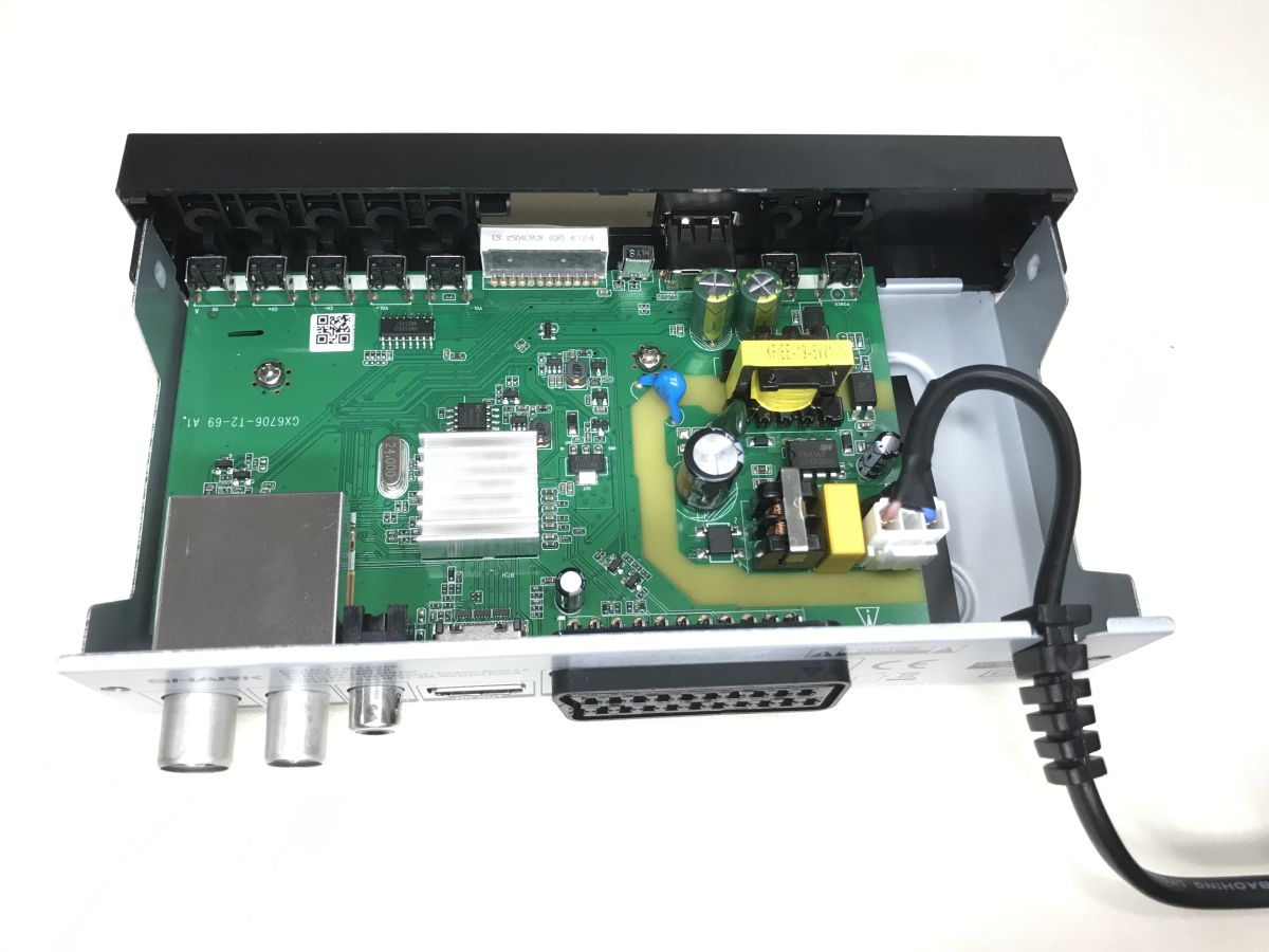

    Something contemporary this time. I've already shown some old tuners, so it's time for a change. As standard, first a presentation of the interior and then an analysis of the Flash memory along with a Linux file system extract. Maybe we can also find a program to change the batch?
    SHARK DVB-T2 set-top box with user manual inside open packaging
    The object of the presentation is a contemporary DVB-T2 / HEVC / H265 decoder characterised by a programmable remote control, which can also be controlled by the TV proper. Just right for the elderly. It was for such a person that I ordered this decoder. I paid all 60 PLN and decided to take a look inside.
    First of all, some photos of the manual - maybe they will be useful to someone, there is also a description of how to pair the remote control.
    Open DVB-T2 set-top box manual with remote control image and function descriptions DVB-T2 decoder manual showing remote battery tips and panel layout DVB-T2 set-top box installation manual with wiring diagram and menu description Opened DVB-T2 set-top box manual showing program and image settings pages Opened DVB-T2 set-top box manual showing program and image settings pages
    Open DVB-T2 decoder manual showing time and system settings pages. User manual for DVB-T2 receiver with recording and scheduling instructions DVB-T2 set-top box manual pages showing Timeshift and troubleshooting sections

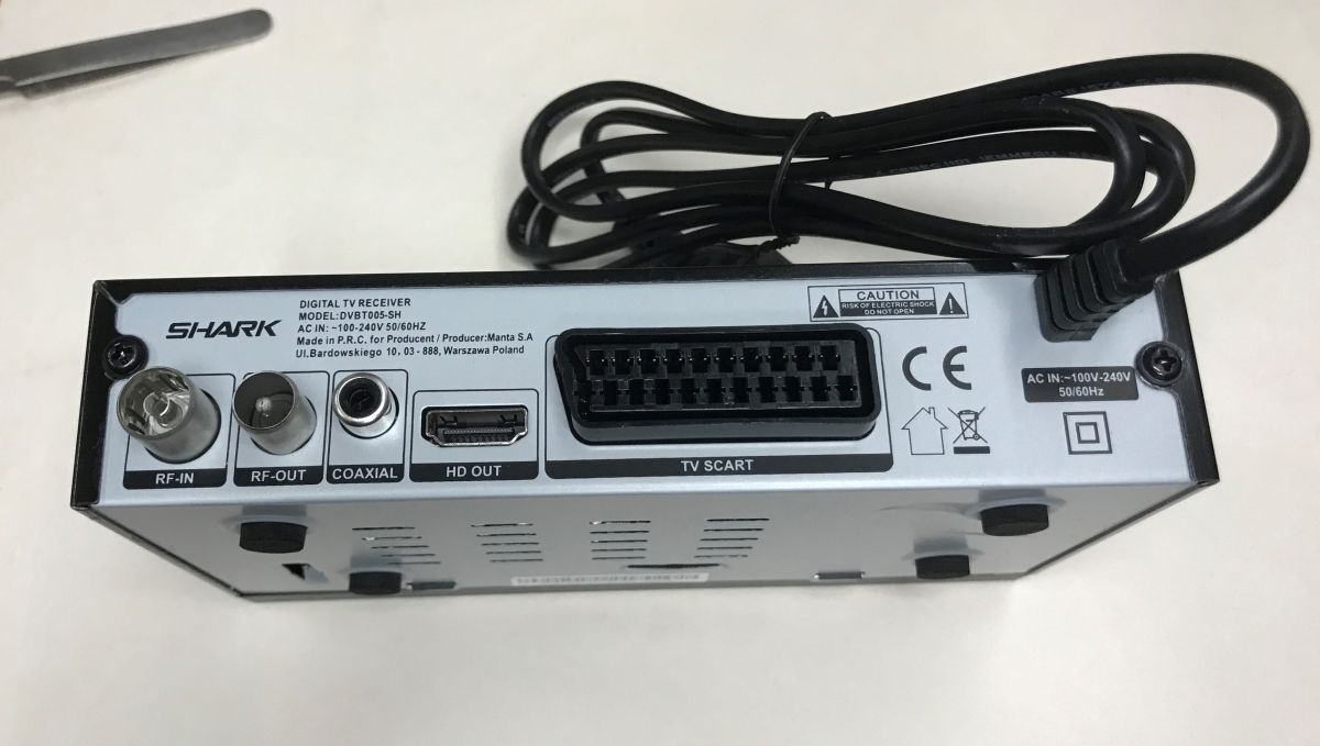

    Let's get to the actual presentation now. We unscrew the screws.
    Rear panel of SHARK DVB-T005-SH set-top box with RF, coaxial, HDMI, and SCART ports

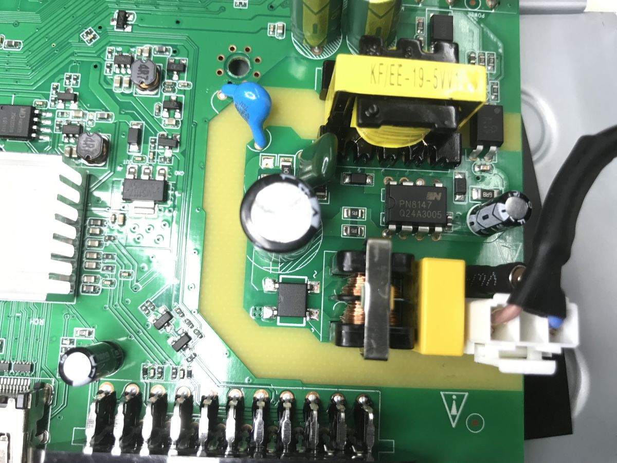

    The circuit is very simple. The whole thing is on a single PCB. First we have the switching power supply, interestingly there is even an EMI filter on its input. Some manufacturers omit it...
    Inside a DVB-T2 decoder showing PCB and flyback power supply
    On the front we have an IR receiver, buttons (quite a lot for such equipment) and a four-digit 7-segment display.

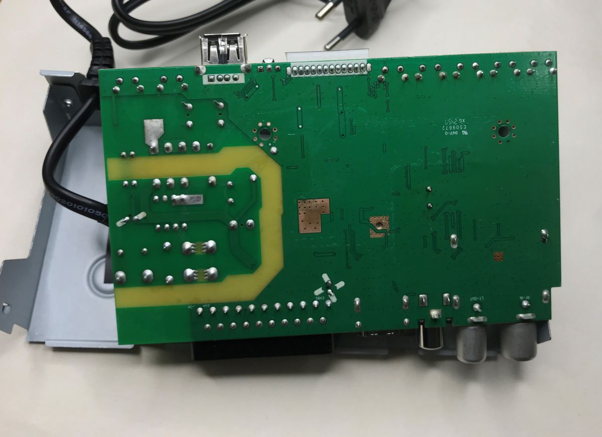

    Bottom of DVB-T2 decoder PCB with power trace and solder points visible
    There is not a single component on the underside of the board - as you can see there was no problem with packing.

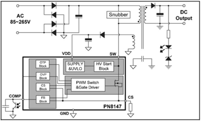

    Close-up of a switch-mode power supply with PN8147 chip on DVB-T2 decoder PCB
    The power supply in flyback topology is based on the PN8147.
    Block diagram of PN8147 flyback IC and its typical application circuit

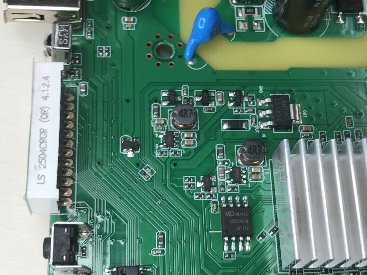

    It probably generates 5 V - as usual. Then there is a section with a 1.8 V LDO and a voltage reduction inverter (5 V -> 3.3 V). The flash bone with firmware (25Q32CSIG) is also caught in the photo.
    Close-up of DVB-T2 decoder PCB with flash memory chip and heatsink visible

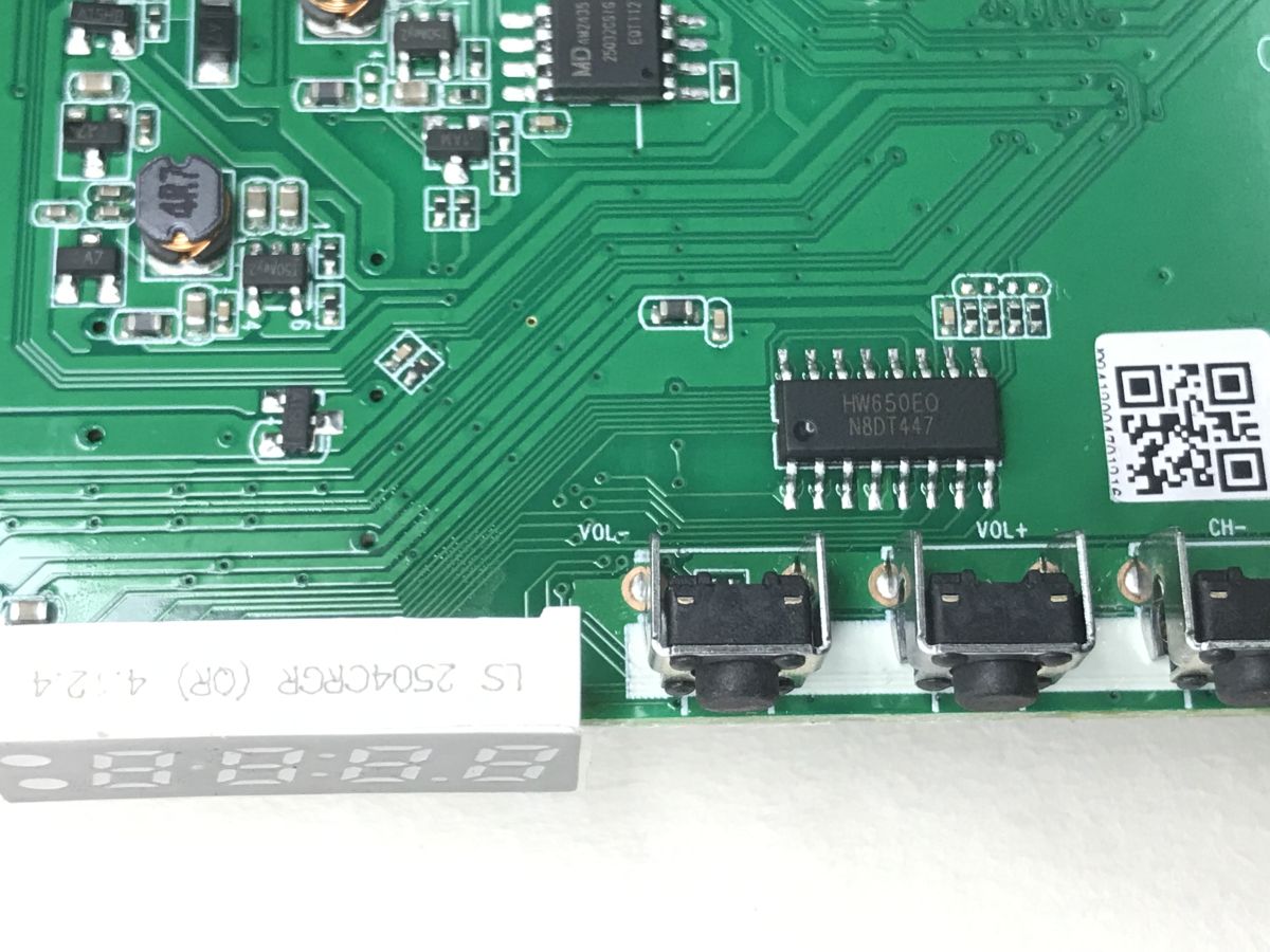

    The buttons and display are handled by the HW650EO - presumably a similar chip to the HD2015 already discussed:
    Running the HD2015 display/button driver after reverse engineering, comparison with TM1637itd
    Close-up of PCB with HW650EO chip and CH/VOL tactile buttons

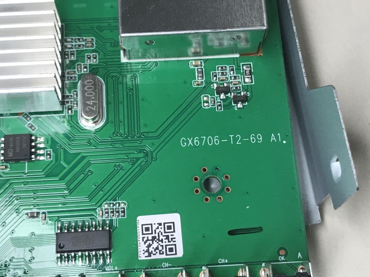

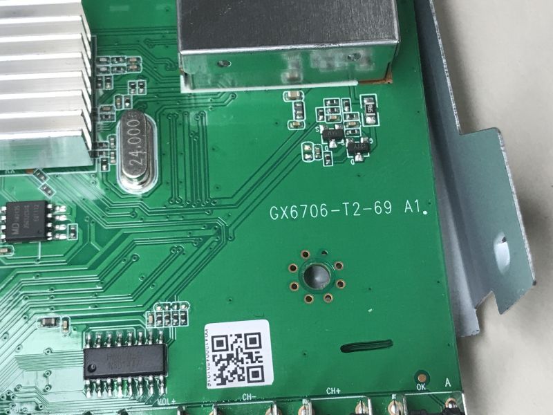

    PCB designation: GX6706-T2-69 A1:
    Close-up of a decoder PCB marked GX6706-T2-69 A1

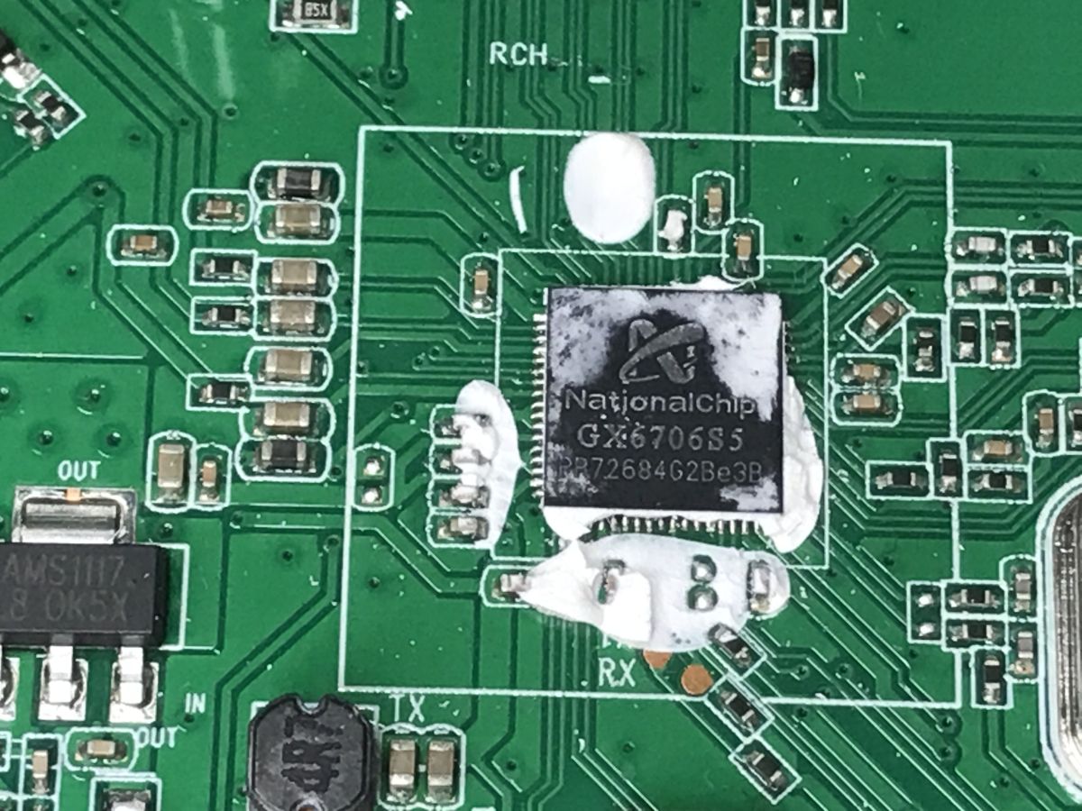

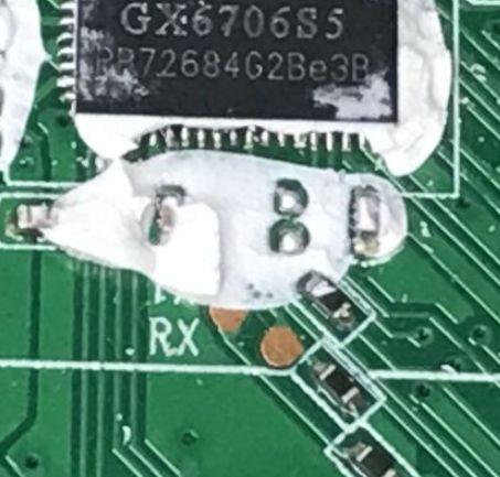

    Finally, you need to know what kind of microprocessor is sitting there:
    Close-up of NationalChip GX6706S5 chip on DVB-T2 decoder PCB with TX and RX labels
    The NationalChip GX6706S5, is quite a popular chip in this type of device, vendors are not hiding about it. You can find a lot of decoders on this chip, although information about the chip itself is residual. It seems to belong to the larger GX/Nationalchip family of chips, along with:

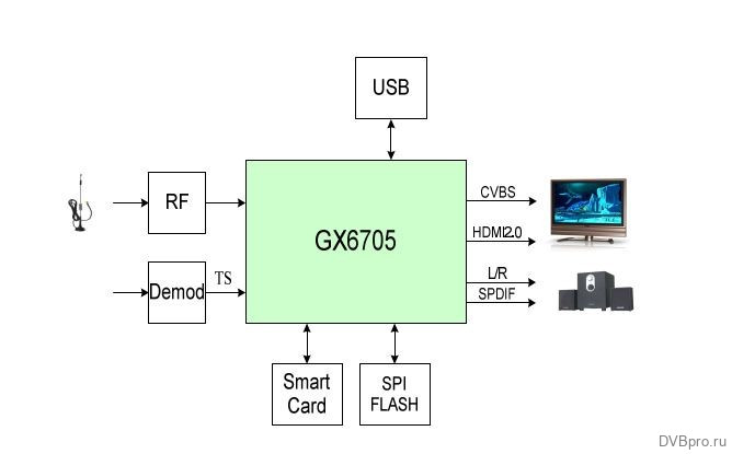

    These types of chips work with external Flash memory, but also have built-in RAM. The GX6705, for example, has 64 MB of DRAM, I could not find information on the GX6706.
    Block diagram of a DVB-T2 set-top box with GX6705 and connected interfaces
    The chip has a UART port out - could there be a chance for a bootloader?
    Close-up of GX6706S5 chip with visible RX and TX pads on a green PCB

    I soldered out the flash using hot air and ripped through the CH341:
    CH341 from Aliexpress and Allegro - what modifications are needed after purchase?
    On the computer side, I used NeoProgrammer. I used the command to analyse the batch binwalk in WSL:
    analysis of the SPI flash memory batch using the commands binwalk, dd, lzma
    I immediately got satisfactory results. The tool learned the packed batch and the ROMFS and SquashFS file systems.

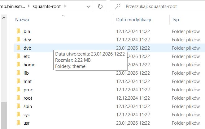

    binwalk -eM "GX6706S5 4mb flash dump.bin"

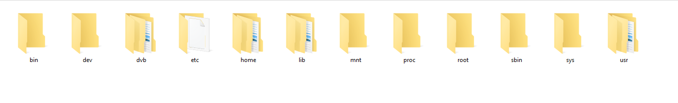

    SquashFS contains the Linux file system along with the characteristic folders bin, etc, mnt, etc.
    File Explorer screenshot showing squashfs-root folder with extracted Linux directories

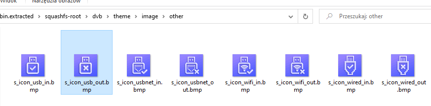

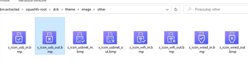

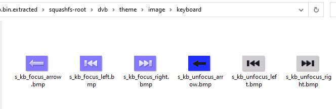

    In the Theme folder we have skin definitions - xml files and icons:
    Screenshot of BMP arrow icons from DVB-T2 receiver interface theme folder
    BMP icons from DVB-T2 firmware representing various USB and network connection types
    Abstract blue background with light streaks and bright flares
    Small graphics use the BMP format and larger images (e.g. backgrounds) use the lossy compressed JPG format.

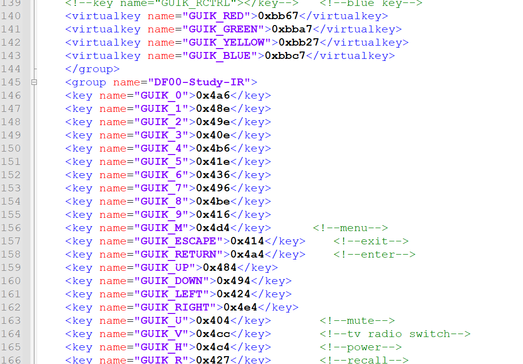

    XML maps names to paths and defines the mode of operation of the device:
    Code: text
    Code: text
    Interesting that there are typos in the XML - e.g. digtal instead of digital.

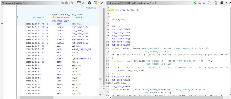

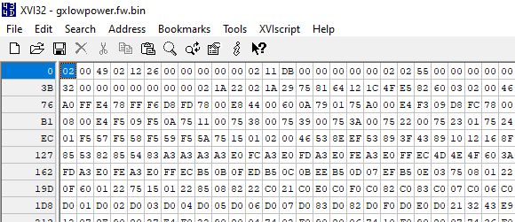

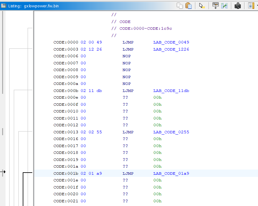

    In the firmware we have the file gxlowpower.fw:
    Screenshot from XVI32 showing hex content of gxlowpower.fw.bin firmware file
    Its header - repeated sequences of byte 0x02 and offsets - suggest to me an 8051 architecture. These are probably jump vectors/tab offsets to routines executed by an auxiliary microcontroller running in standby mode. Could it be that there is a second, small 8051 core in the NationalChips that is responsible for low-power mode: standby IR support, 7-segment display, LEDs and wake-up of the main SoC?
    Screenshot from Ghidra showing assembly code and LJMP jump addresses
    Ghidra correctly decompiles this firmware. You can see the correct C pseudocode, the jumps go to the correct functions.
    Screenshot of Ghidra showing 8051 assembly and decompiled C code of firmware

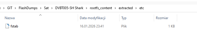

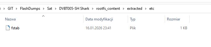

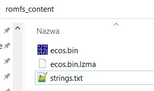

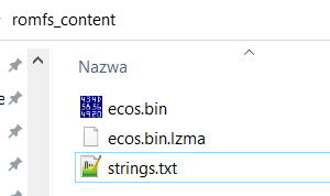

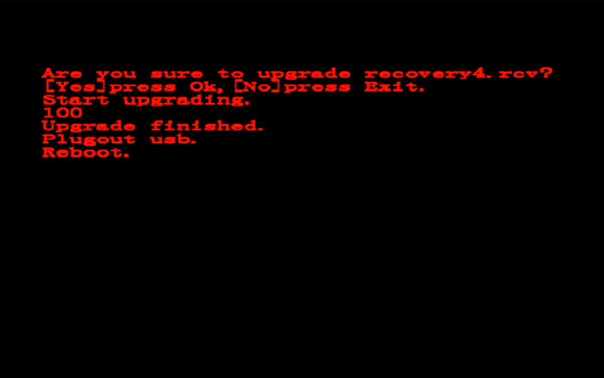

    Separately, we have the ROMFS section. As the name suggests, it is read only - read only. The actual ecos firmware is there, but you have to decompress it first - it uses the LZMA standard.
    Screenshot of the “romfs_content” folder with three files: ecos.bin, ecos.bin.lzma, and strings.txt
    Successful decompression is confirmed by analysing the subtitles from the middle:

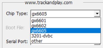

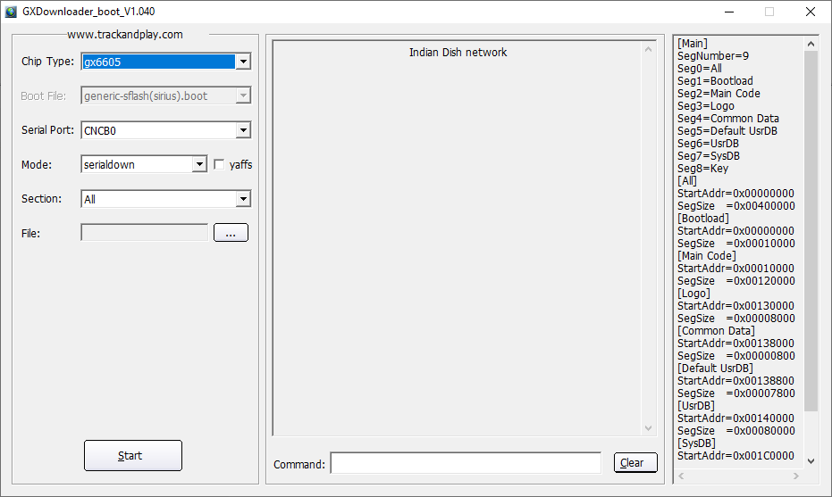

    However, I have not yet found a method to load this into Ghidr. I tried with the C-Sky plugin, but the results do not look like correct instructions.

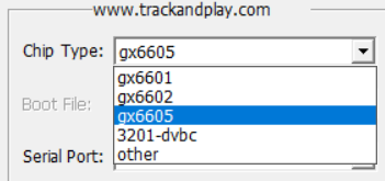

    Flasher GxDownloader
    I found one tool on the web - GXDownloader Boot, I put it in the attachments.
    GXDownloader_Boot window with selected chip gx6605 and setting panel on the left
    Supported chips:
    Screenshot of GXDownloader software with a dropdown list of GX660x chip types
    I found a short presentation of this programme on Youtube:
    https://www.youtube.com/watch?v=Tks2E1pZvwc
    Flasher Open Source from GitHub
    A search on GitHub gave me only one reasonable lead - libre-gxdl by matu6968.
    https://github.com/matu6968/libre-gxdl
    The project shown is a flasher for the NationalChip GX series of devices, which allows you to communicate with these devices at the hardware level and perform operations such as reading and writing memory via the serial and USB ports.
    It is a reimplementation of the original GX downloader (gxdl) tool obtained through reverse engineering.

    A very simple circuit, not surprisingly also available as 'plugs' for HDMI. The whole thing is basically a simple power supply in flyback topology, a voltage-reducing inverter, the main SoC with external flash memory for the program, the display together with the controller (a la HD2015), and the RF head (here signed 4110 A009 514 - I forgot the photo).
    The aforementioned SoC runs the eCos real-time system and in the Flash sits a typical Linux file system from which settings, icons and graphics can be extracted.
    Additionally, we have RX/TX pads available and have managed to find two promising tools for uploading the batch.
    Will anything more be able to be done with it? We are yet to find out, in the meantime, just for the sake of principle, I will ask - have you had any contact with receivers based on NationalChip chips? Or does anyone have more information about them?

    I have always been curious as to where the remote control codes might be hidden in such a FW. Often the decoder itself is fine but the supplied remote control is of poor quality. There are images circulating on the internet with substituted remote control codes, how do you do something like that yourself?
  • Remote keymap XML for DVBT005-SH Shark
    #13 21826452
    Posts: 14791
    Rate: 12937
    @__Grzegorz__
    Just this:
    Screenshot of folder with a 1 KB fstab file modified on January 16, 2026
    @elektronik123456789 maybe keymap.xml?
    Screenshot of XML key mapping for the DF00-Study-IR group

    You can use the software to extract the soft
    Basically the program is from GX6605S but it also works on GX6702 and GX6706S5
    unpack Rep...5S org.exe (516 kB)You must be logged in to download this attachment.

    I will add as a curiosity BOOT.bin file of size 128k has a name sewn in it for auto software update or recovery after failed upload, of course if the boot as such is not corrupted, this name is recovery.rcv
    An efficient decoder checks during start-up, if there is a file on the pendrive for auto-update, thanks to this it is known if the pendrive will be suitable for auto-update (the led on the pendrive flashes during decoder start-up)
    Description for auto-updating.
    Use a fat32 formatted pendrive for uploading
    It is best if the pendrive has a LED indicating reading and writing of data on it.
    Put the software on the pendrive with changed name to recovery.rcv
    Connect the pendrive to an unplugged decoder.
    After the decoder is connected to the power supply, the recovery.rcv file is automatically uploaded
    When the upload reaches 100 (as can be seen in the picture), the pendrive can be removed.
    The decoder should boot itself with the new software.
    Upgrade screen with red text on black: “Upgrade finished”, “Plugout usb”, “Reboot”
    LOGO.bin
    Just change the extension to jpeg and you can already see the startup wallpaper.
    ROOT.bin
    In this particular firmware you can see what is in this file.
    Use the 7-zip program.
    After extracting the ROOT.bin file, the following contents are displayed
    Windows Explorer screenshot showing folders: bin, dev, dvb, etc, home, lib, mnt, proc, root, sbin, sys, usr
    The most interesting content is located in the dvb/theme/ folder
    I will describe the most interesting files

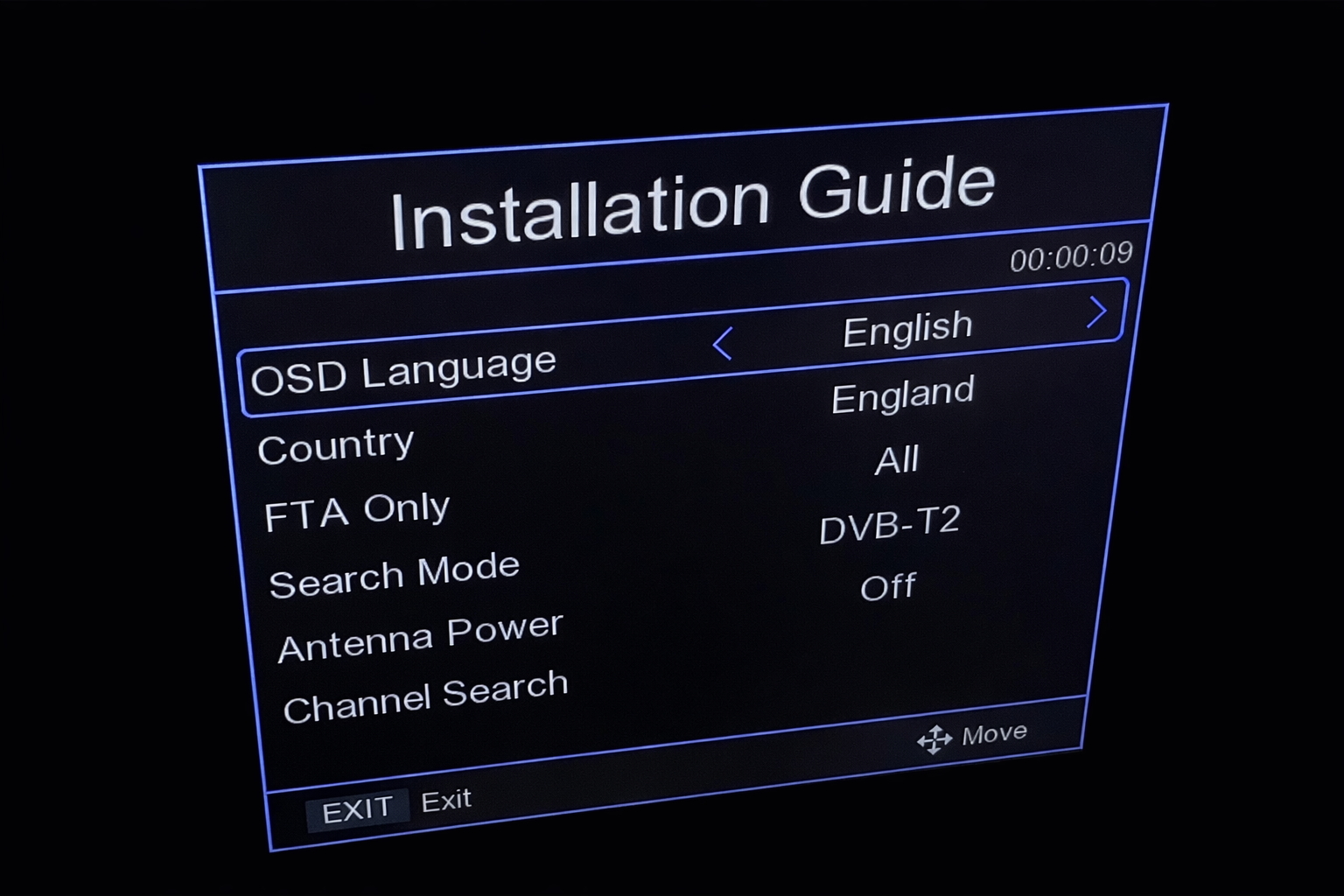

    In addition, this file contains data on the country which is used when searching for channels in the case below, the region England is set to
    <group name="Country config"/>
    <item display="country select" value="0">
    <list display="England" value="0" />
    <list display="Russia" value="1" />
    <list display="France" value="2" />
    <list display="Portugal" value="3" />
    <list display="Spain" value="4" />
    <list display="Greece" value="5" />
    <list display="Italy" value="6" />
    <list display="Poland" value="7" />
    <list display="Germany" value="8" />
    <list display="Thailand" value="9" />
    <list display="Australia" value="10" />
    <list display="Iran" value="11" />
    <list display="Netherlands" value="12" />
    <list display="Serbia" value="13" />
    <list display="Belgium" value="14" />
    <list display="Hungary" value="15" />
    <list display="Denmark" value="16" />
    <list display="Slovenia" value="17" />
    <list display="Luxembourg" value="18" />
    <list display="Norway" value="19" />
    <list display="Czech Republic" value="20" />

    In the language folder we have the languages in which the decoder menu will be displayed.
    The image folder contains all icons and backgrounds used by the software.
    Some settings of the start-up logo and e.g. remote control codes can be changed with the National Image Tool programme
    I do not know if this program will work 100% with the GX6706S5 processor
    Here the description from page National Image Tool
    Replace the remote control in the software
    Regarding the uploading of the software after rs 232 it should work in the newer version of the program GXDownloader_boot_v2.1.3 .
    Because it has settings for this processor cygnus-6706H5-sflash-24M.boot

    GxLoader has 2 variants (https://dvbpro.ru/vosstanovlenie-pristavki-nationalchip-gx-posle-proshivki/ ):
    - 64 KB BOOT partition - lite version, does not support doing software updates via USB
    - 128 KB BOOT partition - normal version, supports performing software updates via USB (this decoder has 128 KB bootloader, so this feature is supported)
    Some decoders have a bootloader 64 KB, others 128 KB so it is a surprise to get a better decoder that has a bootloader with the option to do software updates via USB.
    You can also see the process of doing software accuualisation via USB on the UART if the decoder supports it:
    USB0:   USB EHCI 1.00
    scanning bus 0 for devices... 2 USB Device(s) found
    1 Storage Device(s) found
    reading /recovery_all_force.rcv
    reading /recovery_all.rcv
    reading /recovery.rcv
    nports = 2
    warning: board-init not call function enable_dac, will open cvbs & ypbpr default.
    protect len: 0x0
    ____________usb update____block_num = 64________
    [usb_recover_proc]282 update proc 0%
    [usb_recover_proc]282 update proc 1%
    [usb_recover_proc]282 update proc 3%
    [usb_recover_proc]282 update proc 4%
    [usb_recover_proc]282 update proc 96%
    [usb_recover_proc]282 update proc 98%
    [usb_recover_proc]287 update proc finish
    Update finish, please plug out!!!!!
    restart...

What exactly is inside the DVBT005-SH Shark decoder?
One PCB hosts a PN8147 flyback PSU, NationalChip GX6706S5 SoC, 4 MB 25Q32CSIG SPI flash, HW650EO display/key driver, and an RF tuner can. The front has a four-digit 7-seg display and IR receiver. The underside is unpopulated. [Elektroda, p.kaczmarek2, post #21820059]

I see gxlowpower.fw. What is it?
gxlowpower.fw appears to be low-power firmware, likely for standby functions like IR and display. Its header suggests an 8051 architecture, and Ghidra decompiles it sensibly to C-like pseudocode. [Elektroda, p.kaczmarek2, post #21820059]
Can I flash or read the box over UART without desoldering?
Yes. RX/TX pads near the SoC expose a serial interface. Tools include GXDownloader Boot and the open-source libre-gxdl reimplementation for read/write over serial or USB. "The chip has a UART port out." [Elektroda, p.kaczmarek2, post #21820059]

How do I try decompiling the main CPU code?
The author attempted Ghidra with a C-Sky plugin for eCos content but did not get valid instruction decoding. You can still analyze strings and structures after LZMA decompression. [Elektroda, p.kaczmarek2, post #21820059]
