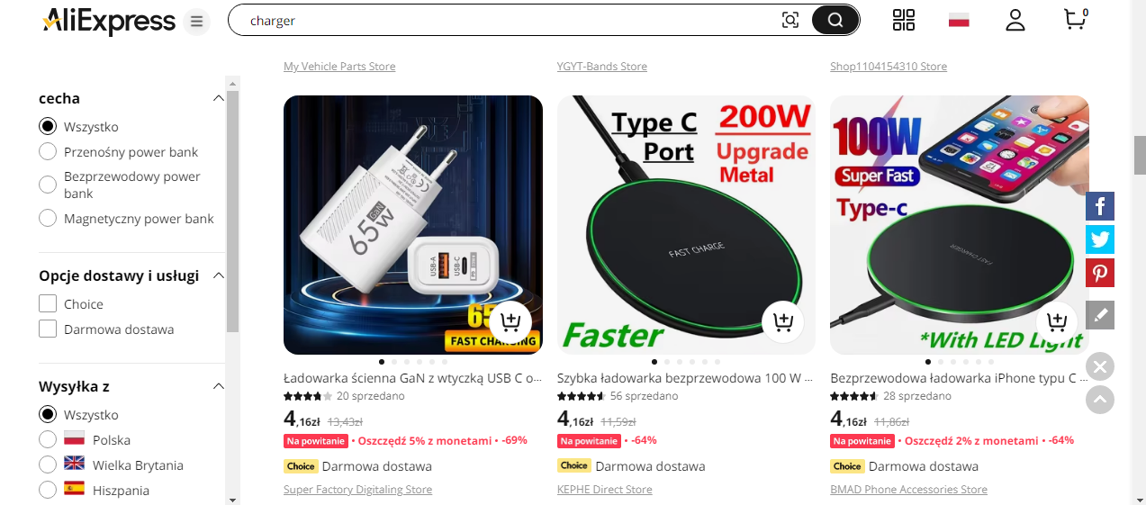

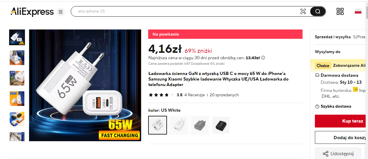

    I invite you to test the boisterously advertised welcome gadget offered to us by AliExpress for just 1$ with free shipping. Here I will check what performance this power supply has in practice, whether it really supports QC and reaches 65 watts, and whether the voltage at its output is safe for our mobile devices. In addition, I will also look at its PCB under thermal imaging to determine what heats up the most.
    Advertisement for 65W GaN wall charger with USB C on AliExpress website

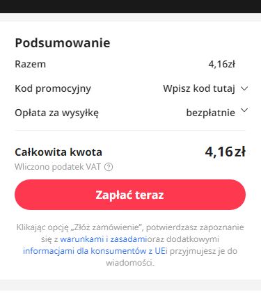

    Let's start with the purchase. The whole thing comes under different names, to me it popped up as a "GaN wall charger with USB C plug". I already have reservations about the name itself, if only because essentially the charging circuitry is already in the phone, and here we have, as it already is, a power supply, although I'm more concerned about that GaN and 65 W....
    Screenshot of 65W USB-C charger listing from AliExpress with product image and description

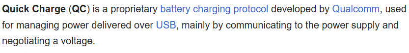

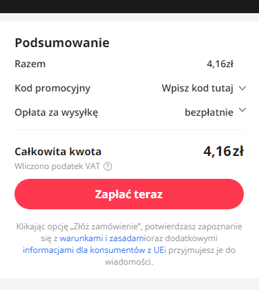

    Fast charging (QC standard - higher voltage?) also caught the title. Well, hard, we buy:
    AliExpress order summary showing a final price of 4.16 PLN with free shipping
    If problems arise, simply open discussions with the seller.

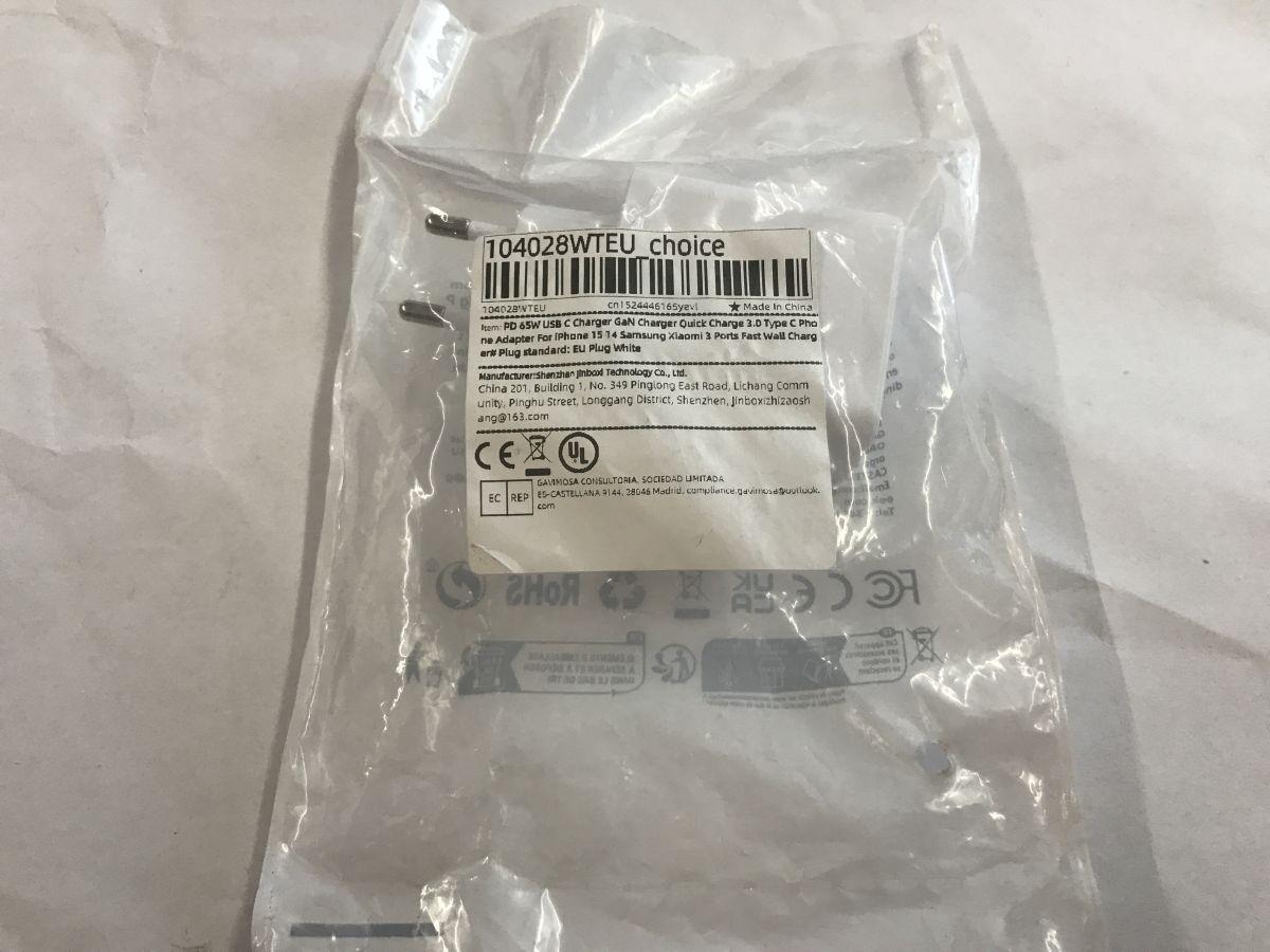

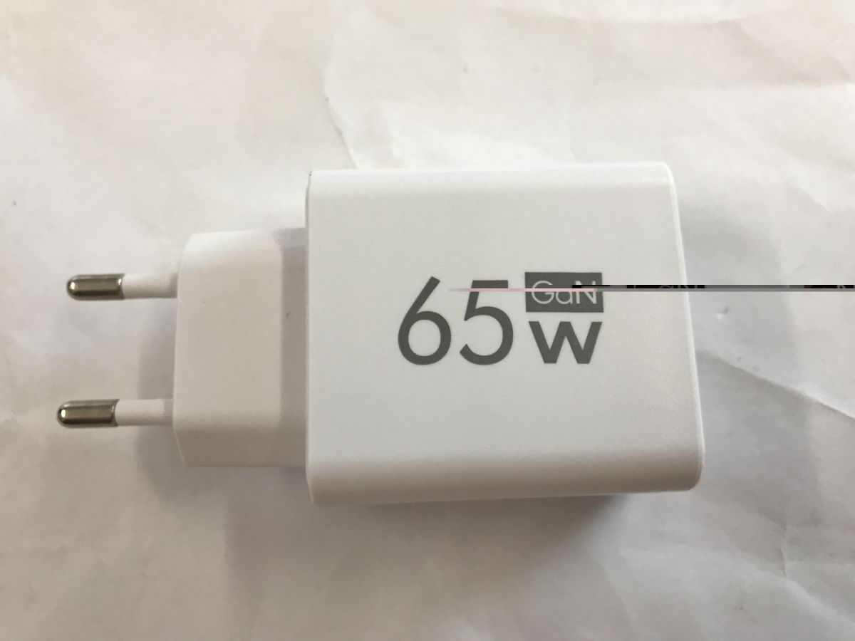

    I waited a long time for the package to arrive, but here it is - there's no mistaking it, it says 65W on the packaging and case too:
    Plastic packaging with 65W USB C charger label and visible EU plug Close-up of product label on Chinese electronic device packaging

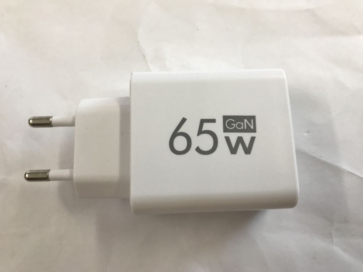

    On the device we have its performance (?) - up to 7.2 A at 9 V, up to 5.4 A at 12 V and up to 3.25 A at 20 V:
    USB-C wall power supply labeled 65 W, model TRG-185 White charger labeled 65W GaN with European plug White charger with USB-A and two USB-C ports, labeled PD 33W.

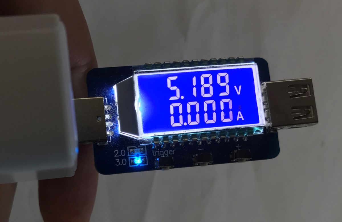

    All nice, but QC trigger can't even switch on 7V - what's up?
    USB meter display showing 5.189 V voltage and 0.000 A current

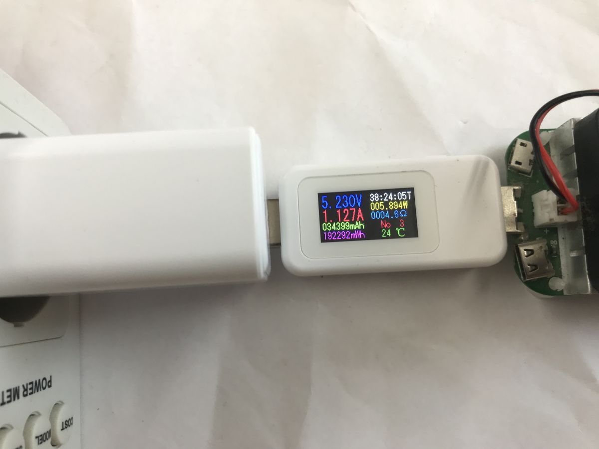

    Let's not judge in advance. The QC trigger may have broken down for me, perhaps it's run-of-the-mill. Worse, at 5 volts I can also draw up to 2 amps and then the voltage drops:
    USB tester showing 5.23 V and 1.127 A connected to white power adapter and PCB. USB tester shows 3.593 V and 2.563 A, connected to a disassembled USB-C power supply.
    One might get the impression that we have a 5 V 2 A power supply here, but this remains to be checked.

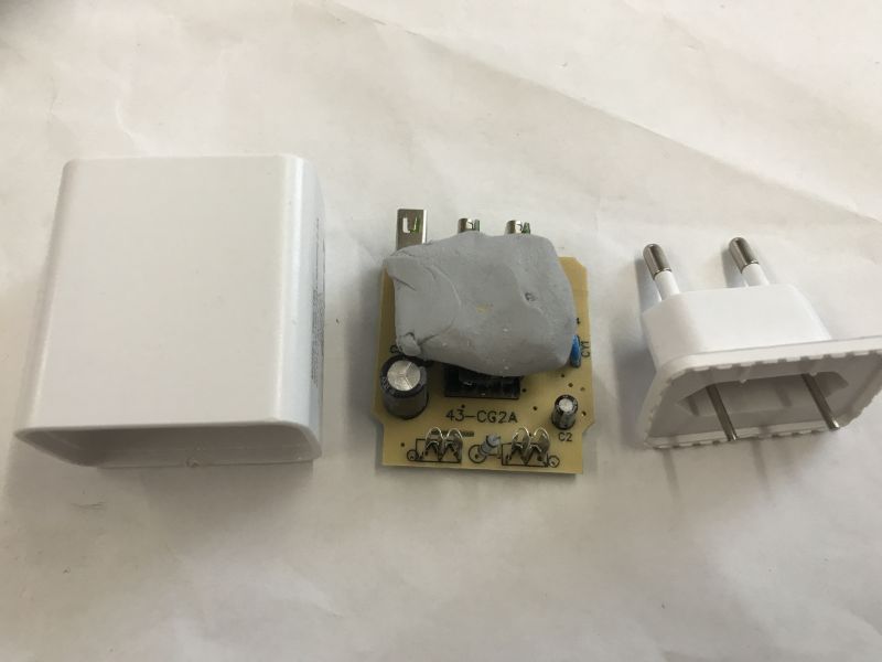

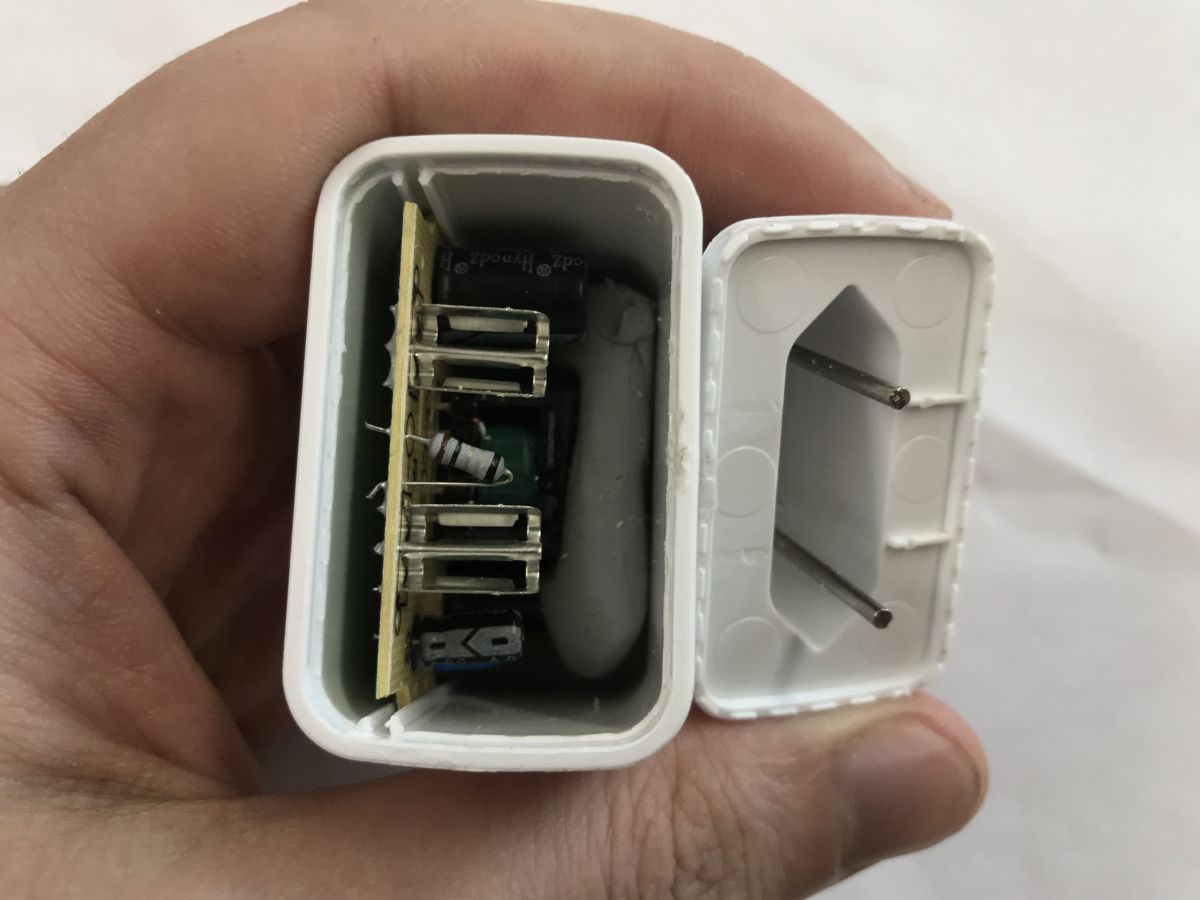

    Interior of the gadget
    The whole thing is suspiciously easy to disassemble. I can get the impression that this device does the autodisassembly itself when plugged in and pulled harder at an angle.
    Disassembled USB-C charger showing internal PCB and loose power plug
    This is how the plug is connected to the board - on contact. Inside we have a small PCB with a load bonus:
    Disassembled plastic USB power adapter with exposed internal PCB and plug

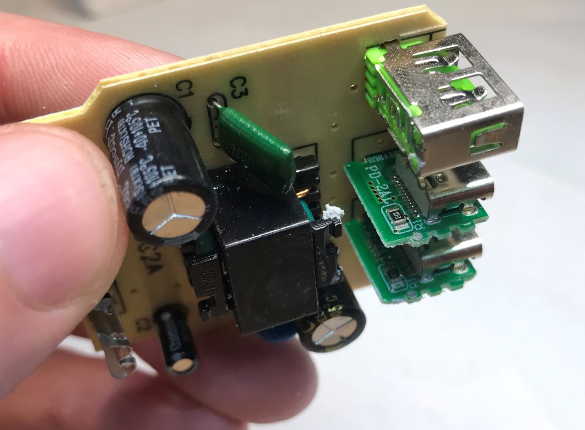

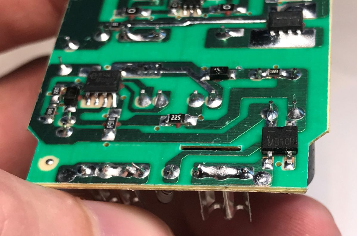

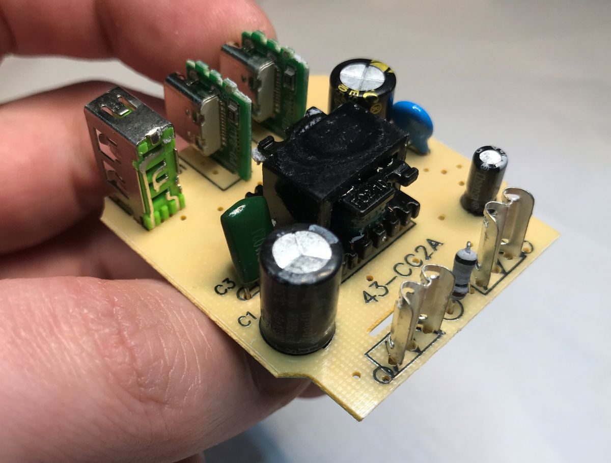

    Here's the PCB itself. Everything is on a poor, single-sided board. It does not resemble a GaN power supply:
    Close-up of power supply PCB with electronic components and USB ports
    You can see by the pins from USB C alone that only 5 V is connected here. There are no derived signals responsible for QC negotiation.
    Close-up of power supply PCB with capacitors, USB ports, and electronic components

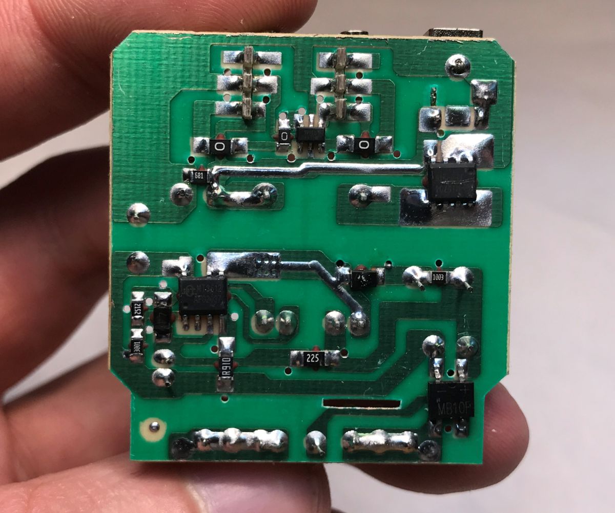

    I don't see anything else on the underside either - all we have here is a PSR (Primary Side Regulation - no optocoupler) flyback converter controller, a synchronous rectifier (on the secondary side - instead of a Schotky diode), and a small circuit to probably let the power supply report to the phone to let it know it can draw more than 500 mA.
    Power supply PCB with visible ICs, resistors, and solder joints.
    We only have a fuse at the input, and then there is a rectifier bridge. Then the minimum inverter circuit:
    Close-up of a single-sided PCB with electronic components from a USB charger.

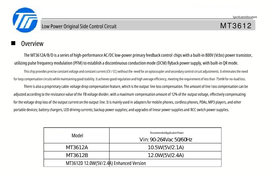

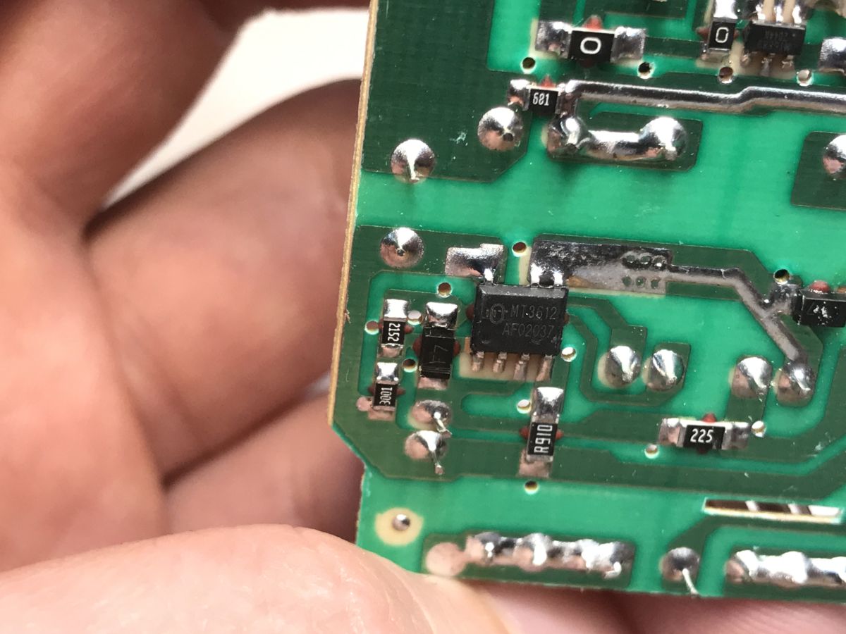

    You can easily read that the inverter is based on the MT3612:
    Close-up of MT3612 chip on a power supply PCB with SMD components
    This fully dispels any doubts - according to the catalogue note, we have here up to 10/12 W depending on the version:
    Document excerpt showing MT3612 chip specs and a table of model variants with power ratings.

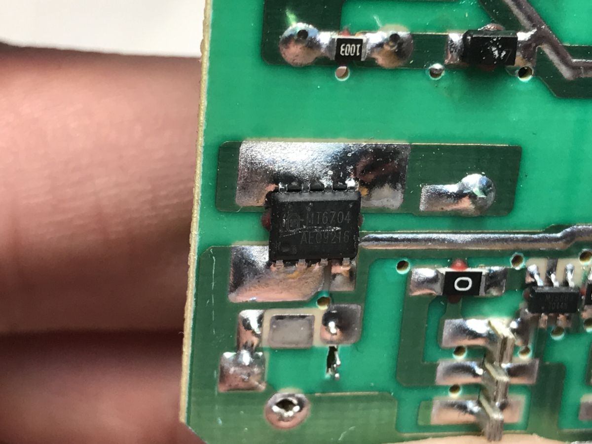

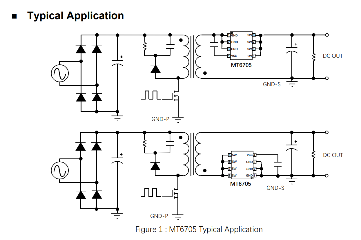

    Now we look at the secondary, low-voltage side.
    PCB with MT6704 chip and other electronic components in a close-up view
    There is only one more modern aspect here, as we have an MT6704 synchronous rectifier (based on a MOSFET) instead of a Schotky diode:
    Typical application diagram of synchronous rectifier using MT6705 IC

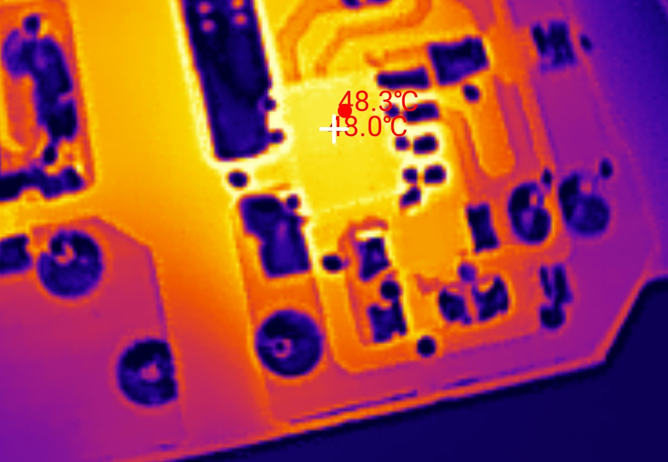

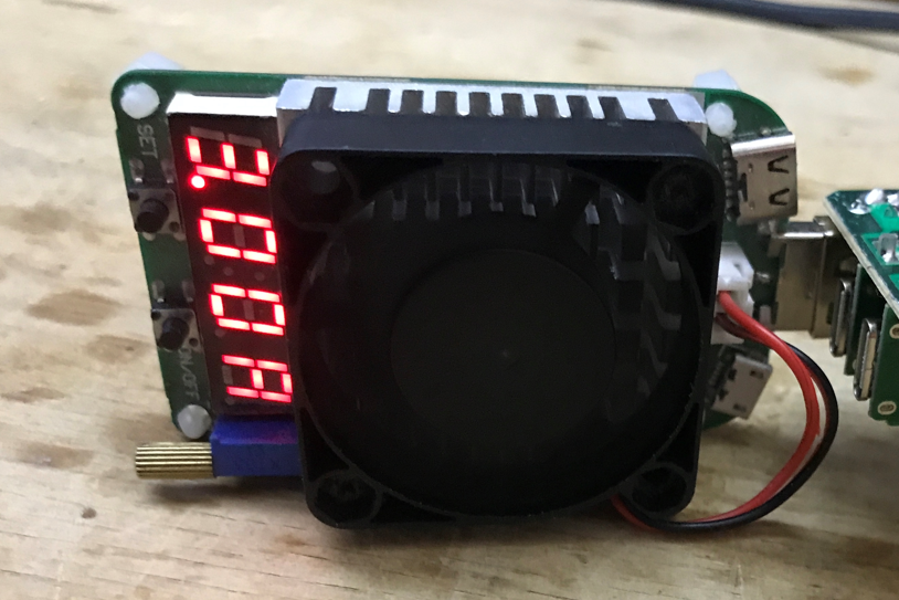

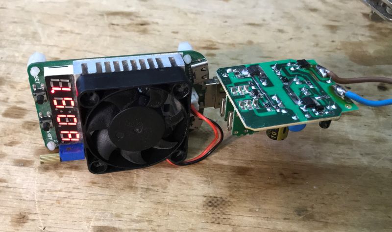

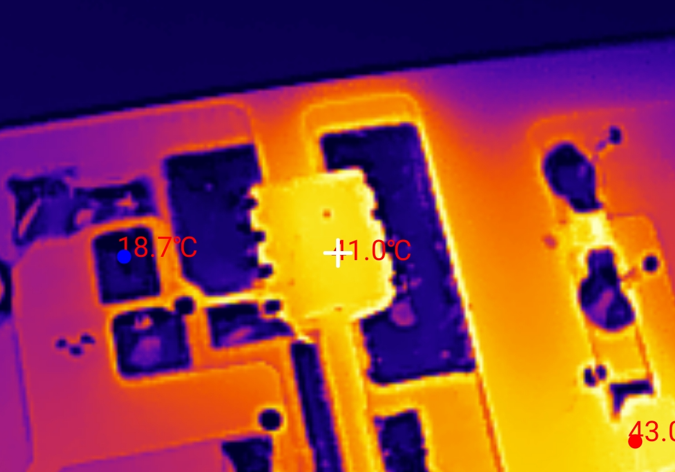

    To start with a current of 1.5 A:
    Electronic tester with fan connected to open USB-C power supply PCB

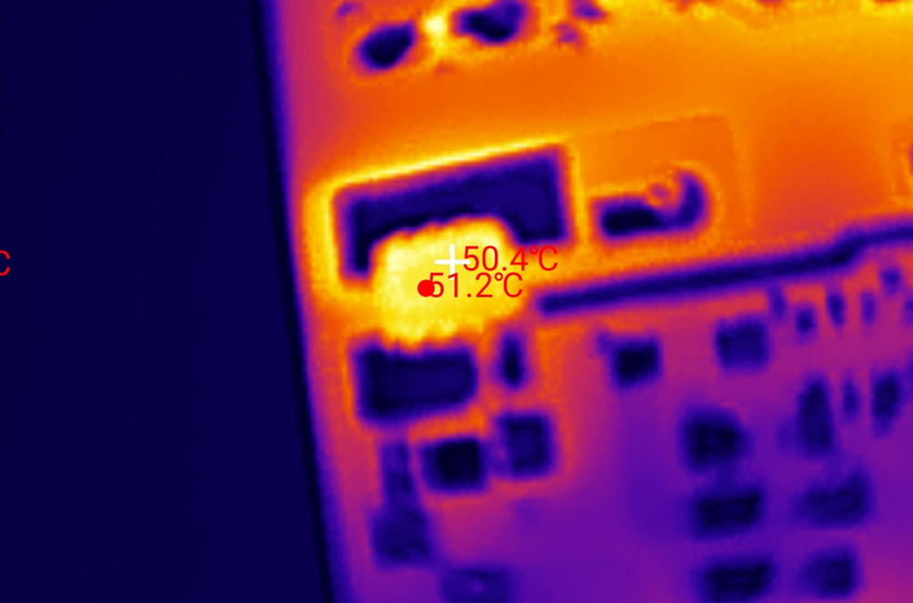

    After half an hour the main PSR controller approaches 50 °C, the synchronous rectifier heats up a little less.
    Thermal image of a PCB with three marked temperature readings Thermal image of a PCB with a hot spot marked at 48.3°C

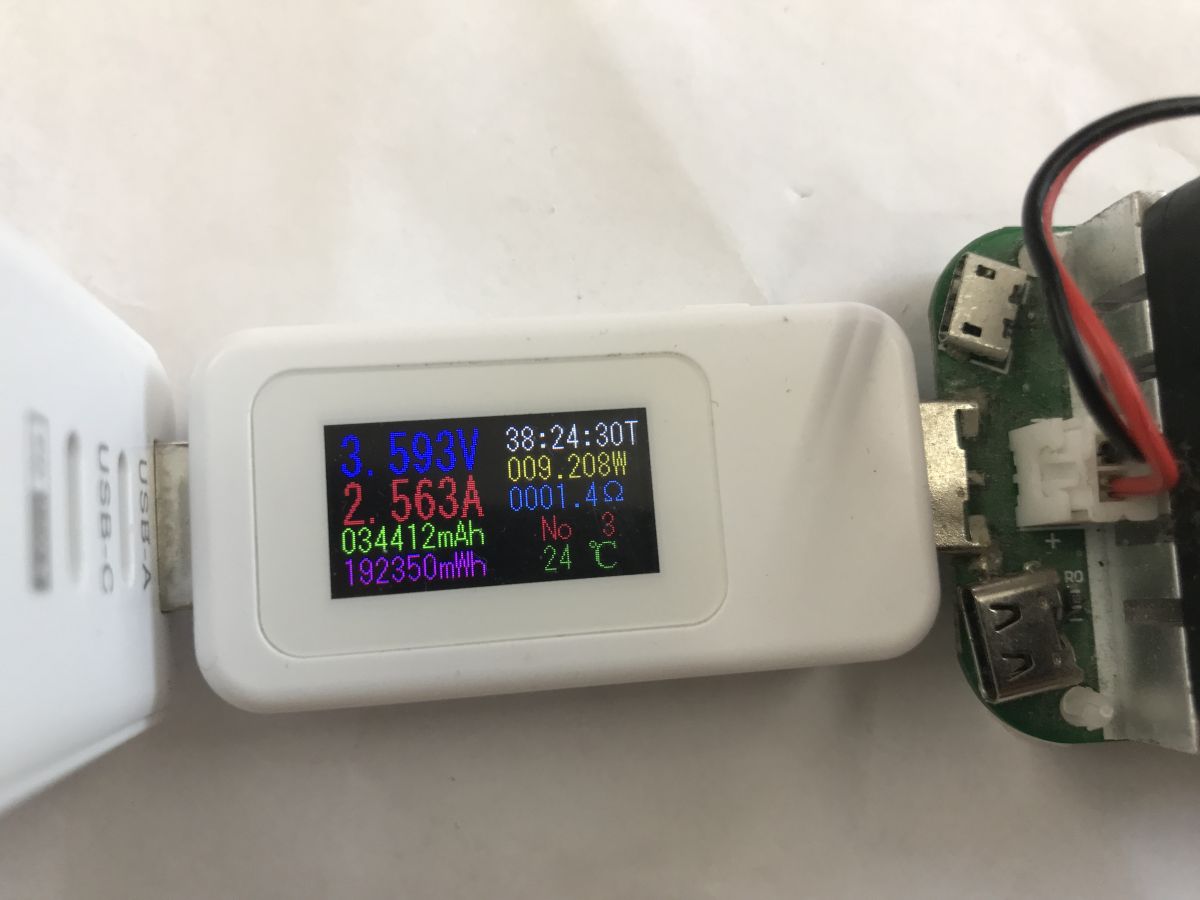

    This is very strange, but after a momentary load of 1.5 A the voltage starts to jump to 6.5 V.

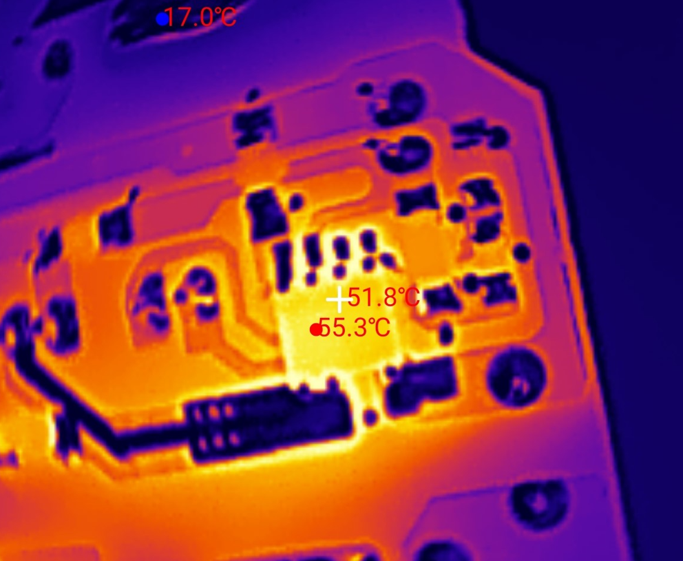

    What happens, on the other hand, when we increase the current?
    USB power tester with fan and red LED display measuring voltage and current Electronic module with LED display showing 6.59 V and small cooling fan
    At this load, the systems exceed the 50 °C limit.
    Thermal image of PCB with marked hotspot reaching 55.3°C Thermal image of PCB with highlighted area reaching over 50°C
    The voltage is also able to occasionally drop to 3.4 V, i.e. the overload protection is trying to protect the inverters.

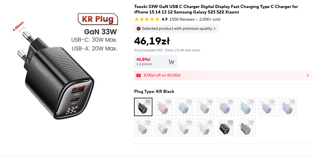

  • Cheap chargers often overstate power and lie on displays
    #18 21826713
    Karol966
    Posts: 2038
    Help: 83
    Rate: 645

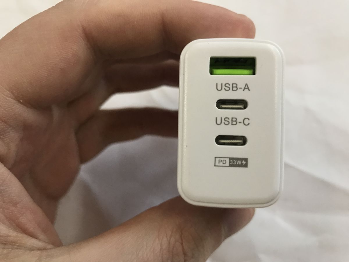

    I once bought a 120W charger from majfriends, such a beautiful yellow one, 4 USB ports including 2 USB-C with a silver border. Of course, it had the same power as the one in the topic - 10W. A piece of steel in the case was used as the load. However, it didn't cost PLN4, but something like PLN10 (although that's 250% more, I didn't expect anything from it - I needed a charger that would give a maximum of 20W - I was hoping that with 120 these 20W could be given, but I was wrong).
    I got it back, the charger was left (nobody wanted it) and I don't want it either.
    I bought a newer, weaker and more expensive one (something around 45W, with a small LED display). I've learnt from experience that before dismantling it, I applied a magnet and was pleasantly surprised - it doesn't have a piece of steel inside, but it weighs something. So maybe it will work. It didn't...
    Same crap, plastic inside. Power 10W. The display was lying in plain sight, but how interesting - at the very beginning it showed quite close to the current and after a few seconds it just increased the display by 1A (from 2A to 3) although in fact there was still about 1.8A flowing.
    Of course the money was refunded and nobody wanted this crap.
    I don't like these practices of the majfriends - there should be a complete ban on the sale of such crap to the EU under threat of heavy fines. They want crap, and a lot of people are writing them positive reviews/comments for it, so let them feed this crap at home and not send it all over the world. Shit!
    Added after 3 [minutes]:
    bearq wrote:
    I found 3 chargers priced at 100PLN+ with a claimed power of ~100W. After testing under load it turned out that two chargers do indeed give about 100W but only for the first 2-3
    And I finally bought a good charger that meets the manufacturer's claim. It was supposed to be 33W and the most I saw on it was 31-32W (with an external meter). On 11.11 I bought it for just under 6USD:
    Black Toocki 33W charger with LED display and two USB ports.

    Have you also come across this type of electronic trap in online shops?
    Yes, such a situation has happened to me. I described the case in my article A microSD card reader from an auction portal: test and summary of the whole construction . Marketed as operating at USB version 2.0 speeds, the reader turned out to operate at speeds adequate to the obsolete version 1.0.
  • QC does not support voltage negotiation

    Try this charger to charge a liion cell, or a pack, or a liion battery. I wish you good luck...
    Note to the Author - QC (quick charge) does not support voltage negotiation!!! Such inventions are supported by the PD (power delivery) standard developed for power supplies. Okay, I'm not extending this prompt because I'll generate too many tokens and the price will knock me off my pins.
    The test alone shows that it's not worth buying electrical junk made in Ch.R.L. or C.R.P.
  • #24 21829567
    Posts: 14648
    Help: 655
    Rate: 12660
    Probably Quick rather than Quck and rather negotiating:
    Wikipedia snippet defining Quick Charge (QC), mentioning USB power management and negotiating voltage.
    https://en.wikipedia.org/wiki/Quick_Charge
  • #25 21829610
    LEDówki
    Posts: 9507
    Help: 1312
    Rate: 2563
    This has changed... I correct the typo, oh shame.... Others should not be ashamed of their mistakes if they are so attached to them. A very good article, for the sake of clarity and to cut down on over-interpretation. Of course, electro-junk lovers will unabashedly buy this because it's cheap.
