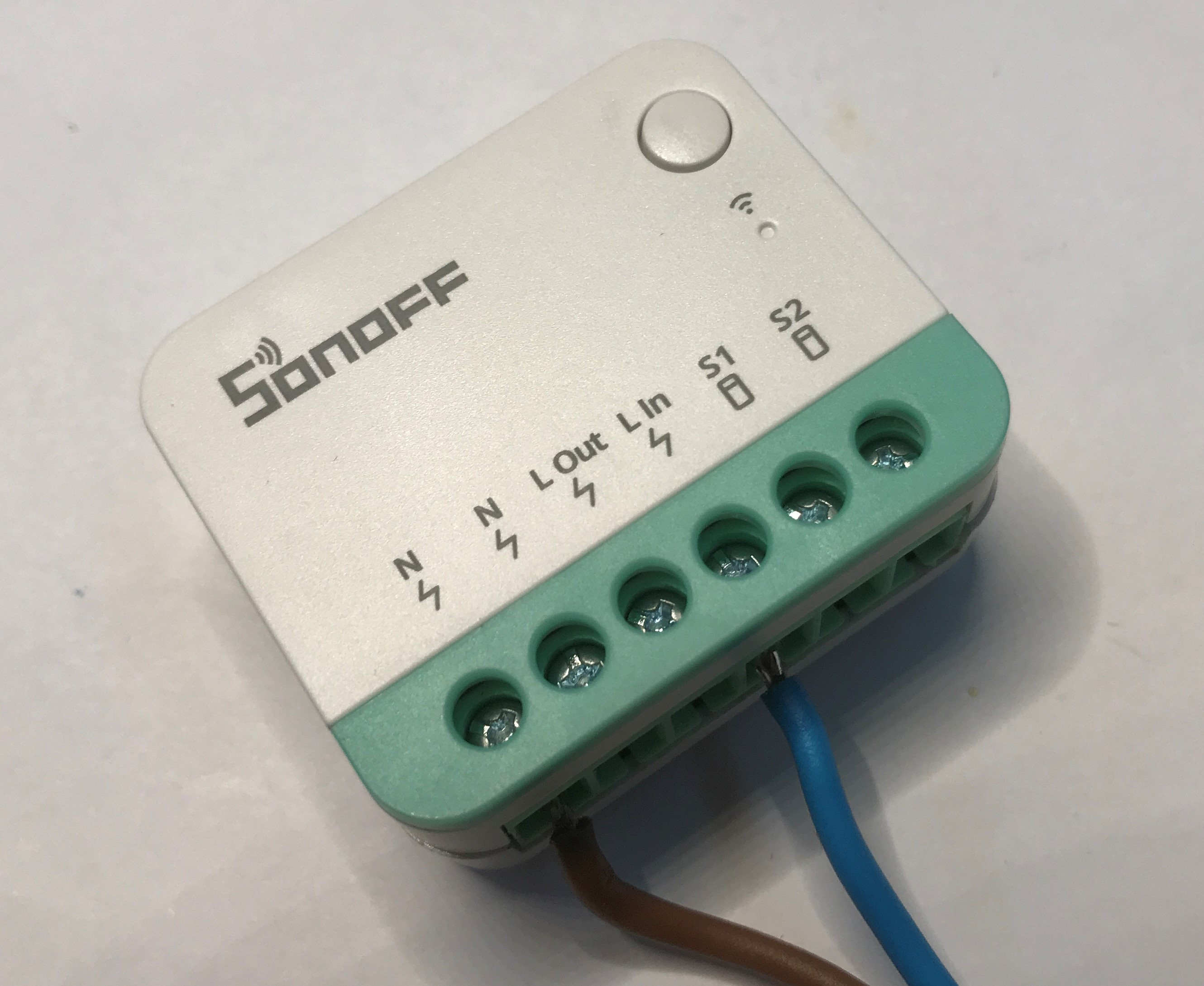

Sonoff MINIR4M relay with visible terminals and connected wires
The Sonoff MINIR4M is a small, in-box relay that allows you to easily turn a simple lighting or electrical device into a Wi-Fi-controlled building automation component. With Matter support, it can work with different ecosystems (Apple Home, Google Home, Alexa) without being locked into a single app.

The product is really compact - its dimensions are only 39.5 x 33 x 16.8 mm. It can be hidden in a deeper box just behind a regular switch, which it will also handle. It operates on 100 - 240 volts.
Sonoff MINIR4M module with technical markings and QR code on the casing
It's time to plug it in and test the application:
Sonoff MINIR4M module with labeled terminals and connected power wires
