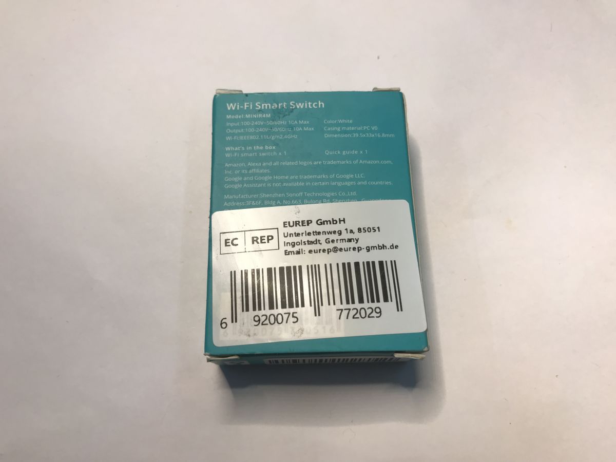

    We bought the Sonoff Mini R4 M for PLN30. This is a little more expensive than the cheapest Tuya products, but maybe it's worth it? All we get in the kit is the product itself and the manual:

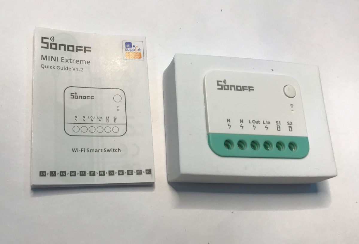

    Sonoff MINI Extreme smart switch box with Matter and smart home logos Back side of Sonoff MINI R4M packaging with technical details and distributor label Sonoff MINIR4M relay beside Quick Guide V1.2 manual

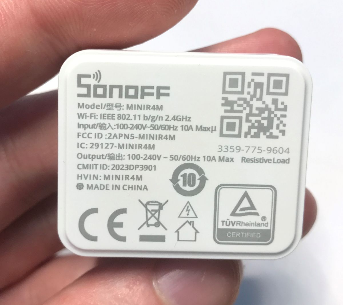

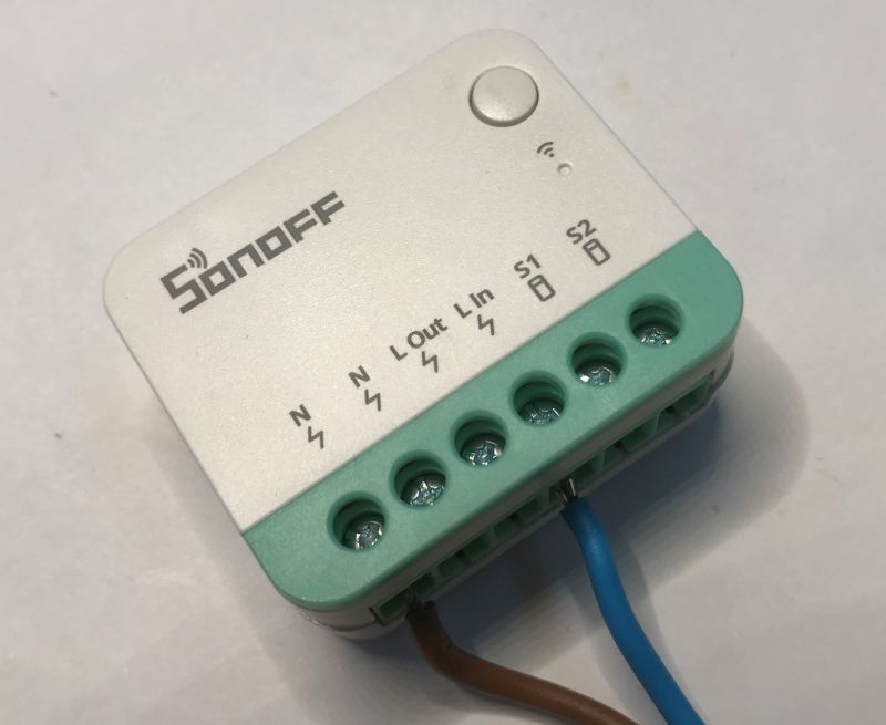

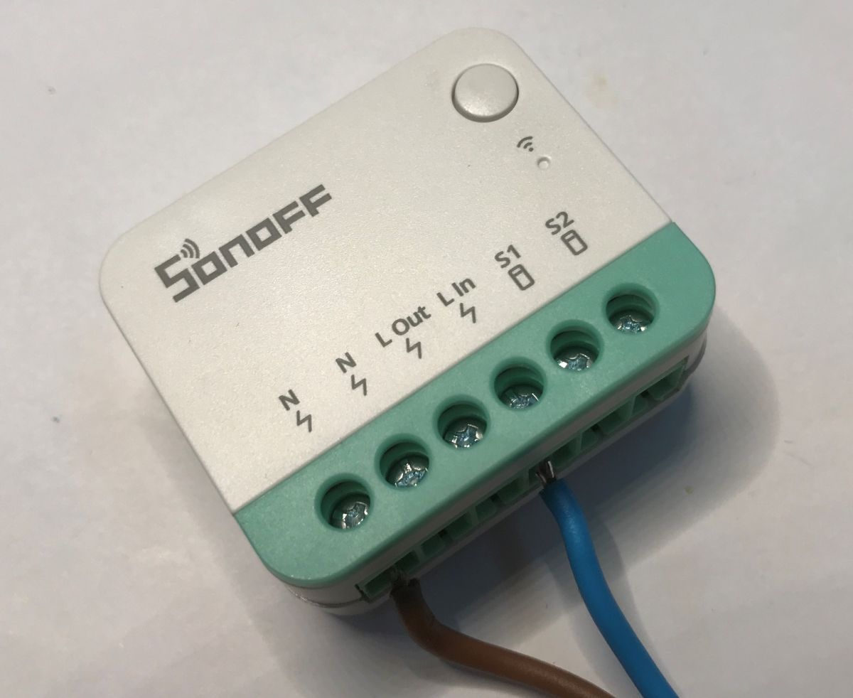

    The product is really compact - its dimensions are only 39.5 x 33 x 16.8 mm. It can be hidden in a deeper box just behind a regular switch, which it will also handle. It operates on 100 - 240 volts.
    Sonoff MINIR4M module with technical markings and QR code on the casing
    It's time to plug it in and test the application:
    Sonoff MINIR4M module with labeled terminals and connected power wires

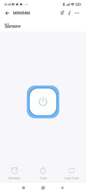

    Test with the eWeLink app

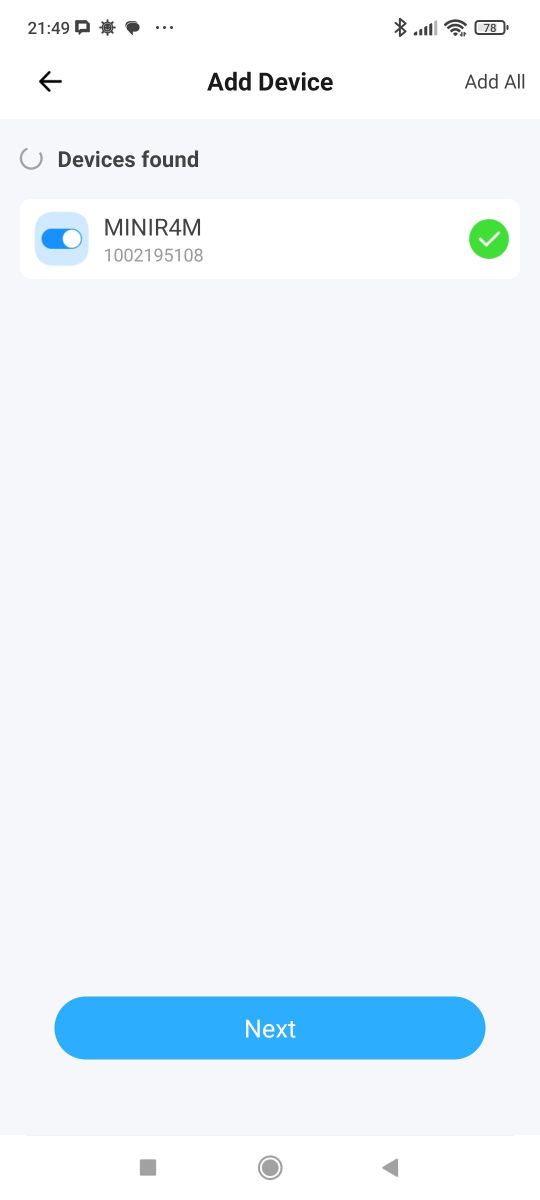

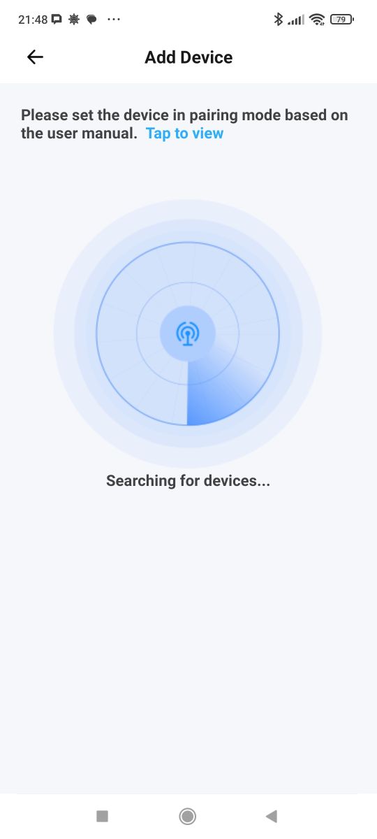

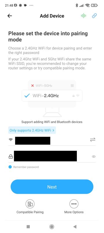

    We download the app and create an account. The product works with a 2.4 GHz Wi-Fi network. We put it into pairing mode. The phone finds the device:
    Device pairing screen with 2.4 GHz Wi-Fi selected and password input field visible eWeLink app screen showing pairing mode and searching for devices animation. App screen showing instructions to set up Sonoff device by scanning the QR code

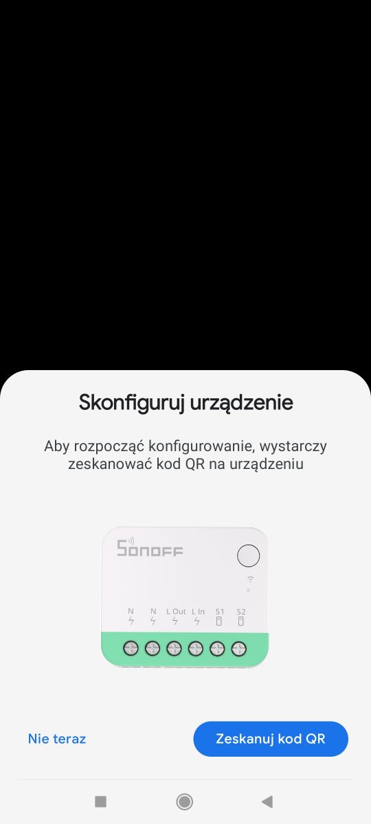

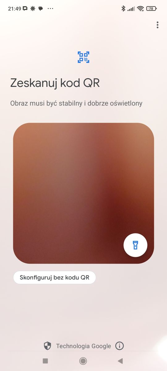

    This is the Matter device - you need to scan the QR code here too. It is located on the casing:
    QR code scanning screen in app with flashlight button and setup without QR option eWeLink app screen showing SONOFF MINIR4M device detected Pairing screen for MINIR4M device in eWeLink app on smartphone

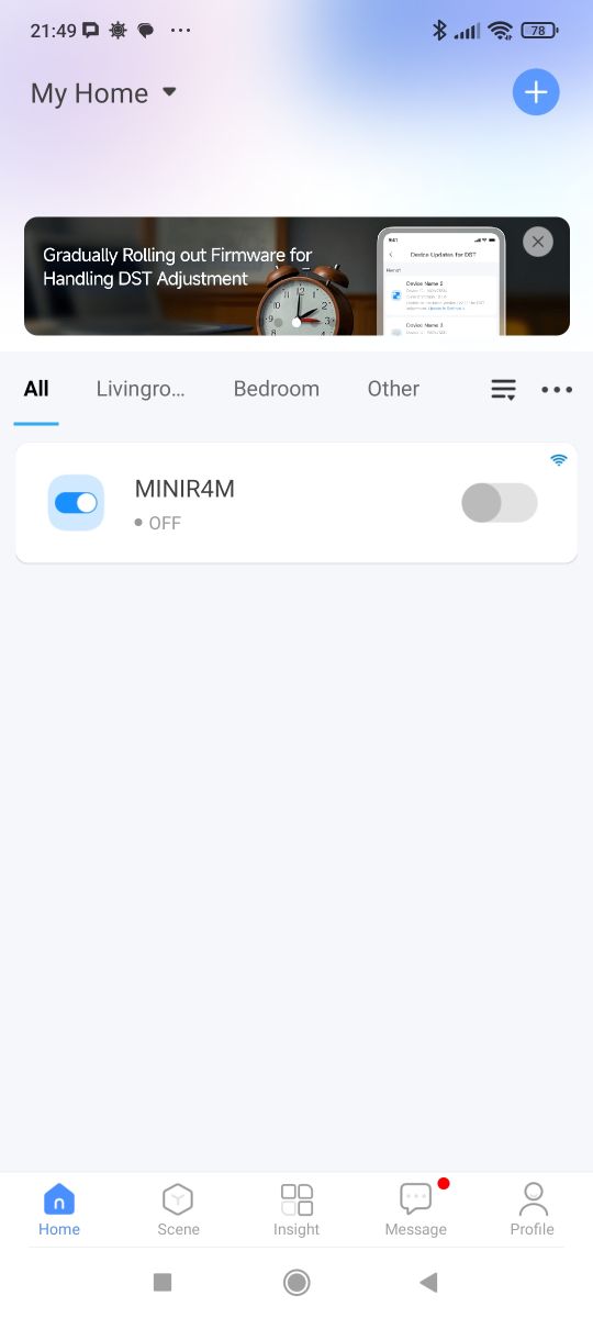

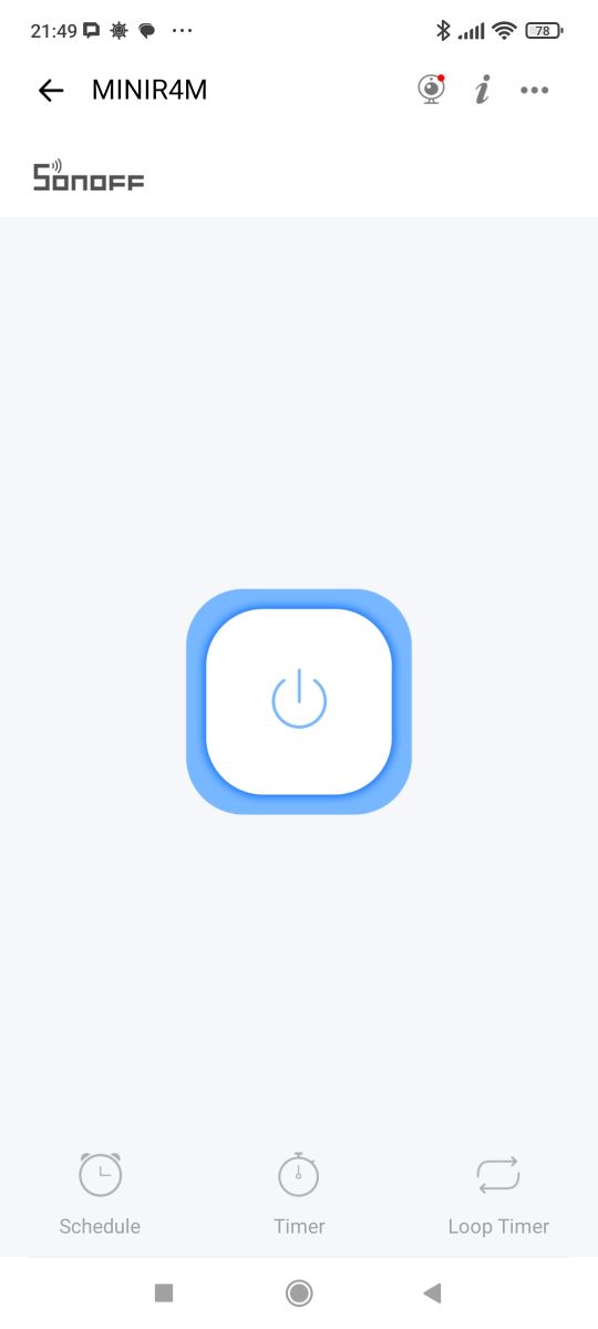

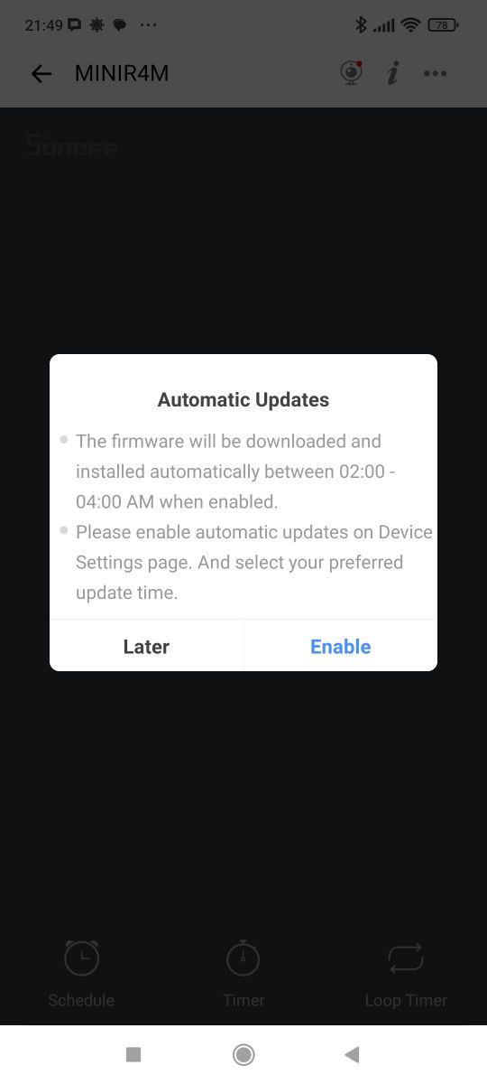

    This way we get remote control of the device from within the app. The app also asks us for updates, which it proposes to do at night between 2:00 and 4:00.
    eWeLink app screen showing Sonoff MINIR4M relay in off state Automatic update prompt for Sonoff MINIR4M in the eWeLink app eWeLink app screen showing Sonoff MINIR4M device with power button highlighted

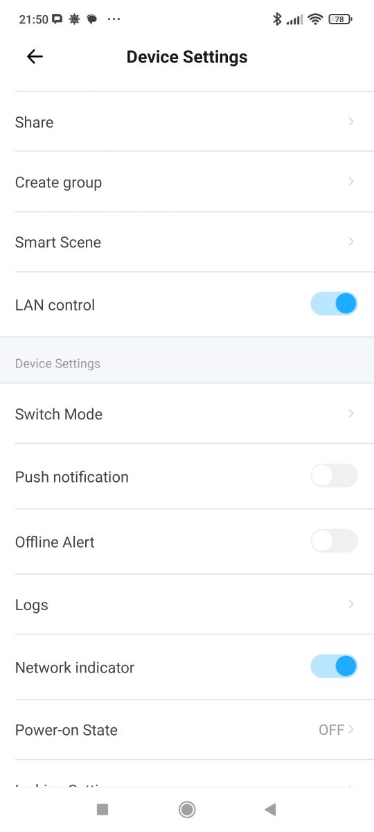

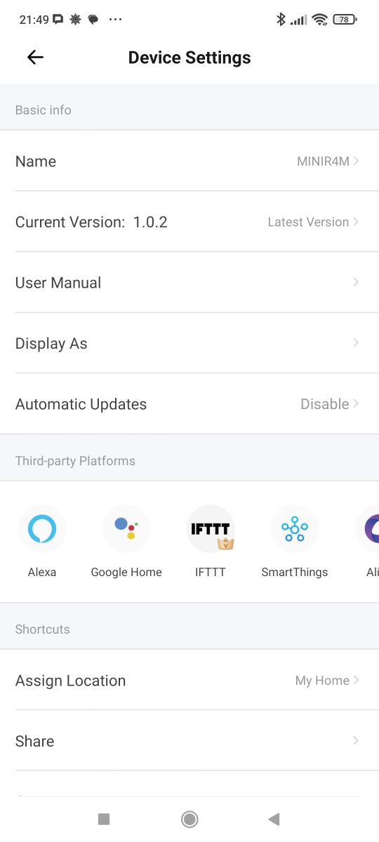

    The device offers integrations with platforms such as Amazon Alexa, Google Home, IFTTT, SmartThings, etc. Scenes and automations are offered as standard. Here we additionally have support for control via LAN (local area network), notification and alarm settings when the device is offline. It is also possible to disable the Wi-Fi status LED (network indicator) and set the status when power is restored. This is very convenient!
    Device settings screen for Sonoff MINIR4M in the eWeLink app Device settings screen in the eWeLink app showing enabled LAN and network indicator

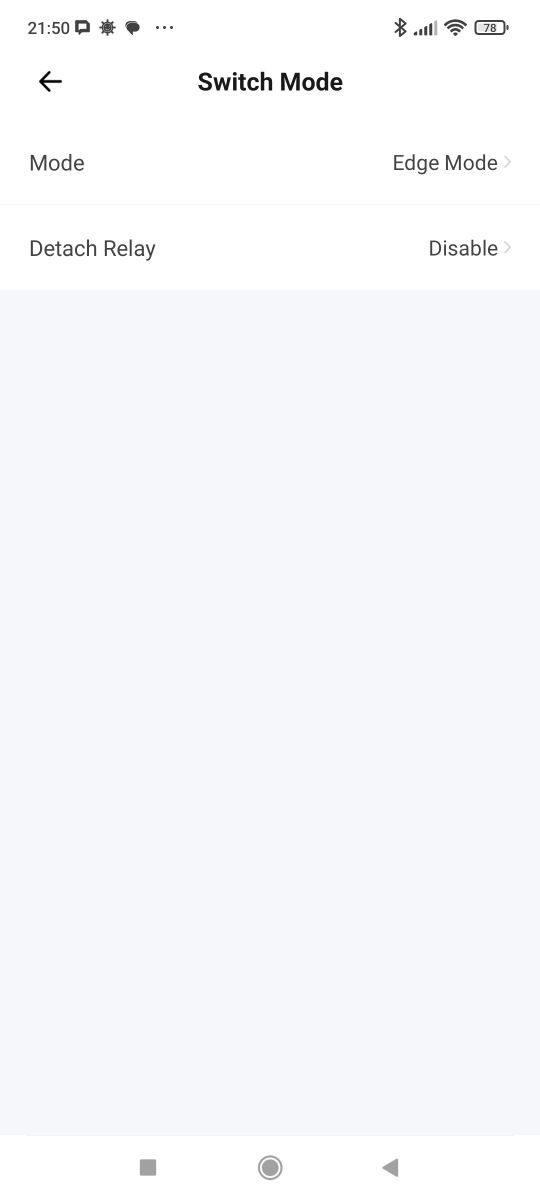

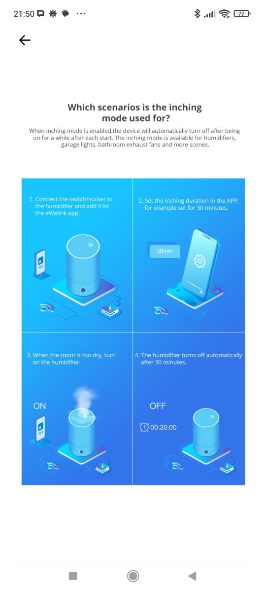

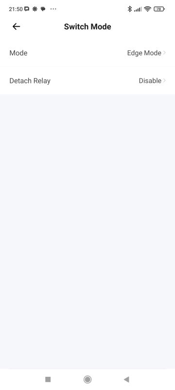

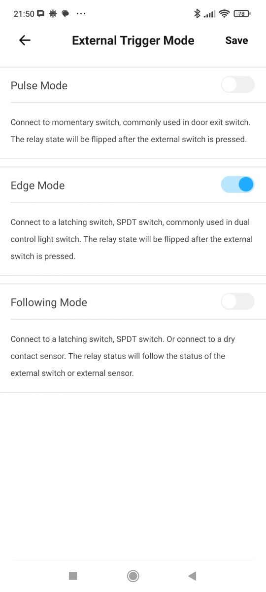

    Switch mode, on the other hand, allows you to handle different types of buttons - bistable and monostable. In addition, you can also separate the relay from the button to rely on automations.
    Screenshot of switch mode settings in the eWeLink app Screenshot of Sonoff app showing external trigger modes for relay control

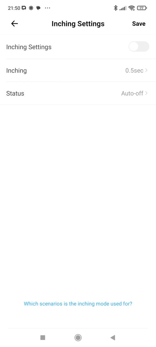

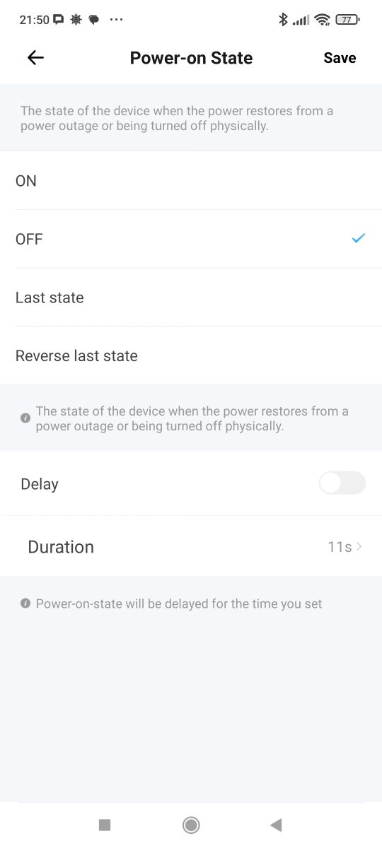

    There's news in the status settings after power restoration too. The delayed option I hadn't seen before. There is also inching left - that is, an automatic return to the previous state after a given time. The infographic shows that this is useful for switching off the humidifier, for example.
    eWeLink app screen showing power-on state settings for the device eWeLink app screen showing Inching Settings for Sonoff device App screen with illustration showing how to use inching mode for a humidifier.

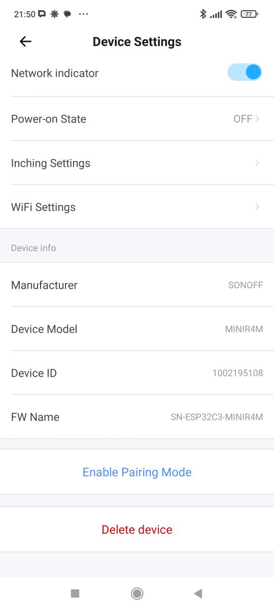

    You can also check the firmware and device version in the settings:
    Screenshot of Sonoff MINIR4M device settings in the eWeLink app
    There are more options than before. I am impressed.

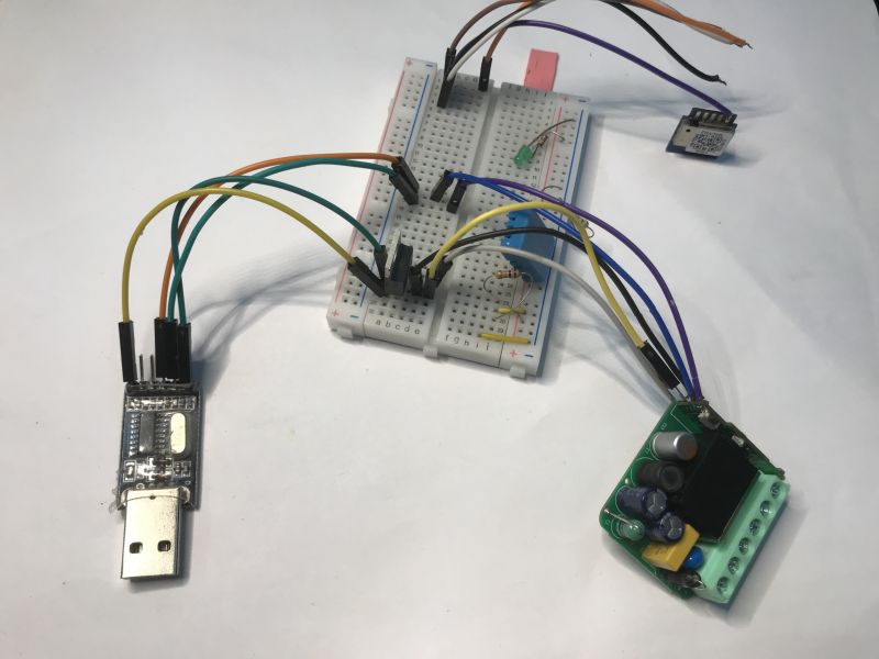

    Interior and programming test

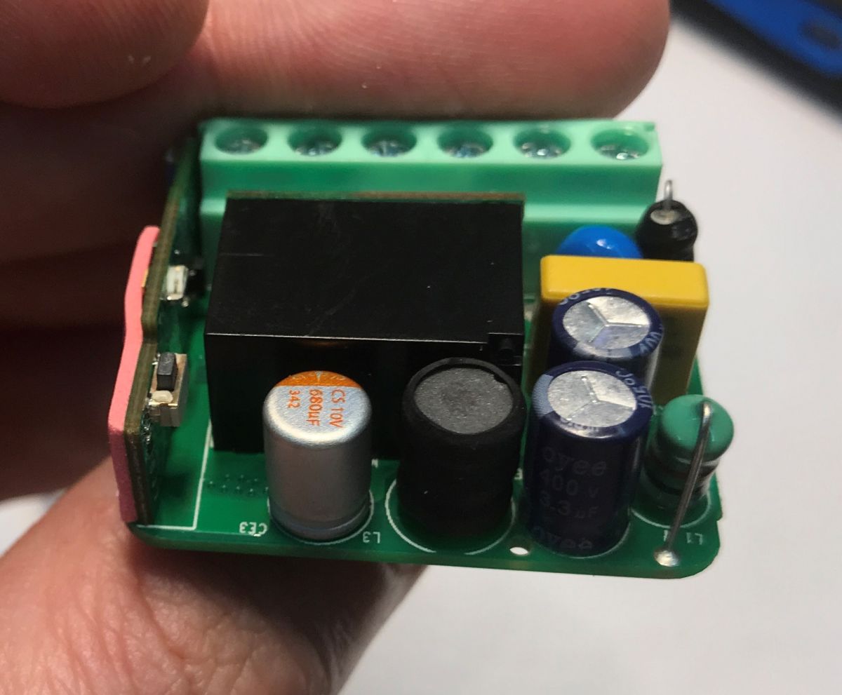

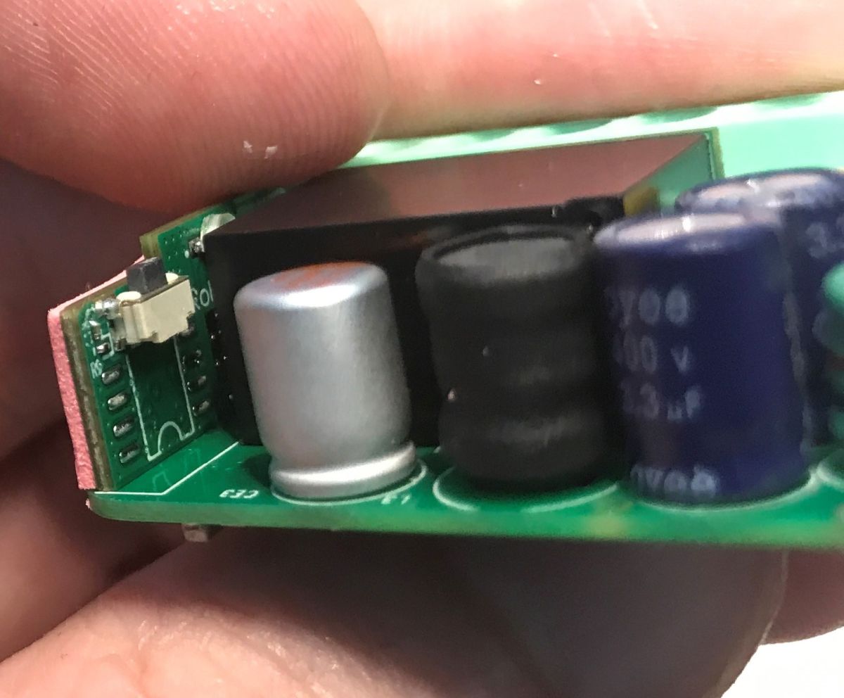

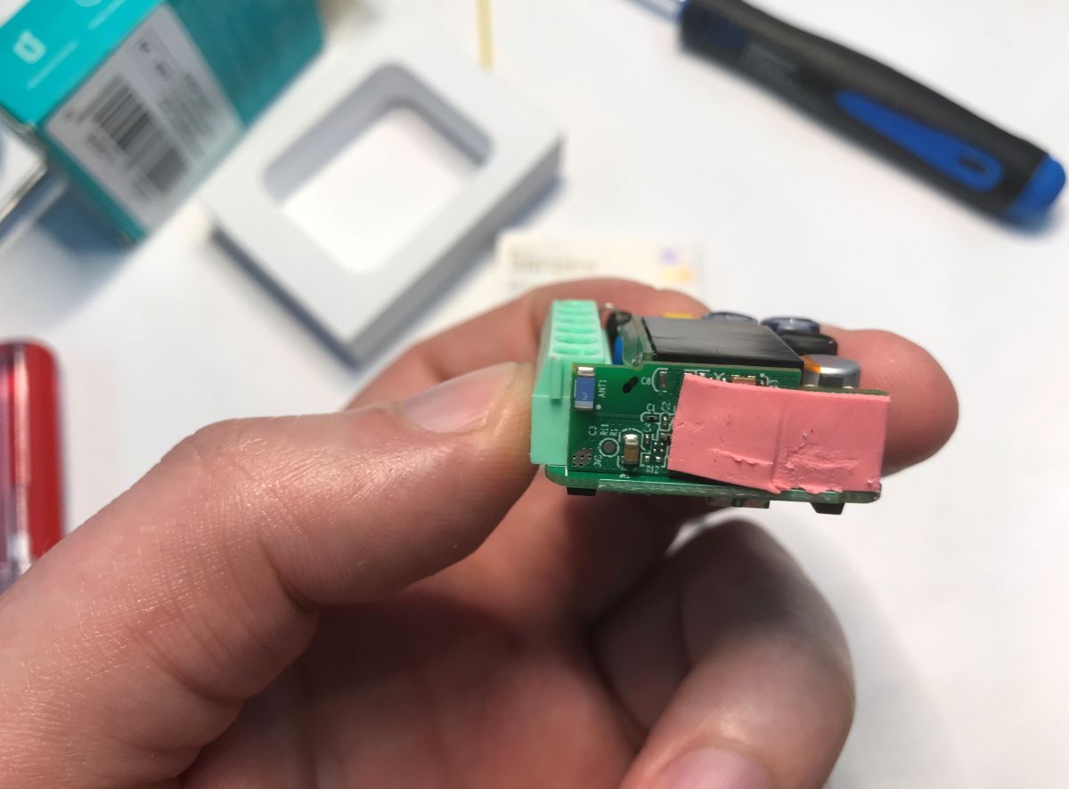

    Let's check the construction of the unit. We lift the lid. The first thing that catches your eye is the thermowell underneath which is the ESP32:
    Sonoff MINIR4M PCB with pink thermal pad on ESP32-C3 module

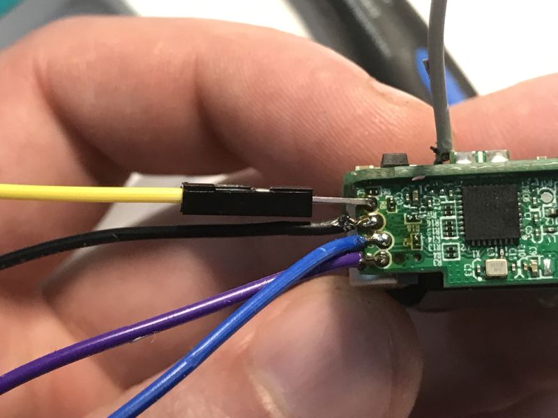

    ESP32-C3, which is the chip from Espressif, this time already with built-in Flash memory. On the board it is possible to identify the RX, TX and GPIO0, but will this give us anything?
    Close-up of Sonoff MINIR4M PCB with wires connected to RX, TX and GND pins
    I connected a USB to UART converter as a test:
    Sonoff Mini R4M module connected to USB-UART adapter and breadboard
    Boot log testifies to a locked flash:

    esptool is unable to read the batch from this chip, so the firmware cannot be changed. What's left is to replace the ESP32 with another one, and that already requires soldering really small components.
    All that's left is to look at the rest of the PCB, for educational purposes only.

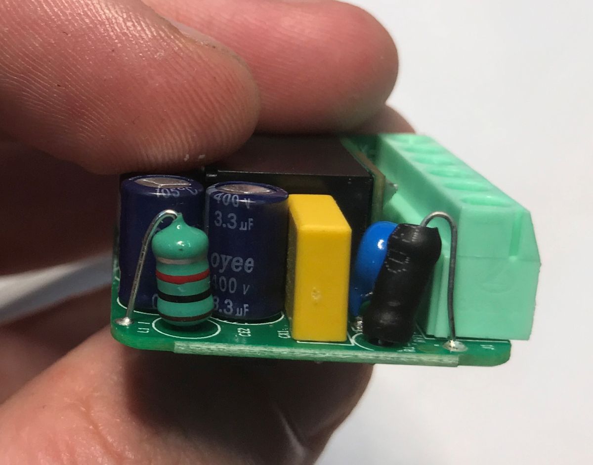

    Close-up of electronics inside Sonoff relay, visible capacitors and resistor Close-up of Sonoff MINIR4M relay internals showing capacitors and PCB components Close-up view of Sonoff MiniR4M relay internal components, including capacitors and inductor
    Inside a transformerless inverter, varistor, capacitor against interference, fuse.... Sonoff has not regretted it.

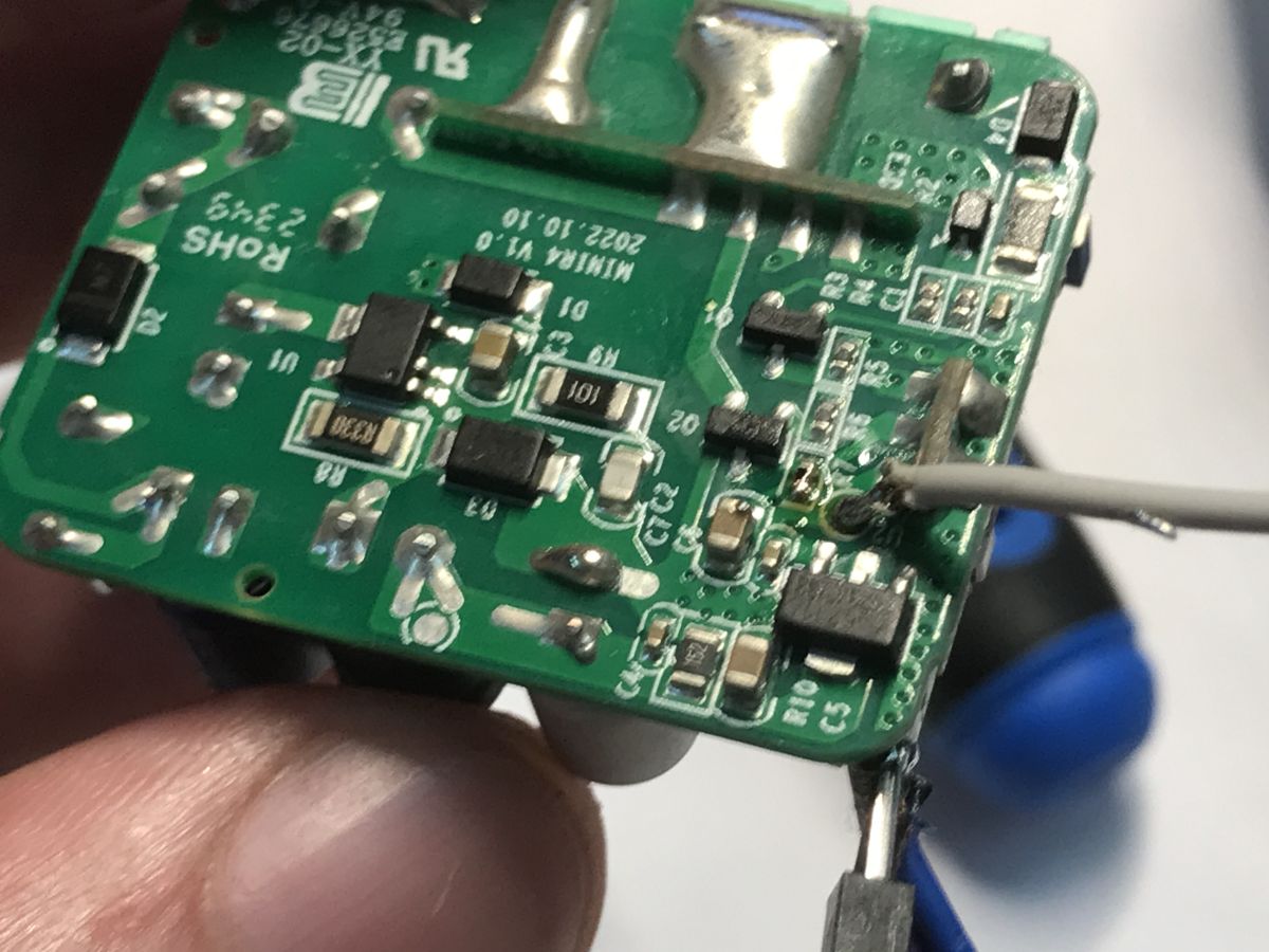

    The circuit is powered by a typical BP2525 + LDO 3.3 V combination.
    Close-up of Sonoff Mini R4 PCB with a test probe wire connected
    PCB designation: MINIR4 V1.0 2022.01.01 It's been four years....
