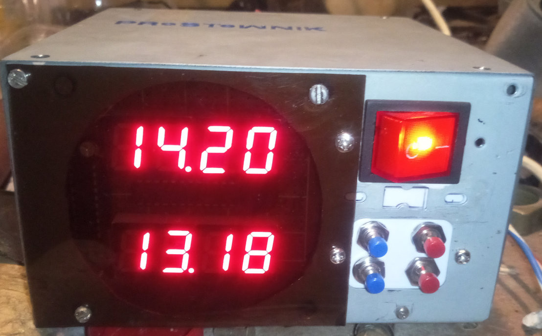

Front panel of rectifier with dual LED displays, four buttons, and main red power switch
I have made myself a transformer rectifier to charge my car battery, with automatic charge control - on an on/off basis - so that charging can be left unattended for long periods. The circuit has two basic tasks:
- enable charging when the battery is connected
- switch off charging when the battery is charged or in an error situation
The garage aesthetics of the unit are provided by the casing after the ATX power supply.
However, I took care to at least divide the front and rear panels.
The side that was visible from the back of the computer is now the front panel. There is a red seven-segment LED display (2 rows of 4 digits with decimal points), a big red main switch and 4 momentary buttons - 2 blue on the left (closer to the display) and 2 red on the right.
There is a fuse socket on the back, a positive and negative terminal, and a power cable sticking out.
Rectifier in ATX case with LED display and red main switch Rear panel of DIY charger in ATX case with fuse and banana plug sockets Front panel of battery charger with dual LED displays and control buttons

4. Maximum voltage
5. Minimum current
6. Maximum current
... which is the same as what can be shown on the display; only it's hexadecimal, the time is in deciminutes, the voltage in centivolts and the current in milliamps.
From this data you can draw yourself a graph:
Line graph: Vmin and Vmax rise and level off, while Imax drops to about 6 A over time.
Commands accepted by Bluetooth
v Enables/disables talk mode
c Requests a block of configuration data.
In response, the loader sends a string of 23 hexadecimal bytes, e.g.:
F843080541258000C81F4016A803E8052805B405A0058C
and these are one by one:
- flag byte
- a byte selecting what to show on the upper and lower display
- a byte with the brightness of the display (LEd)
- a word with the current measurement calibration factor (rCAL)
- 9 more words: T0, I0, I1, I2, U0, U1, U3, U4, U5
sNABCD Changes the value of configuration word number N to ABCD:
- N is the word index from 0 to 9 (0 is the current measurement calibration factor)
- ABCD is the new value given in hexadecimal capitals
e Writes a block of configuration data to the EEPROM
The response to an unrecognised command is an exclamation mark.
Firmware
I guess it was only by using 8051 (CISC) and an assembler that I managed to stuff all the firmware into a 2 KiB ROM.
In version two, I added support for additional commands over Bluetooth (i.e. beyond v ):
nuvoton...hex (5.77 kB)You must be logged in to download this attachment.
I leave the first (old) version if necessary:
nuvoto..hex (5.51 kB)You must be logged in to download this attachment.
Filmish
Charging a charged battery:
Charging a dead battery
Charging a dead battery in auto-recharge mode (which is why this option is the only one disabled by default):
