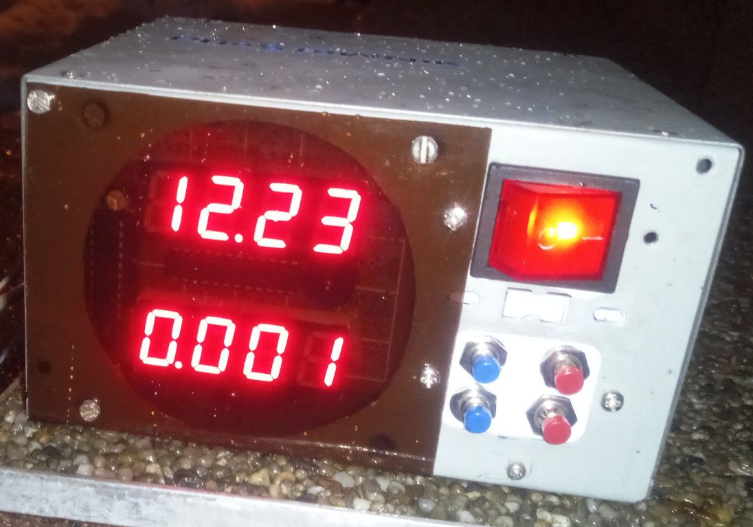

  • Front panel of rectifier with dual LED displays, four buttons, and main red power switch

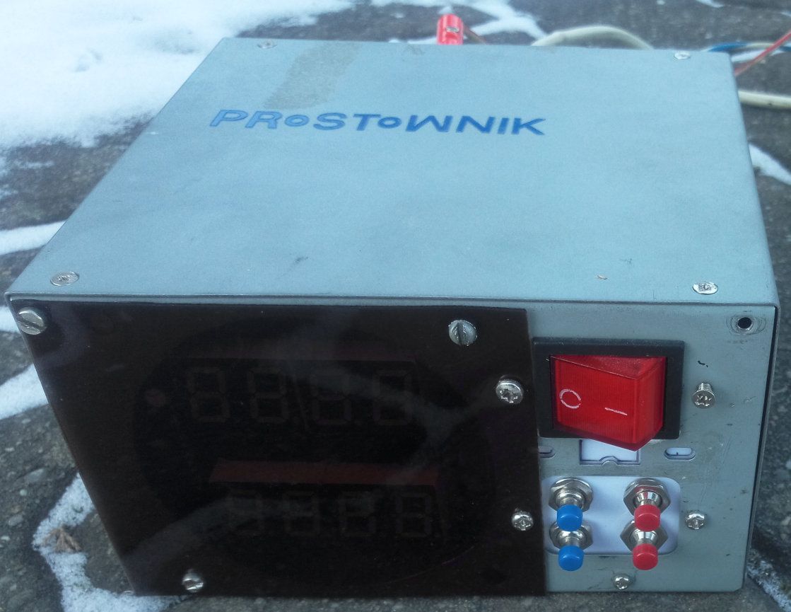

    I have made myself a transformer rectifier to charge my car battery, with automatic charge control - on an on/off basis - so that charging can be left unattended for long periods. The circuit has two basic tasks:
    - enable charging when the battery is connected
    - switch off charging when the battery is charged or in an error situation

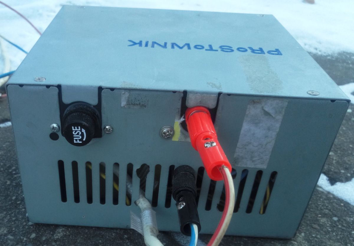

    The garage aesthetics of the unit are provided by the casing after the ATX power supply.
    However, I took care to at least divide the front and rear panels.
    The side that was visible from the back of the computer is now the front panel. There is a red seven-segment LED display (2 rows of 4 digits with decimal points), a big red main switch and 4 momentary buttons - 2 blue on the left (closer to the display) and 2 red on the right.
    There is a fuse socket on the back, a positive and negative terminal, and a power cable sticking out.
    Rectifier in ATX case with LED display and red main switch Rear panel of DIY charger in ATX case with fuse and banana plug sockets Front panel of battery charger with dual LED displays and control buttons

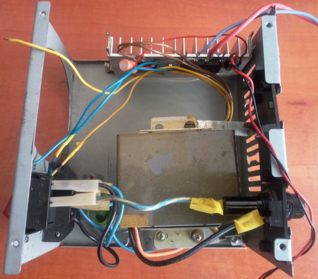

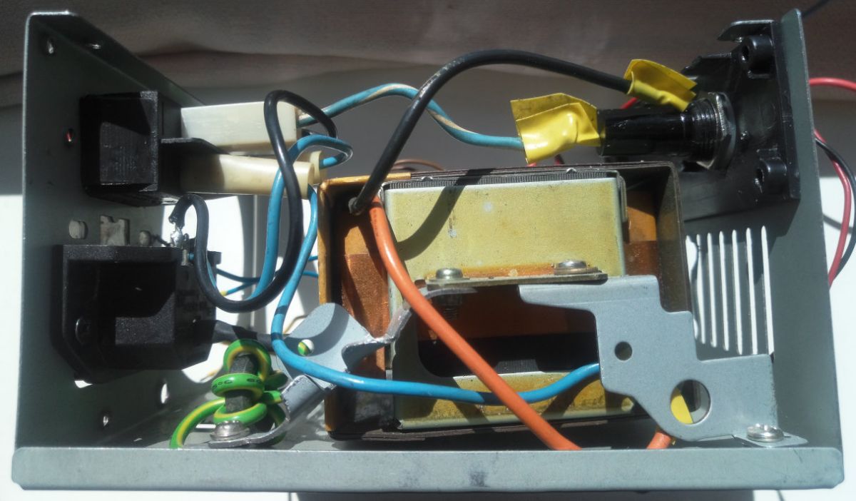

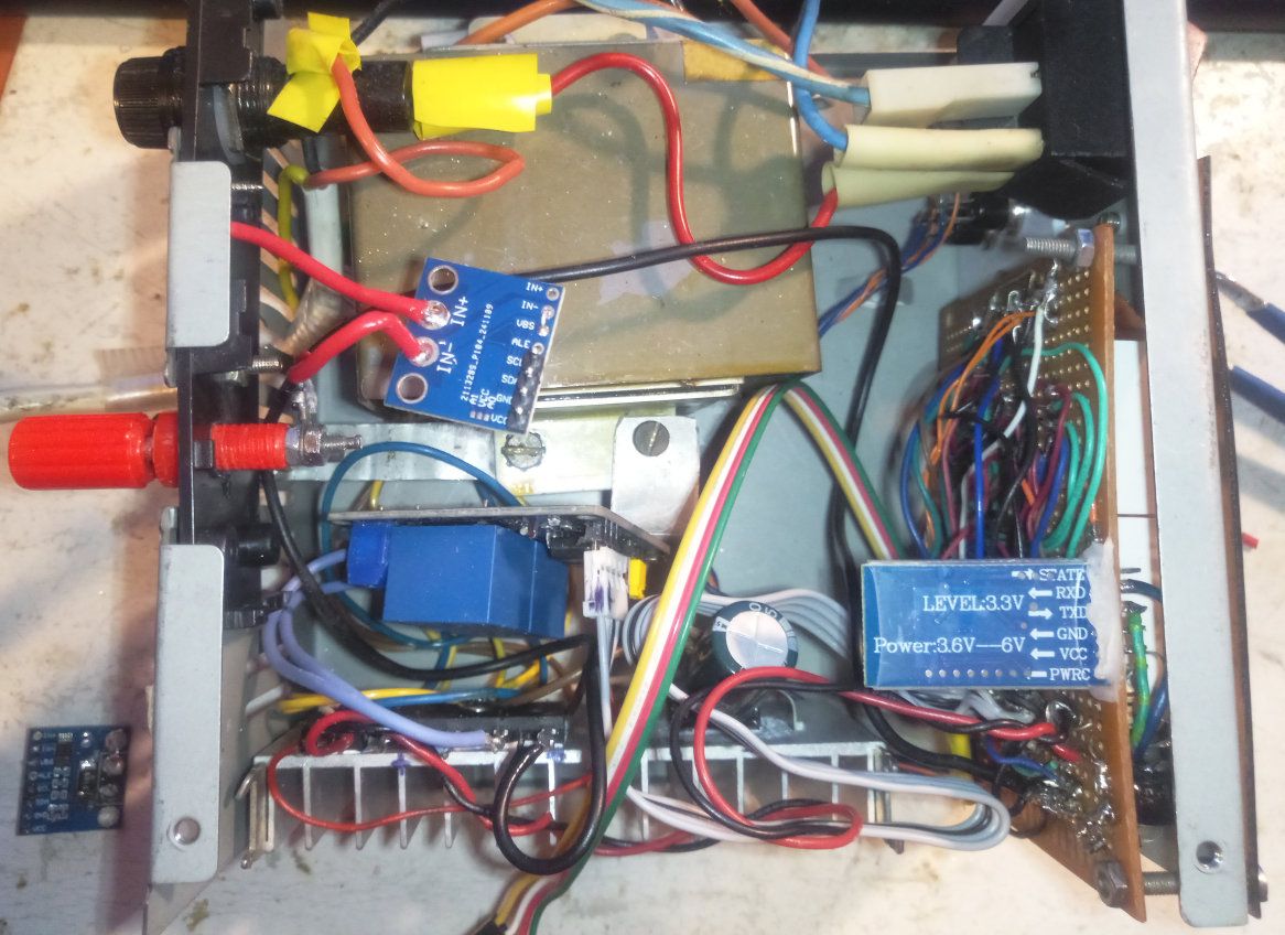

    Internal construction
    The transformer is from a very old TV-SAT receiver, has about 40 W and has 3 secondary windings with the following AC voltages (at ~240 V on the primary):
    2 blue
    Wire colour Voltage Application
    Application
    brown 7,95 V Control electronics supply
    yellow 15,39 V the convolution referred to below the first
    blue 22 V the convolution called below the second

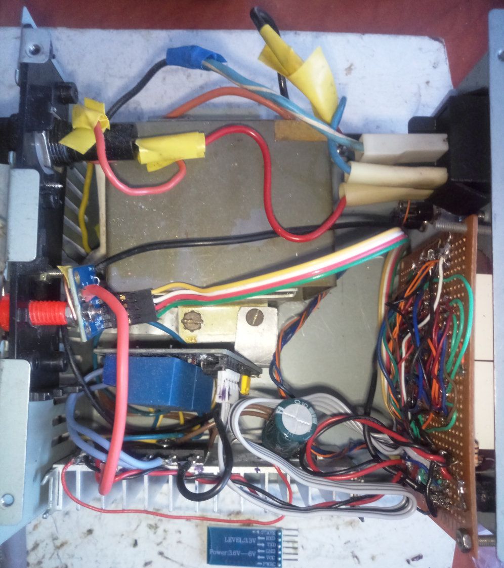

    Inside view of a transformer battery charger in an ATX power supply case.
    The electronics are powered by a separate small rectifier bridge and 7805 .
    One of the other two windings is connected via relays to this second (larger) bridge, from which the rectified voltage exits via a shunt to the banana sockets on the rear.
    Both bridges and 7805 are mounted on a heat sink.

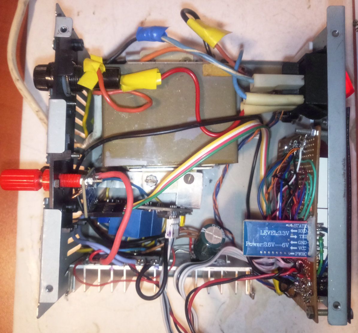

    Interior of a transformer-based charger inside an ATX power supply case

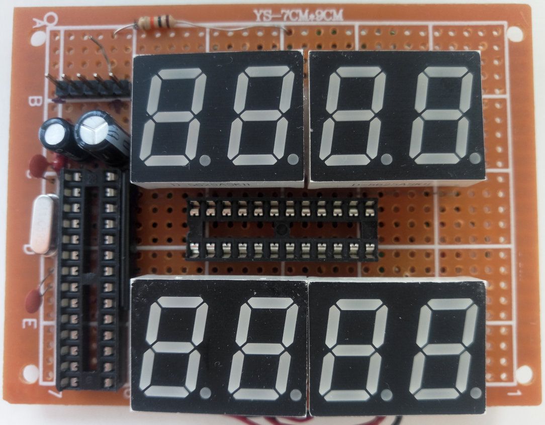

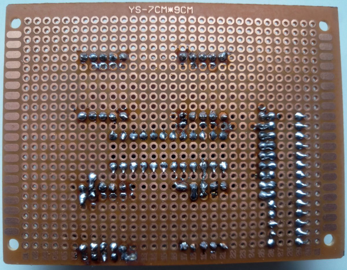

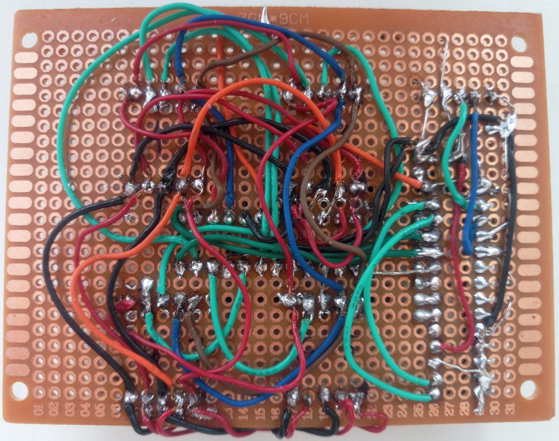

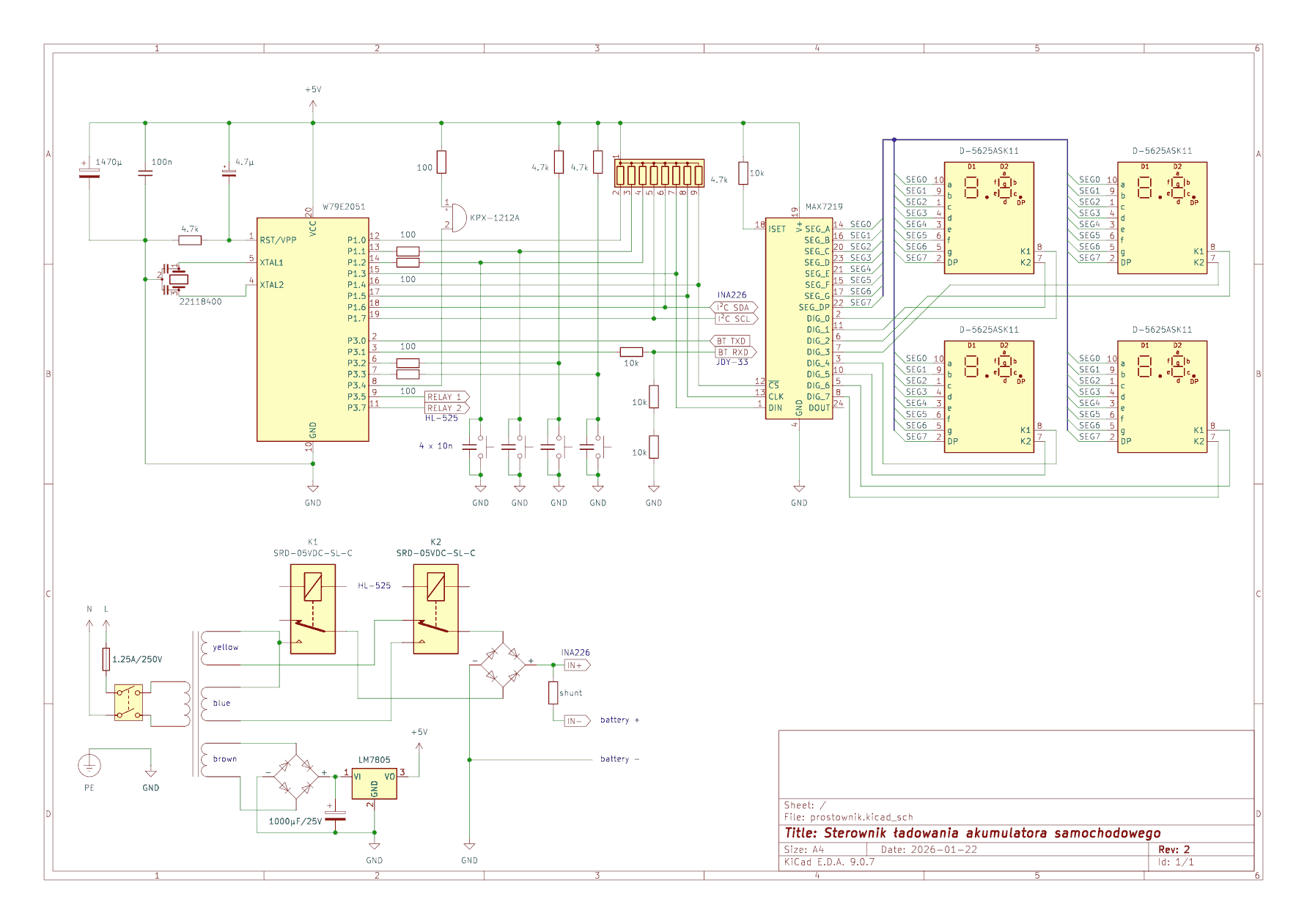

    The main board is a 7x9 cm universal board. It already receives stabilised 5 V.
    There is a socket for Atmel on the board AT89C2051 and EEPROM AT24C02 , but I replaced them with a clone: Nuvoton W79E2051 . Compared to the original, it has built-in non-volatile memory , watchdog a and brown-out reset , well it is 2x faster in this application.
    Also: 4 double-digit displays D-5625ASK11 , which light up quite nicely, operated by MAX7219 ; and a squeaker.
    Prototype board with six 7-segment LED displays and DIP sockets Universal 7x9 cm PCB with soldered connections on bottom side Universal PCB with four 7-segment LED displays and DIP sockets. Perfboard with hand-soldered wires in various colors Electronic board with LED display showing “HELP.” and “HEHE”

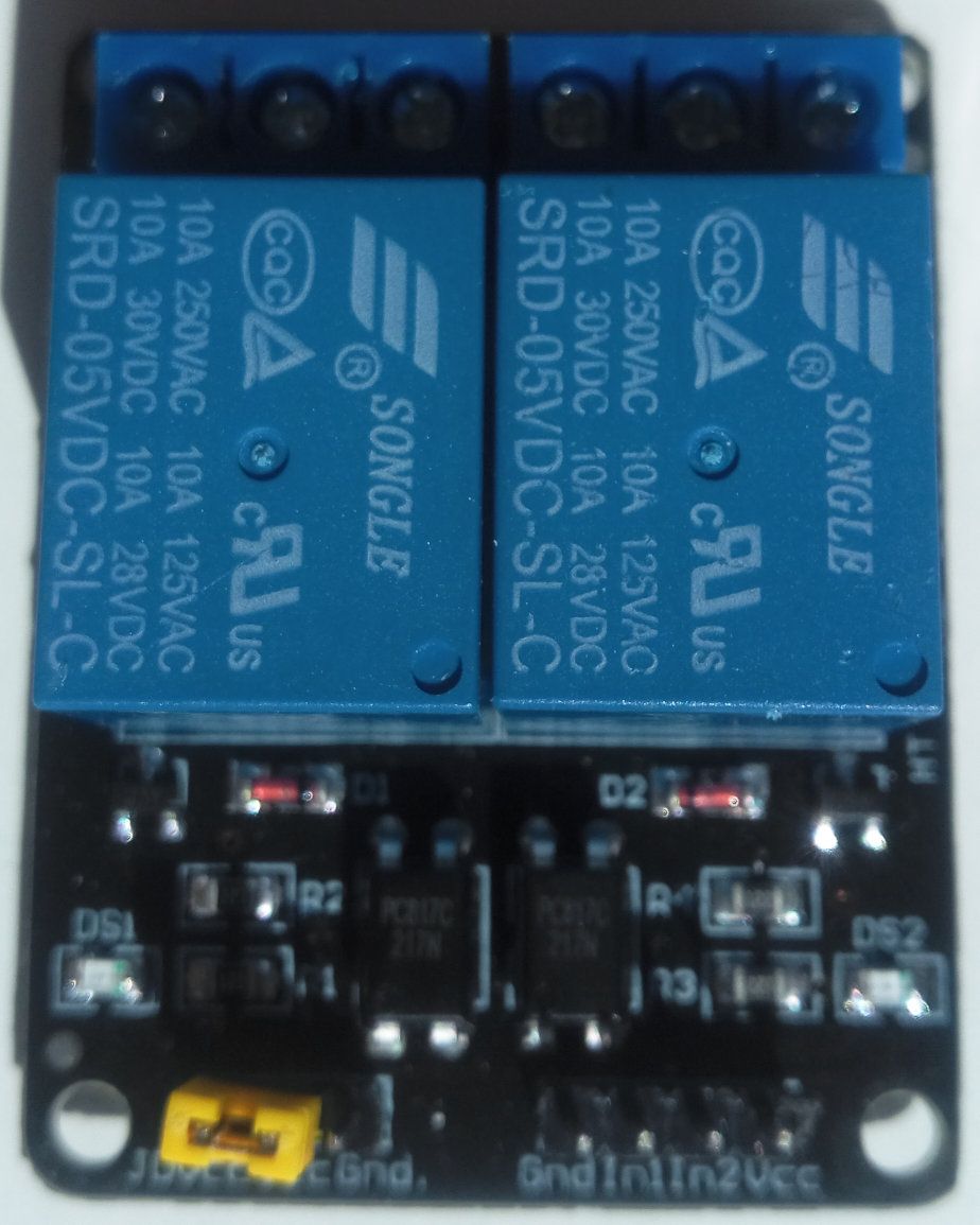

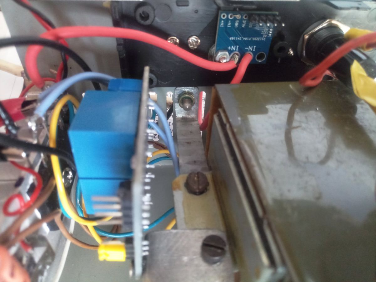

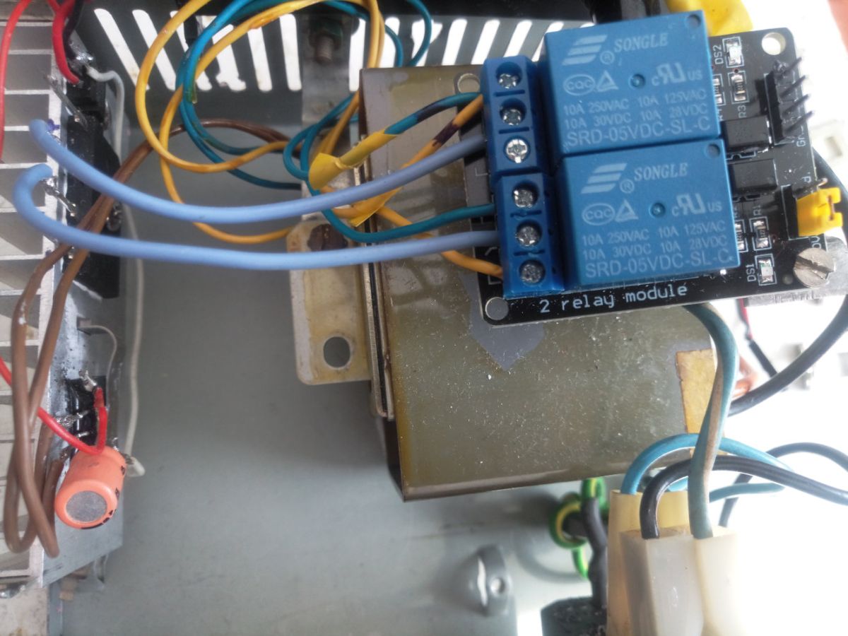

    The following peripheral modules from Aliexpress are connected to the board:
    - 2 5 V SRD-05VDC-SL-C relay module with optoisolation HL-525 - one closes the circuit and the other switches the windings

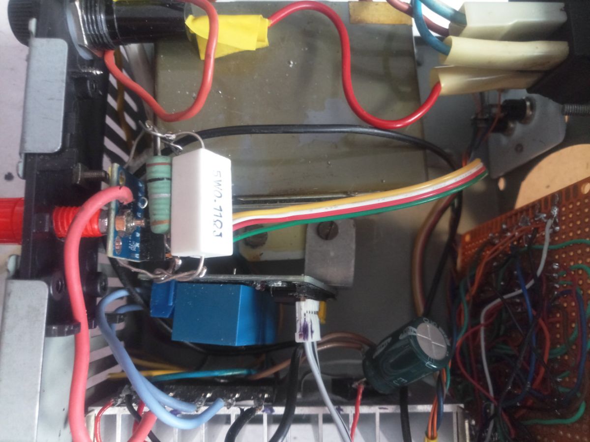

    - via I²C: module INA226 for voltage and current measurement, with wire soldered in parallel to a 0.1 Ω shunt
    - via UART: bluetooth module SPP JDY-33 - together with the rest enclosed in a metal box and maybe because of that it has a range similar to the display through the window
    In the module INA226 I short-circuit the VBS with IN-, i.e. the voltage is measured between the plus and minus terminals, without a shunt.
    The module has a built-in 0.1 Ω shunt to measure currents up to 0.8 A. To extend this range, I soldered a piece of wire in parallel. I don't know what resistance it has, but after calibrating with an H4 bulb (current about 4 A), with a calibration register value of 1345 the result in mA agrees with the meter on the 10 A range. I had previously tried with some 0.1 Ω resistors, but the range was then exceeded.
    5 V dual relay module SRD-05VDC-SL-C with opto-isolation SRD-05VDC-SL-C relay module mounted above a transformer with connected wires View of rectifier interior with relay, transformer, and INA226 module Internal view of transformer-based charger with electronics and wires Internal view of transformer-based charger with electronics and wires Interior of a rectifier showing wires, resistor, and transformer windings Inside of battery charger in ATX case with transformer and control circuitry Inside of a transformer rectifier with electronics modules and relays Close-up of INA226 module and wiring inside a custom battery charger case
    Schematic of a battery charger controller with W79E2051, MAX7219, INA226, relays, and rectifier bridges

    Algorithm
    INA226 operates in the fastest possible mode i.e. without any averaging, 140 µs per measurement.
    The processor reads the voltage and current for 100 ms in a tight loop and does the relaxation.
    At the end we have 4 values: U min , U max , I min , I max .
    I am counting on is that within 10 straightened halves of a sine wave it is possible to catch the extremes even without synchronisation with the zero crossing.
    W79E2051 manages to read data from INA226 400x within these 100 ms, a AT89C2051 - 200x.
    Then a state machine is flown which, based on the aforementioned 4 values and the charging time, changes the state and switches the relays.
    This is followed by converting the parameters to decimal numbers and sending to the display, and possibly sending data to the UART (and further via bluetooth if paired) - and the cycle of measurements repeats.
    Display
    The upper and lower displays one of 7 values independently selectable by the blue button next to the respective display:
    <br/span>
    0 State of automatic charge control as 2 spaces and 2 digits, or error code E-XX
    1 Charge time - in minutes, with one decimal digit
    2 Number of voltage and current samples read in 100 ms
    3 U min - in volts, with two decimal digits
    4 U max - in volts, with two decimal digits
    5 I min - in amperes, with three decimal digits
    6 I max - in amperes, with three digits after the decimal point
    [/table:3cc4fea521]
    When the button is pressed, a single digit with the index of the newly selected parameter appears on the display. It disappears when the button is released.
    If an error occurs, its code will be shown on the lower display instead of what the user requested. Unless, of course, he has enabled himself to show the status (index 0) on the upper display.

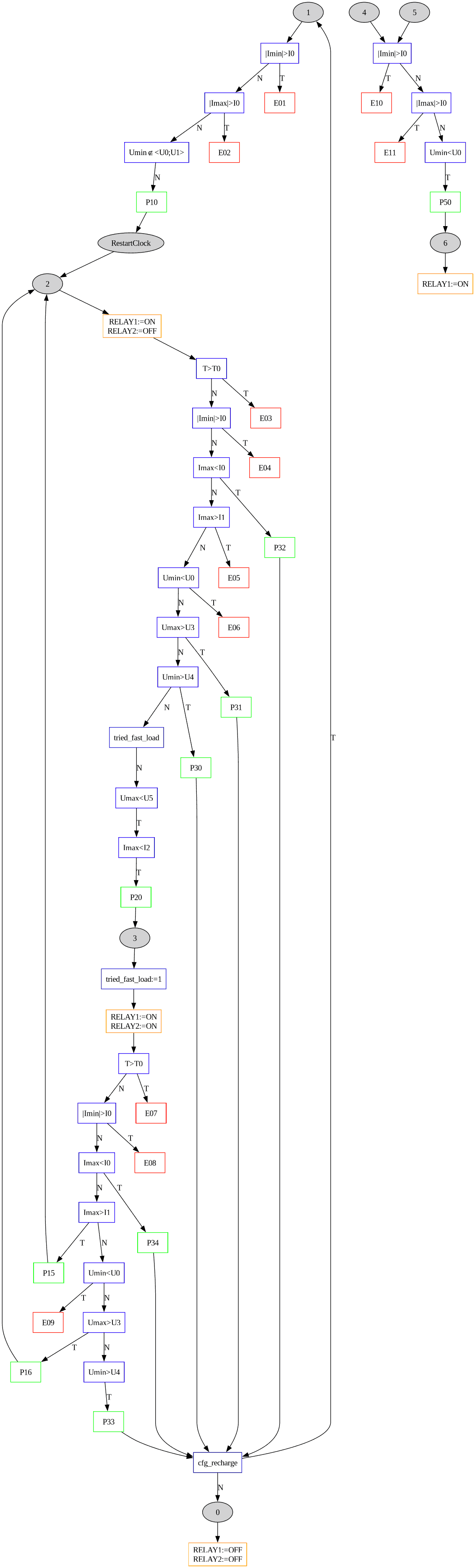

    Charging the battery with increased current
    2
    State Transmitters Description
    0 Off Uncharged. This is the state after switching on when the option AuOn =0.
    1 Off Waiting for conditions to start charging (assumed - connecting the battery).
    This is the state after switching on when the option AuOn =1.
    2 Included first winding Charging the battery with normal current
    3 Included second winding Charging the battery with increased current
    4 Off Waiting conditions to start calibrating current measurement with the second winding
    5 Excluded Waiting for conditions to start calibration of current measurement with first winding
    6 Included X winding Calibration, and X depends on whether we have moved from state 4 or state 5

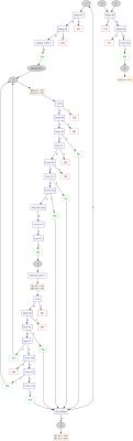

    Diagram of states
    State diagram of the battery charger automation controller
    maszyna s..ów.pdf (20.93 kB)You must be logged in to download this attachment.

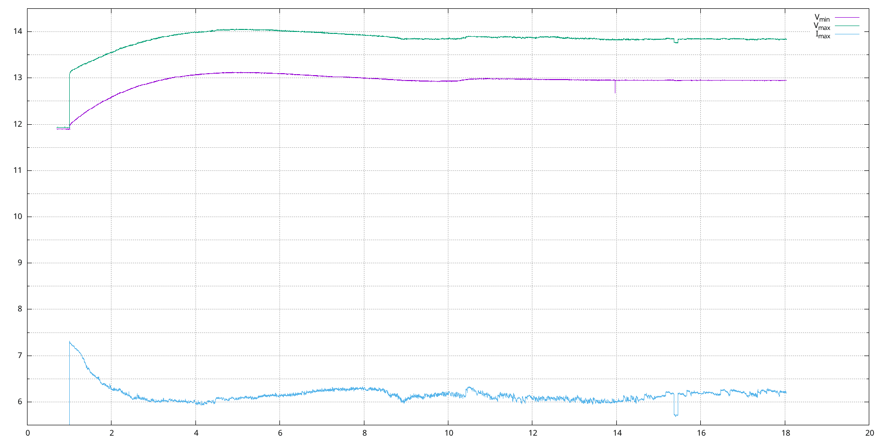

    Bluetooth 2
    The device itself sends lines of text via bluetooth with an error or pass code, such as:
    P-50 0015 0191 0000 0002 FFF8 0002
    P-50 0017 0192 0000 0001 FFFA 0002
    It is possible to send the letter v , which activates and deactivates the talk mode - that is, sending the above block of data after each measurement cycle (every 100 ms), in which case instead of an error/transition code - unless one or the other has occurred - there is only a two-digit status number, e.g.: 64d9678e3a :
    00 0035 0168 0000 0002 FFF8 0003
    00 0035 0167 0000 0001 FFF8 0002
    P-50 0035 0156 0000 0002 FFF8 0002
    06 0035 016A 0000 0000 FFFD FFFD
    06 0035 016B 0000 0000 FFFD FFFD
    06 0035 0170 0000 0297 FFFD 12D9
    06 0035 016A 0297 0297 12D9 12D9
    00 0035 0169 0000 058D FFE8 1951
    00 0035 0165 0000 0002 FFF8 0003
    00 0036 0162 0000 0001 FFF8 0003
    P-50 0036 0165 0000 0001 FFFA 0002
    06 0036 016F 0000 0000 0002 0002
    06 0036 0170 0000 0000 0002 0002
    06 0036 0167 0000 02D5 0002 1169
    06 0036 0165 02D5 02D5 1169 1169
    06 0036 016B 02D5 02D5 1169 1169
    00 0036 0169 0000 0555 FFFB 18C0
    00 0036 0169 0000 0001 FFF8 0002
    The status/error/transition code is given in decimal and the rest of the parameters in hexadecimal and these are, in turn:
    1. Charging (or non-charging, as the clock goes all the time) time
    2. Number of circulations of the tight loop of measurements in 100 ms (as you can see, with the transmitter on, it no longer makes 400x but about 360x)
    3. Minimum voltage
    4. Maximum voltage
    5. Minimum current
    6. Maximum current
    ... which is the same as what can be shown on the display; only it's hexadecimal, the time is in deciminutes, the voltage in centivolts and the current in milliamps.
    From this data you can draw yourself a graph:
    Line graph: Vmin and Vmax rise and level off, while Imax drops to about 6 A over time.

    Is that white cable cut through the vents the power supply? If so, it's a rather poor and dangerous solution. It's a shame that you knocked out the connector connecting the power supply. This is one of the more valuable parts of such a power supply during rework.

    I don't know, maybe it's already the fault of my eyesight, but in the article I don't see the most important thing - a diagram of the rectifier, at least some block diagram. There is only the controller.
    Besides, is it still worth carving something like this in this day and age? Apart from the priceless satisfaction.... The Lidl charger I bought a couple of years ago for about five quid (maybe a bit more expensive now, inflation) has a backup charging function.... Fact, I've never used it because I don't have a garage, but according to the intructions: "(...)the device has an automatic back-up charging function. The battery can be left connected to the charger for an extended period of time."

    Anyway since the device has been made, the article published, I reiterate the question for a complete schematic.

    The idea of a battery charging device is interesting but the execution itself is disastrous.

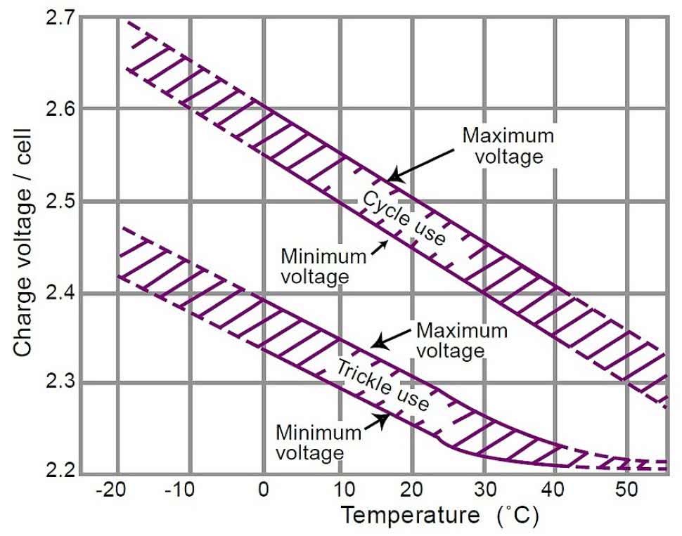

    The standby voltage compensation is "almost" linear 3mW per cell, i.e. 18mV for a lead battery with 6 cells. At an output voltage of 13.6/20°C, that already gives 13.9V at zero degrees.... , then I guess the curve flattens out to -10 and only then flies +18mV....
    I've dug out the supposedly VARTA table, at first glance it is correct :)
    Chart of charge voltage per cell vs temperature, showing ranges for cycle use and trickle use

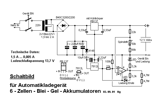

    >>21813971 there is also such an analogue PB137 I don't know if that wouldn't be the simplest solution

    Is that white cable cut through the vents the power supply? If so, it's a rather poor and dangerous solution. It's a shame you blew out the connector connecting the power supply.
    Ow. Maybe some cable bending will still save the situation. I knocked the connector out so the cable wouldn't come out of the front panel. I could have done the front panel on the opposite side, but it was easier to cut out the fan cover and sand the 4 stumps. And once I did that, the handle fell into place.

    I don't know, maybe it's my eyesight's fault already, but in the article I don't see the most important thing - a schematic of the rectifier, at least some block diagram. There is only the controller.
    Besides, is it still worth carving something like that in this day and age?
    This doesn't encourage you to "carve" a piece of schematic yet :) There is a simple integrated bridge screwed to a heatsink with thermally conductive paste.

    Are you somehow regulating the current here? Is the device by design only to pump the rest into the battery/desulphurise it? Because if you connected this charger to a discharged battery (e.g. 10V) it wouldn't be able to charge it, would it? You'd need a current limiter even for that 800mA (even on a simple LM317), you'd have to use a higher transformer voltage but you could charge almost anything with it, even from 0V.
    No, I don't regulate the current. The control circuit turns off the relays when either the voltage or the current is exceeded. You could possibly raise the peak limit to 9.999 A. If it turns out that a discharged battery draws more current and the transformer can deliver it, the circuit would immediately enter an error state and the transformer would have to be changed.
    This is just a circuit to protect against overcharging (and short-circuiting altogether too, but with a response time of 100 ms). It allows you to use a transformer that, when rectified, gives too much voltage without load. I've had a pretty primitive rectifier made on it before, and it had to be watched.
    Andrzej_Tomaszewski wrote:
    The idea of a battery charging device is interesting but the workmanship is already awful.
    I was a little afraid that some people would suffer looking at it, but it is a sacrifice I am prepared to make :)
    Actually, this is the first working prototype. Now the right way to assemble all the parts could be worked out, maybe even the board could be developed. But for me it was just making the physical and electronic platform, which unfortunately has to be done to be able to develop and run the program. I broke one INA226 module by screwing it into the IN- rear end of the positive terminal, because that's how clever I wanted to be, but it turned out that there was so little metal there that the contact became insecure and the current measurement went crazy. I've already put the next module on the wires, but it's guerrilla-fixed with one screw. It's hard, it sticks, it works, nothing flies there.
    Stanley_P wrote:
    I don't think it's suitable for outdoor use?
    And I've already used it outdoors in the drizzle and for half an hour nothing happened ;)

    >>21813971 there is also such an analogue PB137 I do not know if this would not be the simplest solution
    And it is - and it's cheap.
    The application is very simple - probably ideal for this purpose.
    13.7V 1.5A I think will do the job - the battery will be able to take a charge and there will be a current in the region of 0.15A after a few hours.
    Max Vin 40V, so there is no fear that something will not work.
    There is even an application:
    Schematic of automatic 12V battery charger with 13.7V charging voltage

    However, the automatic temperature compensation seems overrated to me. This is supposed to be a charger for recharging a car battery - without disconnecting it. So boosting the voltage could end badly.
    I'd rather expand the Bluetooth interface with override options and remotely "compensate" myself from a smartphone :)
  • #30 21816043
    sq3evp
    Posts: 6695
    Help: 226
    Rate: 900
    Sam Sung wrote:
    I'd rather expand the Bluetooth interface to include override options and remotely "compensate" myself from a smartphone :)
    This is also a method - I was thinking more of using a PB137 and in series a diode (I mean on the GND leg as a reference voltage - depends if you want 0.3 or 0.7 boost) with a switch (can also be a simple jumper) to select the voltage: 13.7V or boosted to 14.0V or 14.4V.
