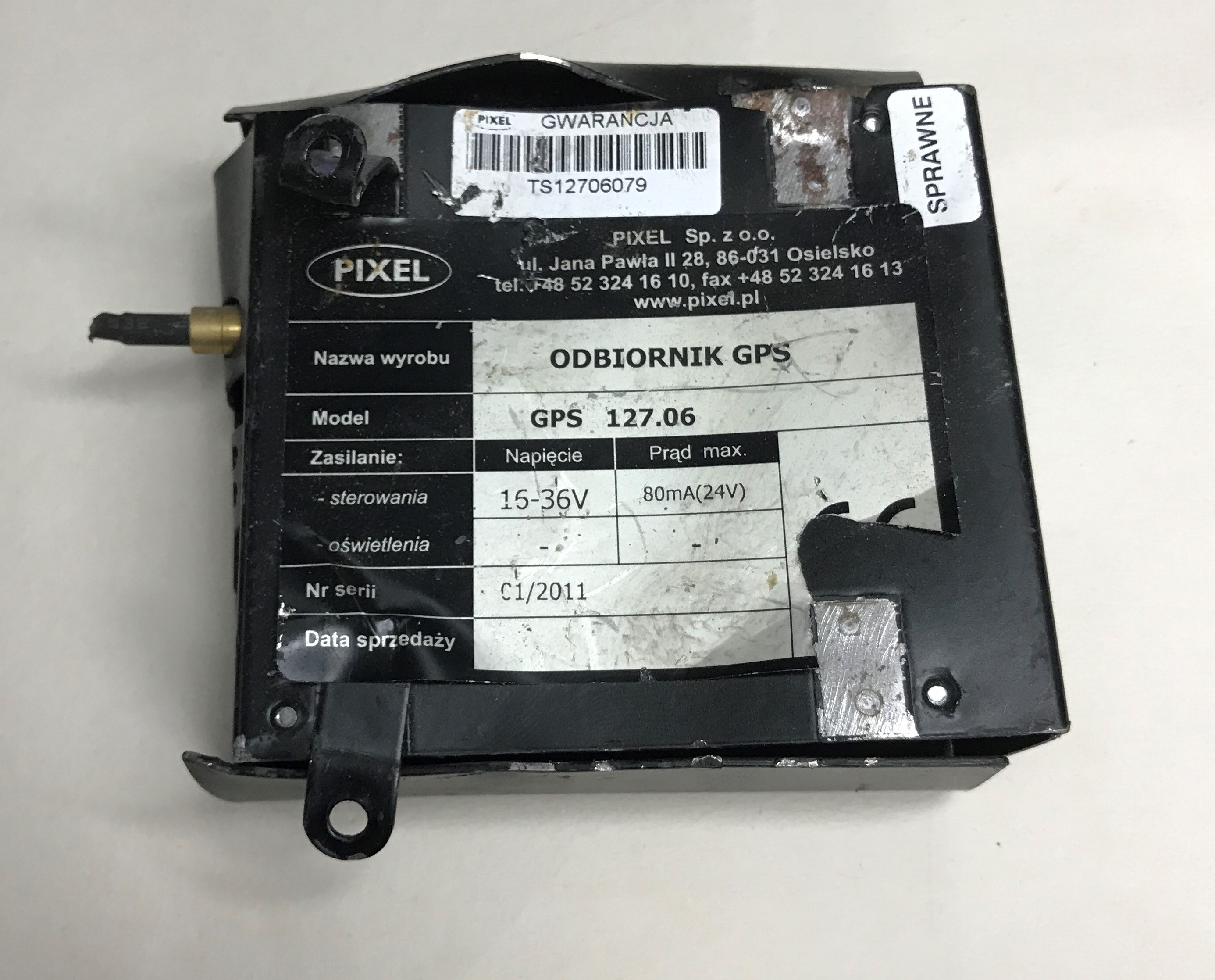

Crushed black PIXEL GPS receiver housing with “ODBIORNIK GPS” label and a side antenna connector.
I got a bit of 'railway' equipment after liquidation, the whole thing rather qualifies as scrap, but you can still take a look inside and satisfy your curiosity. The case is all the more interesting as the item presented here appears to be our domestic product.
Black metal PIXEL GPS receiver case labeled RS422, NMEA and Active Antenna, with LED legend on top.
The module shown here is unlikely to count as retro electronics, dating from 2011, but it is still worth examining. On the side of the case it has an RS422 port (i.e. a variant of RS232), an NMEA (GPS message standard) and an antenna connector. I don't see a power port - my bet is that it's in the plug from RS422.
Crushed black module housing with two connectors, four LEDs, and a gold antenna jack, held in a hand
Let's take a look inside.
