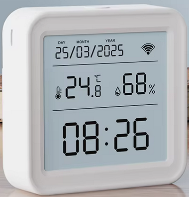

White clock with LCD showing date, time, temperature, and humidity
Hello :)
I recently bought some Tuya modules to play with, with a view to playing with OpenBK.
Among them the TH08(??? E ???) and TH08C modules mentioned in the title. The TH08C version has the ability to switch with a button (the number of clicks of the button that normally turns on the backlight) the 12h/24h time format and the temperature units i.e. C and F.
Both versions are based on the module T1-U-HL (BK7238)
PCB appearance of the TH08E version (as to this E I am not sure but this is how it was described on Aliexpress):
Close-up of TH08E PCB with T1-U-HL module and labeled signal paths
PCB described as "TH08-CBU-BL55072A_V3.8 2025-09-18"
PCB appearance of the TH08C version (this is how it is described in the user manual):
TH08C PCB with T1-U-HL module and label TH08_T1-U_V1.2 2025-10-13
PCB described as "TH08-T1-U_V1.2 2025-10-13"
In principle, both temperature/humidity sensors are similar in design to the TH08 module with BK7231N already described here:
[BK7231N ] Interior of TH08 LCD Calendar/clock/temperature/humidity
At the moment I have uploaded the OpenBK software to the TH08E version (TH08C I have not yet touched and will probably post information about the protocol later). Ot the log data is quite a lot and I don't want to make a fuss with two versions at the moment. As soon as I manage to do something with TH08E I will take up TH08C and see how the communication is with this version....
So for the moment I am focusing on TH08E i.e. PCB "TH08-CBU-BL55072A_V3.8 2025-09-18"
Unfortunately, the communication with the TuyaMCU looks a bit different than in the TH08 module described on the forum (BK7231N) - so for the moment it was not possible to move it.
It is apparent that several packages are missing e.g. 55 AA 00 90 and in the documentation (Tuya Developer) Serial Port Protocol at least I could not find information about package 90....
Edited Post added after time: ok regarding package 90 I found is this Get cached DP command (0x90) - description here: Basic Features MCU Standard Protocol
All in all, I've only been playing with OpenBK for a day (managed to rewire the PIR detectors) and I may be mixing things up. I've actually looked at the OpenBK code but I don't yet understand how it works enough to make any modifications myself.
Maybe colleague @pkaczmarek2 can advise and help here :) Below what I managed to log regarding TH08E module communication....
In firmware configured WiFi/MQTT/NTP (this works) and set flags 10, 37, 43 to this disconnected line CEN - here basically behavioural problems with bad communication similar to the TH08 described in the forum....
Effect:
The TuyaMCU tries to commune with the T1-U-HL (BK7238) and after a period of time shuts down its power supply. The date and time on the display is not updated....
