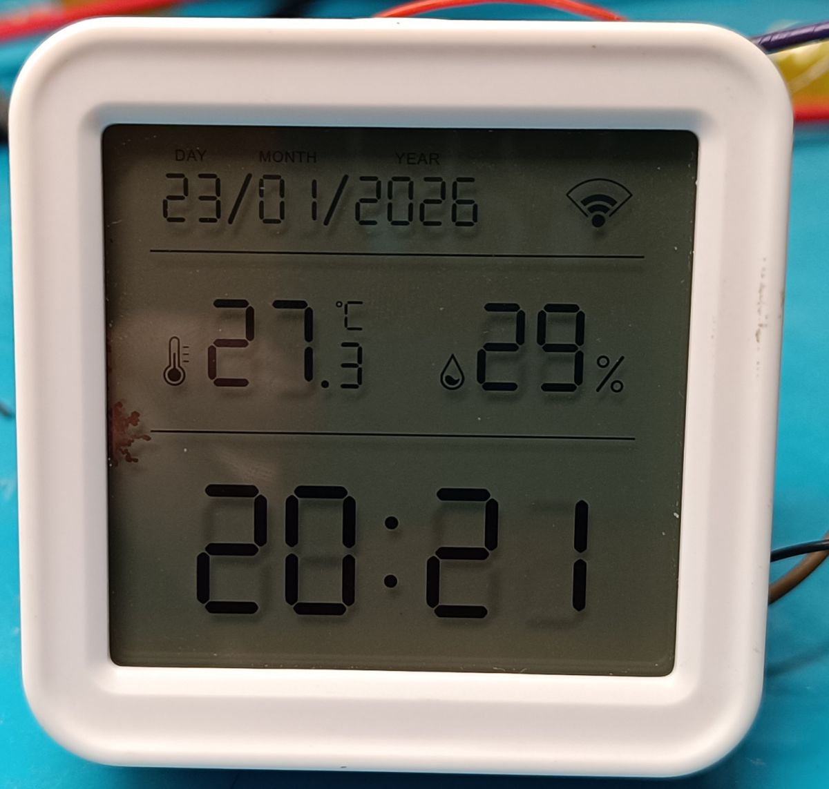

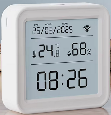

[BK7238 / T1] TH08E and TH08C LCD Calendar/clock/temperature/humidity
tplewa 2616 19
  • White clock with LCD showing date, time, temperature, and humidity
    Hello :)
    I recently bought some Tuya modules to play with, with a view to playing with OpenBK.
    Among them the TH08(??? E ???) and TH08C modules mentioned in the title. The TH08C version has the ability to switch with a button (the number of clicks of the button that normally turns on the backlight) the 12h/24h time format and the temperature units i.e. C and F.

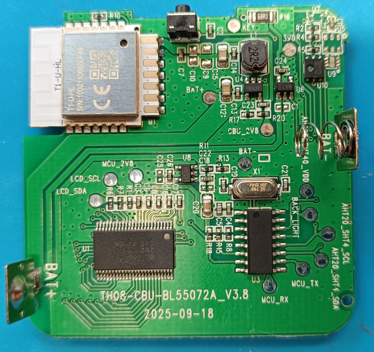

    PCB appearance of the TH08E version (as to this E I am not sure but this is how it was described on Aliexpress):
    Close-up of TH08E PCB with T1-U-HL module and labeled signal paths
    PCB described as "TH08-CBU-BL55072A_V3.8 2025-09-18"

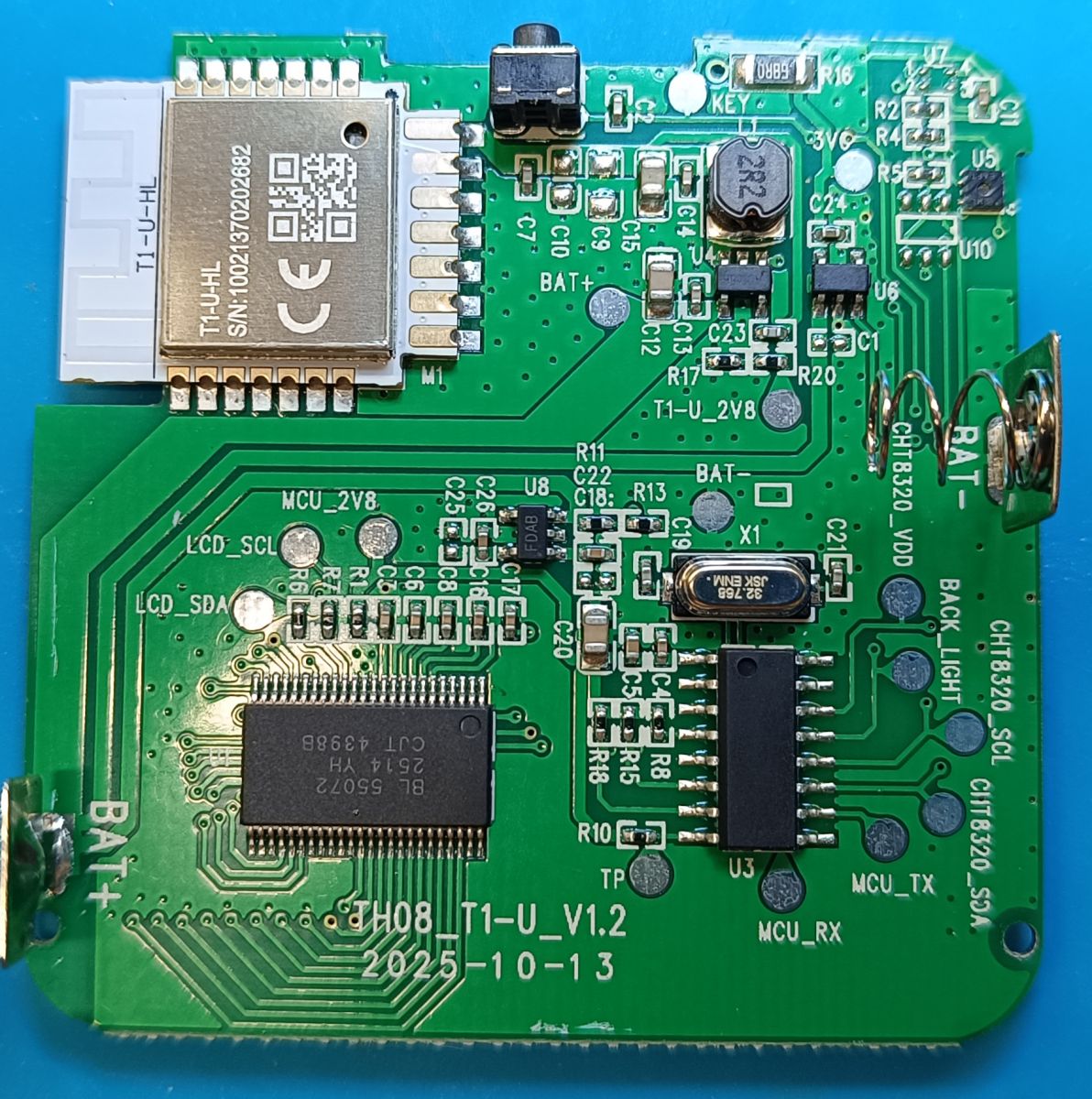

    PCB appearance of the TH08C version (this is how it is described in the user manual):
    TH08C PCB with T1-U-HL module and label TH08_T1-U_V1.2 2025-10-13
    PCB described as "TH08-T1-U_V1.2 2025-10-13"

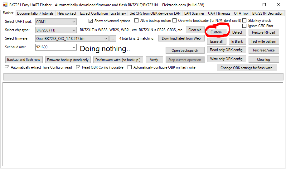

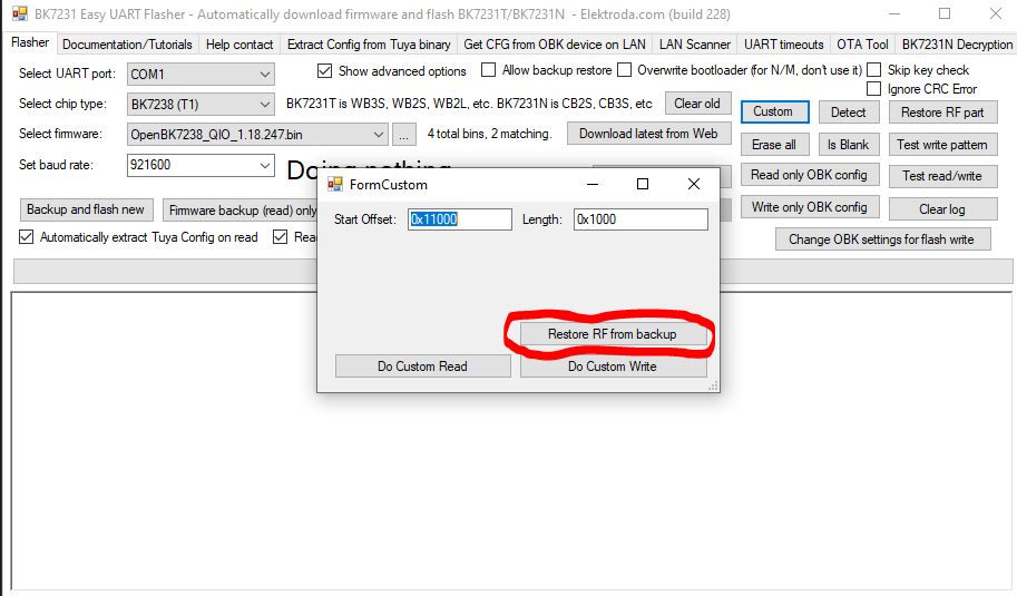

    At the moment I have uploaded the OpenBK software to the TH08E version (TH08C I have not yet touched and will probably post information about the protocol later). Ot the log data is quite a lot and I don't want to make a fuss with two versions at the moment. As soon as I manage to do something with TH08E I will take up TH08C and see how the communication is with this version....
    So for the moment I am focusing on TH08E i.e. PCB "TH08-CBU-BL55072A_V3.8 2025-09-18"

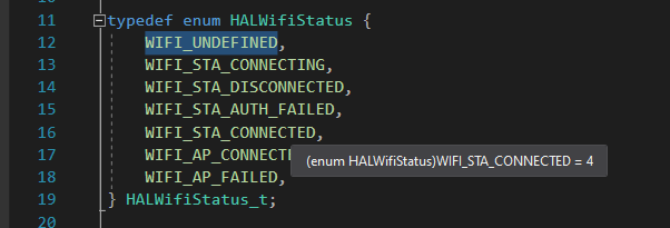

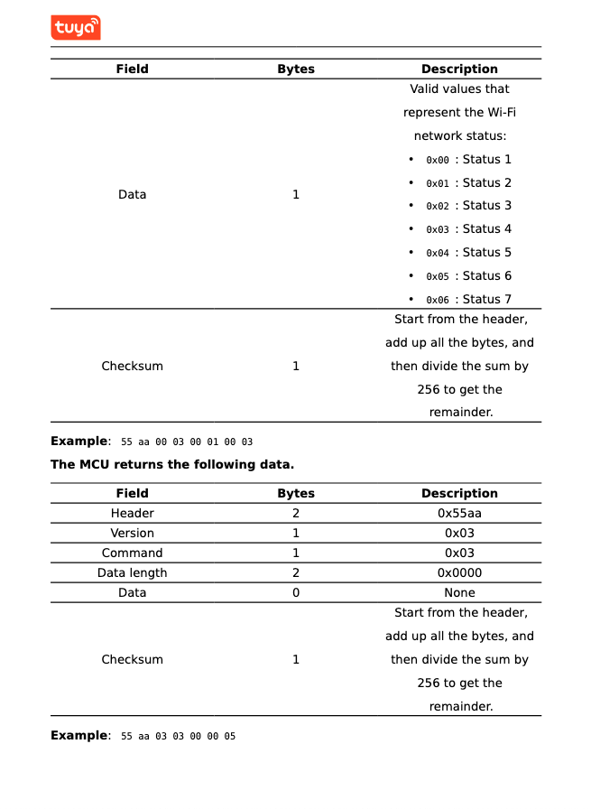

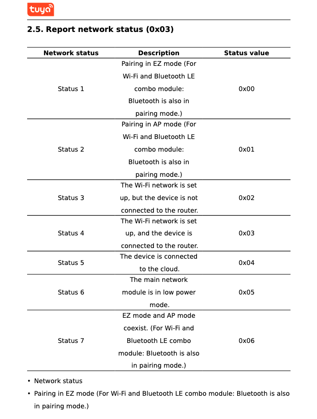

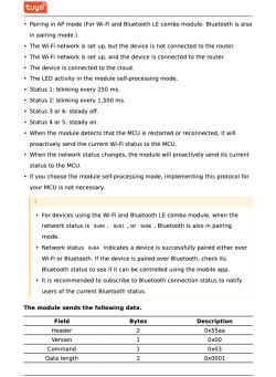

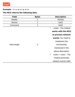

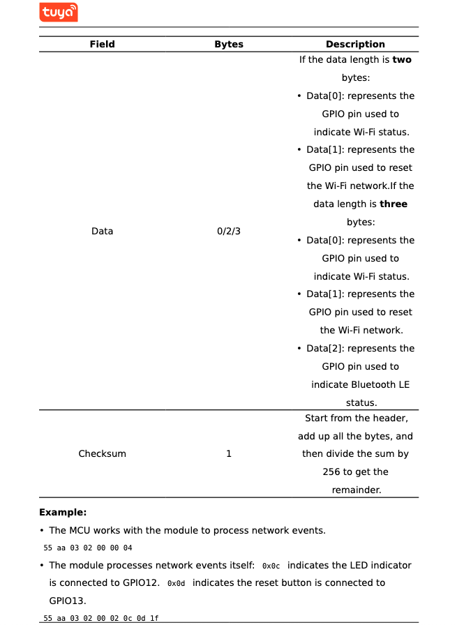

    Unfortunately, the communication with the TuyaMCU looks a bit different than in the TH08 module described on the forum (BK7231N) - so for the moment it was not possible to move it.
    It is apparent that several packages are missing e.g. 55 AA 00 90 and in the documentation (Tuya Developer) Serial Port Protocol at least I could not find information about package 90....
    Edited Post added after time: ok regarding package 90 I found is this Get cached DP command (0x90) - description here: Basic Features MCU Standard Protocol

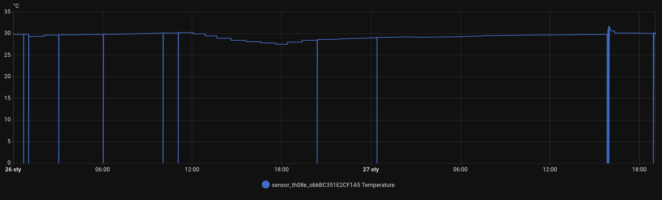

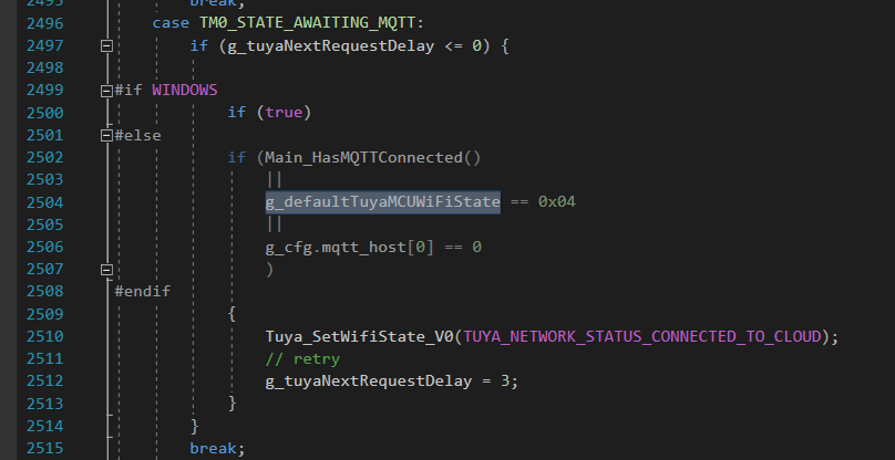

    All in all, I've only been playing with OpenBK for a day (managed to rewire the PIR detectors) and I may be mixing things up. I've actually looked at the OpenBK code but I don't yet understand how it works enough to make any modifications myself.

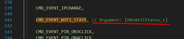

    Maybe colleague @p.kaczmarek2 can advise and help here :) Below what I managed to log regarding TH08E module communication....
    In firmware configured WiFi/MQTT/NTP (this works) and set flags 10, 37, 43 to this disconnected line CEN - here basically behavioural problems with bad communication similar to the TH08 described in the forum....
    Effect:
    The TuyaMCU tries to commune with the T1-U-HL (BK7238) and after a period of time shuts down its power supply. The date and time on the display is not updated....

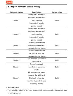

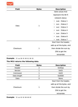

    Sent by WiFi module:
    55 AA	00	03		00 01	02	05
    HEADER	VER=00	WifiState		LEN	02	CHK
    Received by WiFi module:
    55 AA	03	03		00 00		05
    HEADER	VER=03	WifiState		LEN		CHK
    55 AA	00	03		00 01	03	06
    HEADER	VER=00	WifiState		LEN	03	CHK

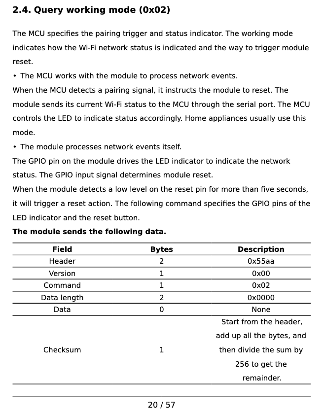

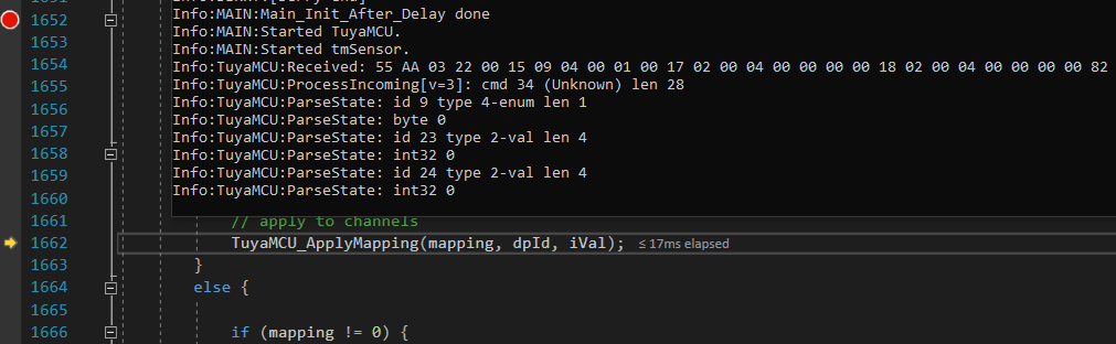

    In contrast, this is what the communion with OpenBK (TH08E) looks like:
    For autoexec.bat with startDriver tmSensor
    startDriver TuyaMCU
    startDriver NTP
    ntp_setServer 194.146.251.100
    ntp_timeZoneOfs 1
    Log:
    55 AA	03	01		00 37	7B2270223A22623876716D646A6D7073776261703171222C2276223A22312E302E30222C226D223A302C226E223A312C22736D223A307D	57
    HEADER	VER=03	Product		LEN	{"p":"b8vqmdjmpswbap1q","v":"1.0.0","m":0,"n":1,"sm":0}	CHK
    55 AA	00	01		00 00		00
    HEADER	VER=00	Product		LEN		CHK
    55 AA	03	02		00 00		04
    HEADER	VER=03	McuConf		LEN		CHK
    55 AA	00	02		00 01	03	05
    HEADER	VER=00	McuConf		LEN	03	CHK
    55 AA	00	02		00 01	04	06
    HEADER	VER=00	McuConf		LEN	04	CHK
    and log with autoexec.bat removed startDriver tmSensor :

    Added after 1 [hour] 54 [minutes]:
    OK Next entry ;)
    There is a little progress after adding the option to autoexec.bat tuyaMcu_defWiFiState 4 the communication went on and the date and time was set :)
    LCD of TH08E sensor showing 27.5°C temperature and 29% humidity
    As before with option startDriver tmSensor communication cuts off as above.
    Although there have been a couple of power-ups where the time/date failed to be set and the BK7238 was cut off (probably not connecting to WiFi - I haven't logged that one). Hmm any ideas ?
    What remains now is the issue of sending data to MQTT....
    ...which are sent as Report status (sync) (0x022) - that is multiple DPs...
    e.g. from the following log:
    55 AA 03 22 00 15 090400010017020004000000001802000400000000 82
    55 AA 03 22 00 15 0102000400000115020200040000001A0304000102 82
    hmm how can this be extracted to individual channels ?

  • tuyaMcu_defWiFiState 4 needed for MQTT connection

    tuyaMcu_defWiFiState 4 is needed, otherwise the device is waiting on MQTT to report that it is 'connected to the cloud', from what I remember, although I guess blank fields in MQTT are also considered a sign that it doesn't need to be checked.
    I checked your packet 55 AA 03 22 00 15 090400010017020004000000001802000400000000 82 and I can see that it is normally parsed by OBK. You just have to map the dpIDs available there to channels, as you normally do. linkTuyaMCUOutputToChannel
    Screenshot of code editor with TuyaMCU logs and channel mapping function
  • Will map dpId values to channels in autoexec
    #3 21817840

    And thanks for the info that the 0x22 package is parsed.... in the morning I'll change autoexec and try to map dpId to channels - ehh in addition I didn't check in Tuya what is under given Id so it will have to be described yet (well, you learn) ;) I'll see maybe from firmware backup it can be pulled out....

    There is BL 55072, yes?
    Exactly BL55072 going over I2C.
    Here, you could boldly knock out the TuyaMCU and plug directly into the BL55072....
    ...except that the segments would have to be configurable, because from what I checked the displays in those I have are different. Ot the one that has switching has additional AM/PM and C and F segments....
    The price of these thermometers in promotions is not high so you can confidently experiment without any major concerns - just if something goes wrong there is no great financial loss ;)

  • Restore RF backup to fix duplicate MACs
    #8 21819855
    tplewa
    Posts: 6741
    Help: 222
    Rate: 1009
    A little summary of the fight against TH08E and TH08C...
    1. Problem with identical MAC addresses after uploading OpenBK
    Unlike the fact that these thermometers are based on the BK7238, at least for the moment there is a problem after changing the firmware to OpenBK (this will probably be corrected in the future). After uploading the OpenBK firmware, we have devices with the same MAC addresses which poses a problem. To work around this, you need to restore the RF area in the Flash memory from the backup file after uploading OpenBK.
    - Restore MAC address after OpenBK upload
    a) In the Flasher checkbox "Show advanced options" and then click on the button "Custom"
    Screenshot of BK7231 Easy UART Flasher with Custom button highlighted
    b) Then select the option "Restore RF from backup" and select the binary of the firmware backup you made before uploading OpenBK
    BK7231 Easy UART Flasher window with Restore RF from backup option highlighted
    And that's basically it, after this step we already have the MAC address as it was before the OpenBK upload.
    2. Differences between TH08E and TH08C 2
    I am specifically describing the difference between the PCBs TH08-CBU-BL55072A_V3.8 2025-09-18 and "TH08-T1-U_V1.2 2025-10-13"
    Basically, apart from the other temperature/humidity sensors, what is important when changing the firmware is in "TH08-T1-U_V1.2 2025-10-13" TuyaMCU has no CEN signal connection from the T1-U-HL module.
    Specifically, Pin 8 of the TuyaMCU (U3) is not connected to Pin 18 of the T1-U-HL module - here, for this PCB and firmware upload, you may only need to raise/disconnect the RX and TX pins of the TuyaMCU chip (Pin 9 - MCU_RX and Pin 10 - MCU_TX).
    In the same way, the firmware of the TuyaMCU version TH08C (PCB "TH08-T1-U_V1.2 2025-10-13" ) does not send dpID 09 (Temperature Unit Convert)

    In both of these modules there were some communication problems e.g. sometimes what I mentioned there was a problem with setting the time and date. Likewise there were occasionally problems sending data to MQTT.
    From what I noticed in order for TuyaMCU to react and send us the sensor data and ask for the date it waits for the information that the WiFi is in state 4. I previously solved this with "tuyaMcu_defWiFiState 4" in autoexec.bat
    After receiving this information i.e. rami 55 AA 00 03 00 01 04 07 modules send packet 0x90 Get cached DP command (0x90)
    for TH08E it is frame 55 AA 03 90 00 04 03 09 17 18 D1
    whereas for TH08C 55 AA 03 90 00 03 02 17 18 C6
    for the aforementioned package should be answered with 55 AA 00 90 00 02 01 00 92
    As I mentioned earlier with the setting in autoexec.bat startDriver tmSensor there was a lack of communication (no WiFi status information was sent). On the other hand, without this option, when we compare the log of the original communication with what is sent by OpenBK, there is a little difference in the order of sent packets, which also caused some strange behaviour of the TuyaMCU chip from time to time. The communication worked one time, the other time it did not work.
    In the end I did a workaround using autoxexec.bat. It's not a perfect solution, but without changing the TuyaMCU driver code it's the only thing I could think of....
    The final solution here is to first wait for the time to be set from NTP and for the WiFi status to be set to a value of 4 and then manually send information about this and with some interval a response to the 0x90 command. Unfortunately when we enable startDriver tmSensor there is no automatic response to this command.
    I have implemented this in autoexex.bat and the response is sent after a fixed time (delay 1s) - not ideal but it works ;) Maybe someone has an idea how to solve this better ?
    Maybe here colleague @p.kaczmarek2 can think of some workaround for this problem in the driver code.

  • Delay cloud acknowledgement until NTP response arrives
    #11 21821593
    Posts: 14770
    Rate: 12913

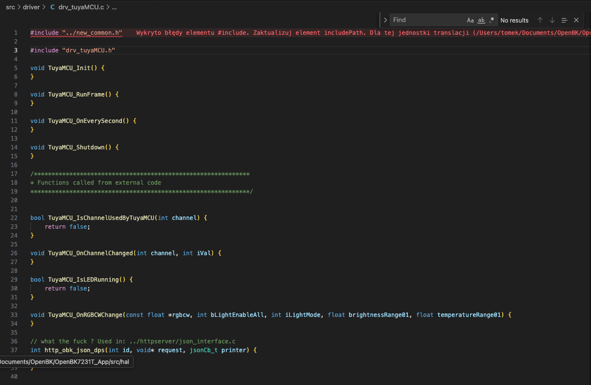

    It seems to me that the date problem could be solved here:
    C code fragment with condition checking MCU WiFi state and MQTT connection
    You need to add a condition to send an acknowledgement only after the response from NTP.
    This could also be done with a script. We have WaitFor and NTPState:
    waitFor NTPState 1

    Generally as there is a tmSensor driver the communication looks different than it was with the original firmware on BK....
    Seemingly it works but strange things happen sometimes - i.e. as if empty data is sent to MQTT and we have something like this on the temperature graph (same for humidity and battery.... ...sometimes only one value is as zero e.g. battery) :
    Temperature chart from OBK sensor showing periodic drops to zero
    or maybe TuyaMCU disconnects power from BK before it sends data....

    Values look ok:
    Code screenshot showing CMD_EVENT_WIFI_STATE line and comment
    HALWifiStatus enum definition with various Wi-Fi connection states

    Seemingly it works but strange things happen sometimes - i.e. as if blank data is sent to MQTT and we have something like this on the temperature graph (same for humidity and battery.... ...sometimes only one value is as zero e.g. battery) :
    TuyaMCU does not disconnect power, rather it is MQTT that performs the publish before TuyaMCU sends data. This is a known problem. A potential work-around is to set the startup channels value to -1, i.e. remembering the previous measurement, but this is not ideal. You could also play with flags, "broadcast self state on connect" or the mqtt_broadcastItemsPerSec command or manually do publishChannel.
    It would be best to give a patch for this in code, but battery-powered devices are a bit less of a priority because most people use Zigbee for this.

  • CMD 0x02 and 0x03 meanings corrected
    #14 21821750
    tplewa
    Posts: 6741
    Help: 222
    Rate: 1009
    As for the values, yes only the names in the OBK are a bit misleading ;)
    CMD 0x02 - McuConf - According to the documentation (Tuya Developer) Serial Port Protocol "Report the network status of the device"
    CMD 0x03 - WifiState - According to documentation (Tuya Developer) Serial Port Protocol "Reset Wi-Fi"
    hehe that's why it's a bit difficult for me to analyse this driver code ;)
    But what else wouldn't be rosy is that there are other names in the "Basic Features" pdf and it fits more like 0x03 as far as the format is concerned than the one described in (Tuya Developer) Serial Port Protocol....
    and here CMD 0x02 - this is Query working mode
    and CMD 0x03 - is Report network status
    CMD 0x02 command table from Tuya documentation showing data structure Tuya documentation snippet showing data format for command 0x02 Tuya documentation excerpt: CMD 0x03 command description with usage examples Network status table for CMD 0x03 in Tuya protocol (Report network status) Tuya documentation snippet showing network statuses and CMD 0x03 data structure Tuya protocol table with CMD 0x03 field descriptions and example data frames
    As for the fact that MQTT sends the data before it receives it, that's possible - that's why the sensor without the display works ok for me, and here there is some delay because we are waiting for NTP. Well, and here as it takes more time MQTT sends zeros.... This ties up into a logical whole.
    As for the patch in the code, hmm maybe I would try something but I don't even have a clue where in the code the sending is done ;) Probably you would have to give a flag as battery powered and some semaphore as the data is already ready to be sent.... Unfortunately there's a lot of this code and so I'm slowly analysing it but a lot will come down as I get a grasp of what the whole data flow in the code looks like and what the dependencies are.... ...and I don't want to do something on the spur of the moment because it's not hard to break ;)
    As for the order, I would say yes, if the analyser does not swap with the order then yes. I always logged on a clean buffer and then copy&paste to a txt file with a description of what I logged.
    Here looking at the communication when tmSensor is on we have in sequence:
    1. Product request and response - this is OK
    2. Sending cyclic CMD 0x02 that is McuConf
    What is missing here is CMD 0x03 which, when I manually send it with autoexec.bat, the TuyaMCU processor continues - it just stands there and does not ask for anything....
    Further, there was a problem with CMD 0x90 - I also did that with autoexec.bat - but now I have the corrected tuyaMCU driver where I added that and it flies on without that.
    There are actually two issues remaining, namely this NTP and the lack of CMD 0x03

  • TuyaMCU driver mixes V0 and V3 CMD 0x02 handling
    #16 21821778
    tplewa
    Posts: 6741
    Help: 222
    Rate: 1009
    @p.kaczmarek2
    Okay I think I have a problem - although today I can barely see out of my eyes and I'm falling on my snout from fatigue ;)
    namely CMD 0x02:
    55 AA 03 02 00 00 04 - this is "Query working mode" ( cmd 0x02 V3)
    and
    55 AA 00 02 00 00 01 - this is "Report the network status of the device" (cmd 0x02 V0)
    Heh driver TuyaMCU doesn't distinguish which version it is and it gets messy in communication because in this one mine sends V3 commands.... and the code responds as if to a V0 command
    ot instead of getting WiFi status in CMD 0x03 V3 "Report network status (0x03)" I get WiFi status in CMD 0x02 V0
    well generally there is a lot of code to improve ;) checking with Tuya's documentation for V0 and V3
    Added after 7 [hours] 24 [minutes]:
    @p.kaczmarek2
    Okay I've done probably the only right thing ;) I've brought the drv_tuyaMCU code to this state (so that it compiles):
    Screenshot of code editor showing drv_tuyaMCU.c with include path error
    Patching the code further probably makes no sense, it would be quicker to rewrite according to Tuya's documentation.... ;)
    On top of that, you need to clean up and get rid of such bloomers from the driver code as http_obk_json_dps (the JSON parsing part for the web server related to the dpId) because it's damn near unreadable if someone has to develop the code later....
    All in all, I was quite surprised when I knocked the code out of this driver and on compilation it popped up that something related to JSON in the HTTP server was missing ;)
    Possibly at least rename it so that it's clear that it's in drv_tuyaMCU....
    All in all, I will still think about what to do with such "flowers" - i'd rather leave that for last...

    does this build make any difference if you OTA or UART flash to it?
    remove tmsensor start if you have it set
    • OpenBK7231T_App_tuyamcu2_47d759a5fe55_OpenBK7238.zip (2.13 MB) You must be logged in to download this attachment.
  • #19 21931608
    tadeu1
    Posts: 83
    mine is BK7238 not 7231, can you send me the BK7238 please?
  • #20 21931609
    Posts: 5220
    Help: 449
    Rate: 918
    yes. the beginning of the filename is misleading, this is for BK7238
