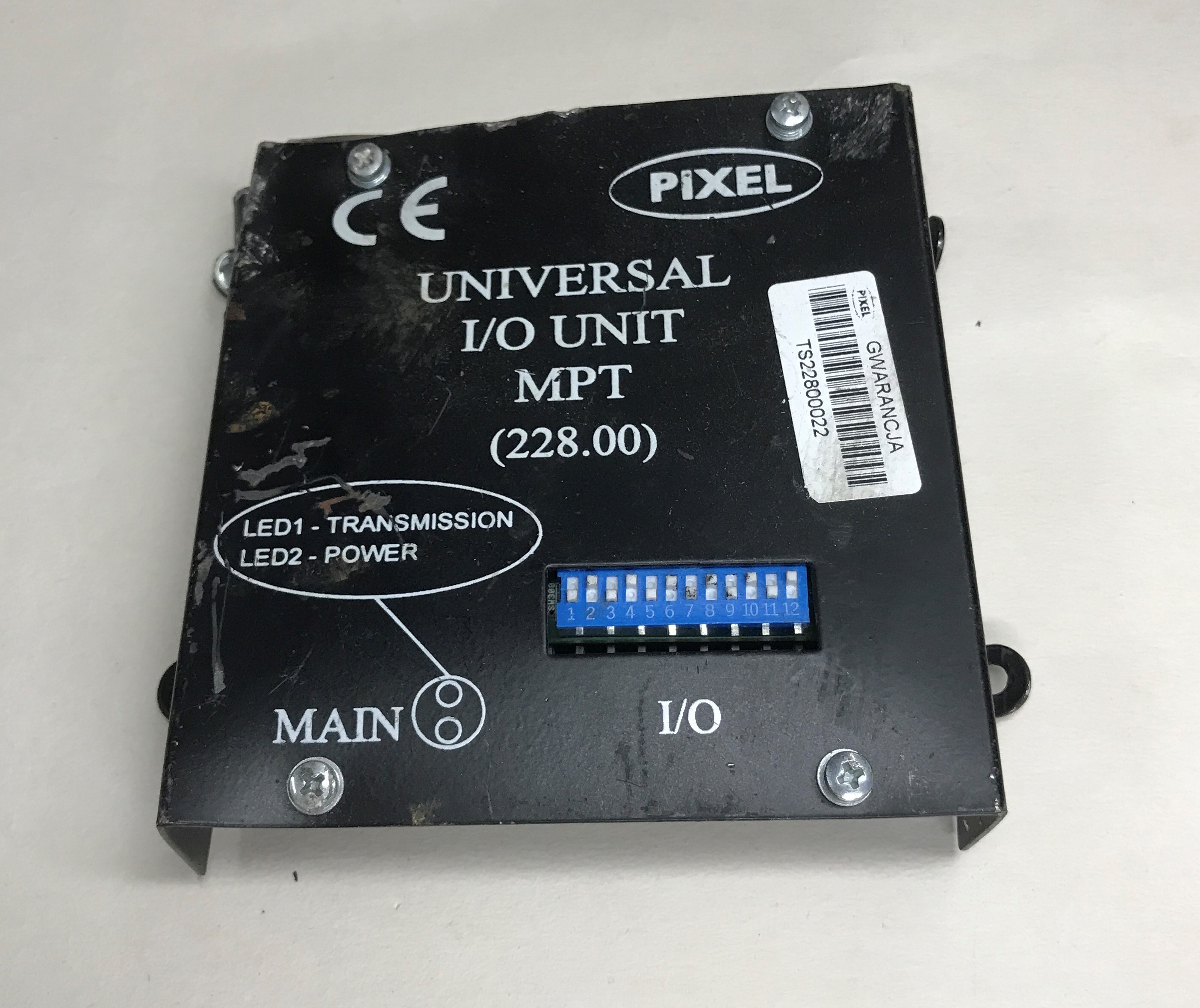

Here's the inside of another 'railway' equipment after decommissioning. This time the casing is pretty much squashed, but it's still worth a look inside - what is the so-called 'technical measurement module'? The English name is Universal I/O Unit MPT, which suggests it's an expansion card of some sort.
Black metal PIXEL housing labeled “Technical measurements module” MPT 228.00, 16–36 V
Operating voltage is 16-36 V, current up to 80 mA (at 24 V). It looks, to me, like a Polish design.
We remove the cover:

It's difficult for me at the moment to make a fully reliable assessment of what the role of the TS922IDT is in this circuit. My guess is that it is the inputs. Is anyone reading able to supplement?
In summary , this was the IO module I received with a packet of 'railway' scrap, although I don't know exactly where it was used. The whole thing took a bit of a beating at checkout, so I don't know if I'll get it up and running, but the inverter at least I could recover, the CAN and RS232 transceivers will also come in handy. Interestingly, the whole thing has inscriptions in Polish, even on the PCB, so one could suspect that it was designed in our country.
If anyone has any additional information, feel free to comment.
