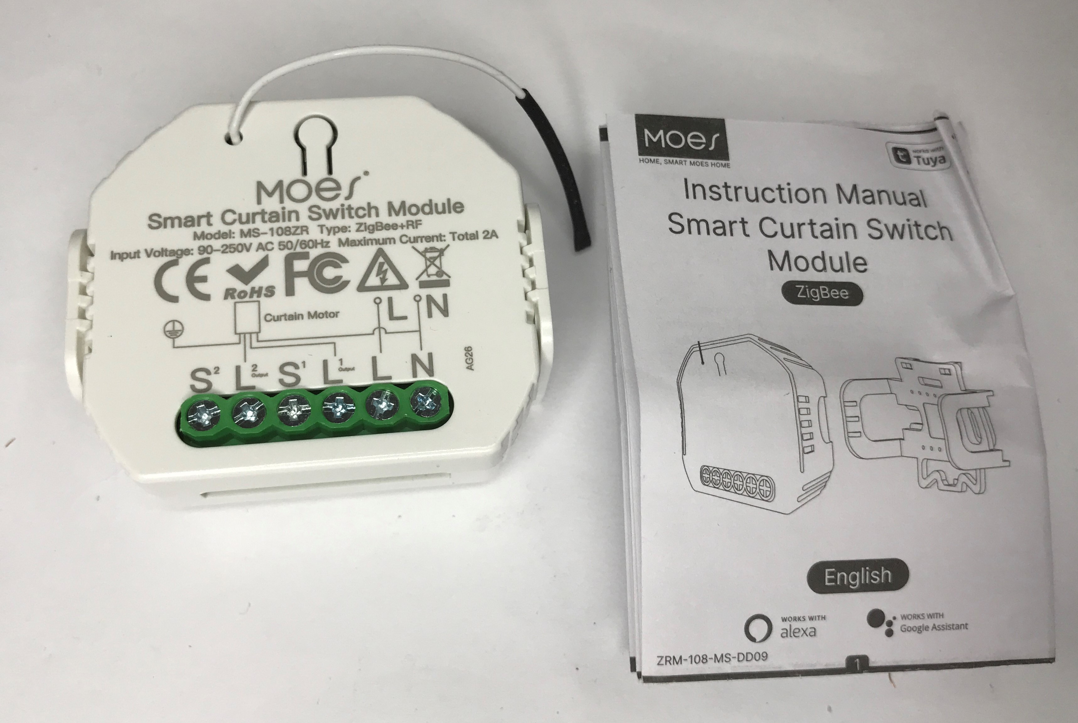

I'd like to invite you to a test of the MS-108ZR in-box roller shutter controller module based on Zigbee wireless communication with additional RF support. Here I will present its pairing with Home Assistant via Zigbee2MQTT, check what its integration with HA offers and show its interior. All this we get for only PLN50 - is it worth it?
Moes ZigBee+RF curtain/blind switch module with L, N, S1, S2 terminals and printed wiring diagram
The device works with loads up to 300 W, while for resistive loads the maximum current recommended by the manufacturer is 2 A. This is sufficient in itself for most roller shutters. The connection diagram is in the manual and, in principle, also on the device itself.
