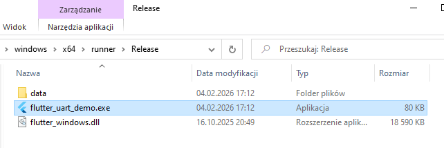

    Let's start with the simplest one - Windows. The application is compiled to an exe and opens as a windowed application.
    Windows File Explorer showing flutter_uart_demo.exe selected in the Release folder

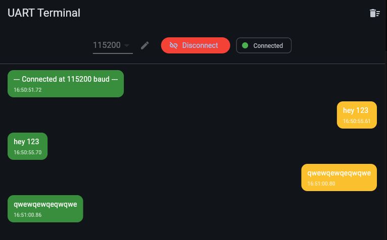

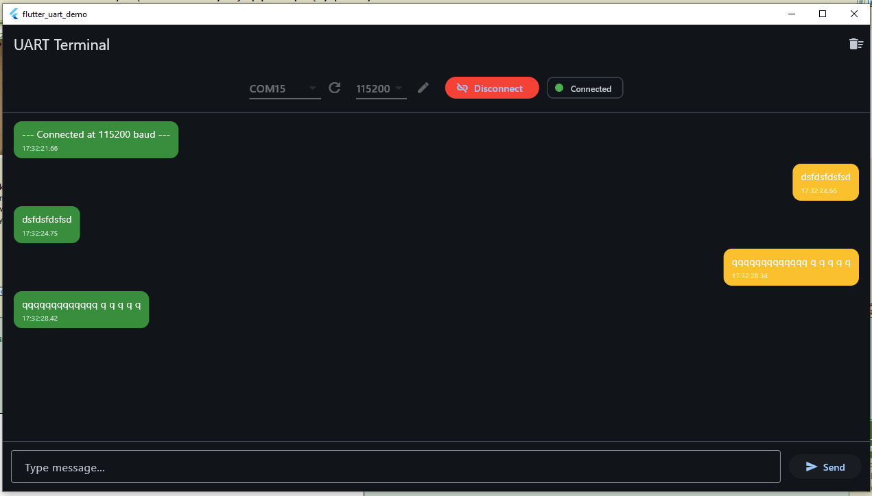

    The application correctly detects the available COM ports and allows us to select one of them. For a test, I shorted the RX and TX pins to get an 'echo' effect, i.e. receiving what I sent.
    Screenshot of a UART terminal showing COM15 connected at 115200 and chat-style sent/received message bubbles

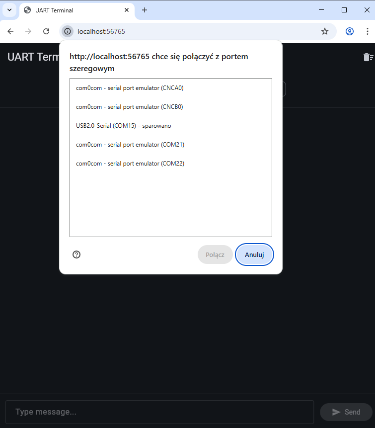

    Presentation - web application in Chrome

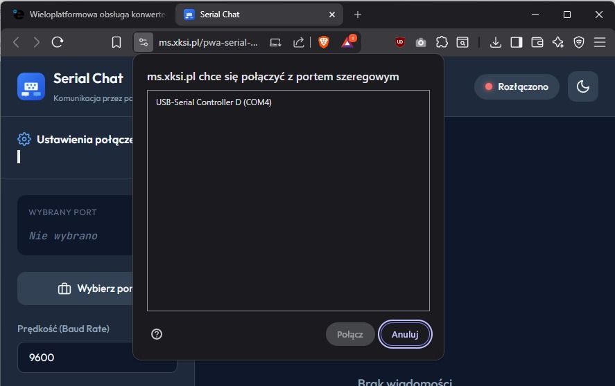

    In Chrome (and other supported browsers) it is slightly different. There, the serial port is selected by a mechanism from the browser.
    Chrome dialog asking to select a serial port for localhost:56765, with Connect and Cancel buttons
    The rest is unchanged - the business logic is the same and the echo test gives the correct result.

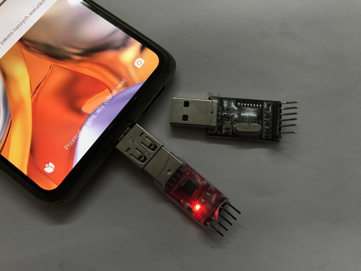

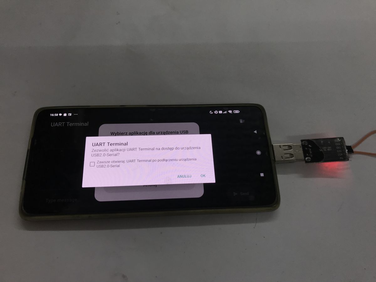

    For this you will need an OTG adapter, this is because normally the phone is in the role of a USB device and not a host. Such an adapter has USB C on one side and a typical USB female A socket on the other.
    Smartphone showing a USB permission dialog in “UART Terminal” with a USB-to-UART adapter plugged in
    The phone asks for permission for device connections and you have to manually allocate them. The rest without problems. Communication works.

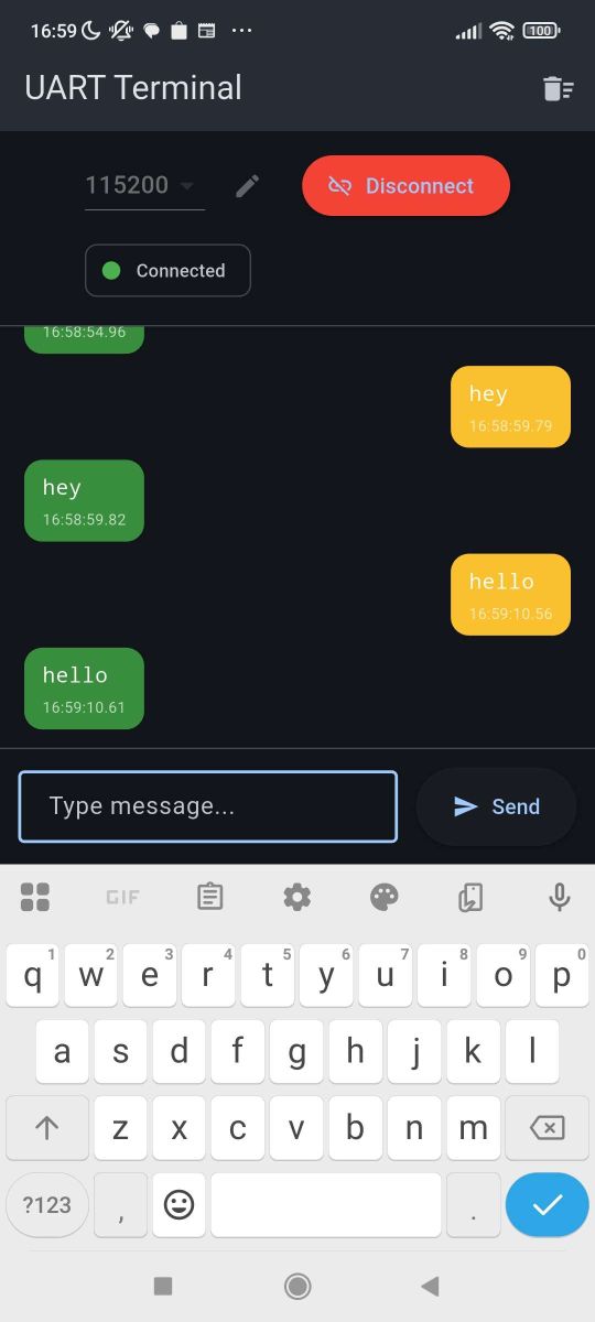

    Android screenshot of “UART Terminal” app showing Connected status and “hey/hello” message bubbles

    It seems to me that all you had to do was make a PWA application / JavaScript and you would have the same thing automatically for all platforms.
    PWA is supported on Android, Windows, Mac, Linux and more....
    The API documentation for the serial port https://developer.mozilla.org/en-US/docs/Web/API/Web_Serial_API?utm_source=chatgpt.com indicates what it works on.
    And here is just such an application: https://ms.xksi.pl/pwa-serial-port/
    And the sources in the appendix.
    * AI-generated code.
    In this approach you have one code for all platforms, apart from notepad you don't need any tools to write, you have debugging tools in every browser....
    I think that for the purposes of playing with electronics, this is today the most convenient way to write auxiliary tools or small applications.
    Browser screenshot of “Serial Chat” web app with USB port settings and chat messages Browser window with “Serial Chat” app and a dialog to select a USB‑Serial port (COM4)

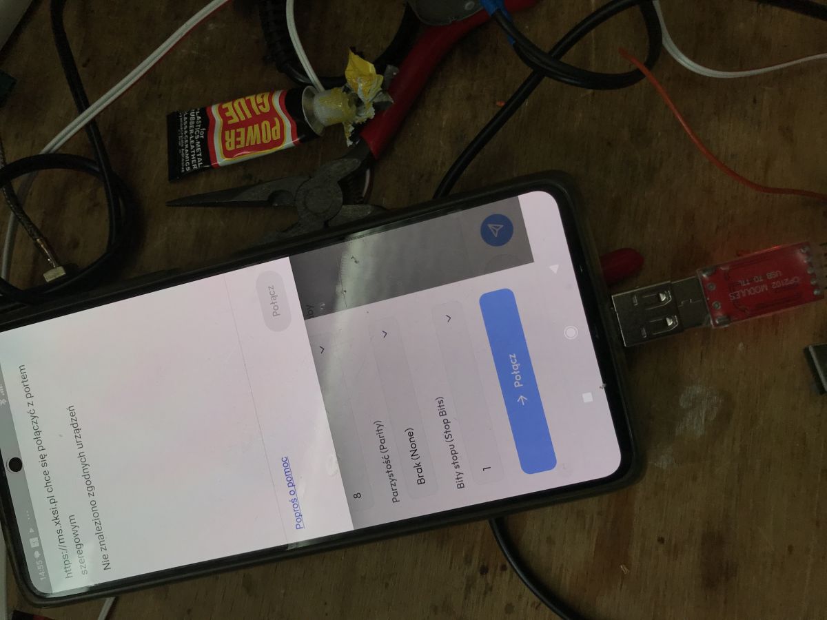

  • #3 21829858
    Posts: 14795
    Rate: 12945

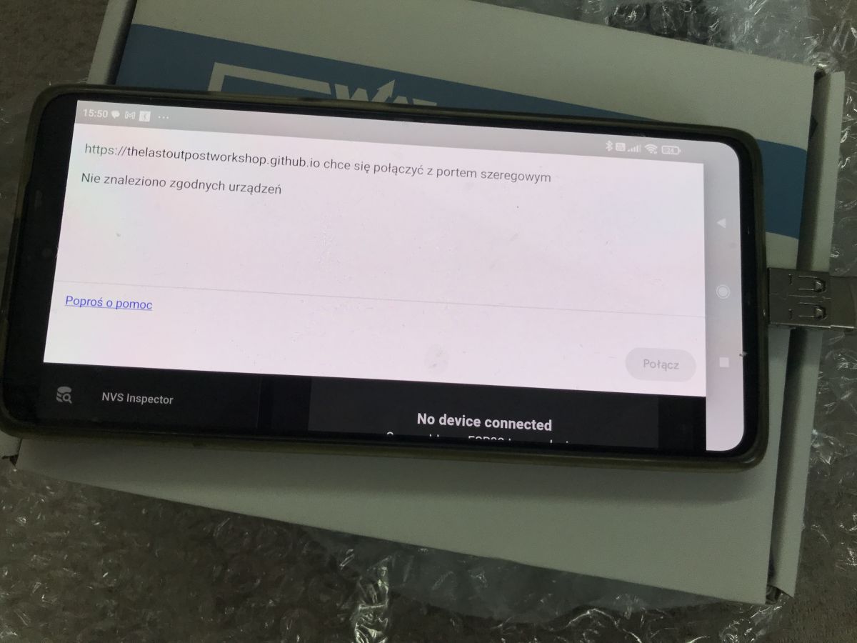

    Thanks for the suggestion, but I think you're missing something though, because on my Androids the solution from the first post sees the UART port, while your site doesn't:
    Phone on a workbench showing UART connection settings with a blue “Connect” button
  • Chrome on Android lacks Web Serial API support

    And that's interesting. Looks like I need to look for a usb-3 <-> usb adapter though and there's a problem because I can't remember when or where I last saw one.
    Added after 20 [minutes]:
    It seems that if I had read the documentation carefully, which I pointed out myself: https://developer.mozilla.org/en-US/docs/Web/API/Web_Serial_API then I would have seen that Chrome on Android does not support Web Serial API .
    So you have to compile... I was convinced that such a trivial thing as a serial port would also be implemented under Android.
    By the way, I wonder why they didn't make this available.
  • ESPConnect also fails to detect the port
    #5 21829910
    Posts: 14795
    Rate: 12945
    I've double-checked on my side still and it seriously doesn't see this port with me.
    Now the question is, for example with ESPConnect will it see it?
    ESPConnect - a convenient tool for ESP8266/ESP32 in the browser - Flash, partitions, information
    Added after 16 [minutes]:
    No, ESPConnect won't work either:
    Phone on a box showing a browser message: no compatible devices found for a serial port
    So there is something to fight for.

    I've double-checked on my side and it seriously doesn't see this port with me.
    Well, because it turned out that under Android it has no right to see. I've already completed the post above so there's no messing about. I started reading why they don't implement this in Chrome on android and it turns out that they don't, because they don't, and in detail it's probably because they don't want to give chrome permissions to serial ports, because these are "somehow connected" to files and a serious vulnerability could arise.
    So if you want serial ports in the browser then on a Windows / Linux / Mac machine there is no problem and on Android no .

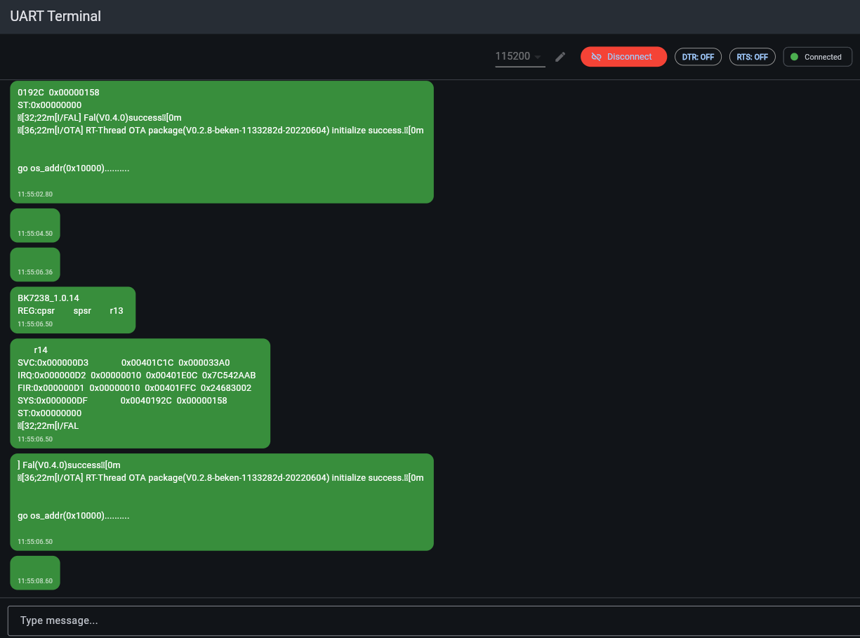

  • Web DTR/RTS control via setSignals API
    #12 21839213
    Posts: 14795
    Rate: 12945
    DTR/RTS control also works, at least on web. I need to implement on Android:
    Screenshot of UART Terminal with green logs, DTR/RTS buttons, and Connected status

How do I connect a USB‑UART adapter to Android with OTG?
  1. Plug a USB‑C OTG adapter into the phone, then the USB‑UART dongle.
  2. When prompted, grant permission to the app for the device.
  3. Select the port in‑app and open the connection. [Elektroda, p.kaczmarek2, post #21829568]
Will ESPConnect see my serial device on Android?
If ESPConnect uses the Web Serial API, it will not see the port on Android Chrome. It will work on desktop browsers that support Web Serial. [“Web Serial API”]
