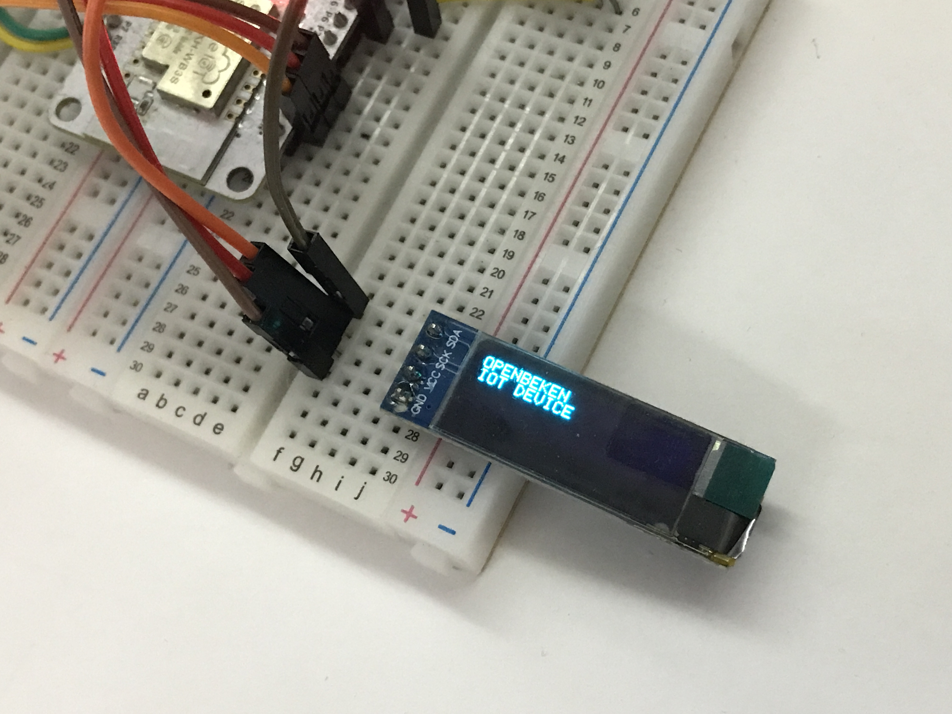

First characters
The next step is to display the text. Here again, you can take advantage of this division of memory into 8 pages and assume that you only ever draw characters on one of them. This in turn allows us to encode the characters as strings of bytes, which we send linearly to the controller, only setting the position on the selected one of the pages beforehand (SSD1306_SetPos).
For the demonstration, I used a standard 5x7 ASCII font, with no lowercase letters. The whole thing is encoded in an array:
Code: C / C++
The SSD1306_WriteChar function sends one character to the controller, this character consists of five bytes of data. Nothing more needs to be done, as we have auto-incremented the address within the selected page.
Code: C / C++
Then you can add an auxiliary function SSD1306_String, which sends consecutive characters separately.
Code: C / C++
The function for presentation remains:
Code: C / C++
Result:
OLED display on a breadboard with wires attached, showing the text “OPENBEKEN IOT DEVICE”.
