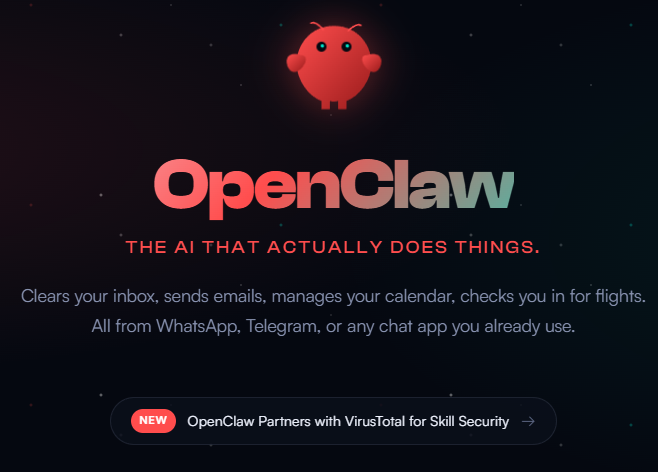

Zack Korman in his GitHub repository skills presents a simple 'prompt injection' attack to which modern AI agent systems such as OpenClaw are vulnerable. "Prompt injection", as the name suggests, involves 'injecting' a malicious command into the data processed by the model. LLM models cannot natively distinguish between the prompt (command) and the data, so they can potentially perform unwanted actions commanded to them by the attacker. This is particularly dangerous for agents such as OpenClaw, as they often have access to large amounts of sensitive systems and personal data.
The attack shown here hides the malicious command in a Skill file, which is a skill for use by the agent. The skills system is simply a system of text files (prompts) that the agent loads to 'acquire' new skills. Skill files are often in Markdown format, further hiding the command from the user by putting it in HTML comment format. This is what a user visiting GitHub sees:
