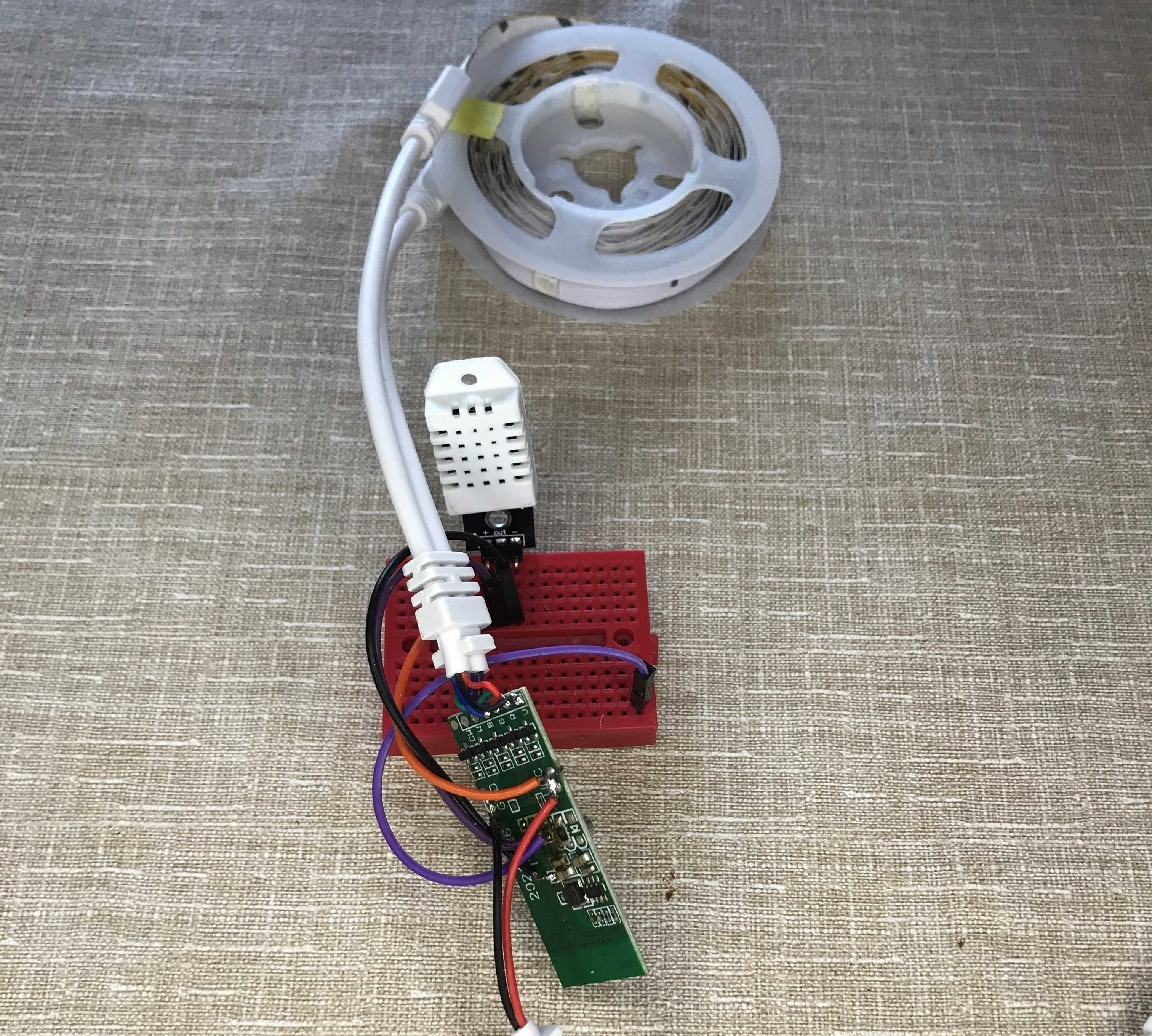

Why change the firmware of IoT devices? One good reason to change the firmware may be to expand the functionality of your existing device. Factory applications usually do not allow for large modifications, whereas open source projects provide almost infinite possibilities. Here, I will show just such a modification using Tuya's RGB LED strip controller as an example. I will change its firmware so that it can be connected to Home Assistant, and then add the DHT22 temperature and humidity sensor to it. Of course, other sensors are also supported - I just had the DHT on hand.

LED strip controller wired to a DHT-style sensor on a red prototyping board
Take this DHT22, for example. It's a simple and cheap temperature and humidity sensor. It requires one arbitrary pin for communication. We choose its role:
Screenshot of GPIO pin configuration menu with options list; DHT11 sensor option highlighted
We connect the DHT as we would to an Arduino, meaning we need a pull up resistor if we don't have one on the DHT board itself. Then we set the channels, simply, we enter the first free numbers. As we set the PWM to channels 1, 2 and 3 (to have RGB), we enter 4 and 5, etc.
GPIO settings panel snippet with DHT11 selected and highlighted channel fields set to 5 and 6.
We save and restart the device if necessary (depends on the controller). The measurements should show up in the panel.
