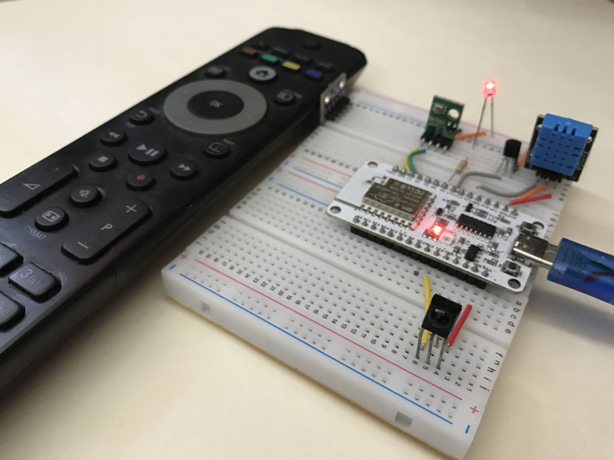

  • Remote control and breadboard with BK7238 module, IR receiver, and LED

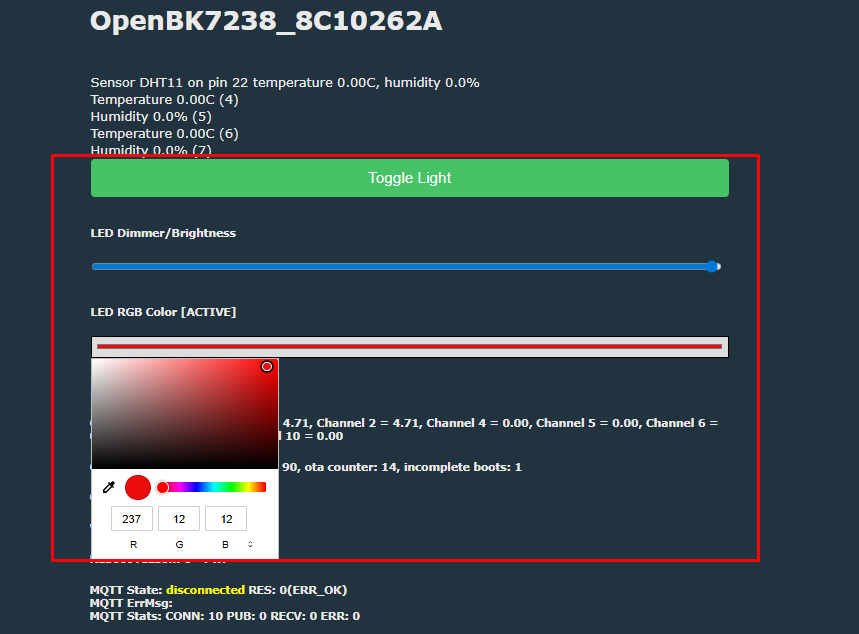

    Configuring the onboard LED
    For the purpose of this demo, I decided to use onboard RGB LED. The onboard LED resides on P6, P24 and P26, but logic levels are inverted. So, I had to set PWM_n (inverted) roles. Either do it manually in Config->Configure Module or import my template:
    Now, you should get this on your main panel and be able to control the LED:

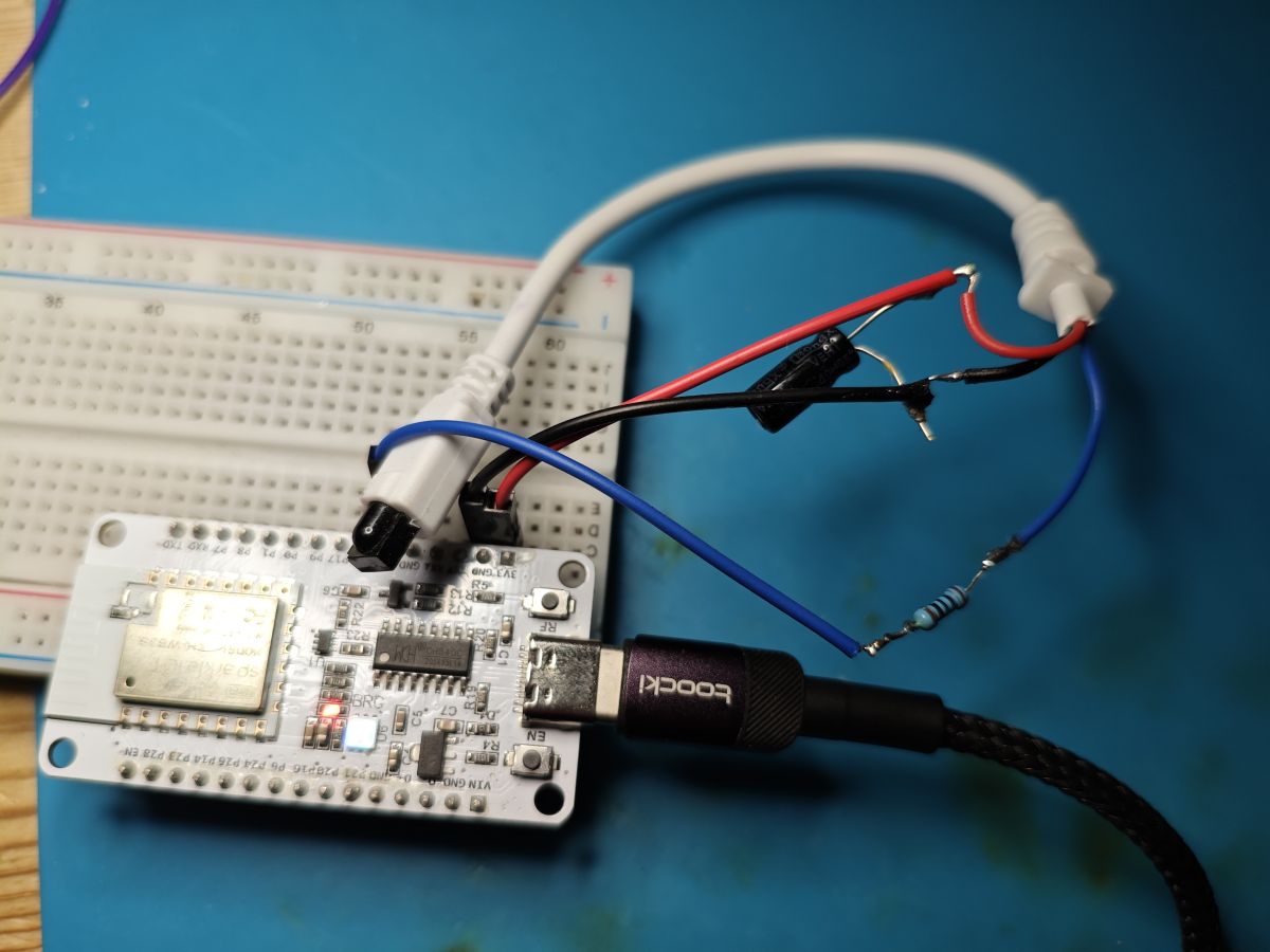

    First you need to know IR receiver pinout. If you are reusing old receiver from old scrap board, follow the traces on PCB. Check for capacitors and ground plane. Check for silkscreen marking.
    If you bought new IR receiver, then check manufacturer/seller datasheet.
    Also check working voltage - for me, only 5V worked.
    Here is my connection:

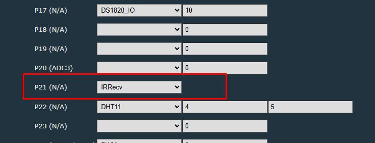

    I chose P21 as IR input and configured it in Configure Module section:
    Setting port P21 as IRRecv in the OBK configuration interface

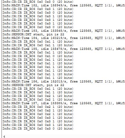

    IR events in OBK Web App Log
    Point your remote towards the receiver and press some button - observe the log.
    As you can see, the 1, 2, 3 buttons on my remote have the following codes:
    OBK Web App logs showing received IR events using the RC6 protocol

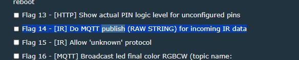

    First enable flag 14:
    Checked option in GUI: Flag 14 - IR - publish MQTT with raw string for IR data

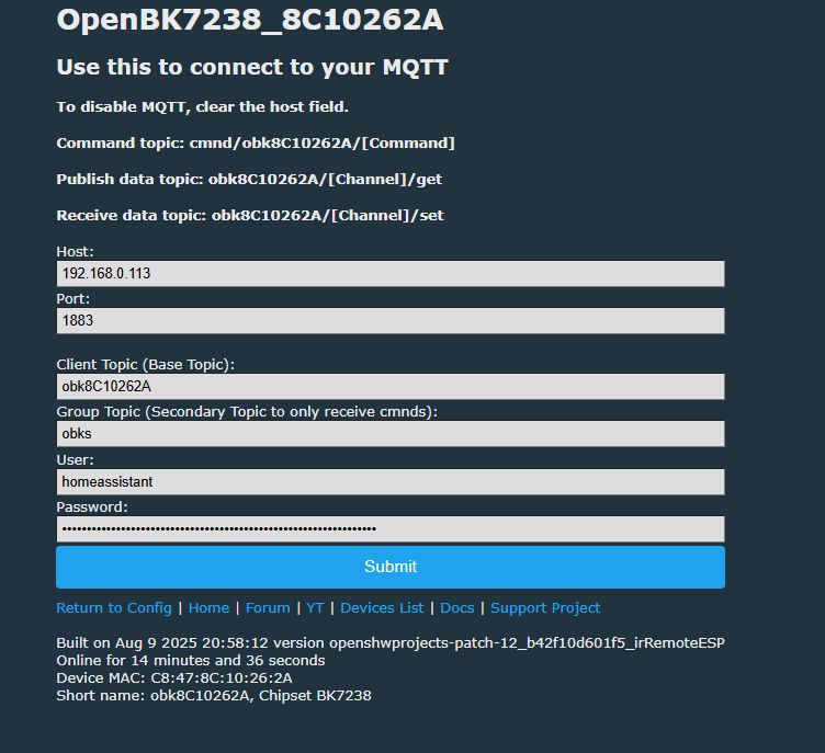

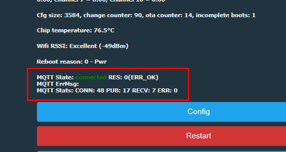

    Also make sure that you have MQTT configured.
    MQTT configuration form for OpenBK7238 device with filled input fields
    Main panel will tell you if the connection has succeeded:
    Highlighted MQTT status panel showing connected state with no errors

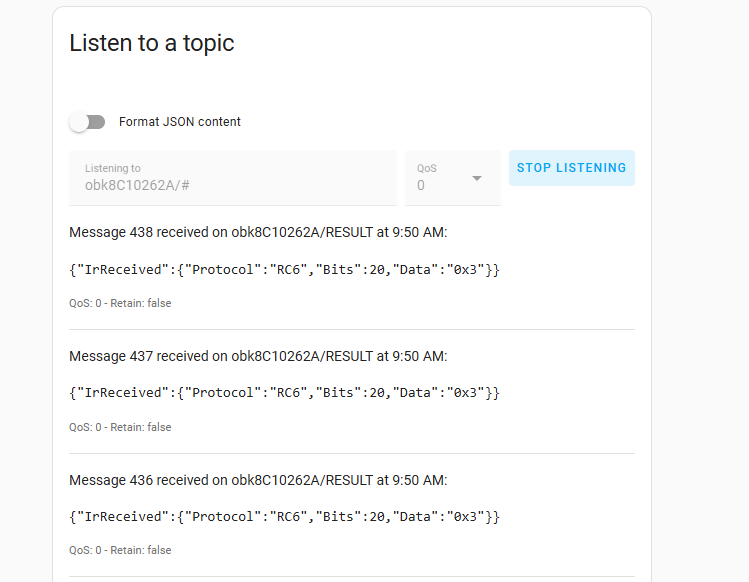

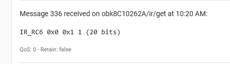

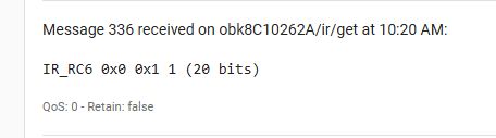

    Then you can listen to device topic in Home Assistant:
    IR_RC6 IR event received via MQTT on topic obk8C10262A/ir/get at 10:20 AM

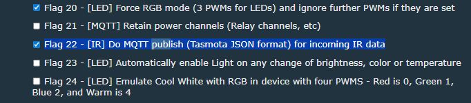

    IR events in Home Assistant - Tasmota format
    Just like before, but use flag 21.
    Screenshot of OBK flag settings with Flag 22 enabled for IR MQTT Tasmota JSON
    Then, again, you can listen to device topic in Home Assistant:
    Screenshot of MQTT messages from IR remote using RC6 protocol in Home Assistant

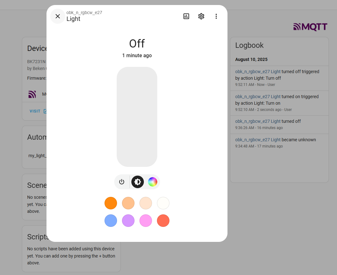

    First, let's assume you have some other device to control. Let's say, RGBCW bulb:
    Control panel for obk_n_rgbcw_e27 light with MQTT action log on the right
    It's called obk_n_rgbcw_e27.

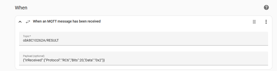

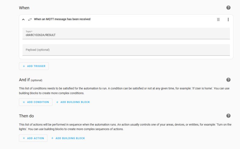

    Now, let's create automation. First, set trigger to MQTT topic RESULT:
    Screenshot of Home Assistant automation editor with MQTT trigger set
    Then, the simplest way would be to set raw payload:
    Section of Home Assistant automation triggered by IR MQTT message

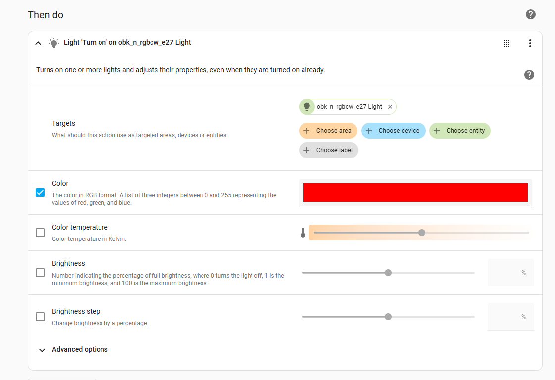

    and set action to do:
    Home Assistant automation panel setting RGB light color to red

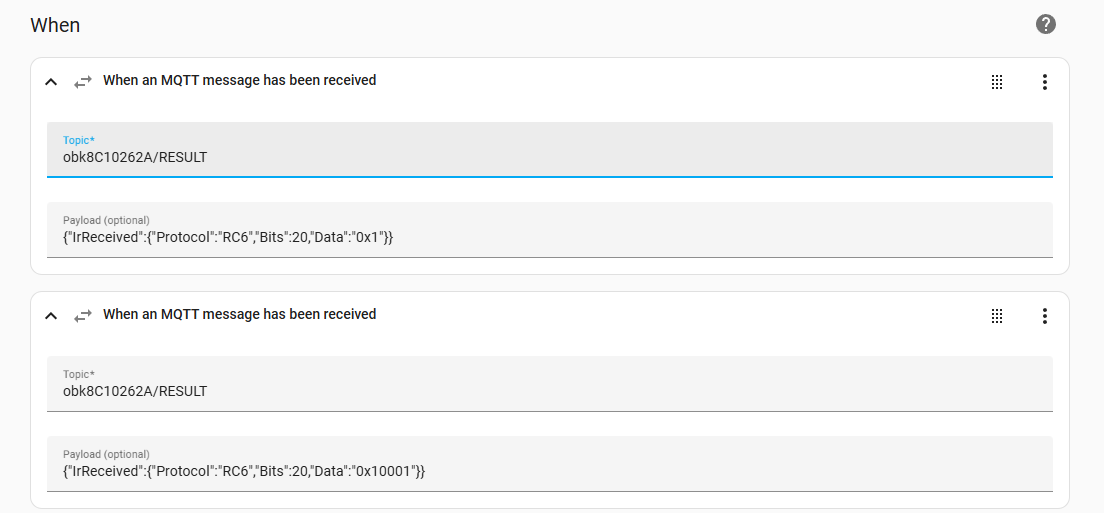

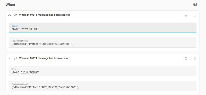

    You may also notice that sometimes IR data contains extra press/hold bit. You can handle both messages in single automation to work around it:
    Two MQTT triggers with IR RC6 data shown in Home Assistant automation editor
    It works well now:

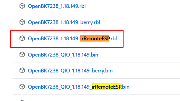

    Alternate IR library version
    Stock obk uses Arduino-IRRemote port, you may also want to try extended version in a form of ESP8266IrRemote. Get it from releases:
    https://github.com/openshwprojects/OpenBK7231T_App/releases/
    Firmware files for BK7238 with irRemoteESP extension highlighted in color.

    Gave the new build a spin myself with the NiceMCU/XH-WB3S board
    IR receiver rescued from parts box from a dead LED strip controller
    NiceMCU board with IR receiver wired to a breadboard for BK7238 testing
    registers random buttons on remote
