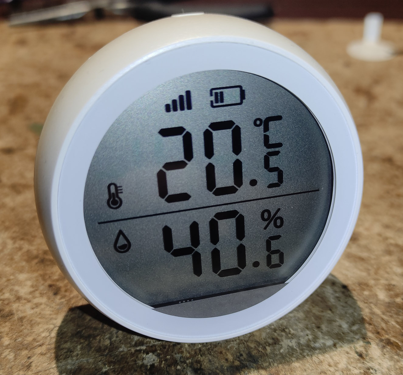

  • Ty0201/RSH-HS03 Zigbee thermometer with Tuya factory firmware was reflashed over OTA to pvvx ZigbeeTLc.
  • The update used Zigbee2MQTT's manual file selection, with 1141-0203-10923001-ZTY0201z_v0134.zigbee for the first OTA and the button held to stop sleep.
  • The stock firmware had very short range, 30-minute temperature updates, and 800 mAh batteries lasting just over six months.
  • After reconfiguration, Z2M detected temperature, humidity, and battery level, but advanced ZigbeeTLc settings were still unsupported.
Round LCD thermo-hygrometer showing 20.5°C and 40.6%, with signal and battery icons
in this topic I will present a software change via OTA in a Zigbee thermometer. Why am I changing this software over at all? Well, while it is very cool in appearance, has a display and is powered by two AAA batteries, unfortunately the factory software is an example of how softwares should not be written for Zigbee.
So:
- Very short range - the device in practice needs to be a few metres from the Zigbee router. Placing it in another room often results in a loss of connection (changing the firmware here won't help - such is the design).
- Temperature update every 30 minutes - regardless of whether the temperature changes or not.
- Possibility to manually refresh at the press of a button, but... the button simultaneously switches between °C/°F units.
- Rapid battery drain - 800 mAh rechargeable batteries last just over six months.

I had version one, so I didn't have to do anything.
Only to be safe I made a copy of the original software. This isn't necessary of course, but as the alternative software has only just been released I preferred to be able to revert to the original should the need arise.
To do this I used https://github.com/pvvx/TlsrComSwireWriter and a USB-COM adapter on a CP1202 chip. I made a couple of copies and compared if I was sure the contents matched.
Windows Command Prompt screenshot showing TLSR825x Flasher logs reading flash memory and saving .bin backups
Ok, it's now time to do the update. I'm changing the firmware to the ZigbeeTlc version written by pvvx, just this month this thermometer model started to be supported by them https://pvvx.github.io/TY0201_TZ3000_bjawzodf/
Admittedly the version released is still marked as beta, but it fully supports this model.
Also a couple of weeks ago there was a major change to the OTA support module in Zigbee2MQTT. The ability to manually select the file to be updated has been added. So you don't have to fiddle with creating the relevant configuration files to specify the right file. Simply download it to disk and select it in the browser window.
This is the list of versions of this firmware from pvvx. The relevant file should be downloaded from the bin directory on github: https://github.com/pvvx/ZigbeeTLc/tree/master/bin
There are 3 versions:
- 1141-0203-10923001-ZTY0201z_v0134.zigbee - the first one is the one to use in this case, it is used to perform an OTA update from the original firmware
- 1141-0230-01343001-ZTY0201.zigbee - the second one is the one to use for OTA updates when ZigbeTlc is already installed on the device
- ZTY0201_v0134.bin - the third is a traditional binary for programmer uploads
Zigbee2MQTT screenshot showing OTA update dialog with a selected .zigbee firmware file Zigbee2MQTT screenshot showing TS0201 Tuya device, 52% battery and remaining time 12:49
Ok, so I specified this file, the update seemingly started and an error occurred, timeout. From what I read on github https://github.com/pvvx/ZigbeeTLc/issues/107
It is the case with this thermometer that you have to press the button on the case all the time during the update (for about 15min of the update!), so that this one doesn't go to sleep. Another example of how the factory software is messed up.
Well, nothing, after those several minutes of clicking, the update reached 100% and the thermometer reset. Now we had to click on the Z2M in the device tab "Reconfiguration" to have it redetected.
And here's where another glitch, it turns out that the device is unsupported. Not really surprising, after all this software has only just been released and presumably with one of the next Z2M updates support will be added.
At the moment, however, I don't have any settings available, and there are quite a few in this firmware, such as calibrating the display - both on the display and via Zigbee, setting the update frequency or disabling the display.
Fortunately, the basic Z2M item detected, namely temperature, humidity and battery level.
Zigbee2MQTT device page for TY0201-z showing “unsupported”, battery 67%, and firmware ID 3001_0134 Zigbee2MQTT screenshot showing sensor data: battery 67%, 20.4°C, humidity 42%, linkquality 92
It remains to test how this firmware will perform. I think it should sensationally because I already use it in the Xiaomi LYWSD03MMC thermometer ( https://pvvx.github.io/ATC_MiThermometer/ ), this tiny model, also with a display is powered by a CR2032 battery and has worked for me on it for over a year!
