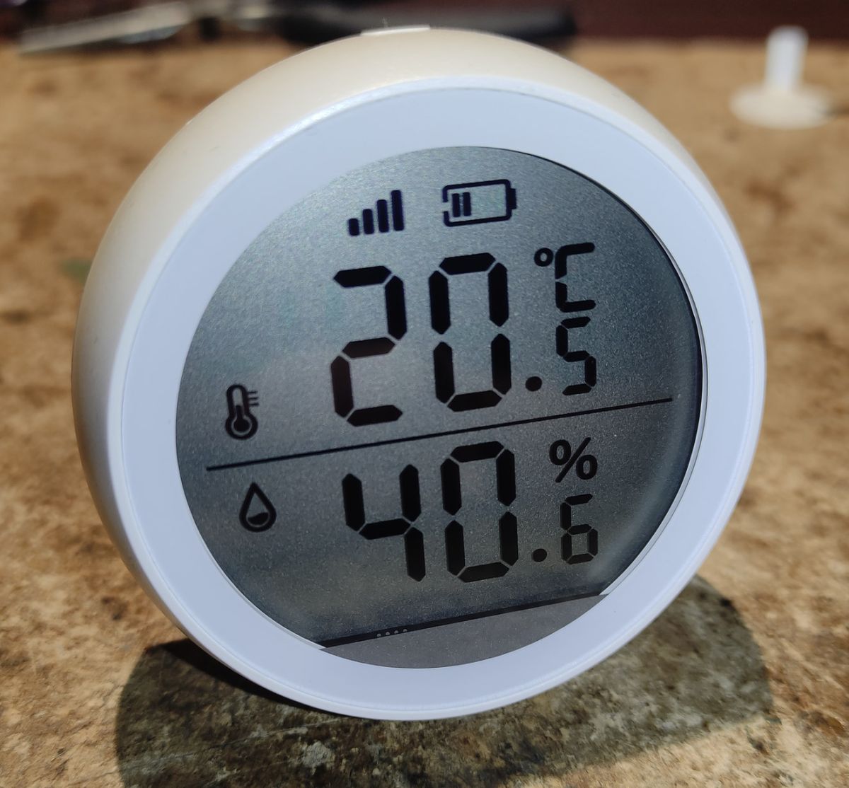

  • Round LCD thermo-hygrometer showing 20.5°C and 40.6%, with signal and battery icons
    in this topic I will present a software change via OTA in a Zigbee thermometer. Why am I changing this software over at all? Well, while it is very cool in appearance, has a display and is powered by two AAA batteries, unfortunately the factory software is an example of how softwares should not be written for Zigbee.
    So:
    - Very short range - the device in practice needs to be a few metres from the Zigbee router. Placing it in another room often results in a loss of connection (changing the firmware here won't help - such is the design).
    - Temperature update every 30 minutes - regardless of whether the temperature changes or not.
    - Possibility to manually refresh at the press of a button, but... the button simultaneously switches between °C/°F units.
    - Rapid battery drain - 800 mAh rechargeable batteries last just over six months.

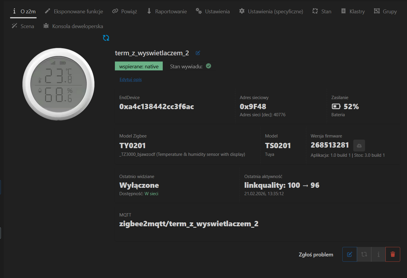

    Zigbee2MQTT device page for TY0201/TS0201 thermometer: 23.8°C, 68.6% humidity, battery 52%

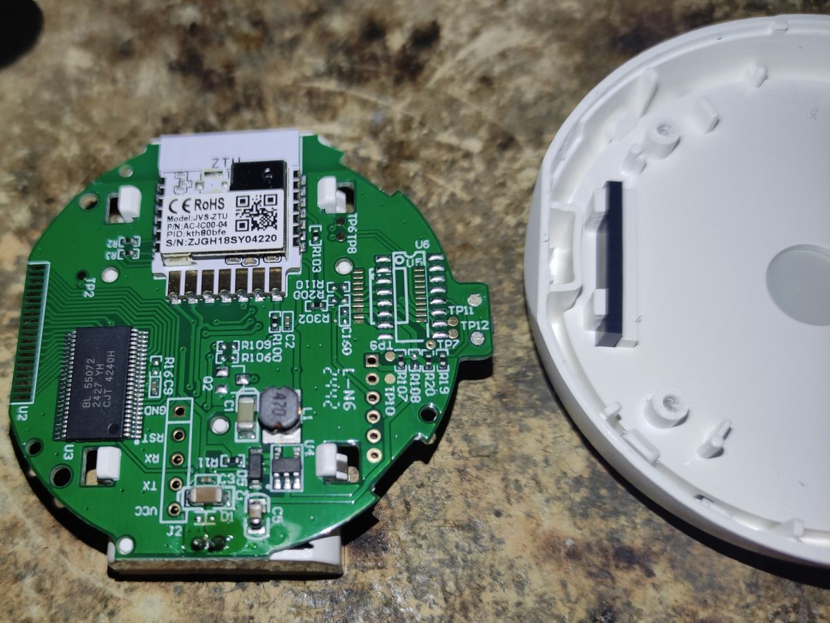

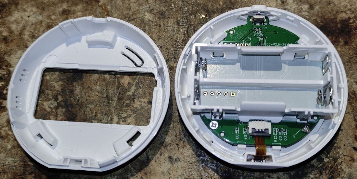

    The device comes in two versions, of course it may be sold in some other version in a while.
    - the first contains only the Zigbee ZTU module with the TLSR8258 chip - and this can be reprogrammed easily via OTA
    - the second one has an additional MRT08S (SO-8) chip, which does not know what it does - if you have this version, you have to solder this chip and make jumpers in place of the missing resistors R2 and R3 (in the version without the additional chip these resistors are there and are 0Ω). This is shown here: https://pvvx.github.io/TY0201_TZ3000_bjawzodf/

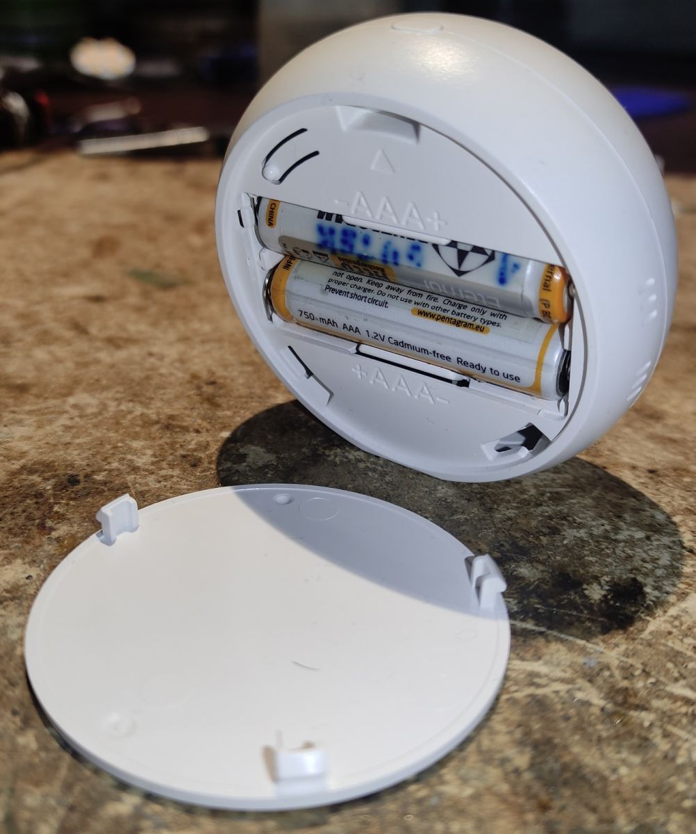

    Open white sensor housing with two AAA batteries; removed cover lying in front. Opened Zigbee thermometer housing showing PCB and a holder for two AAA batteries Green Zigbee thermometer PCB with ZTU module, next to the removed white plastic housing
    I had version one, so I didn't have to do anything.

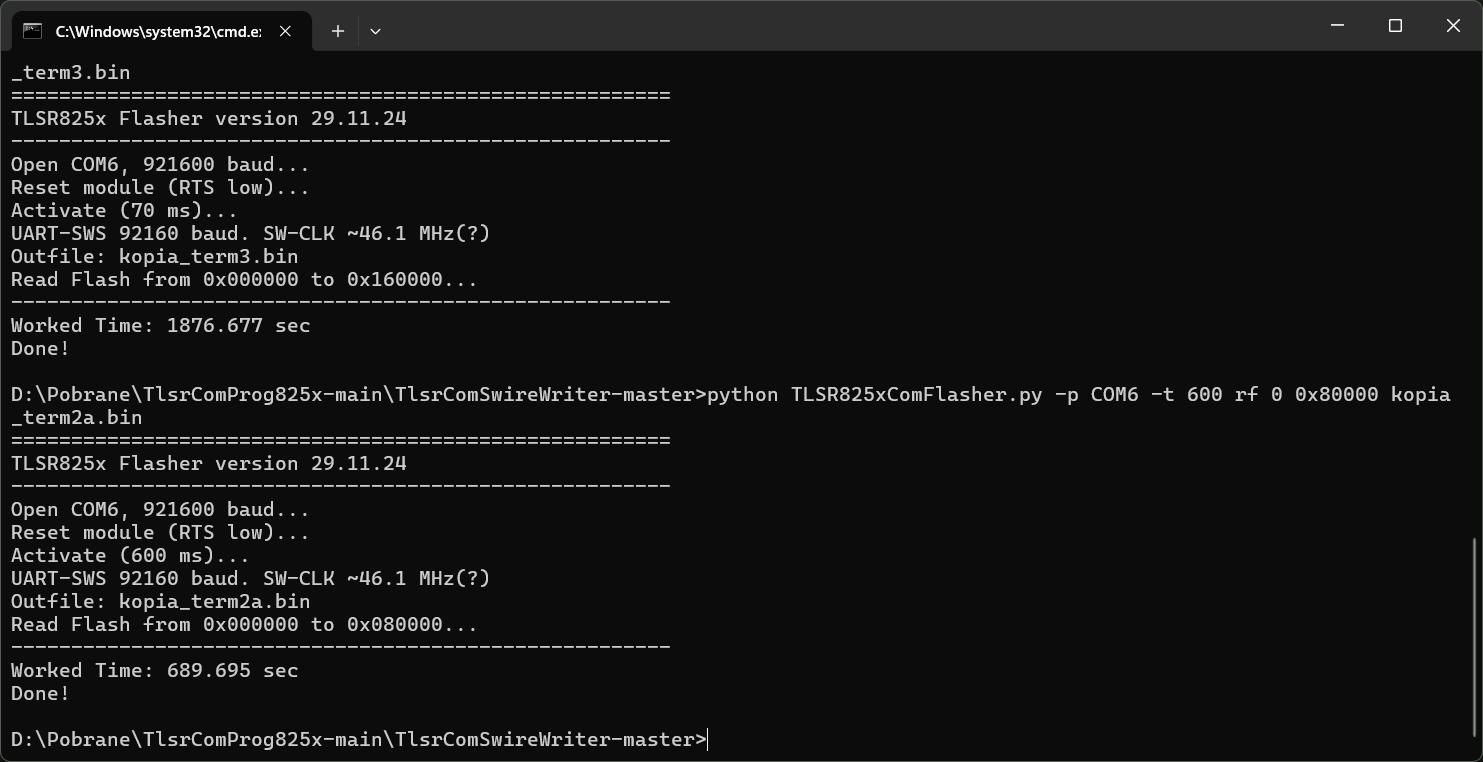

    Only to be safe I made a copy of the original software. This isn't necessary of course, but as the alternative software has only just been released I preferred to be able to revert to the original should the need arise.
    To do this I used https://github.com/pvvx/TlsrComSwireWriter and a USB-COM adapter on a CP1202 chip. I made a couple of copies and compared if I was sure the contents matched.
    Windows Command Prompt screenshot showing TLSR825x Flasher logs reading flash memory and saving .bin backups

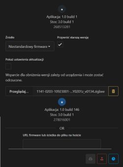

    Ok, it's now time to do the update. I'm changing the firmware to the ZigbeeTlc version written by pvvx, just this month this thermometer model started to be supported by them https://pvvx.github.io/TY0201_TZ3000_bjawzodf/
    Admittedly the version released is still marked as beta, but it fully supports this model.
    Also a couple of weeks ago there was a major change to the OTA support module in Zigbee2MQTT. The ability to manually select the file to be updated has been added. So you don't have to fiddle with creating the relevant configuration files to specify the right file. Simply download it to disk and select it in the browser window.
    This is the list of versions of this firmware from pvvx. The relevant file should be downloaded from the bin directory on github: https://github.com/pvvx/ZigbeeTLc/tree/master/bin
    There are 3 versions:
    - 1141-0203-10923001-ZTY0201z_v0134.zigbee - the first one is the one to use in this case, it is used to perform an OTA update from the original firmware
    - 1141-0230-01343001-ZTY0201.zigbee - the second one is the one to use for OTA updates when ZigbeTlc is already installed on the device
    - ZTY0201_v0134.bin - the third is a traditional binary for programmer uploads
    Zigbee2MQTT screenshot showing OTA update dialog with a selected .zigbee firmware file Zigbee2MQTT screenshot showing TS0201 Tuya device, 52% battery and remaining time 12:49

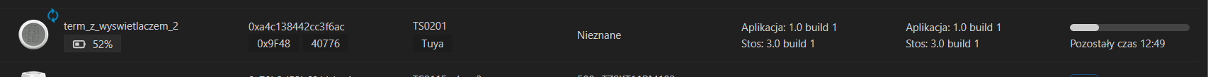

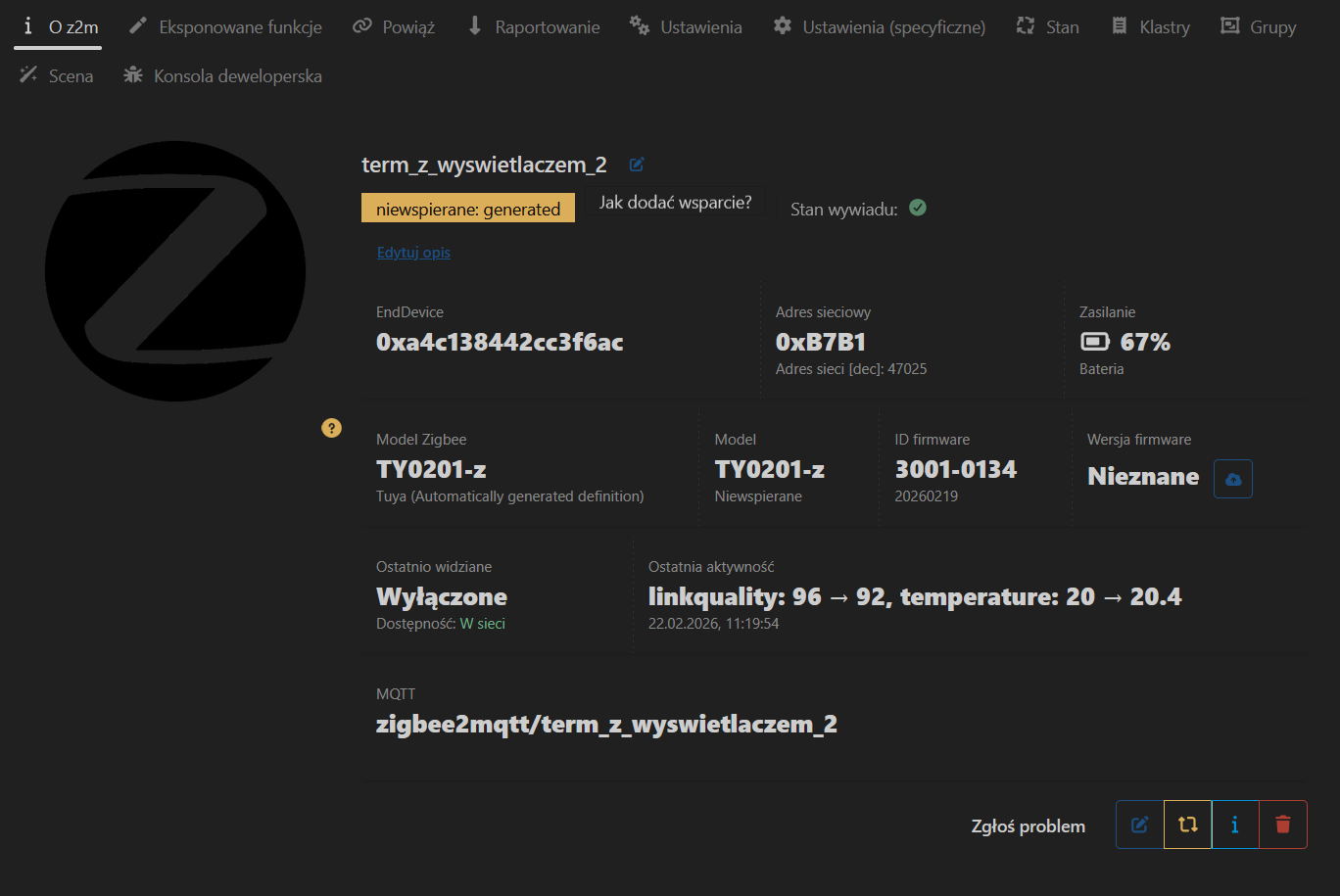

    Ok, so I specified this file, the update seemingly started and an error occurred, timeout. From what I read on github https://github.com/pvvx/ZigbeeTLc/issues/107
    It is the case with this thermometer that you have to press the button on the case all the time during the update (for about 15min of the update!), so that this one doesn't go to sleep. Another example of how the factory software is messed up.
    Well, nothing, after those several minutes of clicking, the update reached 100% and the thermometer reset. Now we had to click on the Z2M in the device tab "Reconfiguration" to have it redetected.

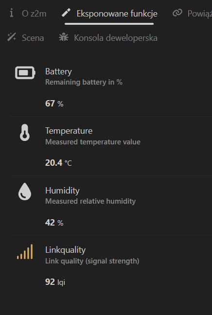

    And here's where another glitch, it turns out that the device is unsupported. Not really surprising, after all this software has only just been released and presumably with one of the next Z2M updates support will be added.

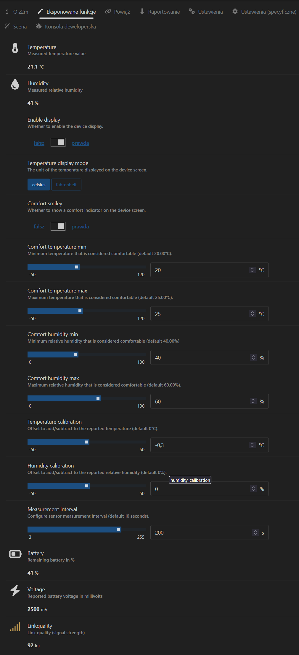

    At the moment, however, I don't have any settings available, and there are quite a few in this firmware, such as calibrating the display - both on the display and via Zigbee, setting the update frequency or disabling the display.
    Fortunately, the basic Z2M item detected, namely temperature, humidity and battery level.
    Zigbee2MQTT device page for TY0201-z showing “unsupported”, battery 67%, and firmware ID 3001_0134 Zigbee2MQTT screenshot showing sensor data: battery 67%, 20.4°C, humidity 42%, linkquality 92

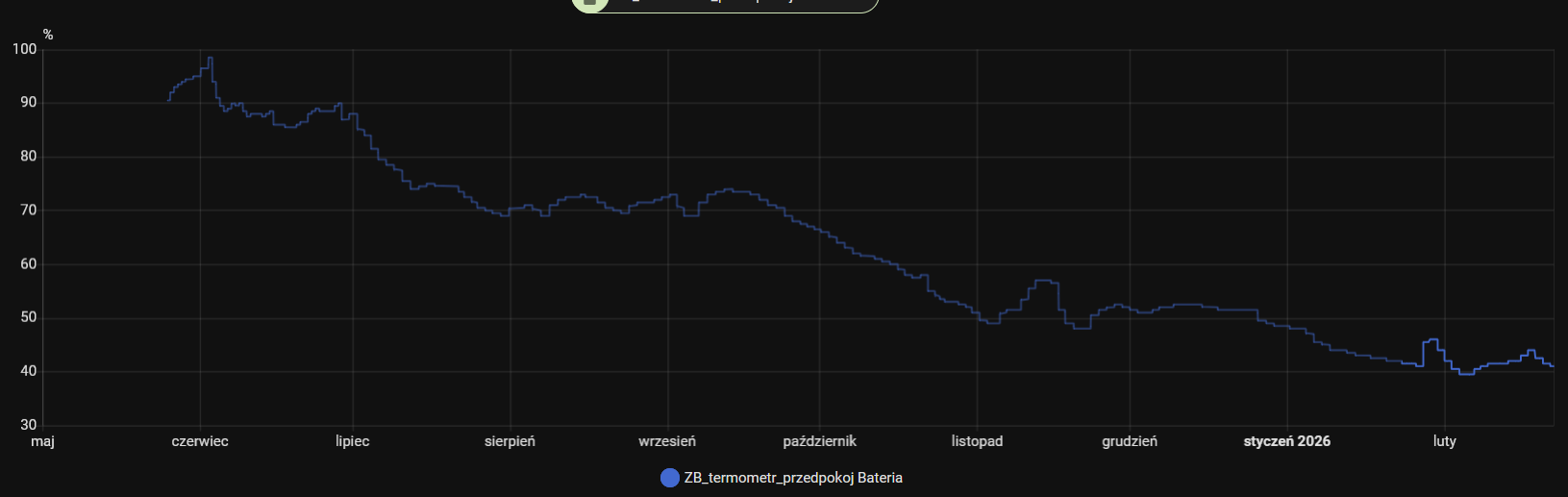

    It remains to test how this firmware will perform. I think it should sensationally because I already use it in the Xiaomi LYWSD03MMC thermometer ( https://pvvx.github.io/ATC_MiThermometer/ ), this tiny model, also with a display is powered by a CR2032 battery and has worked for me on it for over a year!

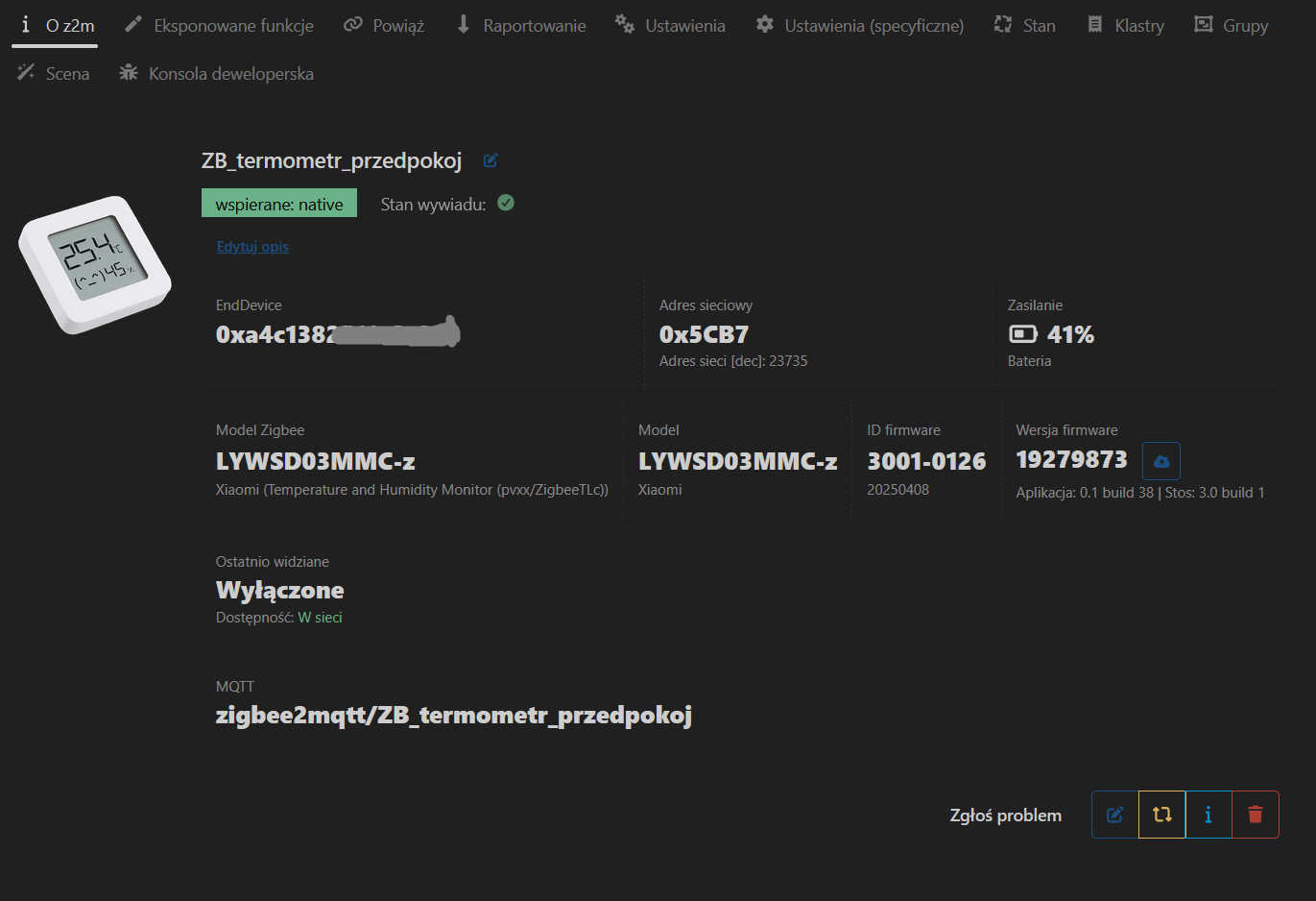

    Below you can see what settings are available for the ZigbeeTlc firmware and a diagram of the CR2032 battery in the thermometer - here the beginning is unfortunately missing because I changed the name of the thermometer, but it has been running since January 2025.
    Zigbee2MQTT device page for “ZB_termometr_przedpokoj” showing 41% battery level Zigbee2MQTT panel showing thermometer settings: 21.1°C, 41% humidity, and calibration sliders Battery level chart in percent from May to February, declining line with legend “ZB_termometr_przedpokoj Bateria”.

    >>21846033 Whether it will be better with power management is yet to be tested. I will be able to say more in a few months. I hope that yes, it will be better. There is additionally some kind of inverter there - probably to power this BL55072 screen driver, because its minimum voltage is 2.5V. And it too can drain the battery.

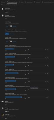

  • Custom Zigbee2MQTT external converter for TY0201 settings
    #5 21847740
    @GUTEK@
    Posts: 1561
    Help: 163
    Rate: 367
    I made up the configuration under this thermometer and pvvx software. I don't know if it is correct, but it works. You can turn off the display, change the update frequency, calibrate the temperature and humidity - these calibrations also apply to the displayed values.
    In the directory with the Z2M configuration (i.e. where you have the configuration.yaml file) you need to create an additional directory "external_converters" and in it "jakisplik.js" with this content:

Yes. Back up the original image first using TlsrComSwireWriter with a CP1202 USB‑UART. You can then restore via programmer if needed. [Elektroda, @GUTEK@, post #21845614]
Are Tuya Zigbee OTA updates signed, and is custom OTA allowed?
Many low‑cost Tuya devices accept unsigned images, enabling community firmware via Z2M. Sonoff typically signs updates; their miniswitches need a programmer for alternates. [Elektroda, @GUTEK@, post #21846098]
What internal hardware differences affect flashing?
Variant 1 uses only a ZTU module with TLSR8258 and supports easy OTA. Variant 2 adds an MRT08S; to reflash, remove it and bridge R2/R3 with 0 Ω jumpers. [Elektroda, @GUTEK@, post #21845614]
What are the default and configurable reporting intervals?
Stock firmware reports temperature every 30 minutes. ZigbeeTLc exposes a measurement_interval of 3–255 s with a 10 s default via the converter. [Elektroda, @GUTEK@, post #21847740]

How can I calibrate temperature and humidity?
Use the external_converter attributes temperature_calibration and humidity_calibration to apply ±50.00 units with 0.01‑step precision; values affect reports and on‑screen display. [Elektroda, @GUTEK@, post #21847740]
Will battery life definitely improve after ZigbeeTLc?
Results are pending; the author notes power management needs months to evaluate. Plan to disable display and tune intervals for savings. [Elektroda, @GUTEK@, post #21846098]
Stock vs. pvvx ZigbeeTLc: what changes after flashing?
Feature Stock TY0201 ZigbeeTLc (pvvx)
Temp report interval 30 minutes fixed 3–255 s, default 10 s
Manual refresh button Also toggles °C/°F Separate unit control
Display control None Enable/disable, comfort icon
Z2M status post‑flash May show unsupported Works via external_converter
Battery life claim ~6+ months on 800 mAh To be tested/optimized

Yes: “Press the button all the time during the update (for about 15min).” This prevents the device sleeping and avoids OTA timeouts. [Elektroda, @GUTEK@, post #21845614]
What immediate readings will I see in Z2M after flashing?
You’ll see temperature (°C), relative humidity (%), and battery level (%/voltage if enabled). Advanced options require the external converter. [Elektroda, @GUTEK@, post #21845614]
