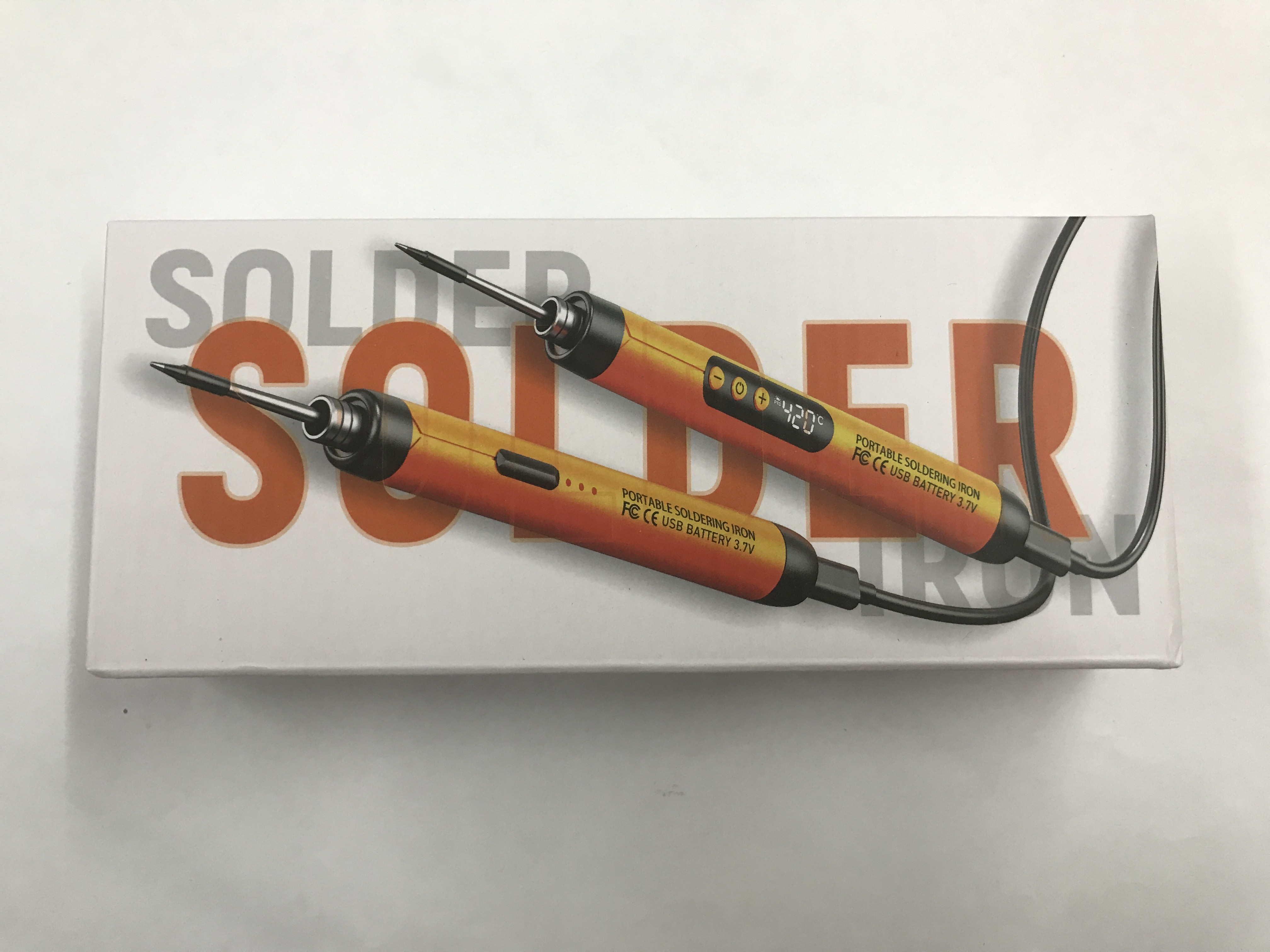

Is it sensible to buy a tiny, battery-powered soldering iron? Can such a soldering iron cope with soldering wires or goldpins? I invite you to a video test - with a breakdown of lead and lead-free solder. I bought the soldering iron for PLN30 - importantly, you can also buy soldering tips for it.

There was a bit of a wait for shipping, but maybe it was worth it?
Gray plastic-wrapped box with label and barcode reading “Soldering Iron Set” on a white surface
The product comes in different colours and there is also a version with LCD.

Time for testing:
Orange USB soldering iron with a detached tip lying on a white surface
I started by warming up. The soldering iron takes a good minute to warm up. It is not a tool for the impatient.

So is it so beautiful and you can throw the wired soldering iron into the corner?
Unfortunately there is no such option. For most applications, however, the heating power is lacking. The larger the component, the larger the copper spout, etc, the worse the soldering:
The binder even solidifies prematurely and "grabs" the soldering iron tip. There is simply a lack of heating power. The more copper, elements, layers, the stronger the heat escapes and is simply missing.
In summary , it may have been better than in my tests those 6 years ago when I tested the ZD-20E battery soldering iron, but I still wouldn't reach for this soldering iron for normal work. I'd definitely prefer to pull an extension cord, it's a better comfort to work with, heats up quicker and there's no risk of it discharging.
However, that doesn't change the fact that this soldering iron is indeed capable of connecting two wires, or thereabouts soldering simple goldpins into a small board where there is no large copper spout. This can be its advantage in unusual situations, when, for example, you are assembling something away from a socket and need to make one or two connections.
This is when you might consider buying it. I certainly don't recommend it for "lazy" people who don't want to pull out a larger soldering iron, because in the end they will lose more time wrestling with this gadget anyway than they will save thanks to its mobility.
This was just my opinion though - what do you think? To what use is such a soldering iron?
