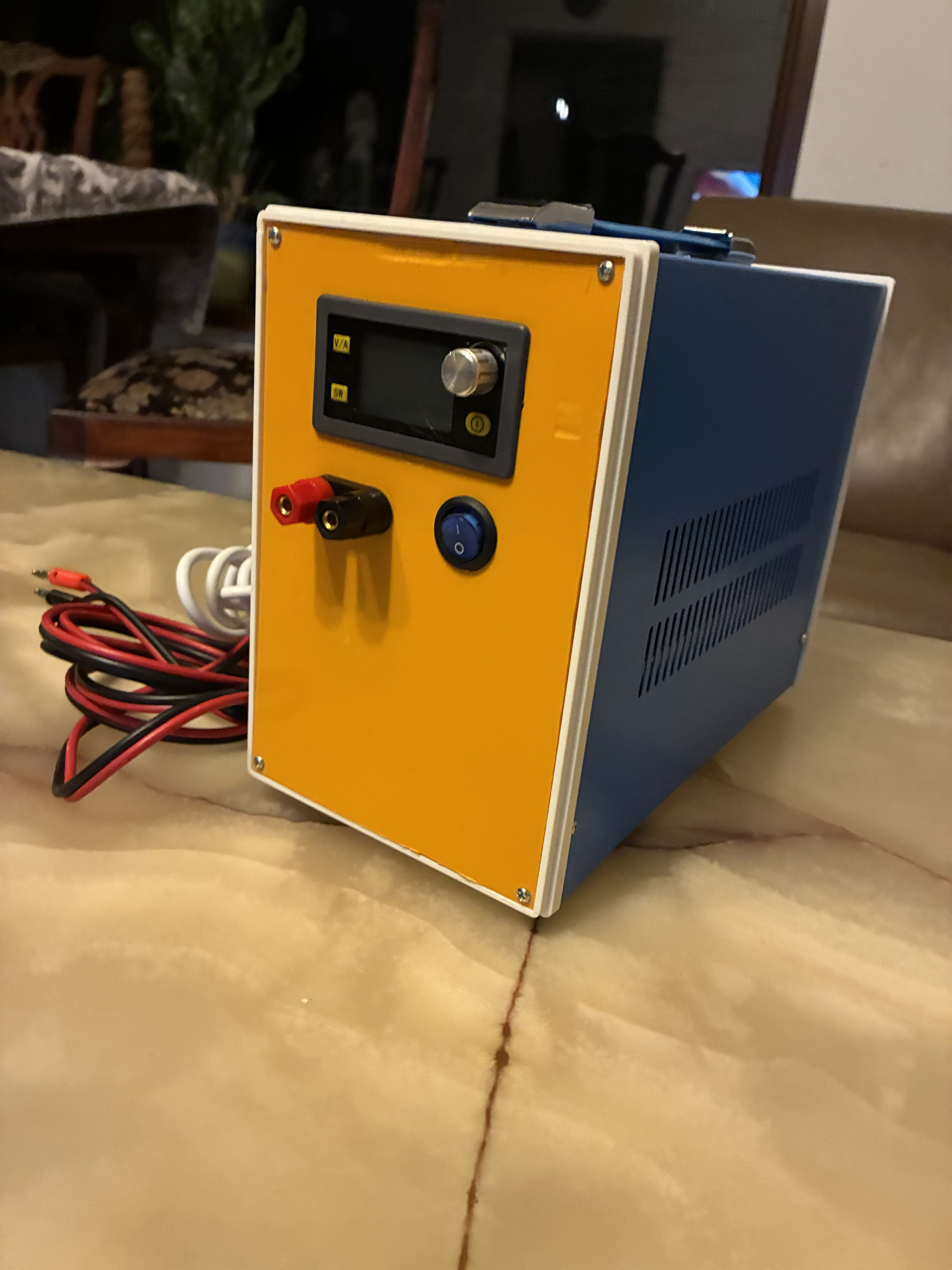

Hi everyone!
I would like to present the construction of a WAREHOUSE POWER SUPPLY quite powerful, as it is almost 1200W .
The power supply came about as an idea to get a cheaper equivalent to the Riden RD6018 kit.
Parameters of the power supply, are:
- voltage regulated 0 - 60V with 0.01V resolution
- regulated current 0 - 20A with 0.01A resolution
- theoretical total power 1200W (20A available over the entire output voltage range)
As a housing I used the housing from an unfinished (and abandoned under construction) electric vehicle service unit (e-bike, scooters).
I attach the front plate of the above mentioned device:

I trimmed accordingly, cut out space for the display, output connectors, ON/OFF button and the result:
DIY bench power supply with yellow front panel, display/knob module, banana sockets, and round power switch

Generic device:
DIY bench power supply with yellow front panel, display, knob, banana jacks, and a round power switch
Blue bench power supply with a yellow front panel, display, knob and red/black terminals on a table by cables

Overall, I'm happy with workshop equipment of this power. It's worth having on hand, sometimes it's been lacking.
The XY6020L module itself is rather uninviting to use as something you can use every day if you want to change parameters. At the same time, its
options to show the current parameters: power, capacity, temperature, time.
I have not performed tests of the correctness of the CC protection, nor have I presented here the accuracy of the indications with the Brymen 869S, but should anyone
need: I can. But at the same time I will say this: the overcurrent protection works ok, it does not cut off the power supply, it only reduces the voltage.
The accuracy of the voltage indication for a workshop power supply is consistent to tenths of a volt. For me ok.
