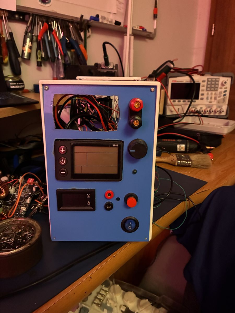

    As a housing I used the housing from an unfinished (and abandoned under construction) electric vehicle service unit (e-bike, scooters).
    I attach the front plate of the above mentioned device:
    Homemade bench power supply on a workbench with display, knob, and banana terminals on a blue front panel

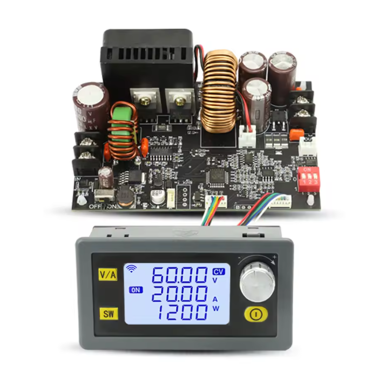

    The power supply itself consists of two main - finished components:
    XY6020L (a module known and discussed here on the forum):
    DC-DC converter board with coils and capacitors plus LCD control panel showing 60.00 V and 20.00 A

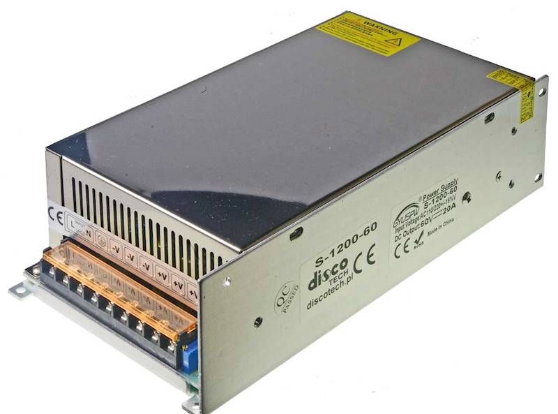

    and from a somewhat less well-known, probably 1200W inverter with the designation
    S-1200-60 (giving 60V with sensitive regulation and a maximum current of 20A):
    Metal power supply converter S-1200-60 1200W with screw terminals and side ventilation slots

    XY6020L => ~120 PLN (possible cheaper from aliexpress, but I already had this module, I give the price from algo)
    S-1200-60 => 295 PLN

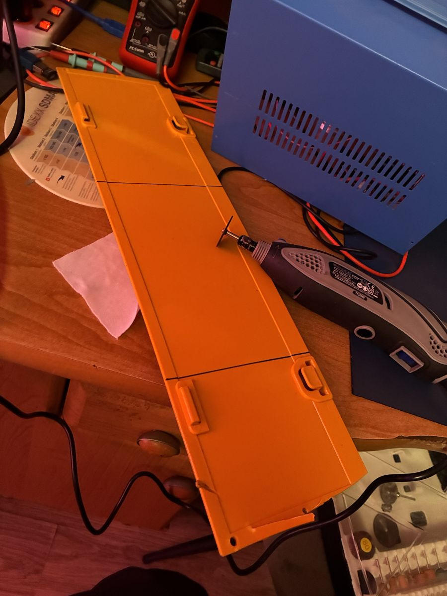

    Yellow - plastic number plate mount => 9.90 PLN
    Yes, you read correctly - I made the front plate of the housing from a yellow number plate mounting frame.
    I just found it in the garage as I was looking for something to replace the front with, and somehow it came up.
    Yellow plastic panel on a workbench beside a rotary tool and a blue vented device housing
    I trimmed accordingly, cut out space for the display, output connectors, ON/OFF button and the result:
    DIY bench power supply with yellow front panel, display/knob module, banana sockets, and round power switch

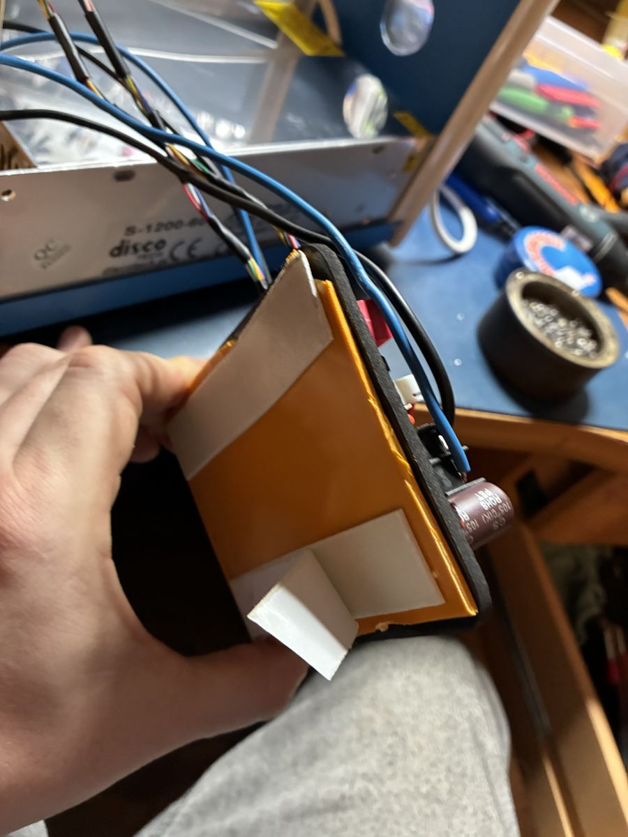

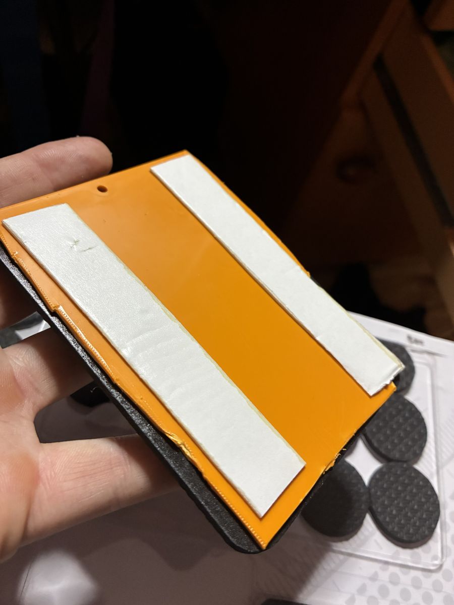

    I had a conundrum: how best to fix the module inside the housing? Well, that's where the leftover frame, double-sided tape and
    one of the rubber washers once bought in Lidl or Biedronka. Maybe I will attach pictures:
    A hand holds an orange rectangular piece with two white adhesive strips on top
    I screwed the module through a rubber washer to a plastic stand, which I glued to the S-1200 inverter housing with double-sided tape
    with - as it turned out later - very high adhesive strength. The module is immovable, of course with a knife you can peel it off, but even in case of failure,
    i did not stick on any of the mounting or ventilation elements of the inverter.

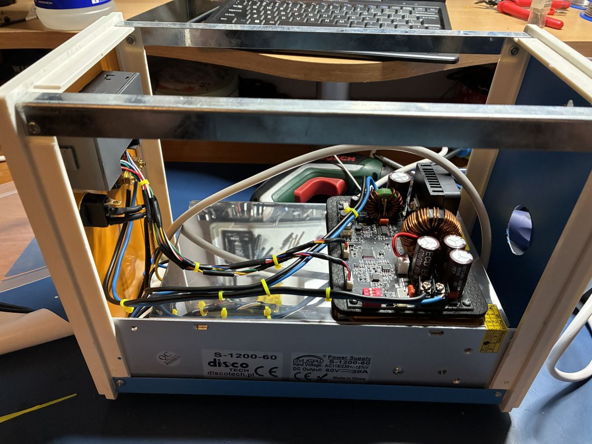

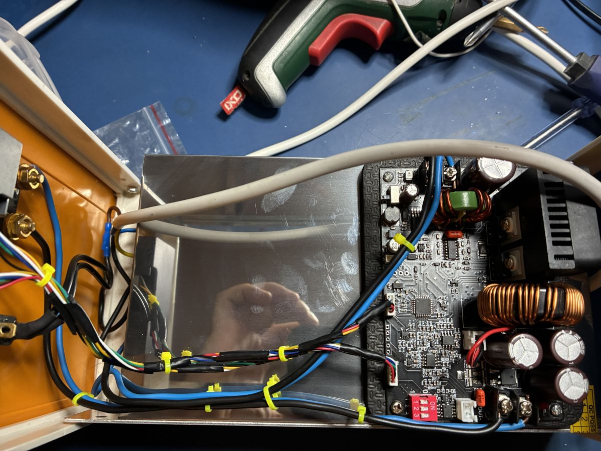

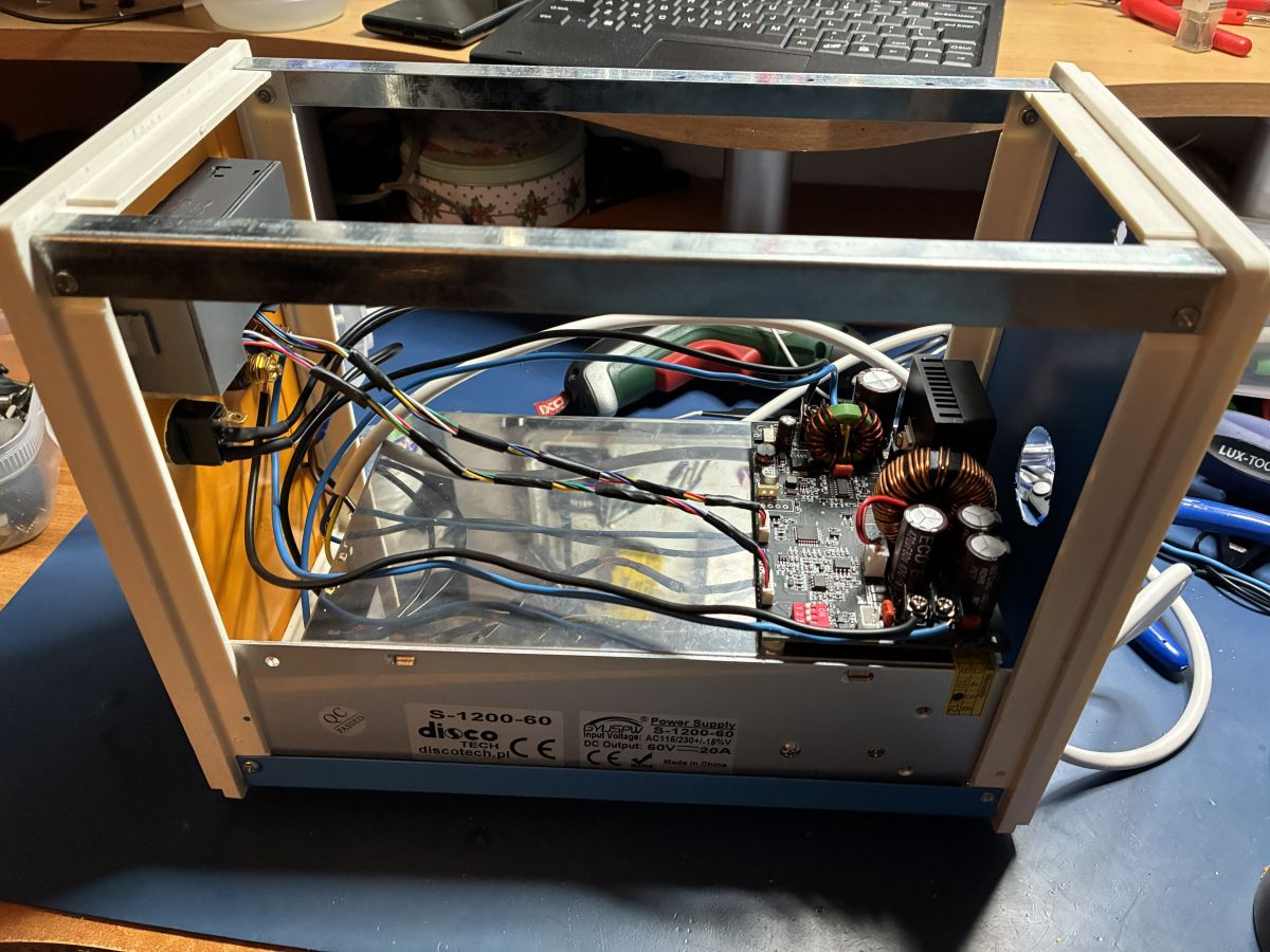

    Finally the inside looks like this:
    Inside a power supply case: converter module, wiring bundles, and a metal frame on a workbench
    from above:
    Inside a metal enclosure with an electronics module, cable ties, and a large copper inductor coil

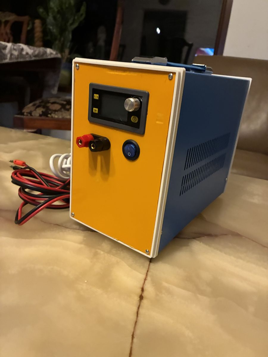

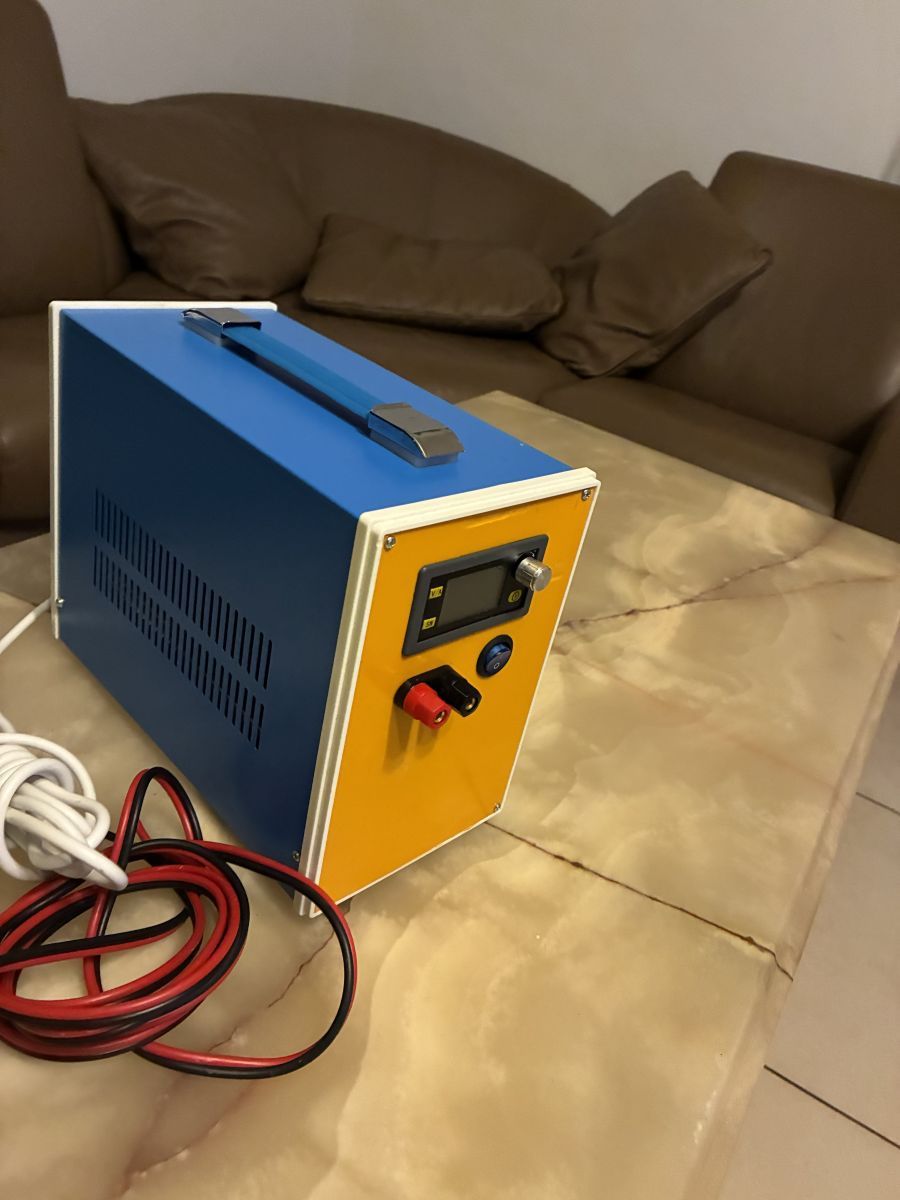

    Generic device:
    DIY bench power supply with yellow front panel, display, knob, banana jacks, and a round power switch
    Blue bench power supply with a yellow front panel, display, knob and red/black terminals on a table by cables

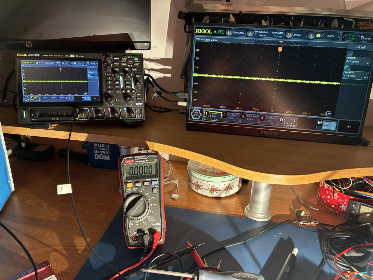

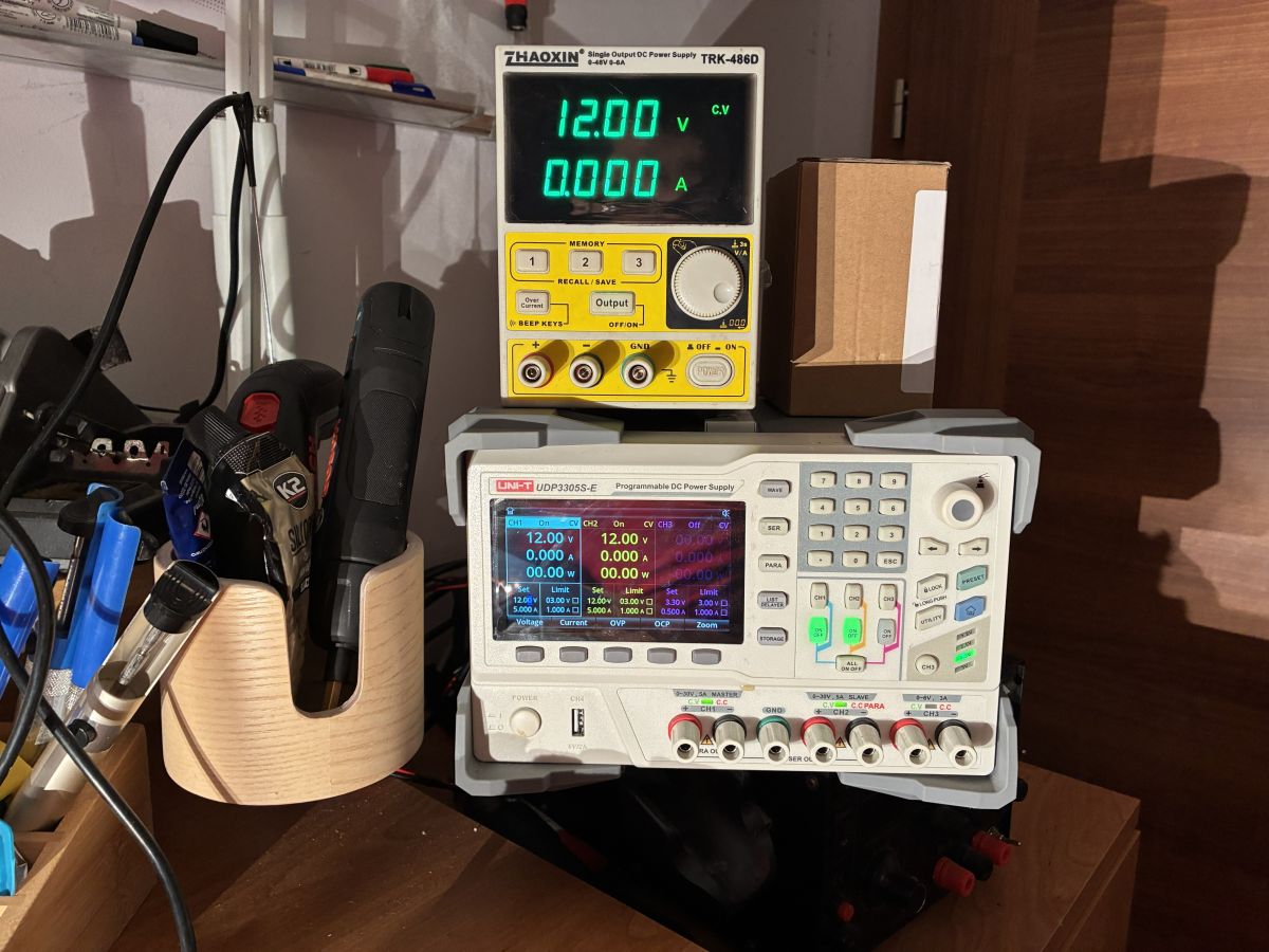

    I wanted to sit down for some ripple testing:
    Workbench with Rigol oscilloscope, Arzopa display showing a waveform, and a UNI-T multimeter on the desk
    I have a possible measurement to compare to:
    Two DC bench power supplies on a workshop shelf, both showing 12.00 V and 0.000 A
    But I don't quite know how to do them right, because I don't have a fixed load (and a supply of gloves). I can tell you one thing: the ripples vs
    UDP3305S are, I don't want to talk about the values because I don't know if I set the oscilloscope right (coupling AC, x10, the rest is in the picture with a 120W load).
    If you'd like me to do some tests, go ahead - I'll post in the discussion when I find the time.

    I have a question related to one photo
    Portable ARZOPA monitor showing a RIGOL oscilloscope interface with a yellow waveform trace on the screen
    What is the model of the monitor? Have you checked any other touchscreen ones? Apparently not everyone wants to work with the Rigol.

    This is the ARZOPA Z1FC model. It is not touchscreen.
    16.1'' and 144 Hz. A cool way to connect and transfer images via USB-C (for a laptop). With an oscilloscope all you need is the oscilloscope power supply, the monitor is a power hub.

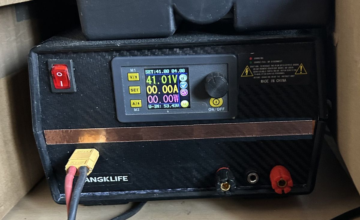

  • XT60 output and 4 mm² wiring for 20 A
    #10 21851481
    Mastertech
    Level 30  
    Posts: 1836
    Help: 108
    Rate: 381
    I made myself a 50V/20A on RD module
    On the primary flatpack 48V/15A turned up to 52V
    Due to RD efficiency and power balance, I have the full 20A available up to about 35V, above that "only" 15.
    The first thing I looked at was the wire cross sections. As the flatpack has 6 pairs of pins in the current connector we isolate ALL of them and only on the XY module do we connect them together. If we can get a 2.5mm copper cable out of the flatpack, it can handle up to 10A, but a 4mm2 copper cable can handle 20A.
    The same applies to the output terminals, I have these bananas as auxiliary, I have the main one on an XT60 connector.
    I attach a photo of my monster: (yes, it used to be C1-112)
    Power supply front panel with display showing 41.01 V and 0.00 A, banana jacks, and an XT60 connector

    Regarding noise measurements:
    Typically you measure AC RMS noise voltage and Vpp in the band up to 20 MHz. Some people use a 1:10 classic (1 M) probe, which is what you should have included with your oscilloscope.
    Sometimes a 1:10 but 50 Ohm probe is used. This is easy to make. However, I don't think it is necessary in this case.
    I am concerned about the power supply: the S-1200-60 - the manufacturer, or rather the importer, does not give documentation. Which is pathetic to say the least.
    I'm basically sure that you'll have to improve the ventilation of the case - at 90% efficiency, the main power supply will give off 120 W of power + losses on the XY6020L. the holes in the top of the case may not be able to convectively remove that much heat.
    Let us know how much noise the S-1200-60 is making and how noisy the whole thing is. High noise is a moderate problem in a design like this, this is supposed to be over 1 kW, not low noise.
    Testing something like this requires pretty massive load resistors.... You could make something out of an old heater :)
    16.1'' and 144 Hz. A cool way to connect and transfer images via USB-C (for a laptop). With an oscilloscope, all you need is an oscilloscope power supply, the monitor is a power hub
    The oscilloscope talks to it over USB-C while receiving power at the same time?
    Or does it output the image over HDMI though?
    Write something more please.

  • Using three 24 V 500 W supplies in configurable setup
    #19 21853436
    Staszek_Staszek
    Posts: 3899
    Help: 116
    Rate: 840
    At the polyclub we had some water barrels with a simple mechanism to lower the electrodes. I don't remember if any salts were added to the water there.
    I decided not to build or buy a 60V - 20A power supply although I was tempted to do so.
    I decided that I would buy myself 3 pieces of 230/24VDC 500W fleXPower X7-2L2L power supplies and combine them in the desired configurations.
    The power supplies were from some demob.
    I tested each separately with kanthal spirals because 500 watts is not a problem as with 1500.
    I didn't check if the short-circuit protection worked or if it was immune to reverse voltage.
    I always connect a 600 V - 20 A diode between the power supplies and the motor.
    I feel safer with this because I don't always know what will appear to me when the circuit is broken.
    I try to remember that I am also fallible.
