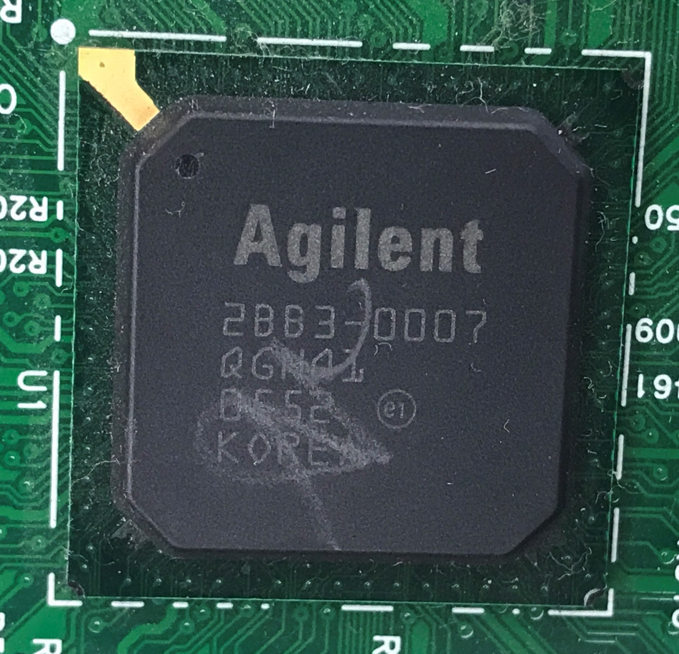

Close-up of a green PCB with ICs, including a large Agilent chip and an MX memory chip
The main MCU is an Agilent 2BB3-007 QGNQL - I can't find anything about it. The D56V62160 is a 2*512K*16 bit DRAM. The MX chip is probably a program flash memory.

Of the tasks that remain to be done:
- locate this UART on the PCB and verify that it also displays messages there
- try to simulate most of the firmware
- try to locate the GPIO registers
- try to compile something of your own and upload it to this Flash
Project repository: https://github.com/openshwprojects/EridaniEmulator

gregor124 03 Mar 2026 20:33
Hello, I think you have set the address wrong. The first byte 0xE5 indicates that this is an unconditional branch "b" instruction. The address in it is bits 23...0, which is 0x9FF2B8 and is a number... [Read more]
