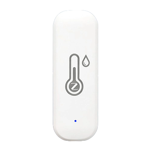

I recently bought on Aliexpress extremely cheap temperature and humidity sensors powered by two AAA batteries and communicating via Zigbee. The price of one unit was less than PLN8 - and that's probably their only advantage.
AliExpress order screenshot showing a Zigbee 3.0 temperature and humidity sensor listing
Even before the package arrived, some rather interesting comments started appearing on the product page. Standard ones like " ***** are great! but I haven't checked yet " and " * crap, doesn't work! ", suggesting that some buyers had not read that the device required a Zigbee gateway. Others began to appear, with very poor range, self-disconnection, and incorrect indications. There was even one with pictures of the device board, which.... was about 1/3 the size of those in older versions.
Eventually, the thermometers arrived. A standard cardboard box, and in it: a brief manual, foam with adhesive tape for assembly, a key for the reset button and the device itself.
Right out of the box, you can see that this is budget equipment. The plastic gives the impression of being of inferior quality - it is not perfectly white, rather slightly creamy and seems to be softer.
Zigbee temperature and humidity sensor kit with device, box, manual, mounting tape, and reset pin tool
After inserting the rechargeable batteries, I paired the device with the Zigbee2MQTT I was using. The sensor was detected without any problems and reported itself as ZY-ZTH02.

The only thing I noticed was the use of a blue LED instead of a red one. Blue LEDs require a higher voltage, so I'm curious to see how this LED will behave with heavily discharged batteries.
White temperature and humidity sensor with thermometer and droplet icons on a wooden surface
The temperature and humidity readings update very quickly - presumably the measurement is sent every time the value changes. This will have an impact on battery life, but for now it is difficult to assess how much.
