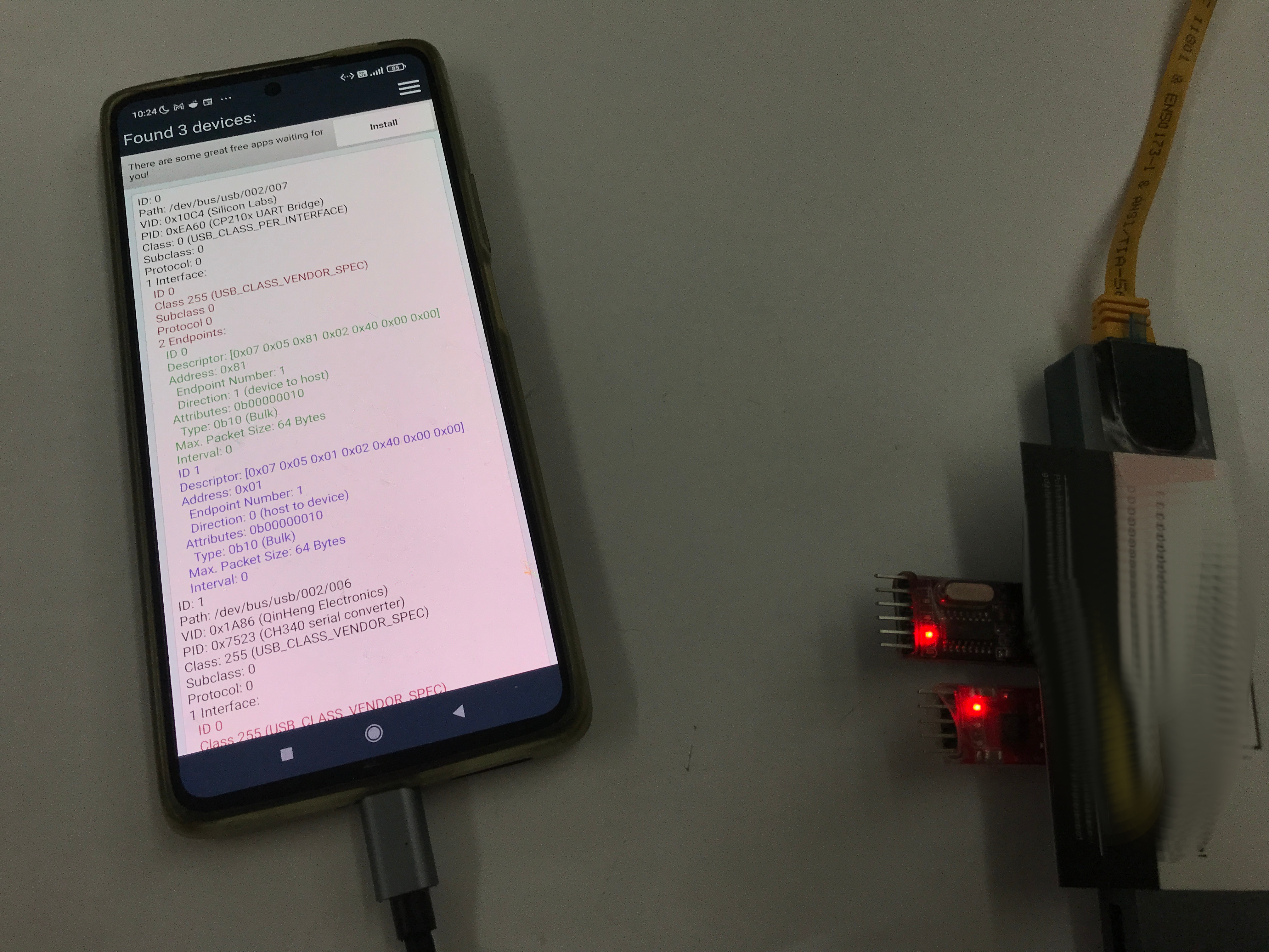

It remains to check the USB to UART converters - one converter, the number of devices found increases by 1, the device is correctly recognised as CH340:
The second converter, CP210x, is also correctly seen:
In summary , I was able to run on this hub:
- wired internet access
- access to storage
- access to USB to UART converters (two types I checked)
