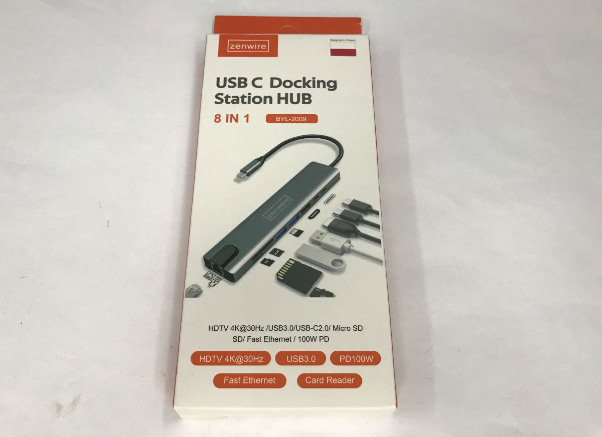

    Packaging of Zenwire USB‑C Docking Station HUB 8‑in‑1, model BYL‑2009

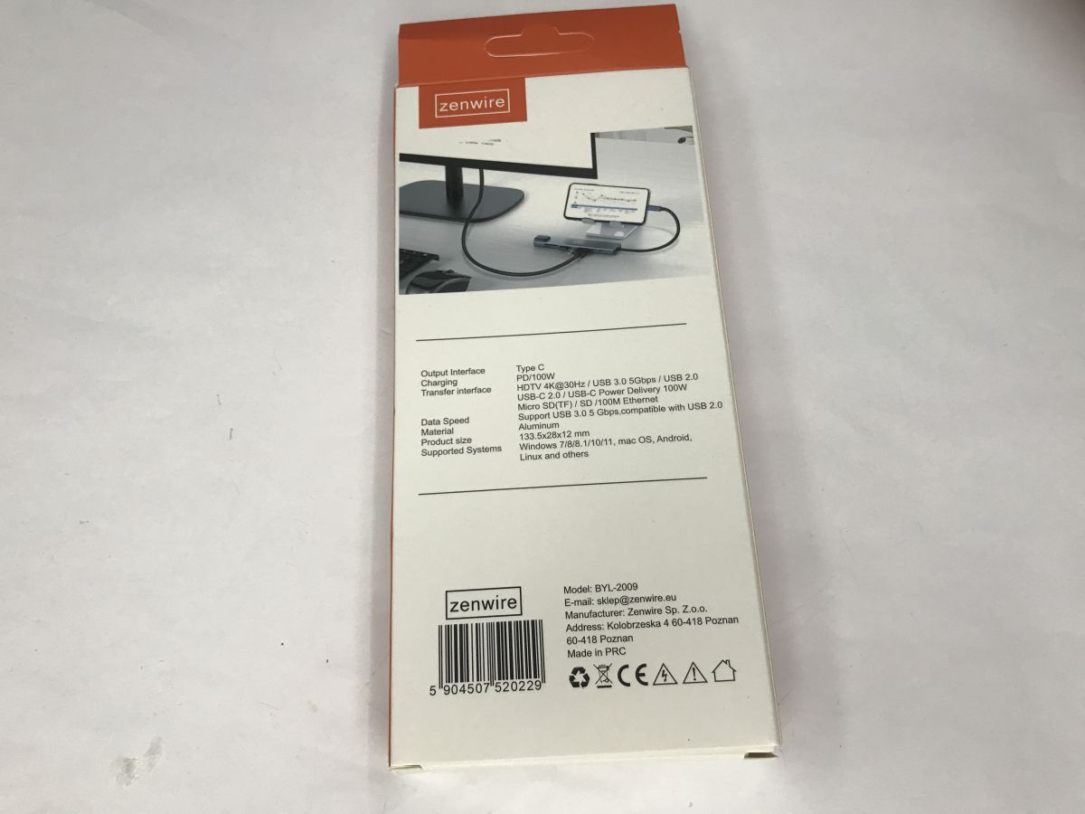

    I bought the first better (actually, cheaper) USB C splitter, model BYL-2009 from Zenwire. It is advertised as 8-in-1 - Ethernet, microSD card, SD, TF, four USB (including two C) and one HDMI. The whole thing also supports PD up to 100 W.
    Back of Zenwire BYL‑2009 USB‑C hub box with ports list and specifications

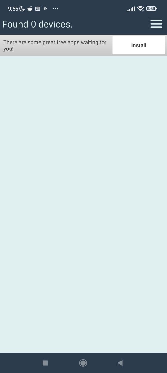

    I verified the hub with my old Xiaomi 11T phone - depending on the phone model, you may get different results. I used the Ultimate USB app to verify.
    First a control test - 0 USB devices without the hub:
    Android app screenshot showing the message “Found 0 devices.”

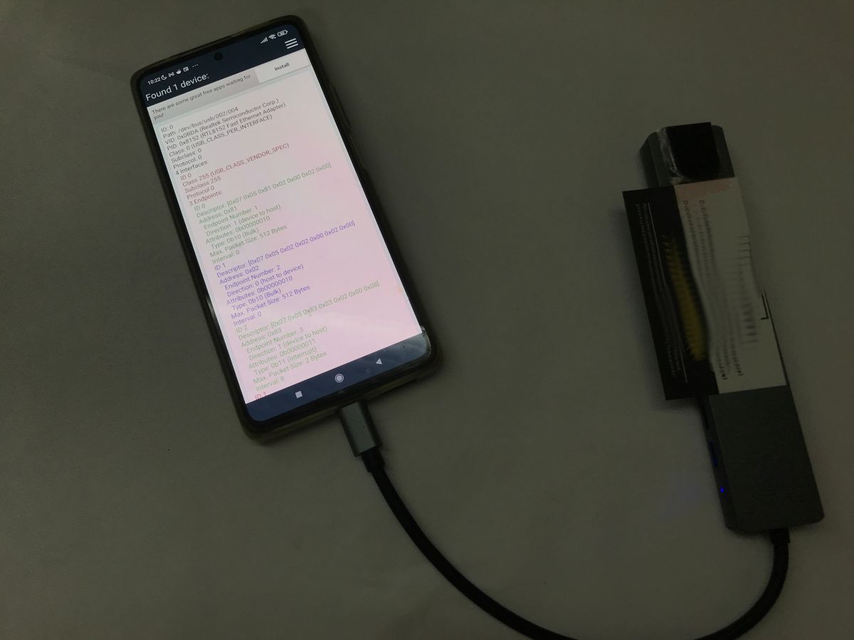

    Now with hub:
    Smartphone connected by cable to a USB‑C hub; the screen shows a list of detected USB devices
    The phone already sees the network controller - RTL8152, but will it work? I disabled the Wi-Fi before the test.

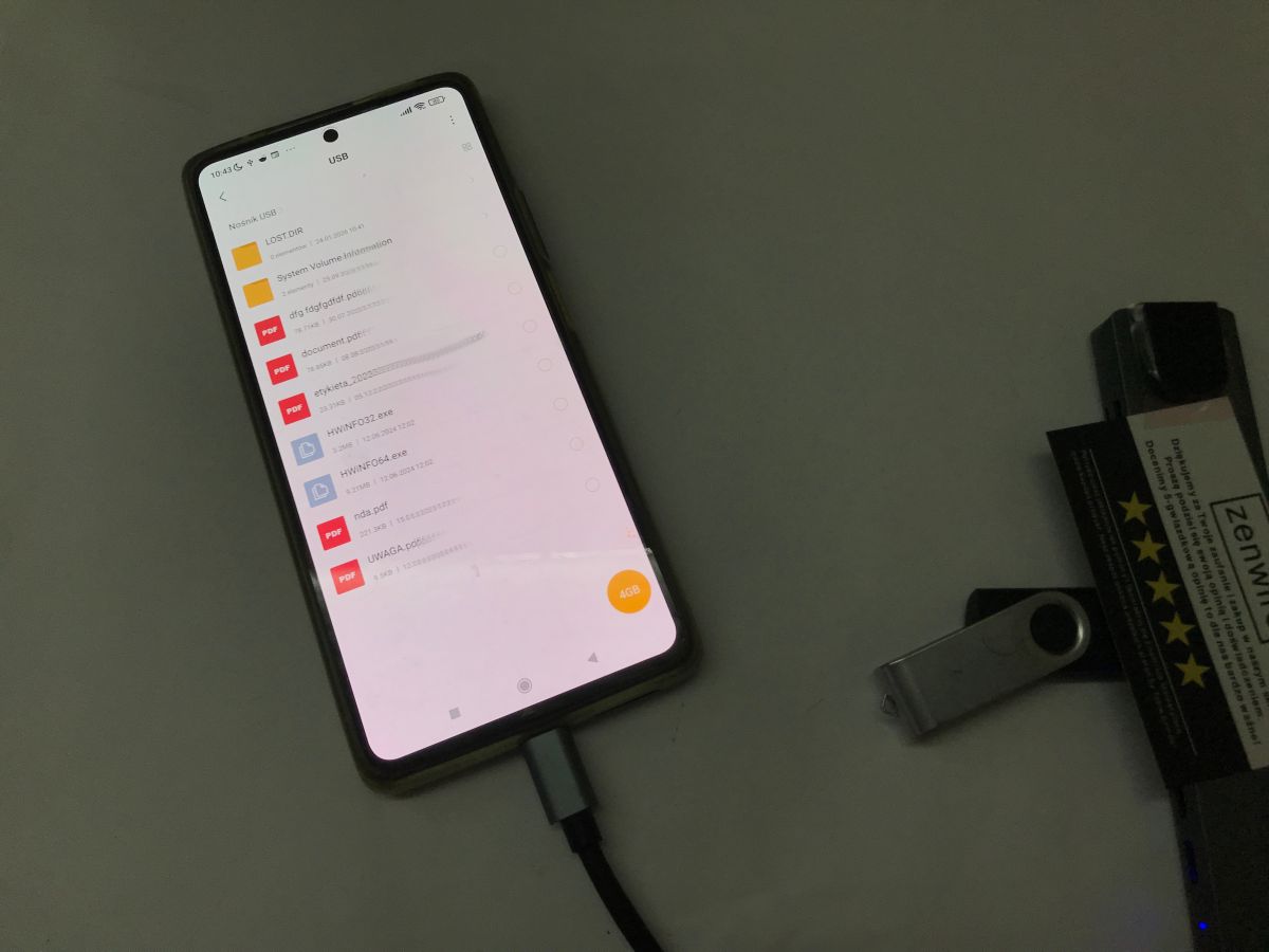

    Internet is working - now maybe check the storage media.
    Smartphone with USB file list on screen and a connected cable; beside it a flash drive and Zenwire packaging
    The memory stick is correctly seen and its contents are available on the phone.

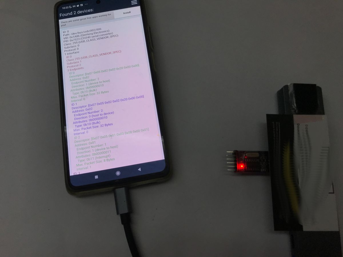

    It remains to check the USB to UART converters - one converter, the number of devices found increases by 1, the device is correctly recognised as CH340:
    Phone displaying USB device details; nearby a small board with red LED and a flat ribbon cable

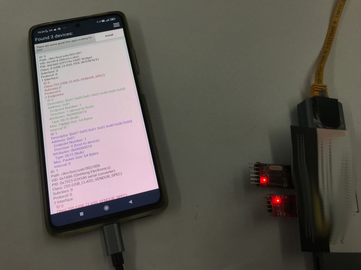

    The second converter, CP210x, is also correctly seen:
    Smartphone showing “Found 3 devices” connected to a USB‑C hub; Ethernet adapter and small LED-lit boards nearby
