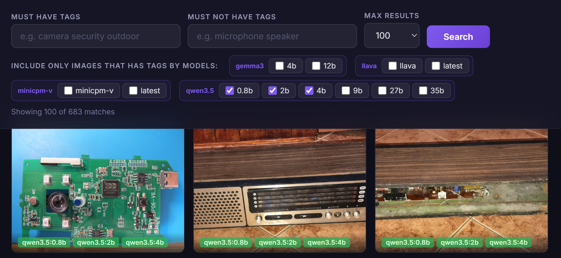

Screenshot of an image search tool with AI model filters and three result thumbnails
Will the Qwen3.5 models allow a simple image search engine to be built by verbal description of the content? Could local AI work in the role of OCR? In the previous topic the AI described more than 1000 images from the Elektroda forum , here I enriched this collection with descriptions from Qwen models 0.8b, 2b, 4b, 9b, 27b, 35b. I have packed the results into a simple search engine. Time to see how it worked.

The question of publication remains - the results are available on GitHub in the form of an image finder. Each image is clickable and its tags can be previewed:
https://openshwprojects.github.io/IndexingElektrodaImages/search2.html
An older version of the site is also available:
https://openshwprojects.github.io/IndexingElektrodaImages/search.html
