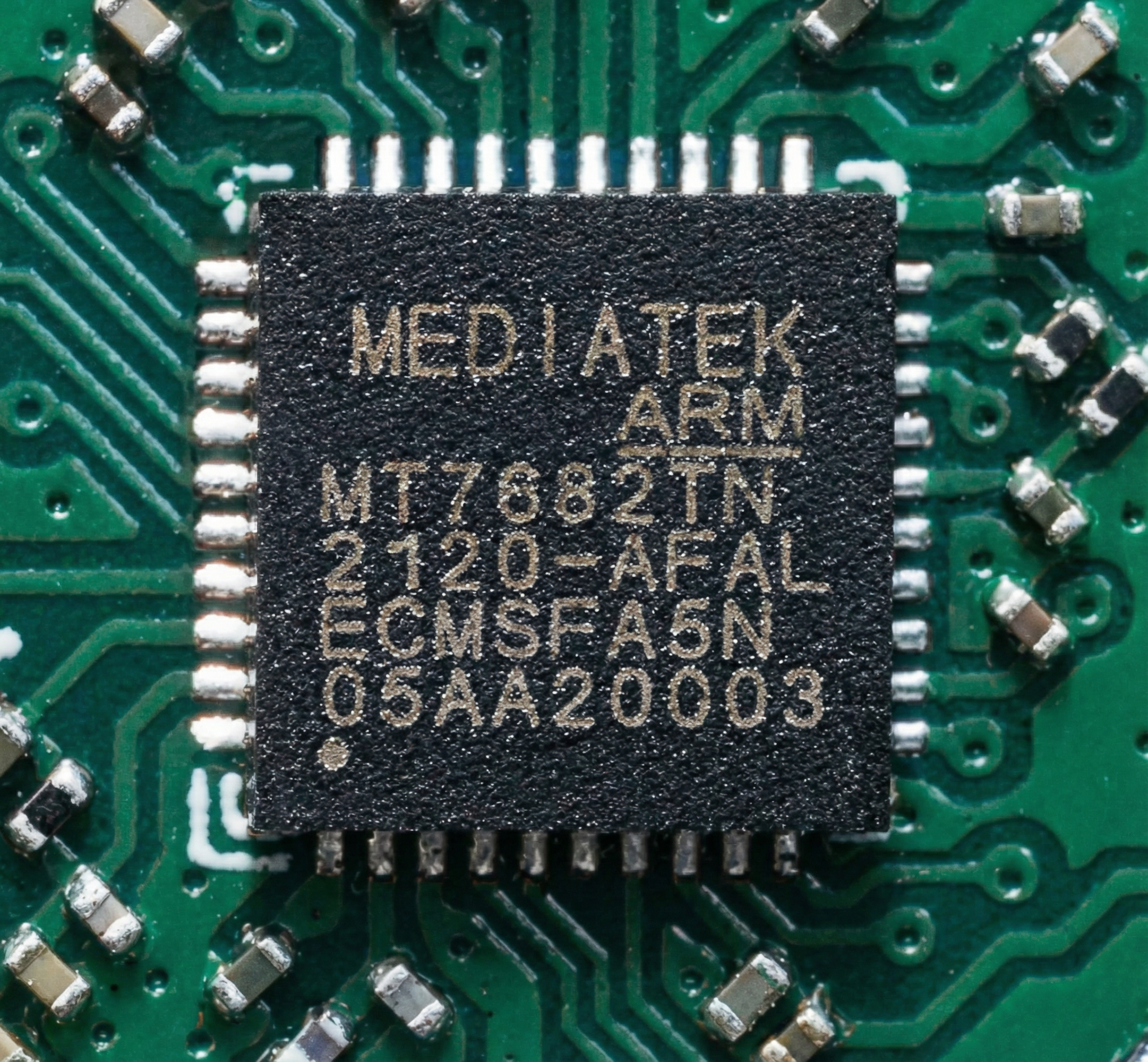

The markings on this Wi-Fi module don't tell me anything. Could this be some kind of novelty, or rather something I haven't seen before?

The first one, however, I soldered off the screen. Inside the module is a Mediatek chip.
Close-up of a Wi‑Fi module on a green PCB with a MediaTek MT7682TN chip

Information about MT7682
The MT7682 catalogue note is available on the web. I include it in the appendix.
The chip features an ARM® Cortex®-M4 core with FPU, clocked to 192 MHz, 384 KB of RAM and 1 MB of Flash memory. Unfortunately, Flash is quite scarce here, a bit like in the regular ESP8285. There may be a problem here with updating the firmware via Wi-Fi, because then you have to fit both images at once in non-volatile memory.
